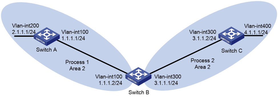

Enabling OSPF
To enable OSPF on a router, you must perform the following tasks:
1.     Create an OSPF process.
2.     Create an OSPF area for the process.
3.     Specify a network in the area.
The interface attached to the network will run the OSPF process in the area. OSPF advertises direct routes of the interface.
OSPF supports multiple processes. To run multiple OSPF processes, you must specify an ID for each process. The process IDs take effect locally and has no influence on packet exchange between routers. Two routers with different process IDs can exchange packets.
Restrictions and guidelines for enabling OSPF
When you configure OSPF on an interface, follow these restrictions and guidelines:
·     You can enable OSPF on the network where the interface resides or directly enable OSPF on that interface. If you configure both, the latter takes precedence.
·     If the specified OSPF process and area do not exist, the operation creates an OSPF process and area for the interface. Disabling an OSPF process on an interface does not delete the OSPF process or the area.
Enabling OSPF on a network

Example: Configuring OSPF route redistribution

Example: Configuring OSPF route summarization on an ASBR
As shown in Figure 11:
·     Configure OSPF on Switch A, Switch B, and Switch C in Area 2.
·     Enable OSPF process 1 and process 2 on Switch B. Switch B uses OSPF process 1 to exchange routing information with Switch A, and uses OSPF process 2 to exchange routing information with Switch C.
·     Assign IP addresses 2.1.2.1/24, 2.1.3.1/24, and 2.1.4.1/24 to VLAN-interface 200 of Switch A. To enable Switch C to learn routes destined for 2.1.2.0/24, 2.1.3.0/24, 2.1.4.0/24, configure OSPF process 2 on Switch B to redistribute routes from process 1 and direct routes.
·     To minimize the size of the routing table on Switch C, configure ASBR route summarization on Switch B. Switch B advertises only the summary route 2.0.0.0/8.
Figure 11 Network diagram
1.     Configure IP addresses for interfaces. (Details not shown.)
2.     Configure OSPF:

3.     Configure OSPF to redistribute routes:
# Configure OSPF process 2 on Switch B to redistribute routes from OSPF process 1 and direct routes.
[SwitchB] ospf 2
[SwitchB-ospf-2]import-route direct
[SwitchB-ospf-2]import-route ospf 1

4.     Configure OSPF to summarize routes on the ASBR:
# Configure OSPF process 2 on Switch B to advertise summary route 2.0.0.0/8.
[SwitchB] ospf 2
[SwitchB-ospf-2] asbr-summary 2.0.0.0 8
[SwitchB-ospf-2] quit
