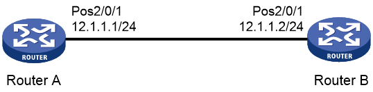

As shown in Figure 1, Router A and Router B are connected by POS interfaces.
Run HDLC on the link between them.
Figure 1 Network diagram

HDLC link bundling configuration examples
Example: Configuring HDLC link bundling
As shown in Figure 2, to increase bandwidth and enhance connection reliability between Router A and Router B, create an HDLC link bundle.
Figure 2 Network diagram

# Verify that:
·     Pos 2/0/1 and Pos 2/0/2 are in Selected state and can perform load balancing.
·     The bandwidth of the HDLC link bundle is 1244160 kbps, the total bandwidth of two POS interfaces.
·     When one POS interface fails, the traffic can be forwarded through the other POS interface. This improves the link reliability.
Use Router A as an example.
[RouterA] display bundle hdlc-bundle 1
Bundle: HDLC-bundle1
  Selected members: 2, Total bandwidth: 1244160 kbps
  Member              State               Bandwidth(kbps)     Priority
  Pos2/0/1            Selected            622080              32768
  Pos2/0/2            Selected            622080              32768
