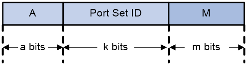

Port number mapping mechanism
Upon receiving a private IPv4 packet, the MAP CE translates the source IPv4 address and source port of the packet. Then, the tunnel module of the MAP CE encapsulates the translated IPv4 packet with an IPv6 header. To improve public IPv4 address usage, MAP uses transport layer ports to extend IPv4 addresses. As a result, a public IPv4 address on the MAP CE can be used by multiple private users.
MAP divides a 16-bit transport layer port number into the following parts:
·     A—PSID offset, which is the number of PSID offset bits. The default value is 6. The PSID offset avoids conflicts with well-known port numbers in the range of 0 to 1023.
·     PSID—The length (k) of a PSID determines the sharing ratio (R), which equals to 2k. Transport layer ports are divided into 2k sets and each set contains a group of consecutive port numbers. Each MAP CE has a unique port set.
·     M—The length (m) of this field determines the number of consecutive ports in the port set, which is 2m.
Consequently, a total of 2k port sets are obtained. A PSID uniquely identifies a port set. Each port set contains a number of ((2A)-1)×(2m) ports.
Figure 1 Transport layer port structure for MAP
For example, the PSID offset is 4, the PSID length is 10, and the length of the M field is 2. The transport layer ports are divided into 210=1024 port sets. Each port set contains ((24)-1)*(22)=60 port numbers. Table 3 shows the mappings between PSID values and port sets. The port sets in the table are segmented because the port numbers in the port sets are not consecutive.
Table 3 Mappings between PSID values and port sets

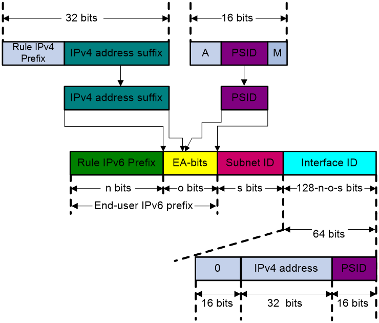

Address mapping mechanism
The MAP CE maps the translated IPv4 address and port number of the original IPv4 packet to an IPv6 address based on the mapping rule, as shown in Figure 2. The IPv6 address contains the Rule IPv6 prefix, EA, Subnet ID, and Interface ID fields. The mapping rule establishes a strong connection between the IPv4 address and port information and the IPv6 address to perform a stateless mapping. This protects the MAP BR from maintaining the mapping between the IPv6 and IPv4 addresses.
·     Rule IPv6 prefix—IPv6 prefix assigned to the MAP CE by the DHCPv6 server.
·     Subnet ID—ID of the first subnet. The value for s is 0.
·     EA—A combination of the IPv4 suffix and the value of the transport layer port's PSID.
·     Interface ID—A combination of an IPv4 address and PSID value.
¡     IPv4 address—If the DHCPv6 server assigns a shared IPv4 address or a dedicated IPv4 address to the MAP CE, the value is the assigned 32-bit IPv4 address. If the DHCPv6 server assigns a Rule IPv4 prefix to the MAP CE, the value for this field is right-padded with 0s to create a 32-bit field. For example, if the Rule IPv4 prefix is 2.1.1.0/29, the value for this field is 0x02010100 (hexadecimal).
¡     PSID—If the PSID value extracted from the EA-bits is less than 16 bits, it is left-padded with 0s to create a 16-bit field. For example, if the PSID value extracted from the EA-bits is 0xAC, the value for this field is 0x00AC. If the DHCPv6 server assigns a Rule IPv4 prefix or a dedicated IPv4 address, no PSID value can be extracted. The value for this field is 0x0000.
Figure 2 Mapping between an IPv4 address and an IPv6 address
