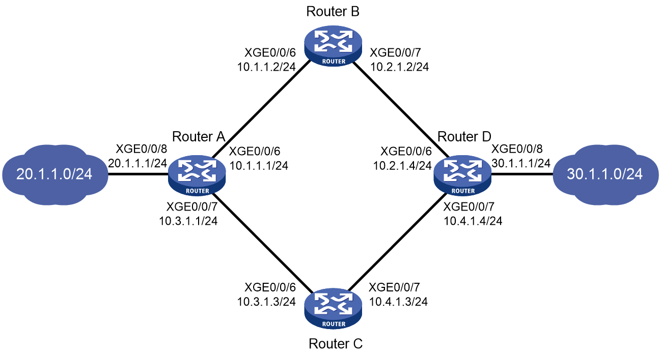

Example: Configuring static routing-Track-NQA collaboration
As shown in Figure 5:
·     Router A is the default gateway of the hosts in network 20.1.1.0/24.
·     Router D is the default gateway of the hosts in network 30.1.1.0/24.
·     Hosts in the two networks communicate with each other through static routes.
To ensure network availability, configure route backup and static routing-Track-NQA collaboration on Router A and Router D as follows:
·     On Router A, assign a higher priority to the static route to 30.1.1.0/24 with next hop Router B. This route is the master route. The static route to 30.1.1.0/24 with the next hop Router C acts as the backup route. When the master route is unavailable, the backup route takes effect.
·     On Router D, assign a higher priority to the static route to 20.1.1.0/24 with next hop Router B. This route is the master route. The static route to 20.1.1.0/24 with next hop Router C acts as the backup route. When the master route is unavailable, the backup route takes effect.
Figure 5 Network diagram
1.     Configure the IP address of each interface, as shown in Figure 5. (Details not shown.)

# Display information about the track entry on Router A.
[RouterA] display track all
Track ID: 1
  State: Positive
  Duration: 0 days 0 hours 0 minutes 32 seconds
  Notification delay: Positive 0, Negative 0 (in seconds)
  Tracked object:
    NQA entry: admin test
    Reaction: 1
    Remote IP/URL: 10.2.1.4
    Local IP:--
    Interface:--
The output shows that the status of the track entry is Positive, indicating that the NQA operation has succeeded and the master route is available.
# Display the routing table of Router A.
[RouterA] display ip routing-table
Destinations : 10       Routes : 10
10.1.1.0/24         Direct 0    0            10.1.1.1        XGE0/0/6
10.1.1.1/32         Direct 0    0            127.0.0.1       InLoop0
10.2.1.0/24         Static 60   0            10.1.1.2        XGE0/0/6
10.3.1.0/24         Direct 0    0            10.3.1.1        XGE0/0/7
10.3.1.1/32         Direct 0    0            127.0.0.1       InLoop0
20.1.1.0/24         Direct 0    0            20.1.1.1        XGE0/0/8
20.1.1.1/32         Direct 0    0            127.0.0.1       InLoop0
30.1.1.0/24         Static 60   0            10.1.1.2        XGE0/0/6
127.0.0.0/8         Direct 0    0            127.0.0.1       InLoop0
127.0.0.1/32        Direct 0    0            127.0.0.1       InLoop0
The output shows that Router A forwards packets to 30.1.1.0/24 through Router B.
# Remove the IP address of Ten-GigabitEthernet 0/0/6 on Router B.
<RouterB> system-view
[RouterB] interface ten-gigabitethernet 0/0/6
[RouterB-Ten-GigabitEthernet0/0/6] undo ip address
Track ID: 1
  State: Negative
  Tracked object:
    Reaction: 1
    Local IP:--
    Interface:--
The output shows that the status of the track entry is Negative, indicating that the NQA operation has failed and the master route is unavailable.
30.1.1.0/24         Static 80   0            10.3.1.3        XGE0/0/7
The output shows that Router A forwards packets to 30.1.1.0/24 through Router C. The backup static route has taken effect.
# Verify that hosts in 20.1.1.0/24 can communicate with the hosts in 30.1.1.0/24 when the master route fails.
[RouterA] ping -a 20.1.1.1 30.1.1.1
Ping 30.1.1.1: 56  data bytes, press CTRL_C to break
Reply from 30.1.1.1: bytes=56 Sequence=1 ttl=254 time=2 ms
Reply from 30.1.1.1: bytes=56 Sequence=2 ttl=254 time=1 ms
Reply from 30.1.1.1: bytes=56 Sequence=3 ttl=254 time=1 ms
Reply from 30.1.1.1: bytes=56 Sequence=4 ttl=254 time=2 ms
Reply from 30.1.1.1: bytes=56 Sequence=5 ttl=254 time=1 ms
--- Ping statistics for 30.1.1.1 ---
5 packet(s) transmitted, 5 packet(s) received, 0.00% packet loss
round-trip min/avg/max/std-dev = 1/1/2/1 ms
# Verify that the hosts in 30.1.1.0/24 can communicate with the hosts in 20.1.1.0/24 when the master route fails.
[RouterD] ping -a 30.1.1.1 20.1.1.1
Ping 20.1.1.1: 56  data bytes, press CTRL_C to break
Reply from 20.1.1.1: bytes=56 Sequence=1 ttl=254 time=2 ms
Reply from 20.1.1.1: bytes=56 Sequence=2 ttl=254 time=1 ms
Reply from 20.1.1.1: bytes=56 Sequence=3 ttl=254 time=1 ms
Reply from 20.1.1.1: bytes=56 Sequence=4 ttl=254 time=1 ms
Reply from 20.1.1.1: bytes=56 Sequence=5 ttl=254 time=1 ms
--- Ping statistics for 20.1.1.1 ---

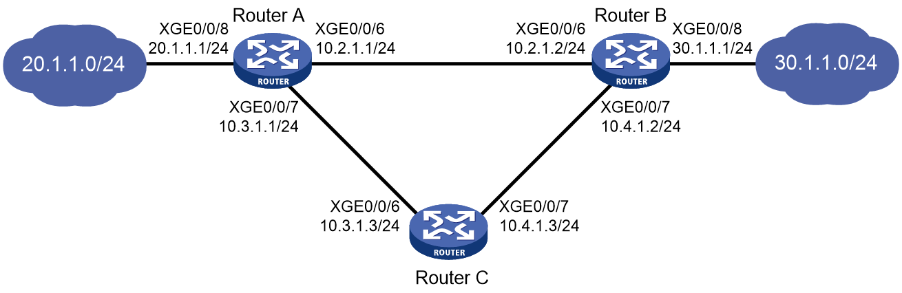

Example: Configuring static routing-Track-BFD collaboration
As shown in Figure 6:
·     Router B is the default gateway of the hosts in network 30.1.1.0/24.
To ensure network availability, configure route backup and static routing-Track-BFD collaboration on Router A and Router B as follows:
·     On Router A, assign a higher priority to the static route to 30.1.1.0/24 with next hop Router B. This route is the master route. The static route to 30.1.1.0/24 with next hop Router C acts as the backup route. When the master route is unavailable, BFD can quickly detect the route failure to make the backup route take effect.
·     On Router B, assign a higher priority to the static route to 20.1.1.0/24 with next hop Router A. This route is the master route. The static route to 20.1.1.0/24 with next hop Router C acts as the backup route. When the master route is unavailable, BFD can quickly detect the route failure to make the backup route take effect.
Figure 6 Network diagram
1.     Configure the IP address of each interface, as shown in Figure 6. (Details not shown.)
2.     Configure Router A:
# Configure a static route to 30.1.1.0/24 with next hop 10.2.1.2 and the default priority (60). Associate this static route with track entry 1.
<RouterA> system-view
[RouterA] ip route-static 30.1.1.0 24 10.2.1.2 track 1
# Configure a static route to 30.1.1.0/24 with next hop 10.3.1.3 and priority 80.
[RouterA] ip route-static 30.1.1.0 24 10.3.1.3 preference 80
# Specify 10.10.10.10 as the source address of BFD echo packets.
[RouterA] bfd echo-source-ip 10.10.10.10
# Configure track entry 1, and associate it with the BFD session to verify the connectivity between Router A and Router B.
[RouterA] track 1 bfd echo interface ten-gigabitethernet 0/0/6 remote ip 10.2.1.2 local ip 10.2.1.1
3.     Configure Router B:
# Configure a static route to 20.1.1.0/24 with next hop 10.2.1.1 and default priority (60). Associate this static route with track entry 1.
[RouterB] ip route-static 20.1.1.0 24 10.2.1.1 track 1
# Configure a static route to 20.1.1.0/24 with next hop 10.4.1.3 and the priority 80.
[RouterB] ip route-static 20.1.1.0 24 10.4.1.3 preference 80
# Specify 1.1.1.1 as the source address of BFD echo packets.
[RouterB] bfd echo-source-ip 1.1.1.1
# Configure track entry 1, and associate it with the BFD session to verify the connectivity between Router B and Router A.
[RouterB] track 1 bfd echo interface ten-gigabitethernet 0/0/6 remote ip 10.2.1.1 local ip 10.2.1.2
4.     Configure Router C:
# Configure a static route to 30.1.1.0/24 with next hop 10.4.1.2.
<RouterC> system-view
[RouterC] ip route-static 30.1.1.0 24 10.4.1.2
# Configure a static route to 20.1.1.0/24 with next hop 10.3.1.1.
[RouterB] ip route-static 20.1.1.0 24 10.3.1.1
Track ID: 1
  State: Positive
  Tracked object type: BFD
  Tracked object:
    BFD session mode: Echo
    Outgoing interface: Ten-GigabitEthernet0/0/6
    VPN instance name: --
    Remote IP: 10.2.1.2
    Local IP: 10.2.1.1
The output shows that the status of the track entry is Positive, indicating that next hop 10.2.1.2 is reachable.
Destinations : 9        Routes : 9
10.2.1.0/24         Direct 0    0            10.2.1.1        XGE0/0/6
10.2.1.1/32         Direct 0    0            127.0.0.1       InLoop0
30.1.1.0/24         Static 60   0            10.2.1.2        XGE0/0/6
The output shows that Router A forwards packets to 30.1.1.0/24 through Router B. The master static route has taken effect.
Track ID: 1
  State: Negative
  Tracked object:
    Remote IP: 10.2.1.2
    Local IP: 10.2.1.1
The output shows that the status of the track entry is Negative, indicating that next hop 10.2.1.2 is unreachable.
# Verify that the hosts in 20.1.1.0/24 can communicate with the hosts in 30.1.1.0/24 when the master route fails.
[RouterB] ping -a 30.1.1.1 20.1.1.1
