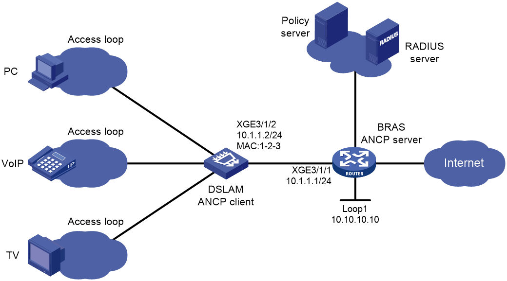

As shown in Figure 1, the ANCP client runs on a DSLAM (an AN), and the ANCP server runs on a BRAS (an H3C device). Access loops are digital subscriber lines (DSLs).
Figure 1 ANCP network diagram
ANCP works between the DSLAM and the BRAS as follows:

As shown in Figure 2, users access the network through IPoE or PPPoE. The RADIUS server performs user authentication and accounting.
Configure ANCP to achieve the following purposes:
·     The BRAS can dynamically discover DSLs on the DSLAM.
·     The BRAS can configure DSLs.
·     The BRAS can perform OAM tests on DSLs.
Figure 2 Network diagram
