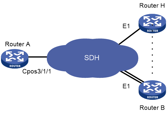

CPOS interface application scenarios
CPOS E1 interfaces are typically used to aggregate E1 lines, as shown in Figure 1.
In actual applications, the connection between low-end devices and the CPOS interfaces might span more than one transmission network and might require relay.
Figure 1 CPOS E1 interface application scenario

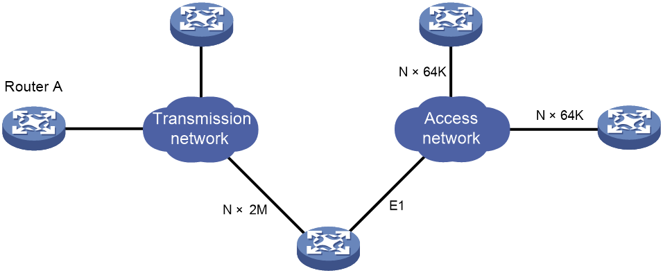

CPOS interface configuration examples
Example: Configuring CPOS-E1 channels
As shown in Figure 2, branch nodes Router B through Router H are uplinked to the central node Router A through E1 links. Router A aggregates these E1 links by using a CPOS interface.
Add one additional E1 link on Router B to expand its capacity, and use an MP-group interface to bind the two E1 links.
Figure 2 Network diagram
For correct network synchronization, make sure the master clock mode is configured on the SONET/SDH devices connected to the routers.
1.     Configure Router A:
# Configure E1 channels 1 and 2 of CPOS 2/2/1 to operate in unframed mode.
<RouterA> system-view
[RouterA] controller cpos 3/1/1
[RouterA-Cpos 3/1/1] e1 1 unframed
[RouterA-Cpos 3/1/1] e1 2 unframed
# Create MP-group 3/1/1 and assign an IP address to it.
[RouterA] interface mp-group 3/1/1
[RouterA-Mp-group3/1/1] ip address 10.1.1.1 24
[RouterA-Mp-group3/1/1] quit
# Assign Serial 3/1/1/1:0 to MP-group 2/2/1.
[RouterA] interface serial3/1/1/1:0
[RouterA-Serial3/1/1/1:0] ppp mp mp-group 3/1/1
[RouterA-Serial3/1/1/1:0] quit
# Assign Serial 3/1/1/2:0 to MP-group 2/2/1.
[RouterA] interface serial3/1/1/2:0
[RouterA-Serial3/1/1/2:0] ppp mp mp-group 3/1/1
[RouterA-Serial3/1/1/2:0] quit
2.     Configure Router B:
# Configure E1 3/1/1 to operate in E1 mode.
<RouterB> system-view
[RouterB] controller e1 3/1/1
[RouterB-E1 3/1/1] using e1
[RouterB-E1 3/1/1] quit
# Configure E1 3/1/2 to operate in E1 mode.
[RouterB] controller e1 3/1/2
[RouterB-E1 3/1/2] using e1
[RouterB-E1 3/1/2] quit
[RouterB] interface mp-group 3/1/1
[RouterB-Mp-group3/1/1] ip address 10.1.1.2 24
[RouterB-Mp-group3/1/1] quit
# Assign Serial 3/1/1:0 to MP-group 2/4/1.
[RouterB] interface serial3/1/1:0
[RouterB-Serial3/1/1:0] ppp mp mp-group 3/1/1
[RouterB-Serial3/1/1:0] quit
# Assign Serial 3/1/2:0 to MP-group 2/4/1.
[RouterB] interface serial3/1/2:0
[RouterB-Serial3/1/2:0] ppp mp mp-group 3/1/1
[RouterB-Serial3/1/2:0] quit
# Execute the display interface serial 3/1/1:0, display interface mp-group 3/1/1, and display ppp mp commands to view the connectivity state.
# Verify that the routers can ping one another. (Details not shown.)
