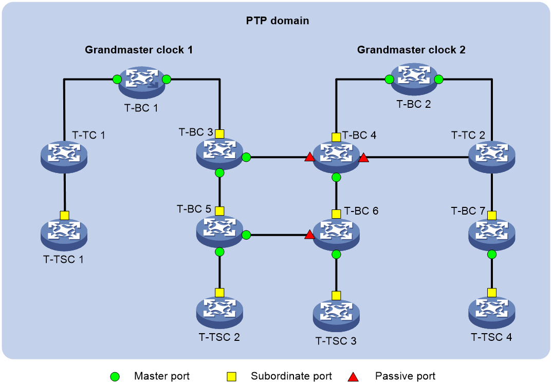

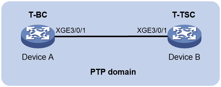

Clock node and PTP port (ITU-T G.8275.1)
A node in a PTP domain is a clock node. A port enabled with PTP is a PTP port.
ITU-T G.8275.1 defines the following types of basic clock nodes:
·     Telecom boundary clock (T-BC)—A clock node with more than one PTP port in a PTP domain for time synchronization. It uses one of the ports to synchronize time to its upstream clock node and uses the other ports to distribute time to the downstream clock nodes. If a T-BC operates as the clock source, it distributes time through multiple PTP ports to its downstream clock nodes.
·     Telecom transparent Clock (T-TC)—A clock code that forwards non-P2P PTP messages in the network. The forwarding duration will be included in calculation of the entire link delay.
·     Telecom time slave clock (T-TSC) —An OC clock node (as defined in IEEE 1588 version 2 and IEEE 802.1AS) that can act only as a member clock.
Figure 1 shows the positions of these basic clock nodes in a PTP domain.
Figure 2 Clock nodes and PTP ports in a PTP domain (ITU-T G.8275.1)
Clock nodes and PTP ports (ITU-T G.8275.2)
ITU-T G.8275.2 defines the following types of basic clock nodes:
·     Partial-support telecom boundary clock (T-BC-P)—A clock node with more than one PTP port in a PTP domain for time synchronization. It uses one of the ports to synchronize time to its upstream clock node and uses the other ports to distribute time to the downstream clock nodes. When a T-BC-P clock node is a clock source, it distributes time through multiple PTP ports to its downstream clock nodes.
·     Partial-support telecom time slave clock (T-TSC-P)—A clock node with a single PTP port in a PTP domain for time synchronization. It synchronizes time from its upstream clock node through the port. It can operate only as a member clock.
Figure 3 shows the positions of these basic clock nodes in a PTP domain.
Figure 3 Clock nodes and PTP ports in a PTP domain (ITU-T G.8275.2)

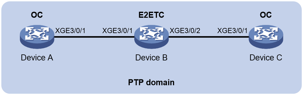

Example: Configuring PTP (IEEE 1588 version 2, IEEE 802.3/Ethernet transport, multicast transmission)
As shown in Figure 6, configure PTP (IEEE 1588 version 2, IEEE 802.3/Ethernet transport, multicast transmission) to enable time synchronization between Device A and Device C.
·     Specify the IEEE 1588 version 2 PTP profile and multicast IEEE 802.3/Ethernet transport of PTP messages for Device A, Device B, and Device C.
·     Assign Device A, Device B, and Device C to the same PTP domain. Specify the OC clock node type for Device A and Device C, and E2ETC clock node type for Device B. All clock nodes elect a GM through BMC in the PTP domain.
·     Use the default Request_Response delay measurement mechanism on Device A and Device C.
Figure 6 Network diagram
1.     Configure Device A:
# Specify the IEEE 1588 version 2 PTP profile.
<DeviceA> system-view
[DeviceA] ptp profile 1588v2
# Specify the OC clock node type.
[DeviceA] ptp mode oc
# Specify PTP for obtaining the time on the default MDC.
[DeviceA] clock protocol ptp mdc 1
# Enable PTP on Ten-GigabitEthernet 3/0/1.
[DeviceA] interface ten-gigabitethernet 3/0/1
[DeviceA-Ten-GigabitEthernet3/0/1] ptp enable
[DeviceA-Ten-GigabitEthernet3/0/1] quit
2.     Configure Device B:
<DeviceB> system-view
[DeviceB] ptp profile 1588v2
# Specify the E2ETC clock node type.
[DeviceB] ptp mode e2etc
[DeviceB] clock protocol ptp mdc 1
[DeviceB] interface ten-gigabitethernet 3/0/1
[DeviceB-Ten-GigabitEthernet3/0/1] ptp enable
[DeviceB-Ten-GigabitEthernet3/0/1] quit
# Enable PTP on Ten-GigabitEthernet 3/0/2.
[DeviceB] interface ten-gigabitethernet 3/0/2
[DeviceB-Ten-GigabitEthernet3/0/2] ptp enable
[DeviceB-Ten-GigabitEthernet3/0/2] quit
3.     Configure Device C:
<DeviceC> system-view
[DeviceC] ptp profile 1588v2
[DeviceC] ptp mode oc
[DeviceC] clock protocol ptp mdc 1
[DeviceC] interface ten-gigabitethernet 3/0/1
[DeviceC-Ten-GigabitEthernet3/0/1] ptp enable
[DeviceC-Ten-GigabitEthernet3/0/1] quit
When the network is stable, perform the following tasks:
·     Use the display ptp clock command to display PTP clock information.
·     Use the display ptp interface brief command to display brief PTP running information for all PTP interfaces.
# Display PTP clock information on Device A.
[DeviceA] display ptp clock
PTP profile         : IEEE 1588 Version 2
PTP mode            : OC
Slave only          : No
Sync uncertain      : Disabled
Clock state         : Disabled
Lock status         : Unlocked
Clock ID            : 000FE2-FFFE-FF0000
Clock type          : Local
Clock domain        : 0
Number of PTP ports : 1
Priority1     : 128
Priority2     : 128
Clock quality :
 Class                 : 248
 Accuracy              : 254
 Offset (log variance) : 65535
Offset from master : 0 (ns)
Mean path delay    : 0 (ns)
Steps removed      : 0
Local clock time   : Sun Jan 15 20:57:29 2019
Clock source info:
 Clock   Pri1 Pri2 Accuracy Class TimeSrc Direction In-Status Offset(log variance)
 Local   128  128  254      248   160     N/A       N/A       65535
 ToD0    128  128  32       6     32      In        Inactive  65535
 ToD1    128  128  32       6     32      N/A       Inactive  65535
# Display brief PTP running information for all PTP interfaces on Device A.
[DeviceA] display ptp interface brief
Name         State         Delay mechanism  Clock step  Asymmetry correction
XGE3/0/1     Master        E2E              Two         0
# Display PTP clock information on Device B.
[DeviceB] display ptp clock
PTP mode            : E2ETC
Slave only          : No
Clock ID            : 000FE2-FFFE-FF0001
Clock type          : Local
Clock domain        : 0
Number of PTP ports : 2
Priority1     : 128
Priority2     : 128
Clock quality :
 Class                 : 248
 Accuracy              : 254
Offset from master : N/A
Mean path delay    : N/A
Steps removed      : N/A
Clock source info:
# Display brief PTP running information for all PTP interfaces on Device B.
[DeviceB] display ptp interface brief
XGE3/0/1     N/A           E2E              Two         0
XGE3/0/2     N/A           E2E              Two         0
The output shows that Device A is elected as the GM, and Ten-GigabitEthernet3/0/1 on Device A is the master port.

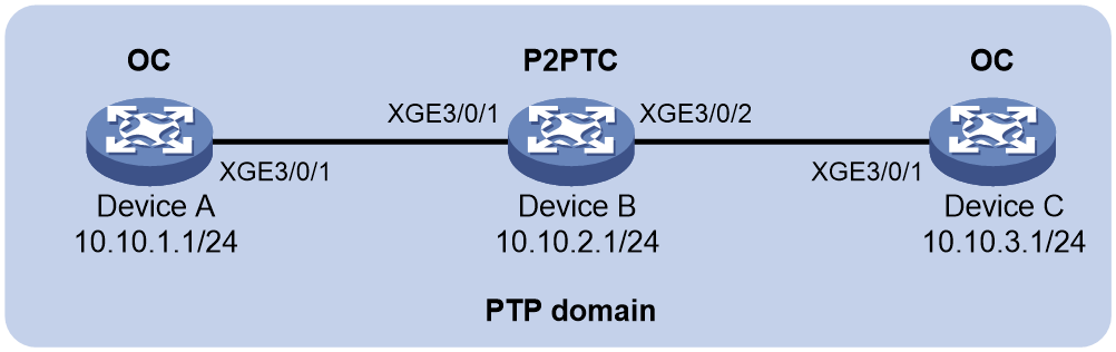

Example: Configuring PTP (IEEE 1588 version 2, IPv4 UDP transport, multicast transmission)
As shown In Figure 7, configure PTP (IEEE 1588 version 2, IPv4 UDP transport, multicast transmission) to enable time synchronization between the devices.
·     Specify the IEEE 1588 version 2 PTP profile and multicast IPv4 UDP transport of PTP messages for Device A, Device B, and Device C.
·     Assign Device A, Device B, and Device C to the same PTP domain. Specify the OC clock node type for Device A and Device C, and P2PTC clock node type for Device B. All clock nodes elect a GM through BMC in the PTP domain.
·     Specify the peer delay measurement mechanism (p2p) for Device A and Device C.
Figure 7 Network diagram
# Configure the source IP address for multicast PTP messages transmitted over IPv4 UDP.
[DeviceA] ptp source 10.10.1.1
# On Ten-GigabitEthernet 3/0/1, specify the IPv4 UDP transport protocol for PTP messages and the peer delay measurement mechanism, and enable PTP.
[DeviceA-Ten-GigabitEthernet3/0/1] ptp transport-protocol udp
[DeviceA-Ten-GigabitEthernet3/0/1] ptp delay-mechanism p2p
# Specify the P2PTC clock node type.
[DeviceB] ptp mode p2ptc
[DeviceB] ptp source 10.10.2.1
# On Ten-GigabitEthernet 3/0/1, specify the IPv4 UDP transport protocol for PTP messages and enable PTP.
[DeviceB-Ten-GigabitEthernet3/0/1] ptp transport-protocol udp
# On Ten-GigabitEthernet 3/0/2, specify the IPv4 UDP transport protocol for PTP messages and enable PTP.
[DeviceB-Ten-GigabitEthernet3/0/2] ptp transport-protocol udp
[DeviceC] ptp source 10.10.3.1
[DeviceC-Ten-GigabitEthernet3/0/1] ptp transport-protocol udp
[DeviceC-Ten-GigabitEthernet3/0/1] ptp delay-mechanism p2p
When the network is stable, perform the following tasks on Device A and Device B.
PTP mode            : OC
Slave only          : No
Clock type          : Local
Clock domain        : 0
Priority1     : 128
Priority2     : 128
Clock quality :
 Class                 : 248
 Accuracy              : 254
Steps removed      : 0
Clock source info:
XGE3/0/1     Master        P2P              Two         0
PTP mode            : P2PTC
Slave only          : No
Clock type          : Local
Clock domain        : 0
Priority1     : 128
Priority2     : 128
Clock quality :
 Class                 : 248
 Accuracy              : 254
Steps removed      : N/A
Clock source info:
XGE3/0/1     N/A           P2P              Two         0
XGE3/0/2     N/A           P2P              Two         0

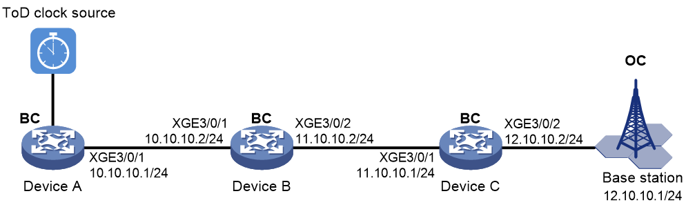

Example: Configuring PTP (IEEE 1588 version 2, IPv4 UDP transport, unicast transmission)
As shown in Figure 8, configure PTP (IEEE 1588 version 2, IPv4 UDP transport, unicast transmission) to enable Device A, Device B, Device C, and the base station to synchronize the time with the ToD clock source.
·     Specify the IEEE 1588 version 2 PTP profile and unicast IPv4 UDP transport of PTP messages for Device A, Device B, and Device C.
·     Assign Device A, Device B, Device C, and the base station to PTP domain 0. Specify the BC clock node type for Device A, Device B, and Device C.
·     Connect Device A to the ToD clock source and Device C to the base station.
·     Use the default Request_Response delay measurement mechanism on all clock nodes in the PTP domain.
Figure 8 Network diagram
1.     Assign IP addresses to the interfaces, and make sure the devices can reach each other, as shown in Figure 8. (Details not shown.)
2.     Configure Device A:
# Specify the BC clock node type.
[DeviceA] ptp mode bc
# Configure the device to receive ToD clock signals and set the delay time correction value to 1000 nanoseconds.
[DeviceA] ptp tod0 input delay 1000
# Set priority 1 to 0 for the ToD 0 clock.
[DeviceA] ptp priority clock-source tod0 priority1 0
# On Ten-GigabitEthernet 3/0/1, configure the destination IP address for unicast PTP messages transmitted over IPv4 UDP, and enable PTP.
[DeviceA-Ten-GigabitEthernet3/0/1] ptp unicast-destination 10.10.10.2
3.     Configure Device B:
[DeviceB] ptp mode bc
[DeviceB-Ten-GigabitEthernet3/0/1] ptp unicast-destination 10.10.10.1
# On Ten-GigabitEthernet 3/0/2, configure the destination IP address for unicast PTP messages transmitted over IPv4 UDP, and enable PTP.
[DeviceB-Ten-GigabitEthernet3/0/2] ptp unicast-destination 11.10.10.1

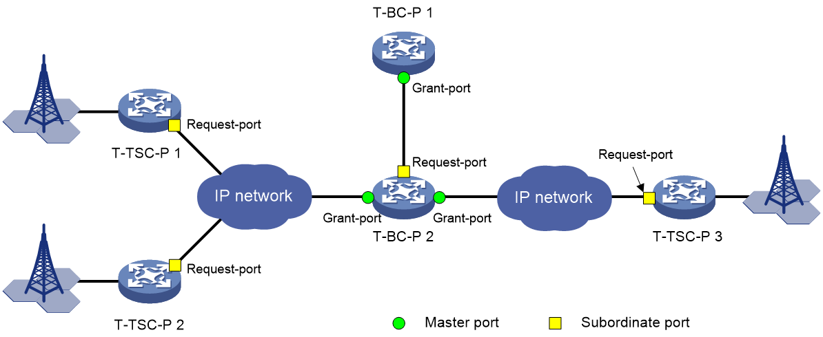

4.     Configure Device C:
[DeviceC] ptp mode bc
# Configure ToD 1to output ToD clock signals and set the transmit delay time correction value to 100 nanoseconds.
[DeviceC] ptp tod1output delay 100
[DeviceC-Ten-GigabitEthernet3/0/1] ptp unicast-destination 11.10.10.2
# On Ten-GigabitEthernet3/0/2, specify IPv4 UDP transport of PTP messages, configure the destination IP address for unicast PTP messages, and enable PTP.
[DeviceC] interface ten-gigabitethernet 3/0/2
[DeviceC-Ten-GigabitEthernet3/0/2] ptp transport-protocol udp
[DeviceC-Ten-GigabitEthernet3/0/2] ptp unicast-destination 12.10.10.1
[DeviceC-Ten-GigabitEthernet3/0/2] ptp enable
[DeviceC-Ten-GigabitEthernet3/0/2] quit
5.     Configure the base station.
# Specify PTP domain 0.
# Specify IPv4 UDP transport of PTP messages.
# Set the destination IP address of unicast PTP messages to 12.10.10.2.
# Specify the Request_Response delay measurement mechanism.
For more information, see the configuration guide for the base station.

Example: Configuring PTP (ITU-T G.8275.1, IEEE 802.3/Ethernet transport, multicast transmission)
As shown in Figure 9, configure PTP (ITU-T G.8275.1, IEEE 802.3/Ethernet transport, multicast transmission) to enable Device A to synchronize Device B.
·     Specify the ITU-T G.8275.1 PTP profile for Device A and Device B.
·     Assign Device A and Device B to the same PTP domain. Specify the T-BC clock node type for Device A and T-TSC clock node type for Device B.
·     Use the default Request_Response delay measurement mechanism on Device A and Device B.
Figure 9 Network diagram
IMPORTANT
IMPORTANT:
The ITU-T G.8275.1 PTP profile transports PTP messages over IEEE 802.3/Ethernet rather than IPv4 UDP and in multicast rather than unicast mode.
# Specify the ITU-T G.8275.1 PTP profile.
[DeviceA] ptp profile g8275.1
# Specify the T-BC clock node type.
[DeviceA] ptp mode t-bc
[DeviceB] ptp profile g8275.1
# Specify the T-TSC clock node type.
[DeviceB] ptp mode t-tsc

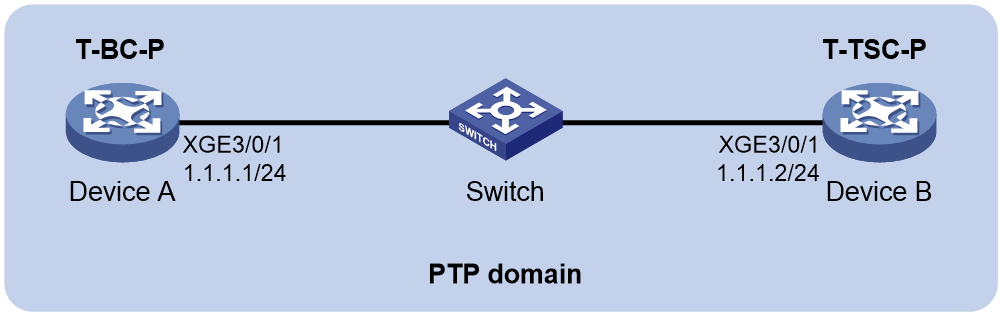

Example: Configuring PTP (ITU-T G.8275.2, IPv4 UDP encapsulation, unicast transmission)
As shown in Figure 10, Device A and Device B are in a PTP domain. The switch is a Layer 2 switch that does not support PTP. Configure PTP (ITU-TG.8275.2, IPv4 UDP encapsulation, unicast transmission) to enable Device B to synchronize to Device A.
·     Specify the ITU-TG.8275.2 PTP profile for Device A and Device B.
Figure 10 Network diagram
Configure IP addresses and routing protocols for the devices. Make sure the devices are reachable to each other.
IMPORTANT
IMPORTANT:
The ITU-T G.8275.2 PTP profile transports PTP messages over IPv4 UDP rather than IEEE 802.3/Ethernet and in unicast rather than multicast mode.
# Specify the ITU-T G.8275.2 PTP profile.
[DeviceA] ptp profile g8275.2
# Specify the T-BC-P clock node type.
[DeviceA] ptp mode t-bc-p
# Enable PTP and configure PTP parameters on Ten-GigabitEthernet 3/0/1.
[DeviceA-Ten-GigabitEthernet3/0/1] ptp unicast-destination 1.1.1.2
[DeviceA-Ten-GigabitEthernet3/0/1] ptp unicast-negotiate grant-port
[DeviceA-Ten-GigabitEthernet3/0/1] ptp notslave disable
[DeviceB] ptp profile g8275.2
# Specify the T-TSC-P clock node type.
[DeviceB] ptp mode t-tsc-p
[DeviceB-Ten-GigabitEthernet3/0/1] ptp unicast-destination 1.1.1.1
[DeviceB-Ten-GigabitEthernet3/0/1] ptp unicast-negotiate request-port

# Display brief PTP running information on Device B.
GE1/0/2      Slave         E2E              Two         0
The output shows that Device A has been elected as the GM, and Ten-GigabitEthernet 3/0/1 on Device A is the master port.
