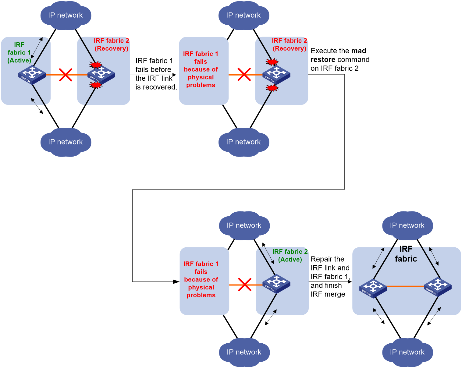

Multi-active handling procedure· 8
MAD mechanisms· 10

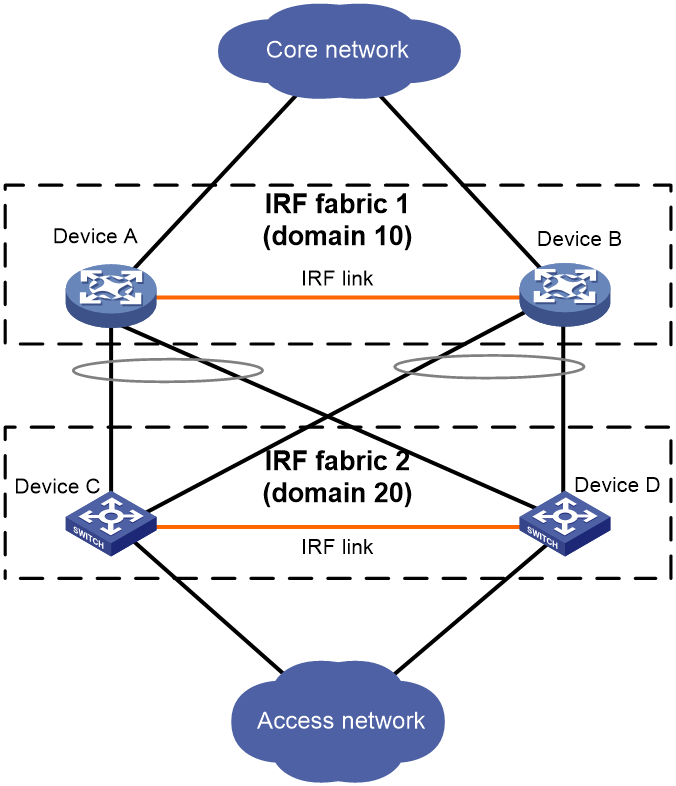

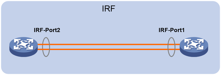

Figure 1 shows an IRF fabric that has two devices, which appear as a single node to the upper-layer and lower-layer devices.
Figure 1 IRF application scenario

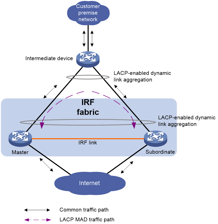

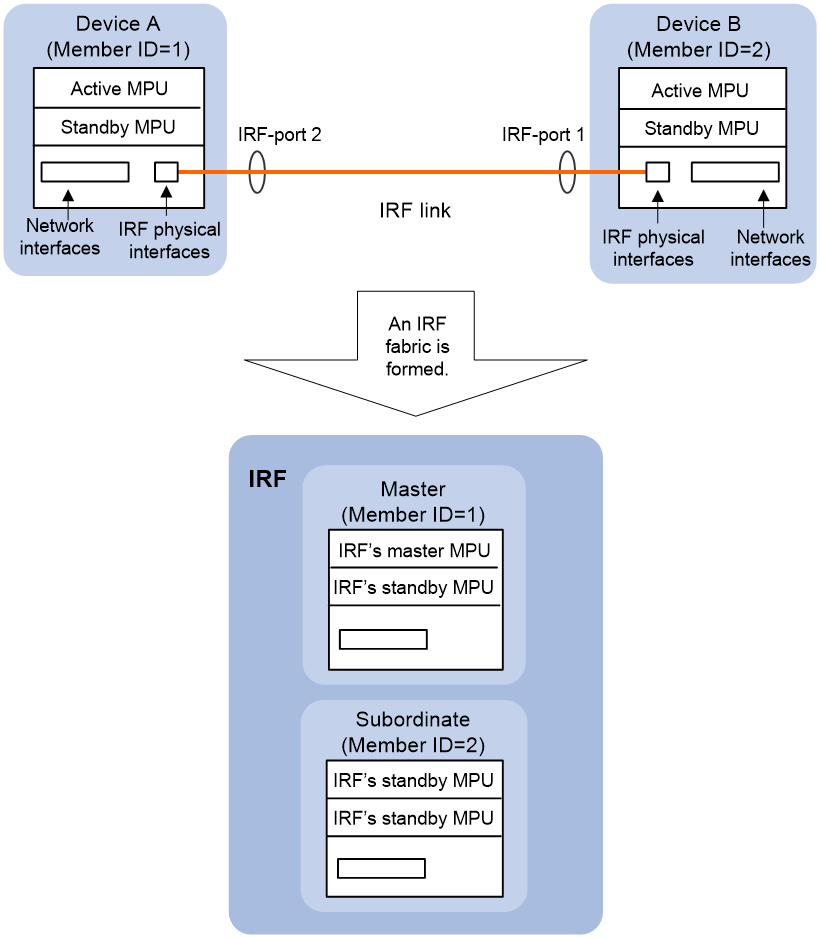

As shown in Figure 2, Device A and Device B form a two-chassis IRF fabric. The fabric has four MPUs (one active and three standbys), and two times the number of interface modules that a single device provides. The IRF fabric manages the physical and software resources of Device A and Device B in a centralized manner.
Figure 2 Two-chassis IRF fabric implementation schematic diagram

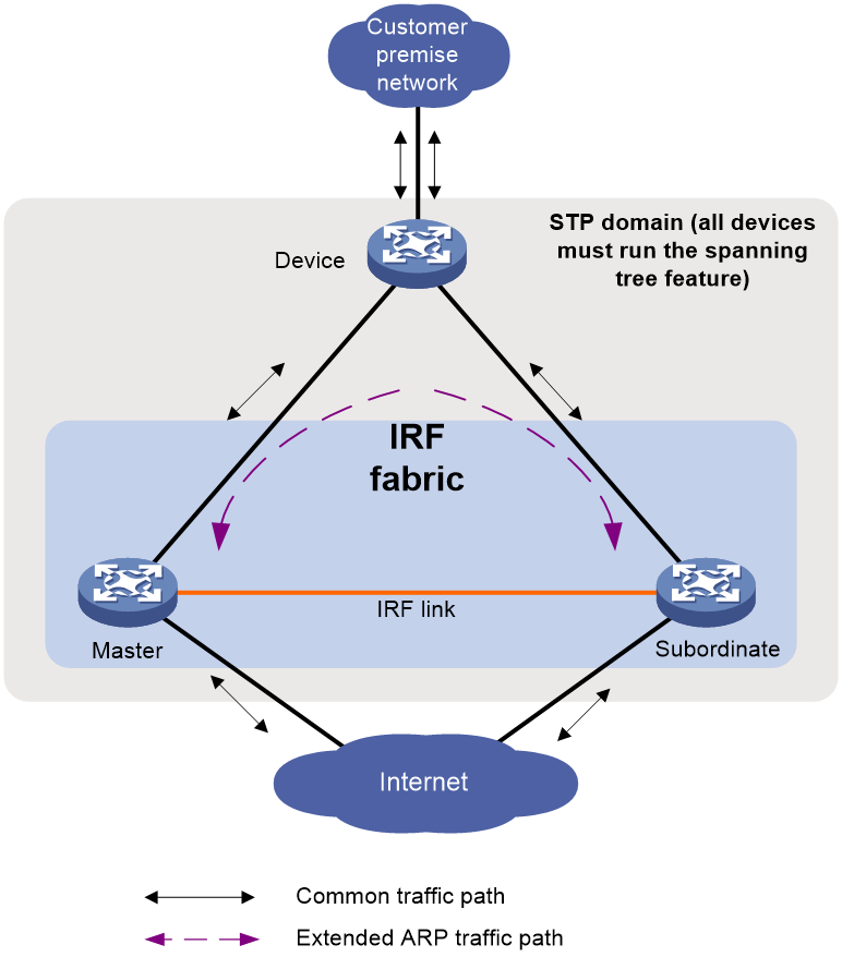

·     IRF link aggregation—You can assign several physical links between neighboring members to their IRF ports to create a load-balanced aggregate IRF connection with redundancy.
·     Multichassis link aggregation—You can use the Ethernet link aggregation feature to aggregate the physical links between the IRF fabric and its upstream or downstream devices across the IRF members.

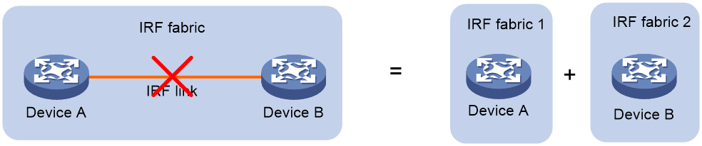

IRF split

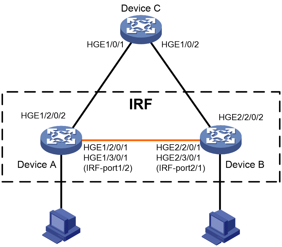

IRF split occurs when an IRF fabric breaks up into multiple IRF fabrics because of IRF link failures, as shown in Figure 3. The split IRF fabrics operate with the same IP address. IRF split causes routing and forwarding problems on the network. To quickly detect a multi-active collision, configure a minimum of one MAD mechanism (see "Configuring MAD").
Figure 3 IRF split

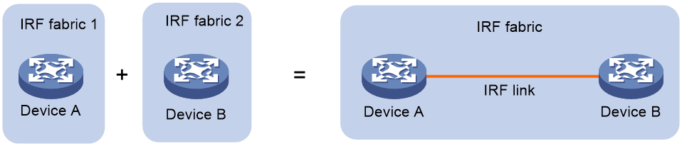

IRF merge occurs when two split IRF fabrics reunite or when two independent IRF fabrics are united, as shown in Figure 4.
Figure 4 IRF merge

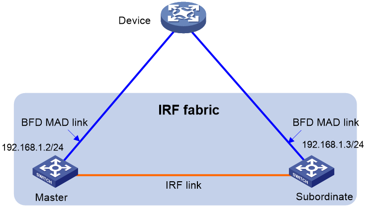

MAD
An IRF link failure causes an IRF fabric to split in two IRF fabrics operating with the same Layer 3 settings, including the same IP address. To avoid IP address collision and network problems, IRF uses multi-active detection (MAD) mechanisms to detect the presence of multiple identical IRF fabrics, handle collisions, and recover from faults.

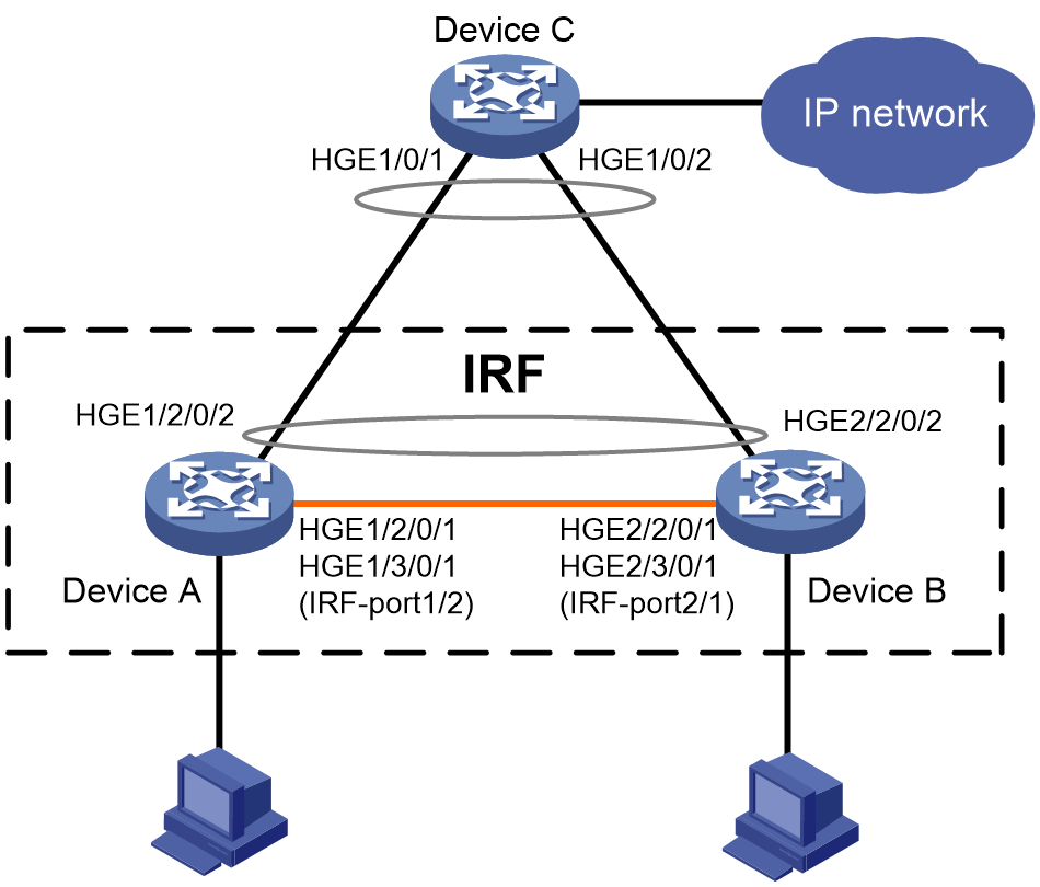

One IRF fabric forms one IRF domain. IRF uses IRF domain IDs to uniquely identify IRF fabrics and prevent IRF fabrics from interfering with one another.
As shown in Figure 5, IRF fabric 1 contains Device A and Device B, and IRF fabric 2 contains Device C and Device D. Both fabrics use the LACP aggregate links between them for MAD. When a member device receives an extended LACPDU for MAD, it checks the domain ID to determine whether the packet is from the local IRF fabric. Then, the member device can handle the packet correctly.
Figure 5 A network that contains two IRF domains

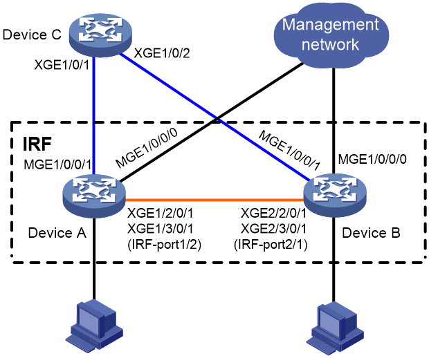

The device supports only two-chassis IRF fabrics in daisy-chain topology, as shown in Figure 6.
Figure 6 Daisy-chain topology
The multi-active handling procedure includes detection, collision handling, and failure recovery.
Detection
IRF provides MAD mechanisms by extending LACP, BFD, ARP, and IPv6 ND to detect multi-active collisions. As a best practice, configure a minimum of one MAD mechanism on an IRF fabric. For more information about the MAD mechanisms and their application scenarios, see "MAD mechanisms."
For information about LACP, see Ethernet link aggregation in Layer 2—LAN Switching Configuration Guide. For information about BFD, see High Availability Configuration Guide. For information about ARP, see Layer 3—IP Services Configuration Guide. For information about ND, see IPv6 basics in Layer 3—IP Services Configuration Guide.
Collision handling
When detecting a multi-active collision, MAD disables all IRF fabrics except one from forwarding data traffic by placing them in Recovery state. The IRF fabrics placed in Recovery state are called inactive IRF fabrics. The IRF fabric that continues to forward traffic is called the active IRF fabric.
BFD MAD and LACP MAD use the following process to handle a multi-active collision:
1.     Compare the health states of split fabrics.‍ To view their health states, use the display system health command. For more information about this command, see device management in Fundamentals Command Reference.
2.     Set all fabrics to the Recovery state except the healthiest one.
3.     Compare the number of members in each fabric if all IRF fabrics are in the same health state.
4.     Set all fabrics to the Recovery state except the one that has the most members.
5.     Compare the member IDs of their masters if all IRF fabrics have the same number of members.
6.     Set all fabrics to the Recovery state except the one that has the lowest numbered master.
7.     Shut down all common network interfaces in the Recovery-state fabrics except for the following interfaces:

Failure recovery
To merge two split IRF fabrics, first repair the failed IRF link and remove the IRF link failure.
After the failed IRF link between two split IRF fabrics is recovered, log in to the inactive IRF fabric to reboot its member devices if the system requires you to do so. After these member devices join the active IRF fabric as subordinate devices, the IRF merge is complete, as shown in Figure 7. The network interfaces that have been shut down by MAD automatically restore their original state.
CAUTION
CAUTION:
If you inadvertently reboot the active IRF fabric after the failed IRF link recovers, its member devices will join the inactive IRF fabric with their network interfaces being shut down by MAD. To restore the original states of the network interfaces in the merged IRF fabric, use the mad restore command.
If the IRF auto-merge feature is enabled, the inactive IRF member devices will automatically reboot after the failed IRF link recovers and a manual reboot is typically not required.
Figure 7 Recovering the IRF fabric
If the active IRF fabric fails before the IRF link is recovered (see Figure 8), use the mad restore command on the inactive IRF fabric to recover the inactive IRF fabric. This command brings up all network interfaces that were shut down by MAD. After the IRF link is repaired, merge the two parts into a unified IRF fabric.
Figure 8 Active IRF fabric fails before the IRF link is recovered

LACP MAD
·     Detection speed is fast.
·     Runs on existing aggregate links without requiring MAD-dedicated physical links or Layer 3 interfaces.
Requires an intermediate device that supports extended LACP for MAD.
Link aggregation is used between the IRF fabric and its upstream or downstream device.

LACP MAD
As shown in Figure 9, LACP MAD has the following requirements:
·     Every IRF member must have a link with an intermediate device.
·     All the links form a dynamic link aggregation group.
·     The intermediate device must be a device that supports extended LACP for MAD.
The IRF member devices send extended LACPDUs that convey a domain ID and an active ID (the member ID of the master). The intermediate device transparently forwards the extended LACPDUs received from one member device to all the other member devices.
·     If the domain IDs and active IDs sent by all the member devices are the same, the IRF fabric is integrated.
·     If the extended LACPDUs convey the same domain ID but different active IDs, a split has occurred. LACP MAD handles this situation as described in "Collision handling."
Figure 9 LACP MAD scenario

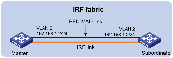

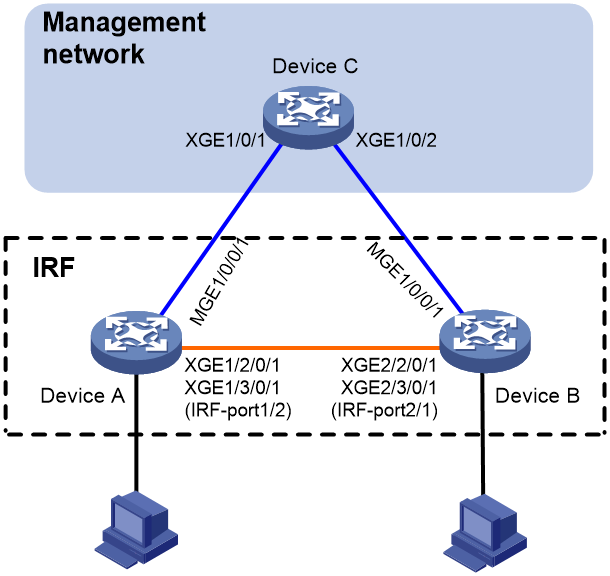

BFD MAD
BFD MAD detects multi-active collisions by using BFD.
You can use common or management Ethernet ports for BFD MAD.
As a best practice, preferentially use management Ethernet ports for BFD MAD. If management Ethernet ports are used, BFD MAD has the following requirements:
·     If no intermediate device is used, you must connect a management Ethernet port on the active MPU of one member device to a management Ethernet port on the active MPU of the other member device.
·     If an intermediate device is used, connect a management Ethernet port on the active MPU of each member device to the intermediate device, as shown in Figure 10. On the intermediate device, assign the ports connected to the management Ethernet ports to the same VLAN.
·     Each member device is assigned a MAD IP address on the master's management Ethernet port.
If common Ethernet ports are used, BFD MAD has the following requirements:
·     If an intermediate device is used, each member device must have a BFD MAD link to the intermediate device. If no intermediate device is used, all member devices must have a BFD MAD link to each other.
·     Assign all ports on the BFD MAD links to the same VLAN or Layer 3 aggregate interface. Assign each member device a MAD IP address on the VLAN interface or Layer 3 aggregate interface.
When you use BFD MAD, follow these restrictions and guidelines:
·     As a best practice, use an intermediate device to connect IRF member devices if the IRF fabric has more than two member devices. A full mesh of IRF members might cause broadcast loops.
·     As a best practice to avoid failure of service modules that provide BFD MAD ports from affecting BFD MAD, preferentially use management Ethernet ports for BFD MAD.
·     The BFD MAD links and BFD MAD VLAN (or Layer 3 aggregate interface) must be dedicated. Do not use the BFD MAD links or BFD MAD VLAN (or Layer 3 aggregate interface) for any other purposes.
·     When you use a Layer 3 aggregate interface for BFD MAD, make sure its member ports do not exceed the maximum number of Selected ports allowed for an aggregation group. If the number of member ports exceeds the maximum number of Selected ports, some member ports cannot become Selected. BFD MAD will be unable to work correctly and its state will change to Faulty. For more information about setting the maximum number of Selected ports for an aggregation group, see Ethernet link aggregation in Layer 2—LAN Switching Configuration Guide.
·     The MAD addresses identify the member devices and must belong to the same subnet.
·     Of all management Ethernet ports on an IRF fabric, only the master's management Ethernet port is accessible.
Figure 10 shows a typical BFD MAD scenario that uses an intermediate device. On the intermediate device, assign the ports on the BFD MAD links to the same VLAN.
Figure 11 shows a typical BFD MAD scenario that does not use an intermediate device.
With BFD MAD, the master attempts to establish BFD sessions with other member devices by using its MAD IP address as the source IP address.
·     If the IRF fabric is integrated, only the MAD IP address of the master takes effect. The master cannot establish a BFD session with any other member. If you execute the display bfd session command, the state of the BFD sessions is Down.
·     When the IRF fabric splits, the IP addresses of the masters in the split IRF fabrics take effect. The masters can establish a BFD session. If you execute the display bfd session command, the state of the BFD session between the two devices is Up.
Figure 10 BFD MAD scenario with an intermediate device
Figure 11 BFD MAD scenario without an intermediate device
ARP MAD
ARP MAD detects multi-active collisions by using extended ARP packets that convey the IRF domain ID and the active ID.
You can use common or management Ethernet ports for ARP MAD.
If management Ethernet ports are used, ARP MAD must work with an intermediate device. Make sure the following requirements are met:
·     Connect a management Ethernet port on each member device to the intermediate device.
·     On the intermediate device, you must assign the ports used for ARP MAD to the same VLAN.
If common Ethernet ports are used, ARP MAD can work with or without an intermediate device. Make sure the following requirements are met:
·     If an intermediate device is used, connect each IRF member device to the intermediate device, as shown in Figure 12. Run the spanning tree feature between the IRF fabric and the intermediate device. In this situation, data links can be used.
·     If no intermediate device is used, connect each IRF member device to all other member devices. In this situation, IRF links cannot be used for ARP MAD.
Each IRF member compares the domain ID and the active ID (the member ID of the master) in incoming extended ARP packets with its domain ID and active ID.
·     If the domain IDs are different, the extended ARP packet is from a different IRF fabric. The device does not continue to process the packet with the MAD mechanism.
·     If the domain IDs are the same, the device compares the active IDs.
¡     If the active IDs are different, the IRF fabric has split.
¡     If the active IDs are the same, the IRF fabric is integrated.
Figure 12 ARP MAD scenario
ND MAD
ND MAD detects multi-active collisions by using NS packets to transmit the IRF domain ID and the active ID.
You can use common or management Ethernet ports for ND MAD.
If management Ethernet ports are used, ND MAD must work with an intermediate device. Make sure the following requirements are met:
·     On the intermediate device, you must assign the ports used for ND MAD to the same VLAN.
If common Ethernet ports are used, ND MAD can work with or without an intermediate device. Make sure the following requirements are met:
·     If an intermediate device is used, connect each IRF member device to the intermediate device, as shown in Figure 13. Run the spanning tree feature between the IRF fabric and the intermediate device. In this situation, data links can be used.
·     If no intermediate device is used, connect each IRF member device to all other member devices. In this situation, IRF links cannot be used for ND MAD.
Each IRF member device compares the domain ID and the active ID (the member ID of the master) in incoming NS packets with its domain ID and active ID.
·     If the domain IDs are different, the NS packet is from a different IRF fabric. The device does not continue to process the packet with the MAD mechanism.
Figure 13 ND MAD scenario
Restrictions and guidelines: IRF configuration
Hardware compatibility with IRF
An S12500G-AF switch can form an IRF fabric only with switches in the same series.
Software requirements for IRF
All IRF member devices must run the same software image version. Make sure the software auto-update feature is enabled on all member devices.
IRF fabric size
An IRF fabric can contain a maximum of two member devices.

IRF port connection
When you connect two neighboring IRF members, follow these restrictions and guidelines:
·     You must connect the physical interfaces of IRF-port 1 on one member to the physical interfaces of IRF-port 2 on the other.
For high availability, bind multiple physical interfaces to an IRF port. You can bind a maximum of 16 physical interfaces to an IRF port.
Figure 14 Connecting IRF physical interfaces

Configuring LACP MAD
2.     Assign a domain ID to the IRF fabric.
irf domain domain-id
The default IRF domain ID is 0.
CAUTION
CAUTION:
Changing the IRF domain ID of an IRF member device will remove that member device from the IRF fabric. This member device will be unable to exchange IRF protocol packets with the remaining member devices in the IRF fabric.
3.     Create an aggregate interface and enter aggregate interface view.
¡     Enter Layer 2 aggregate interface view.
¡     Enter Layer 3 aggregate interface view.
interface route-aggregation interface-number
Perform this step also on the intermediate device.
4.     Configure the aggregation group to operate in dynamic aggregation mode.
link-aggregation mode dynamic
By default, an aggregation group operates in static aggregation mode.
LACP MAD takes effect only on dynamic aggregate interfaces.
5.     Enable LACP MAD.
mad enable
By default, LACP MAD is disabled.
6.     Return to system view.
7.     Enter Ethernet interface view or interface range view.
¡     Enter Ethernet interface view.
¡     Enter interface range view. Choose one of the following commands:
interface range { interface-type interface-number [ to interface-type interface-number ] } &<1-24>
interface range name name [ interface { interface-type interface-number [ to interface-type interface-number ] } &<1-24> ]
To assign a range of ports to the aggregation group, enter interface range view.
To assign one port to the aggregation group, enter Ethernet interface view.
8.     Assign the Ethernet port or the range of Ethernet ports to the specified aggregation group.
port link-aggregation group group-id
Multichassis link aggregation is allowed.
Configuring BFD MAD
Restrictions and guidelines for configuring BFD MAD
As a best practice, use the following procedure to set up BFD MAD:
1.     Choose a BFD MAD link scheme as described in "BFD MAD."
2.     Configure BFD MAD.
3.     Connect the BFD MAD links.
When you configure BFD MAD on a VLAN interface, follow these restrictions and guidelines:
Category
BFD MAD VLAN
·     Do not enable BFD MAD on VLAN-interface 1.
·     If you are using an intermediate device, perform the following tasks:
¡     On the IRF fabric and the intermediate device, create a VLAN for BFD MAD.
¡     On the IRF fabric and the intermediate device, assign the ports of BFD MAD links to the BFD MAD VLAN.
¡     On the IRF fabric, create a VLAN interface for the BFD MAD VLAN.
·     Make sure the IRF fabrics on the network use different BFD MAD VLANs.
·     Make sure the BFD MAD VLAN contains only ports on the BFD MAD links. Exclude a port from the BFD MAD VLAN if that port is not on a BFD MAD link. If you have assigned that port to all VLANs by using the port trunk permit vlan all command, use the undo port trunk permit command to exclude that port from the BFD MAD VLAN.
·     If the BFD MAD VLAN contains Layer 2 aggregate interfaces, configure the Layer 2 aggregate interfaces to operate in static aggregation mode as a best practice. If the aggregation mode is dynamic, some of the member ports in the aggregate interfaces might fail to be selected.
BFD MAD VLAN and feature compatibility
Do not use the BFD MAD VLAN and its member ports for any purpose other than configuring BFD MAD.
·     Use only the mad bfd enable and mad ip address commands on the BFD MAD-enabled VLAN interface. If you configure other features, both BFD MAD and other features on the interface might run incorrectly.
·     Disable the spanning tree feature on any Layer 2 Ethernet ports in the BFD MAD VLAN. The MAD feature is mutually exclusive with the spanning tree feature.
·     You can use multiple Layer 2 Ethernet ports to establish BFD MAD links directly between the member devices or across a relay device, for redundancy. To avoid loops in this situation, take the following actions:
¡     Create one Layer 2 aggregate interface for each member device.
¡     Assign all the ports used on each member device for BFD MAD to one of those aggregate interfaces.
¡     Make sure each aggregate interface contains only ports on the same member device.
¡     Assign the aggregate interfaces to the BFD MAD VLAN.
MAD IP address
·     To avoid network issues, only use the mad ip address command to configure IP addresses on the BFD MAD-enabled VLAN interface. Do not configure an IP address by using the ip address command or configure a VRRP virtual address on the BFD MAD-enabled VLAN interface.
·     Make sure all the MAD IP addresses are on the same subnet.

When you configure BFD MAD on a management Ethernet port, follow these restrictions and guidelines:
Category
Management Ethernet ports for BFD MAD
Connect a management Ethernet port on each IRF member device to the common Ethernet ports on the intermediate device. To avoid BFD MAD failure caused by an active/standby MPU switchover, connect the management Ethernet ports on each MPU to the intermediate device.
BFD MAD VLAN
·     On the intermediate device, create a VLAN for BFD MAD, and assign the ports used for BFD MAD to the VLAN. On the IRF fabric, you do not need to assign the management Ethernet ports to the VLAN.
·     Make sure the BFD MAD VLAN on the intermediate device contains only ports on the BFD MAD links.
MAD IP address
·     Use the mad ip address command instead of the ip address command to configure MAD IP addresses on the BFD MAD-enabled management Ethernet ports.
Configuring BFD MAD on a VLAN interface
2.     (Optional.) Assign a domain ID to the IRF fabric.
By default, the domain ID of an IRF fabric is 0.
CAUTION
CAUTION:
3.     Create a VLAN dedicated to BFD MAD.
vlan vlan-id
By default, only VLAN 1 exists.
Perform this step also on the intermediate device (if any).
4.     Return to system view.
5.     Enter Ethernet interface view or interface range view.
To assign a range of ports to the BFD MAD VLAN, enter interface range view.
To assign one port to the BFD MAD VLAN, enter Ethernet interface view.
6.     Assign the port or the range of ports to the BFD MAD VLAN.
¡     Assign the ports to the VLAN as access ports.
port access vlan vlan-id
¡     Assign the ports to the VLAN as trunk ports.
port trunk permit vlan vlan-id
¡     Assign the ports to the VLAN as hybrid ports.
port hybrid vlan vlan-id { tagged | untagged }
The link type of BFD MAD ports can be access, trunk, or hybrid.
The default link type of a port is access.
7.     Return to system view.
8.     Enter VLAN interface view.
interface vlan-interface vlan-interface-id
9.     Enable BFD MAD.
mad bfd enable
By default, BFD MAD is disabled.
10.     Assign a MAD IP address to a member device on the VLAN interface.
mad ip address ip-address { mask | mask-length } member member-id
By default, no MAD IP addresses are configured on any VLAN interfaces.
Repeat this step to assign a MAD IP address to each member device on the VLAN interface.

Configuring BFD MAD on a management Ethernet port
CAUTION
CAUTION:
3.     Enter management Ethernet interface view.
interface m-gigabitethernet interface-number
4.     Enable BFD MAD.
mad bfd enable
5.     Assign a MAD IP address to each member device.
By default, no MAD IP addresses are configured.
Configuring ARP MAD
Restrictions and guidelines for configuring ARP MAD
As a best practice, use the following procedure to set up ARP MAD:
1.     Choose an ARP MAD link scheme as described in "ARP MAD."
2.     Configure ARP MAD.
3.     Connect the ARP MAD links.
When you configure ARP MAD on a VLAN interface, follow these restrictions and guidelines:
Category
ARP MAD VLAN
·     Do not enable ARP MAD on VLAN-interface 1.
¡     On the IRF fabric and the intermediate device, create a VLAN for ARP MAD.
¡     On the IRF fabric and the intermediate device, assign the ports of ARP MAD links to the ARP MAD VLAN.
¡     On the IRF fabric, create a VLAN interface for the ARP MAD VLAN.
·     Do not use the ARP MAD VLAN for any other purposes.
ARP MAD and feature configuration
If an intermediate device is used, make sure the following requirements are met:
·     Run the spanning tree feature between the IRF fabric and the intermediate device to ensure that there is only one ARP MAD link in forwarding state. For more information about the spanning tree feature and its configuration, see Layer 2—LAN Switching Configuration Guide.
·     Enable the IRF fabric to change its bridge MAC address as soon as the address owner leaves.
·     If the intermediate device is also an IRF fabric, assign the two IRF fabrics different domain IDs for correct split detection.
When you configure ARP MAD on a management Ethernet port, follow these restrictions and guidelines:
Category
Management Ethernet ports for ARP MAD
Connect a management Ethernet port on each member device to the common Ethernet ports on the intermediate device. To avoid ARP MAD failure caused by an active/standby MPU switchover, connect the management Ethernet ports on each MPU to the intermediate device.
ARP MAD VLAN
On the intermediate device, create a VLAN for ARP MAD, and assign the ports used for ARP MAD to the VLAN. On the IRF fabric, you do not need to assign the management Ethernet ports to the VLAN.
Configuring ARP MAD on a VLAN interface
CAUTION
CAUTION:
3.     Configure the IRF bridge MAC address to change as soon as the address owner leaves.
undo irf mac-address persistent
By default, the IRF bridge MAC address does not change after the address owner leaves.
CAUTION
CAUTION:
IRF bridge MAC address change will cause transient traffic disruption.
4.     Create a VLAN dedicated to ARP MAD.
vlan vlan-id
Do not configure ARP MAD on VLAN-interface 1.
Perform this task also on the intermediate device (if any).
5.     Return to system view.
6.     Enter Ethernet interface view or interface range view.
To assign a range of ports to the ARP MAD VLAN, enter interface range view.
To assign one port to the ARP MAD VLAN, enter Ethernet interface view.
7.     Assign the port or the range of ports to the ARP MAD VLAN.
The link type of ARP MAD ports can be access, trunk, or hybrid.
8.     Return to system view.
9.     Enter VLAN interface view.
10.     Assign the interface an IP address.
By default, no IP addresses are assigned to any VLAN interfaces.
11.     Enable ARP MAD.
mad arp enable
By default, ARP MAD is disabled.
Configuring ARP MAD on a management Ethernet port
CAUTION
CAUTION:
CAUTION
CAUTION:
4.     Enter management Ethernet interface view.
5.     Assign an IP address to the management Ethernet port.
By default, no IP addresses are configured.
6.     Enable ARP MAD.
mad arp enable

Configuring ND MAD on a management Ethernet port
CAUTION
CAUTION:
CAUTION
CAUTION:
5.     Assign an IPv6 address to the management Ethernet port.
ipv6 address { ipv6-address/pre-length | ipv6 address pre-length }
By default, no IPv6 addresses are assigned to a management Ethernet port.
6.     Enable ND MAD.
mad nd enable
By default, ND MAD is disabled.

Recovering an IRF fabric
If the active IRF fabric fails before the IRF link is recovered, perform this task on the inactive IRF fabric to recover the inactive IRF fabric for traffic forwarding. The manual recovery operation brings up all interfaces that were shut down by MAD on the inactive IRF fabric.
2.     Recover the inactive IRF fabric.
mad restore

Example: Configuring a two-chassis IRF fabric with LACP MAD enabled on an aggregate interface
As shown in Figure 15, set up a two-chassis IRF fabric at the access layer of the enterprise network.
Configure LACP MAD on the multichassis aggregation to Device C, which supports extended LACP.
Figure 15 Network diagram
Analysis

Example: Configuring a two-chassis IRF fabric with BFD MAD enabled on a VLAN interface
As shown in Figure 16, set up an IRF fabric at the distribution layer of the network.
·     Configure BFD MAD in the IRF fabric and set up BFD MAD links between the member devices.
·     Disable the spanning tree feature on the ports used for BFD MAD, because the two features conflict with each other.
·     Assign the highest member priority to Device A so it can be elected the master.
Figure 16 Network diagram

Example: Configuring a two-chassis IRF fabric with ARP MAD enabled on a VLAN interface
As shown in Figure 17, set up a two-chassis IRF fabric at the distribution layer of the enterprise network.
·     Configure ARP MAD for the IRF fabric and use Device C as an intermediate device. Device C can come from any vendor.
·     To prevent loops, enable the spanning tree feature between the IRF fabric and Device C.
Figure 17 Network diagram
Analysis

Example: Configuring a two-chassis IRF fabric with ND MAD enabled on a VLAN interface
As shown in Figure 18, set up a two-chassis IRF fabric at the distribution layer of the enterprise network.
·     Configure ND MAD for the IRF fabric and use Device C as an intermediate device. Device C can come from any vendor.
Figure 18 Network diagram
Analysis
To reduce the device reboot times when you set up an IRF fabric, use the following steps:
1.     In standalone mode, complete IRF port configuration and other settings required for IRF setup.
2.     Change the operating mode to IRF. Before the devices finish reboot, connect IRF physical interfaces. After the devices finish reboot, the IRF fabric is set up.
3.     Configure MAD settings.
If you change the operating mode to IRF before binding IRF physical interfaces to IRF ports, use the following steps to ensure successful IRF setup:
1.     Configure IRF port settings and other required settings.
2.     Execute the save command to save the running configuration.
3.     Execute the irf-port-configuration active command to activate the IRF port settings.
1.     Configure settings for IRF setup on Device A:
# Assign member ID 1 to Device A, and bind HundredGigE 2/0/1 and HundredGigE 3/0/1 to IRF-port 2.
<Sysname> system-view

Example: Configuring a two-chassis IRF fabric with ARP MAD and management IP configured on the same management Ethernet port
IMPORTANT
IMPORTANT:
This example is also applicable to a two-chassis IRF fabric running ND MAD, except that you must configure ND MAD differently.
As shown in Figure 19, use Device A and Device B to set up a two-chassis IRF fabric.
Use management Ethernet port M-GigabitEthernet 1/0/0/1 to perform ARP MAD for IRF split detection and to provide device access for management purposes.
Configure management IP addresses for the IRF fabric and each member device on the management port to meet the following requirements:
·     The administrator can use the same management IP address to access the IRF fabric before and after an active/subordinate switchover.
·     The administrator can access each member device for failure recovery through their respective management IP addresses after the IRF fabric splits.
Figure 19 Network diagram
Analysis
When you configure management IP addresses, follow these restrictions and guidelines:
·     To make sure you can access the IRF fabric at the same IP address after a master/subordinate switchover, use the ip address ip-address { mask-length | mask } command to configure a management IP address on the management port, in this example, on M-GigabitEthernet 1/0/0/1. You can use this address to access the IRF fabric as long as the fabric has not split. This address might be inaccesible for an IP conflict after the IRF fabric splits, because it exists on all member devices. In the context of IRF, this address is called a global management IP address.
·     To access each member device for failure recovery after the IRF fabric splits, use the ip address ip-address { mask-length | mask } irf-member member-id command to configure a management IP address for each member device on the management port, in this example, on M-GigabitEthernet 1/0/0/1. In the context of IRF, this address is called a member-specific management IP address.
·     Make sure the management IP addresses assigned to all IRF member devices on the same management Ethernet port belong to the same subnet. Make sure the management IP addresses assigned to an IRF member device on different management Ethernet ports belong to different subnets.
·     You must manually make sure the management IP addresses configured on the subordinate devices will not cause IP address conflicts on the network. When the IRF fabric is running correctly, only the IP addresses of the management Ethernet ports on the master device take effect. The management IP addresses of the management Ethernet ports on the subordinate devices do not take effect. If a management IP address on a subordinate device conflicts with an IP address in the network, the system cannot detect the IP conflict, causing network issues after an IRF split.
When the IRF fabric is integrated, you can access the IRF fabric by using either the global management IP address or the management IP address specific to the master device. As a best practice to prevent the management IP address from changing upon a master/subordinate switchover, use the global management IP address as long as the IRF fabric is integrated.
When you configure ARP MAD on a management Ethernet port, follow the restrictions and guidelines in "Configuring ARP MAD."
Setting up the IRF fabric

Example: Configuring a two-chassis IRF fabric with BFD MAD and management IP configured on separate management Ethernet ports
IMPORTANT
IMPORTANT:
This example is also applicable to a two-chassis IRF fabric running ARP MAD or ND MAD, except that you must configure ARP MAD and ND MAD differently.
As shown in Figure 20, use Device A and Device B to set up a two-chassis IRF fabric.
Use management Ethernet port M-GigabitEthernet 1/0/0/0 on Device A and Device B for device management purposes. Configure management IP addresses for the IRF fabric and each member device on the management port to meet the following requirements:
Use management Ethernet port M-GigabitEthernet 1/0/0/1 to perform BFD MAD for IRF split detection.
Figure 20 Network diagram
Analysis
·     To make sure you can access the IRF fabric at the same IP address after a master/subordinate switchover, use the ip address ip-address { mask-length | mask } command to configure a management IP address on the management port, in this example, on M-GigabitEthernet 1/0/0/0. You can use this address to access the IRF fabric as long as the fabric has not split. This address might be inaccesible for an IP conflict after the IRF fabric splits, because it exists on all member devices. In the context of IRF, this address is called a global management IP address.
·     To access each member device for failure recovery after the IRF fabric splits, use the ip address ip-address { mask-length | mask } irf-member member-id command to configure a management IP address for each member device on the management port, in this example, on M-GigabitEthernet 1/0/0/0. In the context of IRF, this address is called a member-specific management IP address.
When you configure BFD MAD on a management Ethernet port, follow the restrictions and guidelines in "Configuring BFD MAD."
# Bind HundredGigE 2/0/1 and HundredGigE 3/0/1 to IRF-port 1/2.
[Sysname] irf member 1
[Sysname] irf-port 2
[Sysname-irf-port2] port group interface hundredgige 2/0/1
[Sysname-irf-port2] port group interface hundredgige 3/0/1
[Sysname-irf-port2] quit
# Save the running configuration to the next-startup configuration file.
[Sysname] save
# Enable IRF mode.
[Sysname] chassis convert mode irf
The device will switch to IRF mode and reboot. Continue? [Y/N]:y
You are recommended to save the current running configuration and specify the configuration file for the next startup. Continue? [Y/N]:y
Please input the file name(*.cfg)[flash:/startup.cfg]
(To leave the existing filename unchanged, press the enter key):
flash:/startup.cfg exists, overwrite? [Y/N]:y
Validating file. Please wait...
Saved the current configuration to mainboard device successfully.
Slot 1:
Save next configuration file successfully.
Do you want to convert the content of the next startup configuration file flash:/startup.cfg to make it available in IRF mode? [Y/N]:y
Now rebooting, please wait...
Device A is a one-chassis IRF fabric after it reboots.
2.     Configure settings for IRF setup on Device B:
# Assign member ID 2 to Device B, and bind HundredGigE 2/0/1 and HundredGigE 3/0/1 to IRF-port 2/1.
[Sysname] irf member 2
[Sysname] irf-port 1
[Sysname-irf-port1] port group interface hundredgige 2/0/1
[Sysname-irf-port1] port group interface hundredgige 3/0/1
[Sysname-irf-port1] quit
[Sysname] save
# Connect Device B to Device A, as shown in Figure 20.
# Enable IRF mode.
Slot 1:
Device B reboots to join the IRF fabric that contains Device A.
Configuring management IP addresses
# Assign IP address 192.168.1.1/24 to the IRF fabric on management Ethernet port M-GigabitEthernet 1/0/0/0.
[Sysname] interface m-gigabitethernet 1/0/0/0
[Sysname-M-GigabitEthernet1/0/0/0] ip address 192.168.1.1 24
# On management Ethernet port M-GigabitEthernet 1/0/0/0, assign IP addresses 192.168.1.101/24 and 192.168.1.102/24 to IRF member device 1 (Device A) and IRF member device 2 (Device B), respectively. After the IRF fabric splits, the administrator can use IP addresses 192.168.1.101/24 and 192.168.1.102/24 to log in to Device A and Device B, respectively.
[Sysname-M-GigabitEthernet1/0/0/0] ip address 192.168.1.101 24 irf-member 1
[Sysname-M-GigabitEthernet1/0/0/0] ip address 192.168.1.102 24 irf-member 2
[Sysname-M-GigabitEthernet1/0/0/0] quit
# Exclude management Ethernet port M-GigabitEthernet 1/0/0/0 from being shut down by MAD upon detection of multi-active collisions.
[Sysname] mad exclude interface m-gigabitethernet 1/0/0/0
Configuring BFD MAD
1.     Configure the IRF fabric:
# Assign a MAD IP address to each IRF member device on management Ethernet port M-GigabitEthernet 1/0/0/1.
[Sysname] interface m-gigabitethernet 1/0/0/1
[Sysname-M-GigabitEthernet1/0/0/1] mad ip address 192.168.2.1 24 member 1
[Sysname-M-GigabitEthernet1/0/0/1] mad ip address 192.168.2.2 24 member 2
# Enable BFD MAD on management Ethernet port M-GigabitEthernet 1/0/0/1.
[Sysname-M-GigabitEthernet1/0/0/1] mad bfd enable
[Sysname-M-GigabitEthernet1/0/0/1] quit
[Sysname] save
2.     Configure Device C as the intermediate device for BFD MAD:
# Create VLAN 3.
<DeviceC> system-view
[DeviceC] vlan 3
# Assign Ten-GigabitEthernet 1/0/1 and Ten-GigabitEthernet 1/0/2 to VLAN 3 for forwarding BFD MAD packets.
[DeviceC-vlan3] port ten-gigabitethernet 1/0/1 to ten-gigabitethernet 1/0/2
[DeviceC-vlan3] quit
# Disconnect the IRF links between Device A and Device B. Verify that you can use 192.168.1.101 and 192.168.1.102 to log in to Device A and Device B, respectively. (Details not shown.)
# Execute the display mad verbose command on Device A and Device B to verify that MAD is correctly functioning, as follows:
·     The Multi-active recovery state field displays Yes on one device and displays No on the other device.
·     On each device, the following network interfaces are excluded from being shut down by MAD:
¡     The IRF physical interfaces.
¡     Management Ethernet ports M-GigabitEthernet 1/0/0/0 and M-GigabitEthernet 1/0/0/1.
#  Execute the display interface brief command on Device A and Device B to verify that the MAD shutdown action is performed correctly, as follows:
·     On the device in Recovery state, all network interfaces have been shut down by MAD except the IRF physical interfaces and management Ethernet ports M-GigabitEthernet 1/0/0/0 and M-GigabitEthernet 1/0/0/1.
·     On the device not in Recovery state, no network interfaces are shut down by MAD.
