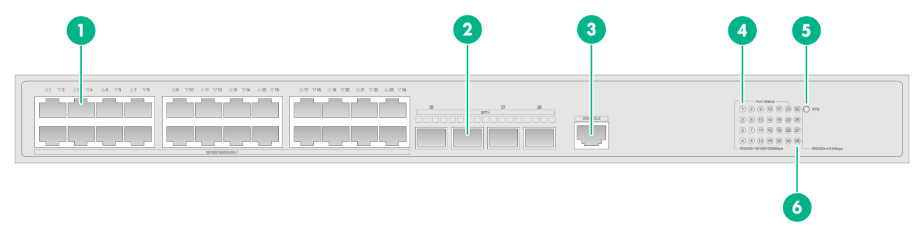

S5170-EI switch series
S5170-28S-EI
Figure 1 Front panel
(1) 10/100/1000BASE-T autosensing Ethernet port
(2) SFP+ port
(3) Serial console port (CONSOLE)
(4) 10/100/1000BASE-T autosensing Ethernet port LED
(5) System status LED (SYS)
(6) SFP+ port LED

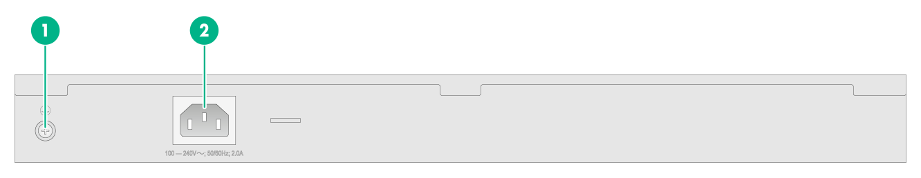

Figure 2 Rear panel
(1) Grounding screw
(2) AC-input power receptacle

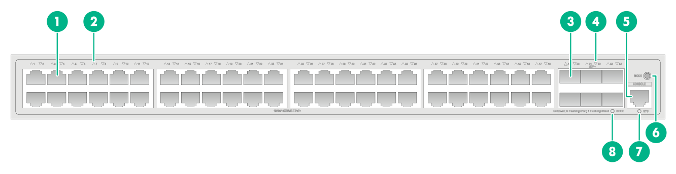

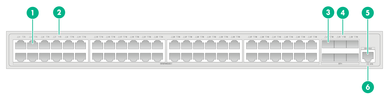

S5170-54S-EI
Figure 3 Front panel
(2) 10/100/1000BASE-T autosensing Ethernet port LED
(3) SFP+ port
(4) SFP+ port LED
(5) Serial console port (CONSOLE)
(6) System status LED (SYS)

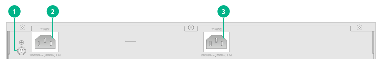

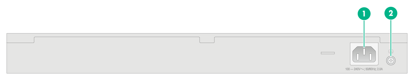

Figure 4 Rear panel
(1) AC-input power receptacle
(2) Grounding screw

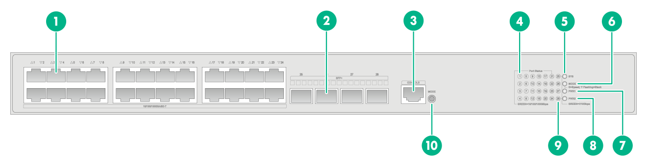

S5570S-28S-EI

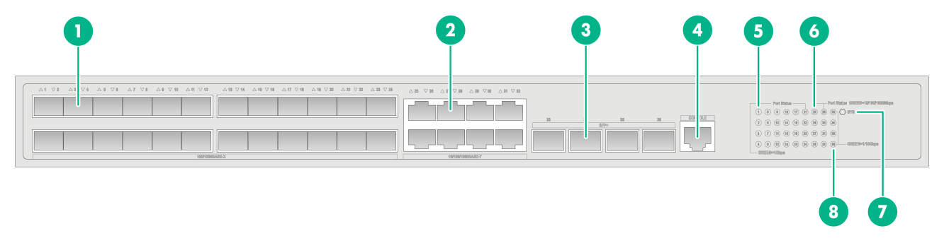

Figure 15 Front panel
(2) SFP+ port
(6) Mode LED (MODE)
(7) Power supply 1 status LED (PWR1)
(8) Power supply 2 status LED (PWR2)
(9) SFP+ port LED
(10) Mode button

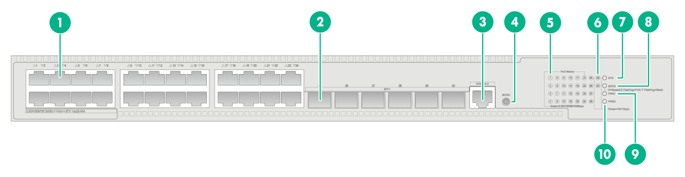

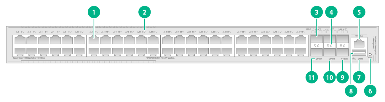

S5570S-54S-EI

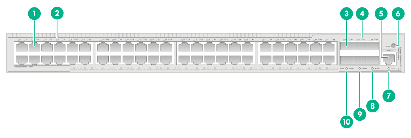

Figure 17 Front panel
(3) SFP+ port
(4) SFP+ port LED
(6) Mode button
(7) System status LED (SYS)
(8) Mode LED (MODE)
(9) Power supply 2 status LED (PWR2)
(10) Power supply 1 status LED (PWR1)

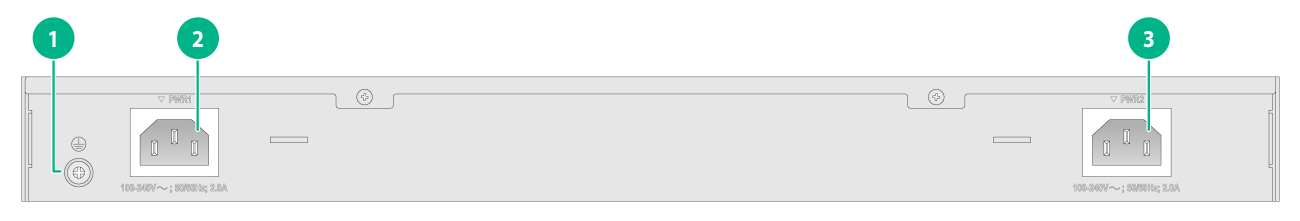

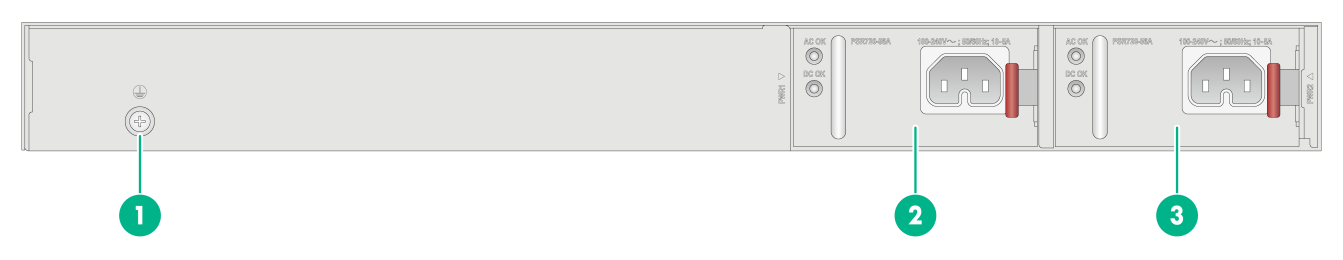

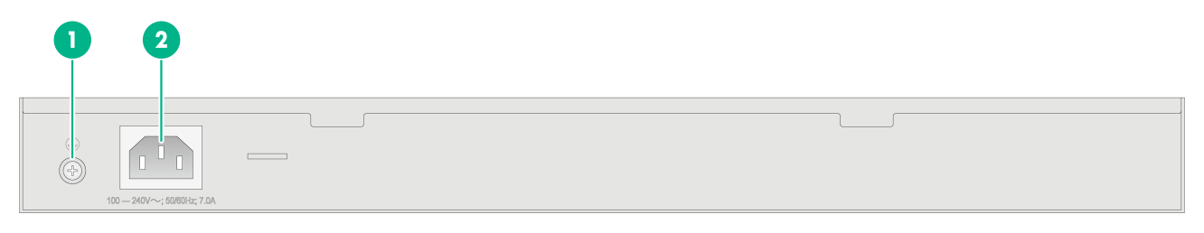

Figure 18 Rear panel
(1) Grounding screw
(2) Power supply 1 (PWR1)
(3) Power supply 2 (PWR2)
The S5570S-54S-EI switch has two power supply slots on the rear panel. You can install one or two power supplies for the switch as required. In Figure 18, two PSR75-12A AC power modules are installed in the power supply slots.
The S5570S-54S-EI switch with a product code of LS-5570-54S-EI is shipped with power supply slot PWR1 empty and power supply slot PWR2 installed with a filler panel.
The S5570S-54S-EI switch with a product code of LS-5570-54S-EI-GL supports shipment with power supplies installed. If you hope that the switch is shipped with the purchased power supplies installed, contact the H3C sales personnel.

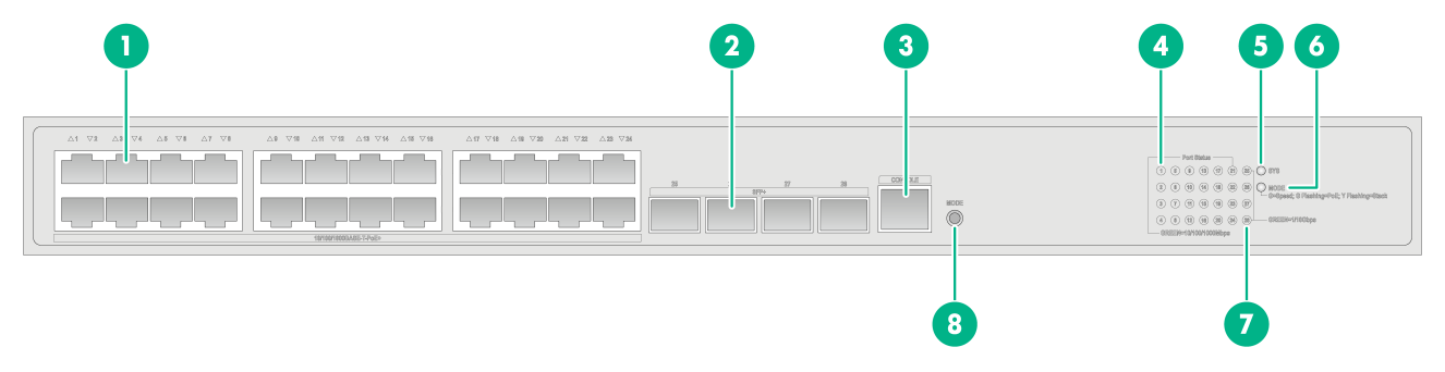

Figure 19 Front panel
(1) 10/100/1000BASE-T-PoE+ autosensing Ethernet port
(2) SFP+ port
(4) Mode button
(5) 10/100/1000BASE-T-PoE+ autosensing Ethernet port LED
(6) SFP+ port LED
(8) Mode LED (MODE)
(9) Power supply 1 status LED (PWR1)
(10) Power supply 2 status LED (PWR2)

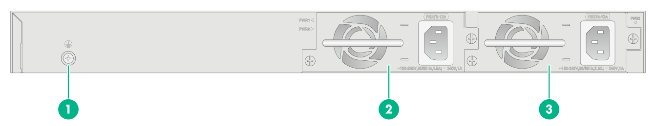

Figure 20 Rear panel
(1) Grounding screw
The S5570S-28S-HPWR-EI switch has two power supply slots on the rear panel and came with power supply slot PWR1 empty and power supply slot PWR2 installed with a filler panel. You can install one or two power supplies for the switch as required. In Figure 20, two PSR360-56A AC power modules are installed in the power supply slots.

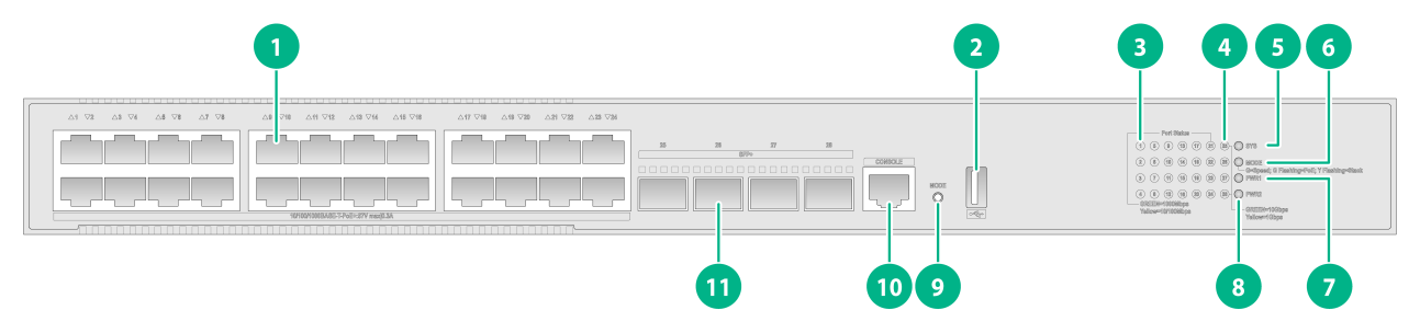

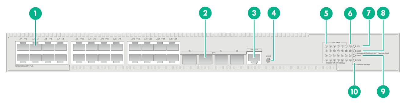

Figure 21 Front panel
(2) USB port
(3) 10/100/1000BASE-T-PoE+ autosensing Ethernet port LED
(4) SFP+ port LED
(6) Mode LED (MODE)
(9) Mode button
(10) Serial console port
(11) SFP+ port

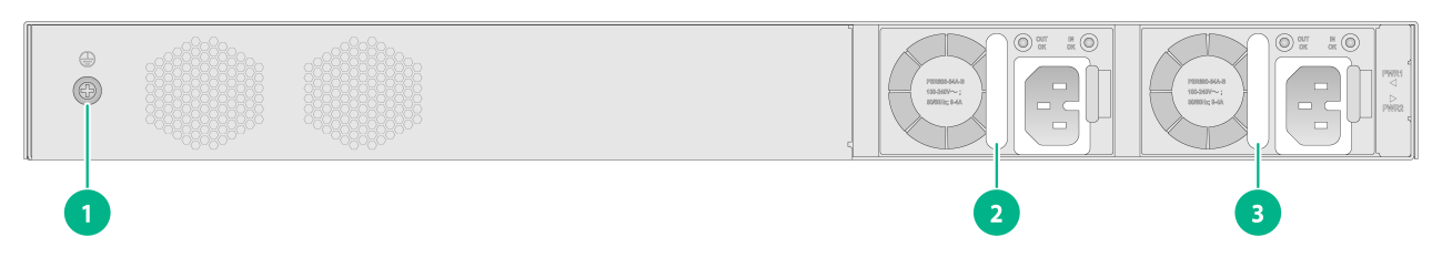

Figure 22 Rear panel
(1) Grounding screw
The S5570S-28S-HPWR-EI-A switch has two power supply slots on the rear panel. You can install one or two power supplies for the switch as required. In Figure 22, two PSR600-54A-B AC power supplies are installed in the power supply slots.
The S5570S-28S-HPWR-EI-A switch with product code LS-5570S-28S-HPWR-EI-A came with power supply 1 slot empty and power supply slot 2 installed with a filler panel.
The S5570S-28S-HPWR-EI-A switch with product code LS-5570S-28S-HPWR-EI-A-GL supports shipment with power supplies installed. To have the switch shipped with power supplies installed, contact the H3C marketing personnel and add your requirements to the order in advance.

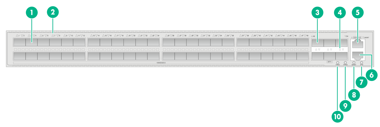

Figure 25 Front panel
(3) SFP+ port
(4) SFP+ port LED
(6) Mode button
(8) USB port
(9) Mode LED (MODE)
(11) Power supply 1 status LED (PWR1)
Figure 26 Rear panel

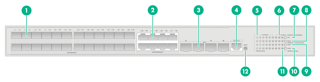

S5570S-36F-EI

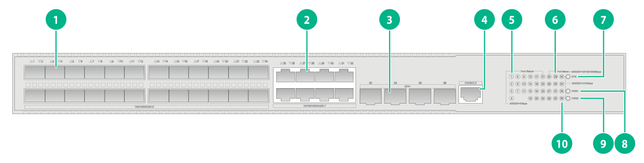

Figure 27 Front panel
(1) SFP port
(3) SFP+ port
(4) Serial console port (CONSOLE)
(5) SFP port LED
(6) 10/100/1000BASE-T autosensing Ethernet port LED
(8) Mode LED (MODE)
(11) SFP+ port LED
(12) Mode button

(8) Management Ethernet port LED
Figure 30 Rear panel
(1) Grounding screw
The S5570S-54F-EI switch has two power supply slots on the rear panel. You can install one or two power supplies for the switch as required. In Figure 30, two PSR75-12A AC power modules are installed in the power supply slots.
The S5570S-54F-EI switch with a product code of LS-5570S-54F-EI is shipped with power supply slot PWR1 empty and power supply slot PWR2 installed with a filler panel.
The S5570S-54F-EI switch with a product code of LS-5570S-54F-EI-GL supports shipment with power supplies installed. If you hope that the switch comes with the purchased power supplies installed, contact the H3C sales personnel.

Figure 31 Front panel
(1) 2.5G/1000/100BASE-T-PoE++ port
(2) SFP+ port
(4) Mode button
(5) 2.5G/1000/100BASE-T-PoE++ port LED
(6) SFP+ port LED
(8) Mode LED (MODE)
Figure 32 Rear panel
(1) Grounding screw
The S5570S-30MS-UPWR-EI switch has two power supply slots on the rear panel and comes with power supply slot PWR1 empty and power supply slot PWR2 installed with a filler panel. You can install one or two power supplies for the switch as required. In Figure 32, two PSR720-56A AC power modules are installed in the power supply slots.

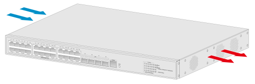

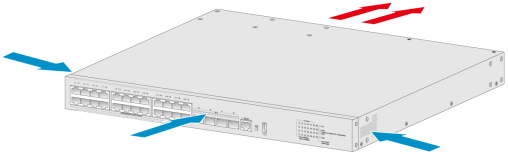

Cooling system
To dissipate heat timely and enhance system stability, the switch uses a high-performance cooling system. Consider the site ventilation design when you plan the installation site for the switch. Table 33 describes fan trays available for the switch.
Table 33 Fan trays available for the switch
Device model
Fan tray type
Airflow direction
All S5170-EI switch models
All S5570S-EI switch models, except the S5570S-28S-HPWR-EI-A and S5570S-54S-PWR-EI-A
Fixed fan trays
From the chassis left side to the right side (S5170-28S-HPWR-EI switch as an example)
S5570S-54S-PWR-EI-A
From the chassis two sides and port side to the power supply side
(S5570S-28S-HPWR-EI-A switch as an example)
