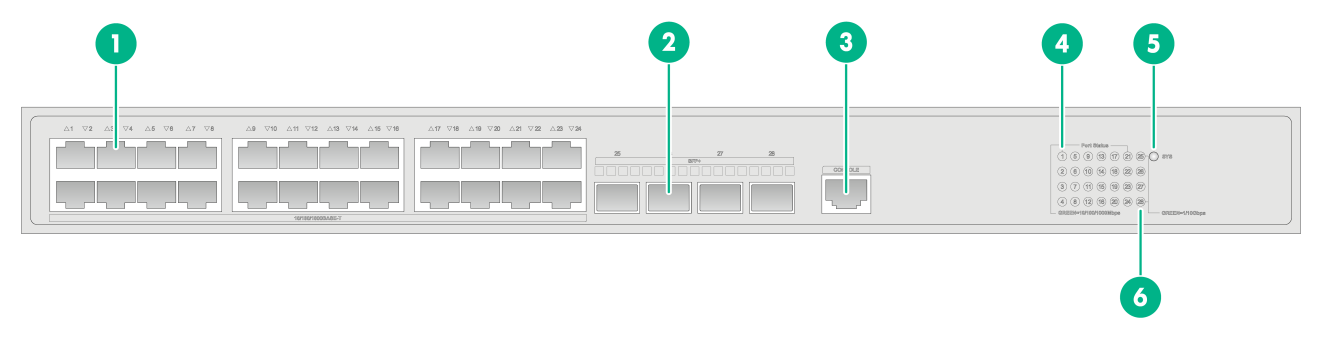

Figure 1 Front panel
(1) 10/100/1000BASE-T autosensing Ethernet port |
(2) SFP+ port |
(3) Serial console port (CONSOLE) |
(4) 10/100/1000BASE-T autosensing Ethernet port LED |
(5) System status LED (SYS) |
(6) SFP+ port LED |

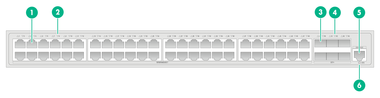

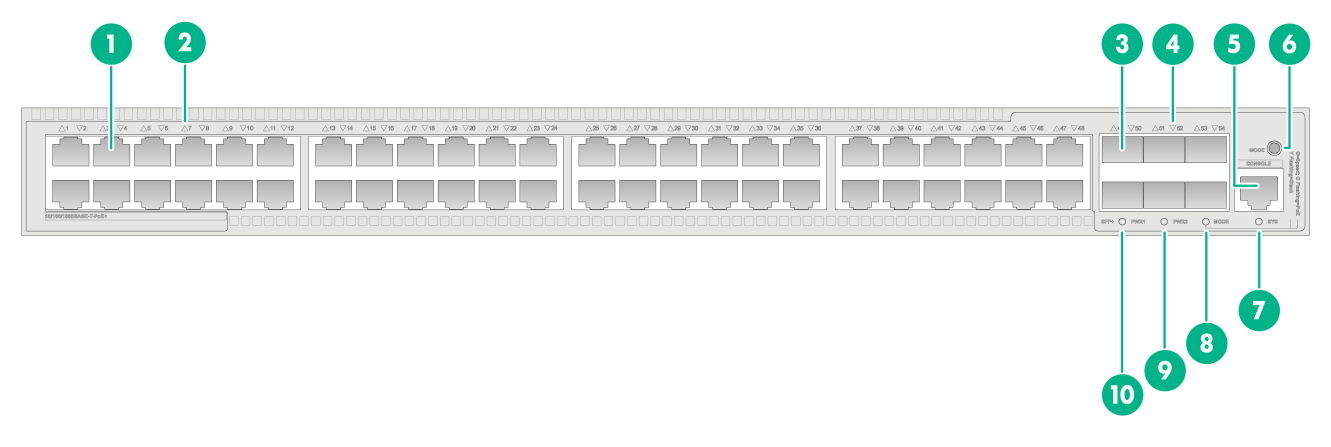

Figure 3 Front panel
(2) 10/100/1000BASE-T autosensing Ethernet port LED |
(3) SFP+ port |
(4) SFP+ port LED |
(5) Serial console port (CONSOLE) |
(6) System status LED (SYS) |

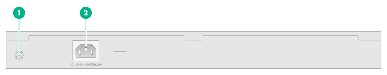

(1) AC-input power receptacle |
(2) Grounding screw |

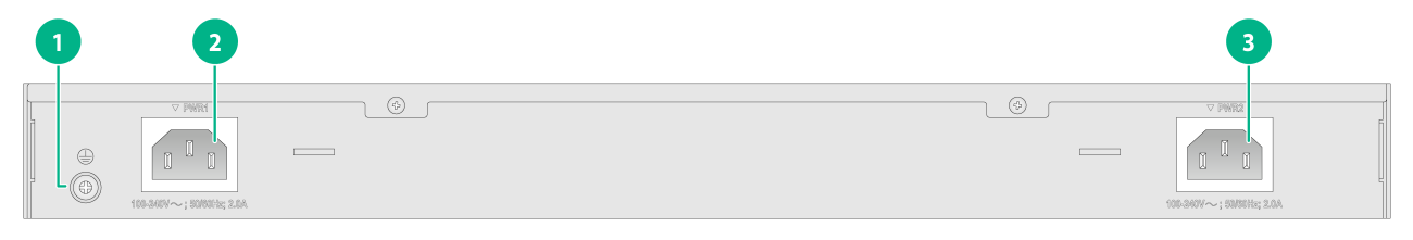

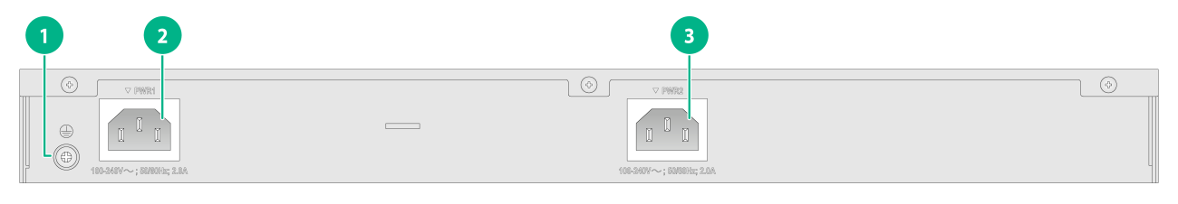

Figure 6 Rear panel
(1) Grounding screw |
(2) AC-input power receptacle 1 |
(3) AC-input power receptacle 2 |
The S5170-54S-EI-DP switch has two power input receptacles on the rear panel. You can use one power feed or two power feeds for 1+1 redundancy for the switch.

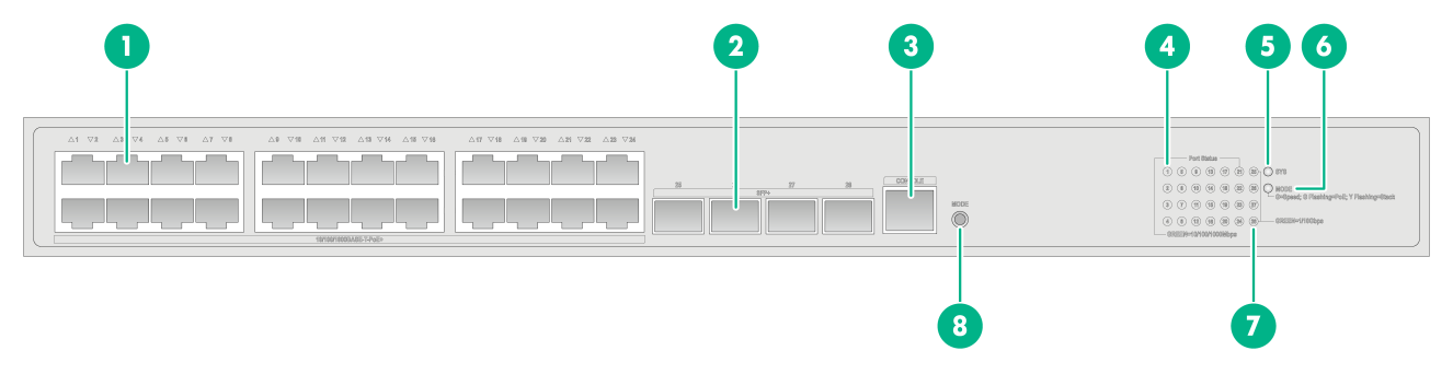

S5170-28S-HPWR-EI
Figure 7 Front panel
(1) 10/100/1000BASE-T-PoE+ autosensing Ethernet port |
(2) SFP+ port |
(4) 10/100/1000BASE-T-PoE+ autosensing Ethernet port LED |
(6) Mode LED (MODE) |
(7) SFP+ port LED |
(8) Mode button |

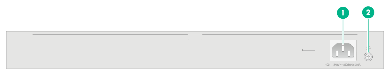

(2) AC-input power receptacle |

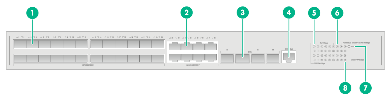

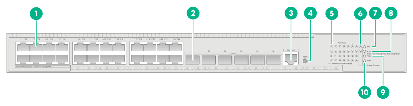

Figure 11 Front panel
(1) SFP port |
(2) 10/100/1000BASE-T autosensing Ethernet port |
(3) SFP+ port |
(4) Serial console port (CONSOLE) |
(5) SFP port LED |
(6) 10/100/1000BASE-T autosensing Ethernet port LED |
(7) System status LED (SYS) |
(8) SFP+ port LED |

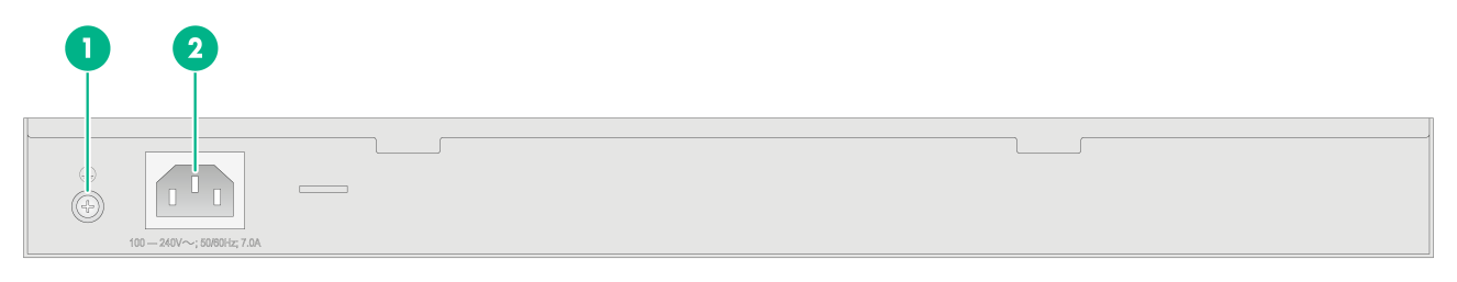

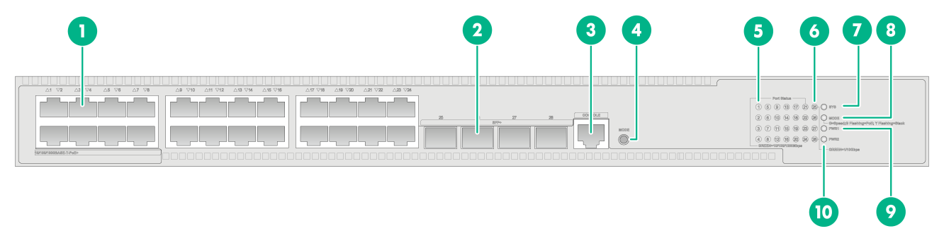

S5570S-28S-EI

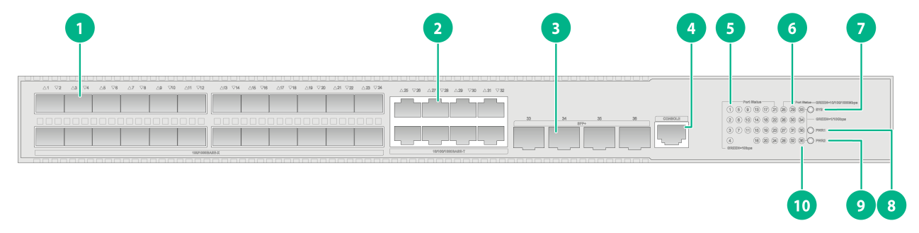

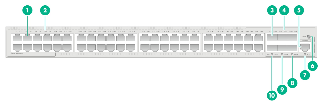

Figure 15 Front panel
(2) SFP+ port |
(7) Power supply 1 status LED (PWR1) |
(8) Power supply 2 status LED (PWR2) |
(9) SFP+ port LED |
(10) Mode button |

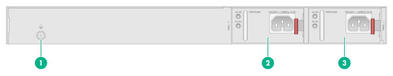

(2) Power supply 1 (PWR1) |
(3) Power supply 2 (PWR2) |
The S5570S-28S-EI switch has two power supply slots on the rear panel. You can install one or two power supplies for the switch as required. In Figure 16, two PSR75-12A AC power modules are installed in the power supply slots.
The S5570S-28S-EI switch with a product code of LS-5570S-28S-EI is shipped with power supply slot PWR1 empty and power supply slot PWR2 installed with a filler panel.
The S5570S-28S-EI switch with a product code of LS-5570S-28S-EI-GL supports shipment with power supplies installed. If you hope that the switch is shipped with the purchased power supplies installed, contact the H3C sales personnel.

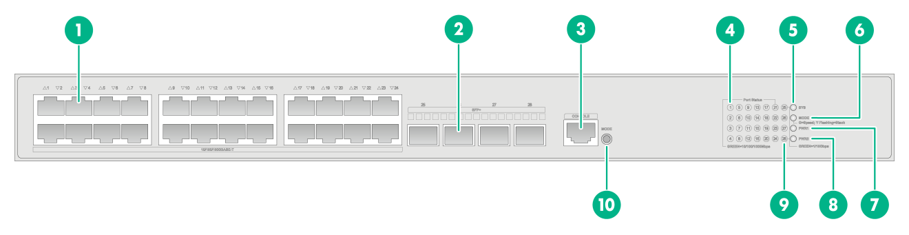

S5570S-54S-EI
Figure 17 Front panel
(3) SFP+ port |
(4) SFP+ port LED |
(6) Mode button |
(8) Mode LED (MODE) |
(9) Power supply 2 status LED (PWR2) |
(10) Power supply 1 status LED (PWR1) |
The S5570S-54S-EI switch has two power supply slots on the rear panel. You can install one or two power supplies for the switch as required. In Figure 18, two PSR75-12A AC power modules are installed in the power supply slots.
The S5570S-54S-EI switch with a product code of LS-5570-54S-EI is shipped with power supply slot PWR1 empty and power supply slot PWR2 installed with a filler panel.
The S5570S-54S-EI switch with a product code of LS-5570-54S-EI-GL supports shipment with power supplies installed. If you hope that the switch is shipped with the purchased power supplies installed, contact the H3C sales personnel.

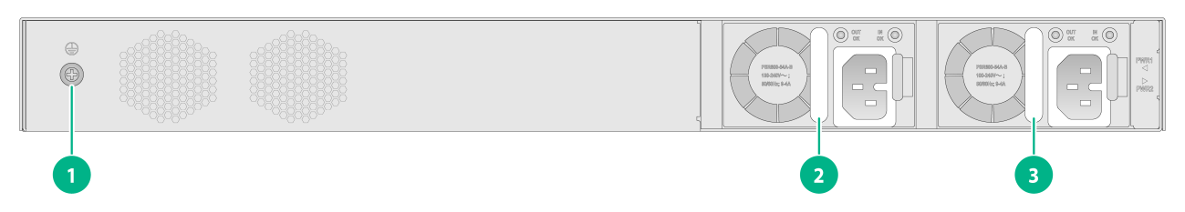

(10) Power supply 2 status LED (PWR2) |
The S5570S-28S-HPWR-EI switch has two power supply slots on the rear panel and came with power supply slot PWR1 empty and power supply slot PWR2 installed with a filler panel. You can install one or two power supplies for the switch as required. In Figure 20, two PSR360-56A AC power modules are installed in the power supply slots.
S5570S-28S-HPWR-EI-A

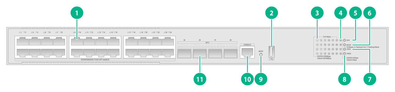

Figure 21 Front panel
(2) USB port |
(3) 10/100/1000BASE-T-PoE+ autosensing Ethernet port LED |
(4) SFP+ port LED |
(9) Mode button |
(10) Serial console port |
(11) SFP+ port |
The S5570S-28S-HPWR-EI-A switch has two power supply slots on the rear panel. You can install one or two power supplies for the switch as required. In Figure 22, two PSR600-54A-B AC power supplies are installed in the power supply slots.

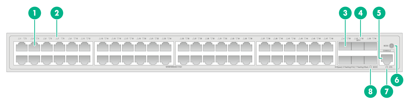

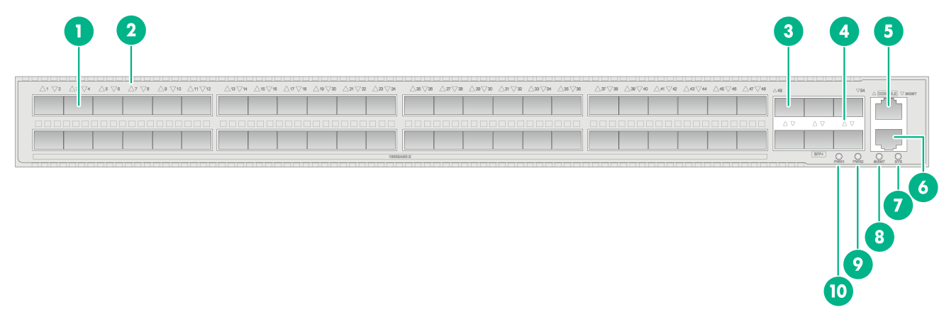

Figure 23 Front panel
(2) 10/100/1000BASE-T-PoE+ autosensing Ethernet port LED |
(3) SFP+ port |
(4) SFP+ port LED |
(6) Mode button |

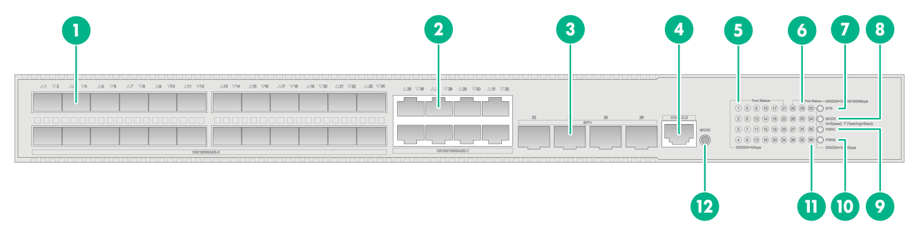

S5570S-36F-EI
Figure 27 Front panel
(1) SFP port |
(3) SFP+ port |
(5) SFP port LED |
(9) Power supply 1 status LED (PWR1) |
(11) SFP+ port LED |
(12) Mode button |
The S5570S-36F-EI switch has two power supply slots on the rear panel. You can install one or two power supplies for the switch as required. In Figure 28, two PSR75-12A AC power modules are installed in the power supply slots.
The S5570S-36F-EI switch with a product code of LS-5570S-36F-EI is shipped with power supply slot PWR1 empty and power supply slot PWR2 installed with a filler panel.
The S5570S-36F-EI switch with a product code of LS-5570S-36F-EI-GL supports shipment with power supplies installed. If you hope that the switch comes with the purchased power supplies installed, contact the H3C sales personnel.

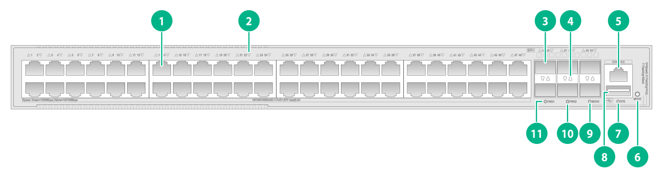

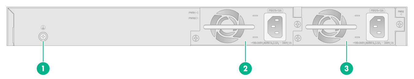

S5570S-54F-EI
Figure 29 Front panel
(1) SFP port |
(2) SFP port LED |
(3) SFP+ port |
(4) SFP+ port LED |
(6) Management Ethernet port |
(8) Management Ethernet port LED |
The S5570S-54F-EI switch has two power supply slots on the rear panel. You can install one or two power supplies for the switch as required. In Figure 30, two PSR75-12A AC power modules are installed in the power supply slots.
The S5570S-54F-EI switch with a product code of LS-5570S-54F-EI is shipped with power supply slot PWR1 empty and power supply slot PWR2 installed with a filler panel.
The S5570S-54F-EI switch with a product code of LS-5570S-54F-EI-GL supports shipment with power supplies installed. If you hope that the switch comes with the purchased power supplies installed, contact the H3C sales personnel.

AC power status LED
The S5170-36F-EI-DP switch provides two AC power status LEDs on the rear panel to indicate the AC power status.
Table 24 AC power status LED description
LED mark |
Status |
Description |
PWR1/PWR2 |
Steady green |
Normal AC power input |
Off |
Abnormal or no AC power input |
Power status LED
The power status LEDs show the operating status of power supply 1 (PWR1) and power supply 2 (PWR2), respectively.
Table 25 Power status LED description
LED mark |
Status |
Description |
PWR1/PWR2 |
Steady green |
The power supply is present and operating correctly. |
Steady yellow |
The power supply is present, but it is not operating or has failed. |
Off |
No power supply is present. |

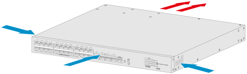

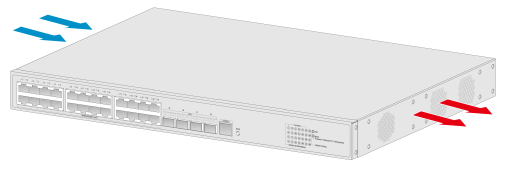

Cooling system
To dissipate heat timely and enhance system stability, the switch uses a high-performance cooling system. Consider the site ventilation design when you plan the installation site for the switch. Table 33 describes fan trays available for the switch.
Table 33 Fan trays available for the switch
Device model |
Fan tray type |
Airflow direction |
All S5170-EI switch models All S5570S-EI switch models, except the S5570S-28S-HPWR-EI-A and S5570S-54S-PWR-EI-A |
Fixed fan trays |
From the chassis left side to the right side (S5170-28S-HPWR-EI switch as an example) |
S5570S-28S-HPWR-EI-A S5570S-54S-PWR-EI-A |
From the chassis two sides and port side to the power supply side (S5570S-28S-HPWR-EI-A switch as an example) |
