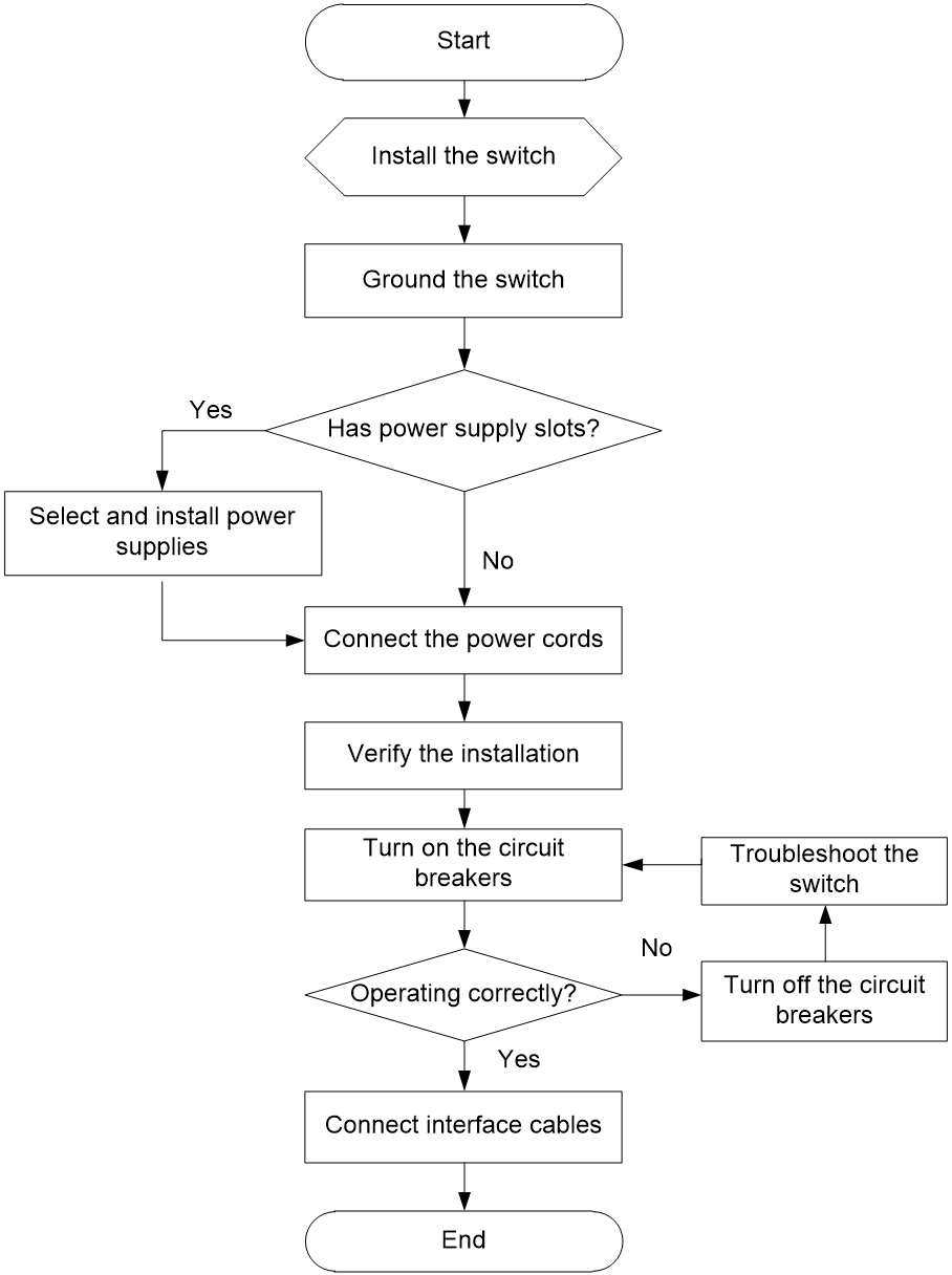

2 Installing the switch
CAUTION
CAUTION:
Keep the tamper-proof seal on a mounting screw on the chassis cover intact, and if you want to open the chassis, contact H3C for permission. Otherwise, H3C shall not be liable for any consequence.
Figure2-1 Hardware installation flow

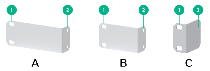

Installing the switch in a 19-inch rack
Mounting brackets
Table2-2 describes the mounting brackets applicable to the switch.
Table2-2 Mounting brackets applicable to the switch
Switch model
Mounting brackets
Views
S5135S-8FP4S-EI-Q
S5135S-8FP4XS-EI-Q
S5135S-8T4S-EI-Q
S5135S-8T4XS-EI-Q
S5135S-10T2S2X-EI-Q
Mounting brackets A (provided)
See A in Figure2-2.
S5135S-16FP4S-EI
S5135S-16T4S-EI
Mounting brackets B (provided)
See B in Figure2-2.

Figure2-2 Mounting brackets
(1) Screw hole for attaching the bracket to the rack post
(2) Screw hole for attaching the bracket to the switch

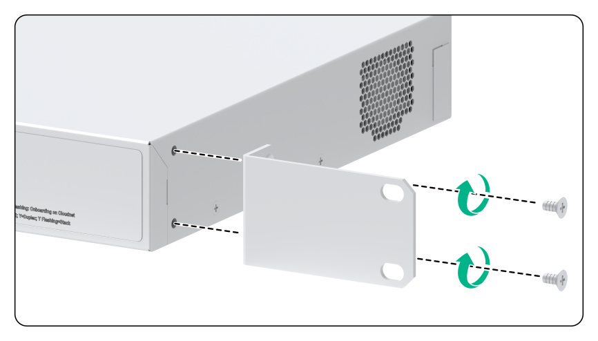

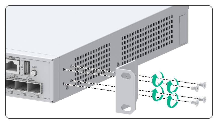

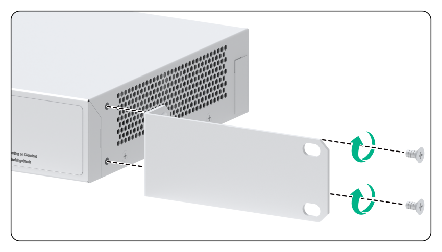

Attaching the mounting brackets to the switch
The S5135S-EI switches provide only the port side mounting position for the mounting brackets.
1.     Align one mounting bracket with the screw holes at the mounting position. Use M4 screws to attach the mounting bracket to the chassis. See Figure2-3 for installing mounting bracket A, Figure2-4 for installing mounting bracket B, and Figure2-5 for installing mounting bracket C.
2.     Repeat step 1 to attach the other mounting bracket to the chassis.
Figure2-3 Attaching mounting bracket A (S5135S-8T4XS-EI-Q switch)
Figure2-4 Attaching mounting bracket B (S5135S-16FP4S-EI switch)
Figure2-5 Attaching mounting bracket C (S5135S-48T4S-EI-Q switch)

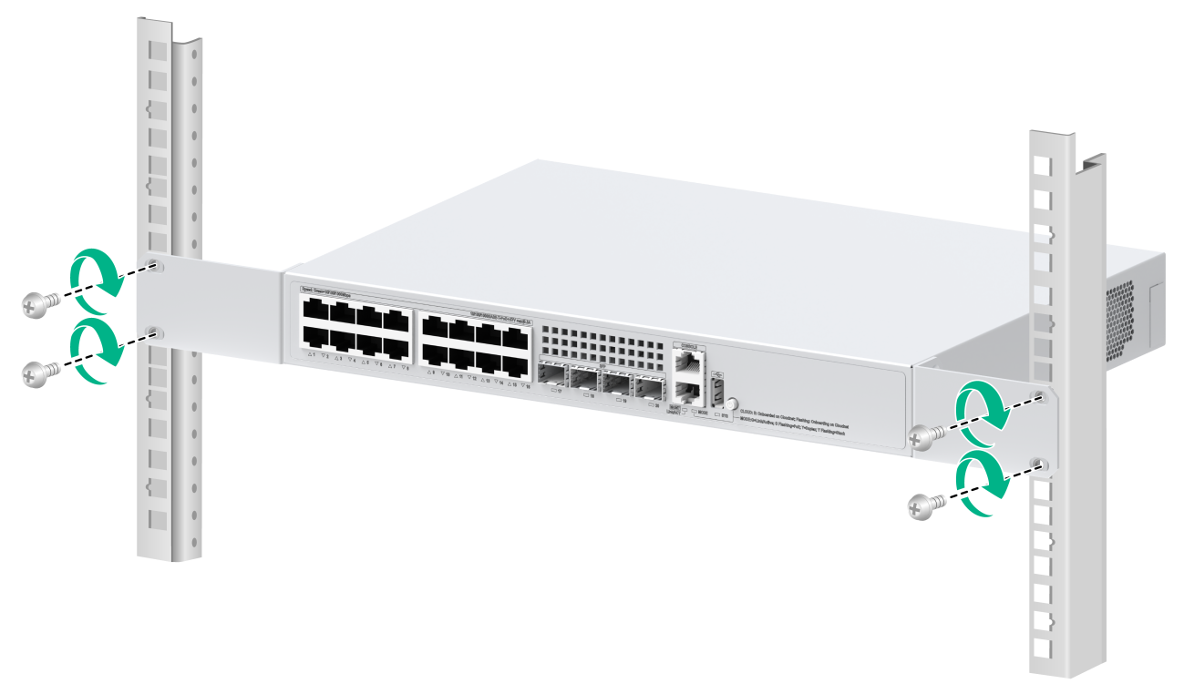

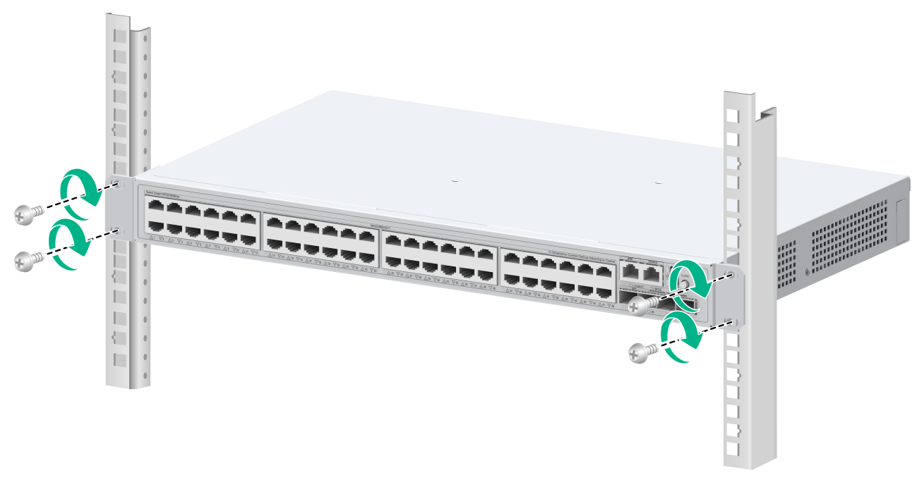

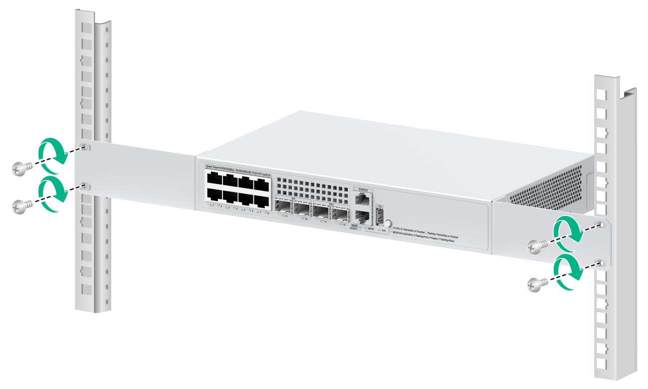

Rack-mounting the switch
This task requires two people. To mount the switch in the rack:
1.     Wear an ESD wrist strap and make sure it makes good skin contact and is reliably grounded.
2.     Verify that the mounting brackets have been securely attached to the switch chassis.
3.     Install cage nuts in the mounting holes in the rack posts.
No cage nuts are provided with the switch. Prepare them yourself.
4.     One person holds the switch chassis and aligns the mounting brackets with the mounting holes in the rack posts, and the other person attaches the mounting brackets to the rack with M6 screws.
No M6 screws are provided with the switch. Prepare them yourself.
5.     Verify that the switch chassis is horizontal and secure.
Figure2-6 Mounting an S5135S-8T4XS-EI-Q switch in the rack
Figure2-7 Mounting an S5135S-16FP4S-EI switch in the rack
Figure2-8 Mounting an S5135S-48T4S-EI-Q switch in the rack

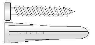

20 mm (0.79 in) long screws and screw anchors as shown in Figure2-9 are provided with these switches for wall-mounting.
Figure2-9 Screw anchor and screw

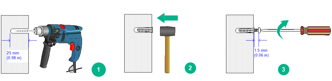

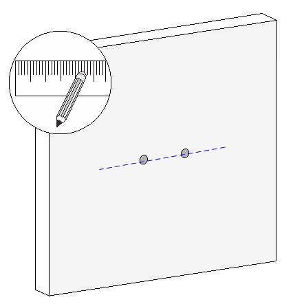

To mount the switch on a wall:
1.     Mark two installation holes on the wall. Make sure the two holes are on the same horizontal line.
See Table2-2 for the distance requirement between the two holes.
Figure2-10 Installing the switch on a wall (1)
2.     Drill two holes with a diameter of 6 mm (0.24 in) and a depth of 25 mm (0.98 in) at the marked locations. Hammer the screw anchors into the wall and use a Phillips screwdriver to fasten the screw into the screw anchor. Leave 1.5 mm (0.06 in) between the screw head and the wall for hanging the switch.
Figure2-11 Installing the switch on a wall (2)

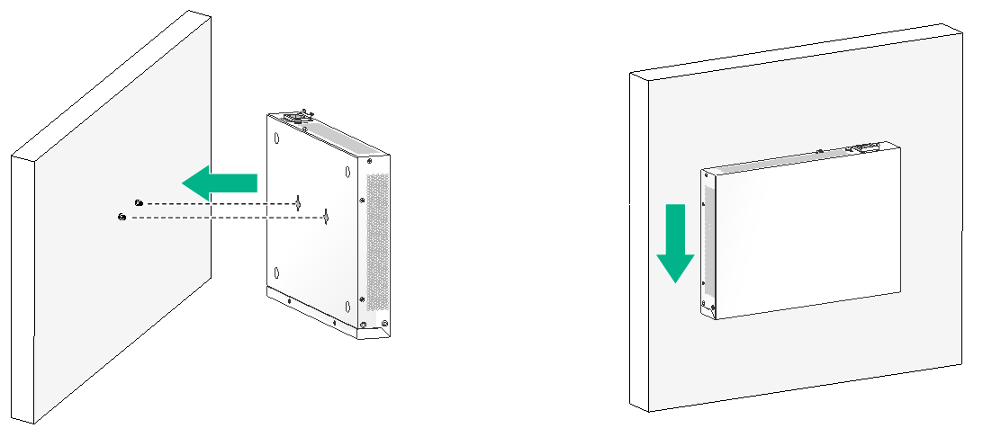

3.     Align the installation holes in the switch rear with the screws on the wall and hang the switch on the screws. Make sure the port side faces down and the left and right sides are perpendicular to the ground.
Figure2-12 Installing the switch on a wall (3)

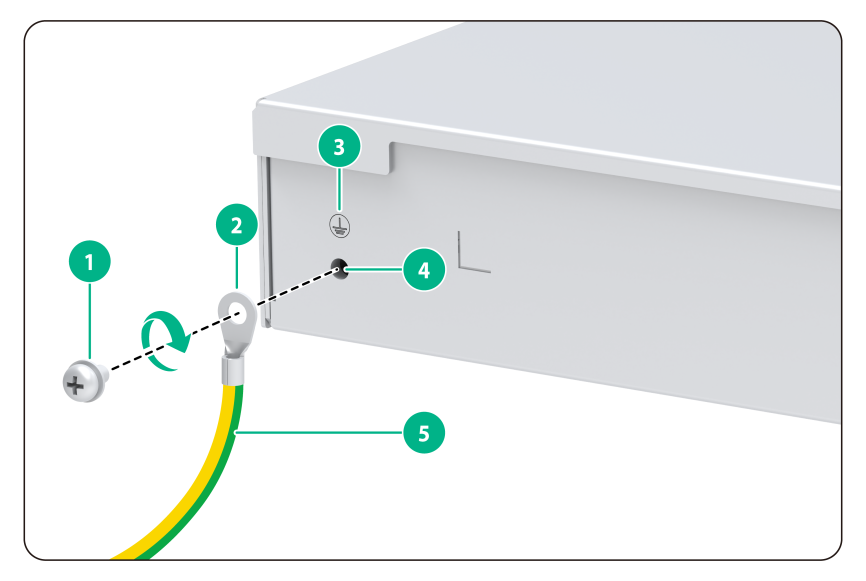

Grounding the switch with a grounding strip
WARNING
WARNING!
Connect the grounding cable to the grounding system in the equipment room. Do not connect it to a fire main or lightning rod.
The grounding screw and grounding hole (with a grounding sign) are located at the rear panel of the switch.
To ground the switch by using a grounding strip:
1.     Attach the ring terminal end of the grounding cable to the grounding hole in the switch.
a.     Remove the grounding screw from the grounding hole in the rear panel of the switch.
b.     Attach the grounding screw to the ring terminal of the grounding cable.
c.     Use a screwdriver to fasten the grounding screw into the grounding hole.
Figure2-13 Attaching the grounding cable to the grounding hole of the switch (S5135S-48T4S-EI-Q switch)
(1) Grounding screw
(2) Ring terminal
(3) Grounding sign
(4) Grounding hole
(5) Grounding cable

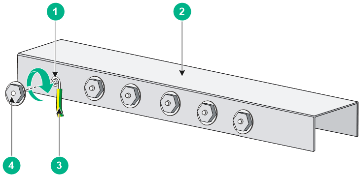

2.     Connect the other end of the grounding cable to the grounding strip.
a.     Use the needle-nose pliers to bend the bare wire.
b.     Hook the grounding cable to the post on the grounding strip, and use the hex nut to secure the cable to the post.
Figure2-14 Connecting the grounding cable to a grounding strip
(1) Grounding post
(2) Grounding strip
(3) Grounding cable

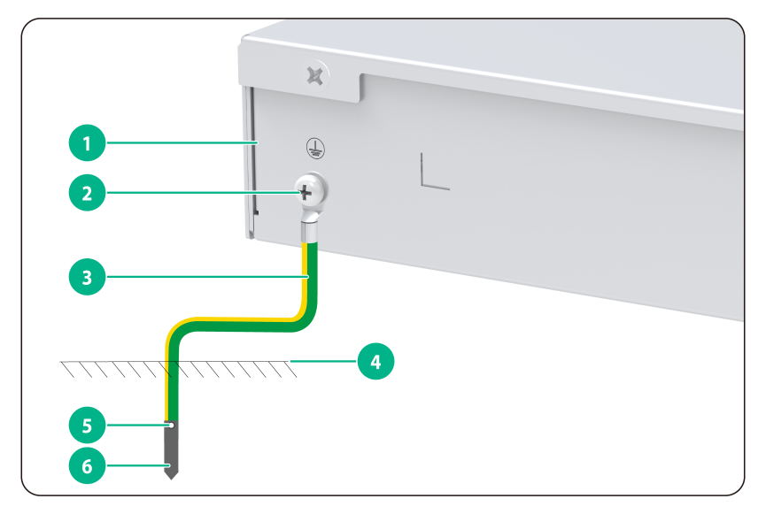

Grounding the switch with a grounding conductor buried in the earth ground
If the installation site does not have grounding strips, but earth ground is available, hammer a 2.5 m (8.20 ft) or longer angle iron or steel tube into the earth ground to act as a grounding conductor. Make sure a minimum of 0.7 m (2.30 ft) is left between the top of the grounding conductor and the ground. In cold areas, bury the grounding conductor below the frozen soil layer. In areas with thin soil or rocky gravel, determine the depth for burying the grounding conductor based on the actual condition.
If zinc-coated steel is used, the following dimensions requirements must be met:
·     Angle iron—A minimum of 50 × 50 × 5 mm (1.97 × 1.97 × 0.20 in).
·     Steel tube—A minimum of 3.5 mm (0.14 in) in thickness.
·     Flat steel—A minimum of 40 × 4 mm (1.57 × 0.16 in).
·     Round steel—A minimum of 10 mm (0.39 in).
Weld the yellow-green grounding cable to the angel iron or steel tube and treat the joint for corrosion protection.
Figure2-15 Grounding the switch by burying the grounding conductor into the earth ground
(1) Chassis rear panel
(2) Grounding screw
(3) Grounding cable
(4) Earth
(5) Welding point
(6) Grounding conductor

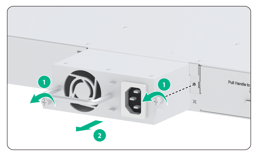

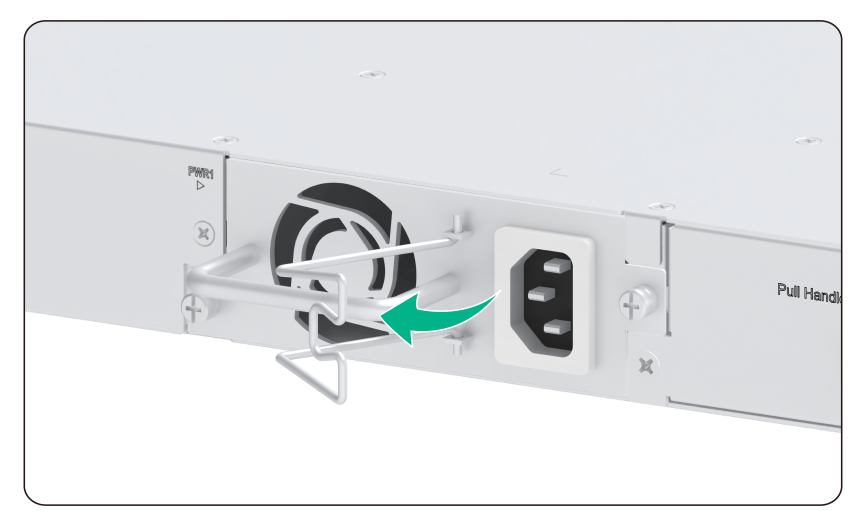

Installing a power supply
2.     Unpack the power supply and verify that the power supply model is as required.
3.     Remove the filler panel (if any) from the target slot.
If you require only one power supply, install it in power supply slot 1 and make sure a filler panel is installed in power supply slot 2.
4.     Orient the power supply with the upside up. Grasp the handle of the power supply with one hand and support its bottom with the other, and slide the power supply slowly along the guide rails into the slot. See callout 1 in Figure2-18.
To prevent damage to the power supply and the connector on the switch backplane, insert the power supply gently. If you encounter a hard resistance or the power supply tilts while inserting the power supply, pull out the power supply, realign it with the slot, and then insert it again.

Removing a power supply
2.     Power off the power supply and remove the power cord.
3.     Loosen the captive screws on the power supply with a Phillips screwdriver until they are completely disengaged from the chassis.
4.     Grasp the handle of the power supply with one hand and pull the module part way out. Support the module bottom with the other hand, and pull the power supply slowly along the guide rails out of the slot.
5.     Place the removed power supply in an antistatic bag.
Figure2-19 Removing a power supply

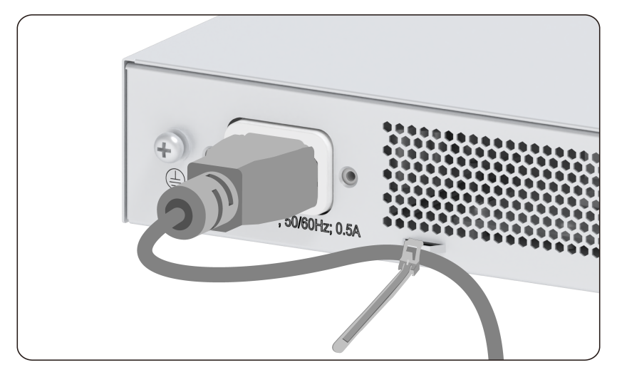

Connecting the AC power cord for the fixed AC power supply
1.     Connect the plug of the AC power cord to the AC-input power receptacle on the switch. See Figure2-20.
2.     Use a cable tie to secure the power cord to the handle near the AC power receptacle. See Figure2-21.
3.     Connect the other end of the power cord to an AC power source.
Figure2-20 Connecting the AC power cord for the fixed AC power supply
Figure2-21 Securing the AC power cord for the fixed AC power supply through a cable tie

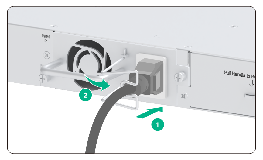

Connecting the power cord for a CA-70A12/PSR75-12A power supply
1.     Pull the bail latch leftward, as shown in Figure2-22.
2.     Connect the plug of the power cord to the power receptacle on the switch. See Figure2-23.
3.     Pull the bail latch rightward to secure the plug to the power receptacle. See Figure2-23.
4.     Connect the other end of the power cord to a power source.
Figure2-22 Connecting the power cord for a CA-70A12/PSR75-12A/PSR150-A1 power supply (1)
Figure2-23 Connecting the power cord for a CA-70A12/PSR75-12A/PSR150-A1 power supply (2)

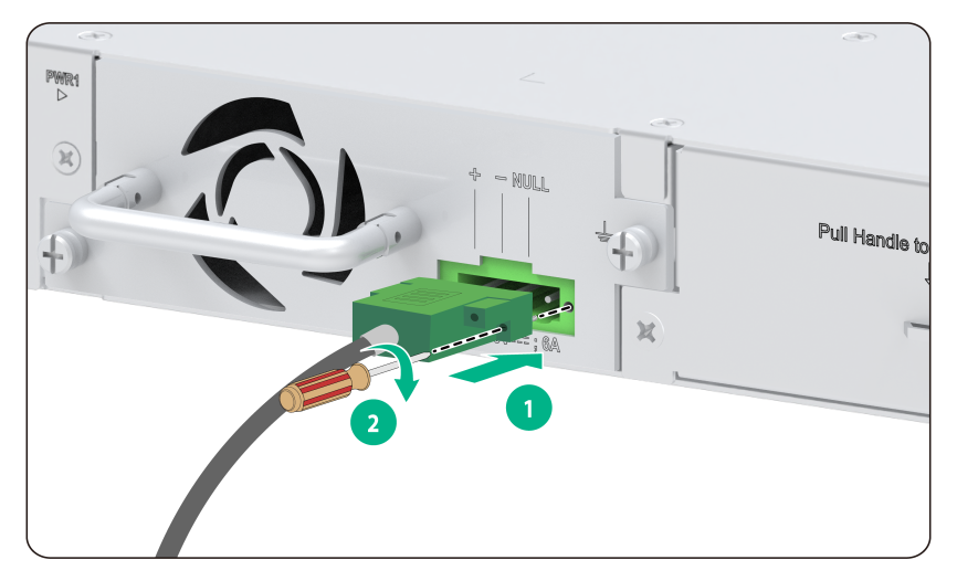

Connecting the power cord for a PSR180-12D-B power supply
CAUTION
CAUTION:
·     Connect the other ends of the wires for a PSR150-D1 power supply to a –48 VDC power source, with the negative wire ( or L–) to the negative terminal () and the positive wire (+ or M/N) to the positive terminal (+).
·     To use an H3C RPS to supply power to the power supply, use a compatible RPS power cord to connect the RPS to the power supply.
·     The power cord color code scheme in Figure2-24 is for illustration only. The cable delivered for your country or region might use a different color scheme. When you connect the power cord, always identify the polarity symbol on its wires.
To connect the power cord for a PSR150-D1 power supply:
1.     Correctly orient the plug at one end of the cable with the power receptacle on the power supply, and insert the plug into the power receptacle. See callout 1 in Figure2-24.
If you cannot insert the plug into the receptacle, re-orient the plug rather than use excessive force to push it in.
2.     Tighten the screws on the plug with a flat-blade screwdriver to secure the plug in the power receptacle. See callout 2 in Figure2-24.
3.     Connect the other end of the power cord to a –48 VDC power source or an RPS.
Figure2-24 Connecting the DC power cord for a PSR180-12D-B power supply (S5135S-48S2T4X-EI)

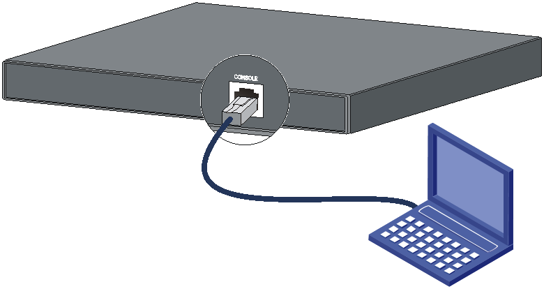

Connecting the switch to a configuration terminal
The S5135S-EI switch models each provide only a serial console port.
In Figure3-1, the switch is connected to a configuration terminal (PC as an example) from the serial console port.
Figure3-1 Connecting the switch to a configuration terminal
As shown in Figure3-1, two types of console cables can be used for connecting the switch to a configuration terminal. The switch is not provided with a serial console cable.

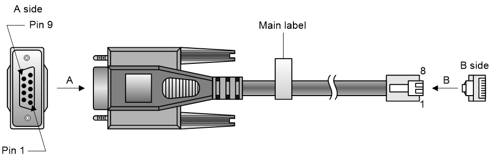

Connecting a DB9-to-RJ45 console cable
CAUTION
CAUTION:
Follow these guidelines when you connect a DB9-to-RJ45 console cable:
·     Identify the mark on the serial console port and make sure you are connecting to the correct port.
·     The serial ports on PCs do not support hot swapping. To connect a PC to an operating switch, first connect the PC end. To disconnect a PC from an operating switch, first disconnect the switch end.
A DB9-to-RJ45 serial console cable is an 8-core shielded cable, with a crimped RJ-45 connector at one end for connecting to the serial console port of the switch, and a DB-9 female connector at the other end for connecting to the serial port on a configuration terminal.
Figure3-2 DB9-to-RJ45 console cable
Table3-3 DB9-to-RJ45 console cable signal pinout
RJ-45
Signal
DB-9
Signal
1
RTS
8
CTS
2
DTR
6
DSR
3
TXD
2
RXD
4
SG
5
SG
5
SG
5
SG
6
RXD
3
TXD
7
DSR
4
DTR
8
CTS
7
RTS
To connect the switch to a configuration terminal (for example, a PC) by using a DB9-to-RJ45 console cable:
1.     Plug the DB-9 female connector of the DB9-to-RJ45 console cable to the serial port on the PC.
2.     Connect the RJ-45 connector to the serial console port on the switch.

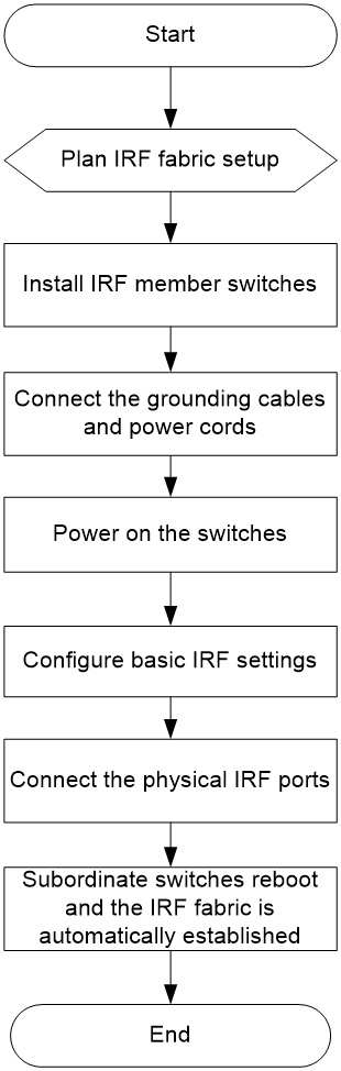

IRF fabric setup flowchart
Figure4-1 IRF fabric setup flowchart
To set up an IRF fabric:
Step
Description
1.     Plan IRF fabric setup.
Plan the installation site and IRF fabric setup parameters:
·     Planning IRF fabric size and the installation site
·     Identifying the master switch and planning IRF member IDs
·     Planning IRF topology and connections
·     Identifying IRF physical ports on the member switches
·     Planning the cabling scheme
2.     Install IRF member switches.
See "Installing the switch in a 19-inch rack" or "Mounting the switch on a workbench."
3.     Connect grounding cables and power cords.
See "Grounding the switch" and "Connecting the power cord."
4.     Power on the switches.
N/A
5.     Configure basic IRF settings.
See the IRF configuration guide or virtual technologies configuration guide for the switch series, depending on the software version.
6.     Connect the IRF physical ports.
Connect IRF physical ports on switches.
All switches except the master switch automatically reboot, and the IRF fabric is established.

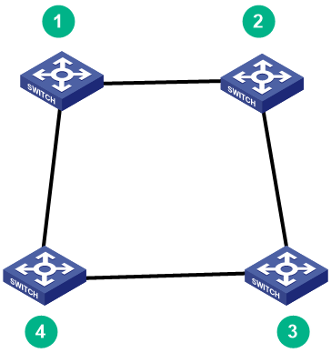

Figure4-2 IRF fabric in daisy chain topology
Figure4-3 IRF fabric in ring topology

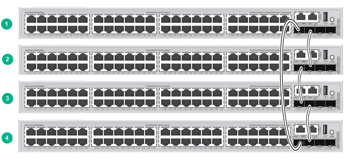

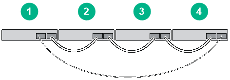

As a best practice, use ring topology to connect the switches. The following describes cabling schemes in ring topology.
Connecting the IRF member switches in one rack
Use SFP cables to connect the IRF member switches in a rack as shown in Figure4-4. The switches in the ring topology (see Figure4-5) are in the same order as connected in the rack.
Figure4-4 Connecting the switches in one rack
Figure4-5 IRF fabric topology

Figure4-6 ToR cabling
Configuring basic IRF settings
After you install the IRF member switches, power on the switches, and log in to each IRF member switch (see the fundamentals configuration guide for the switch series) to configure their member IDs, member priorities, and IRF port bindings.
Follow these guidelines when you configure the switches:
·     Assign the master switch higher member priority than any other switch.
·     Bind physical ports to IRF port 1 on one switch and to IRF port 2 on the other switch. You perform IRF port binding before or after connecting IRF physical ports depending on the software release.
·     Execute the display irf configuration command to verify the basic IRF settings.
For more information about configuring basic IRF settings, see the IRF configuration guide or virtual technologies configuration guide for the switch series, depending on the software version.
Connecting the IRF physical ports
Connect the IRF member switches as planned.
Wear an ESD wrist strap when you connect transceiver modules and fibers. For how to connect them, see H3C Transceiver Modules User Guide.
Verifying the IRF fabric setup
To verify the basic functionality of the IRF fabric after you finish configuring basic IRF settings and connecting IRF ports:
1.     Log in to the IRF fabric through the console port of any member switch.
2.     Create a Layer 3 interface, assign it an IP address, and make sure the IRF fabric and the remote network management station can reach each other.
3.     Use Telnet or SNMP to access the IRF fabric from the network management station. (See the fundamentals configuration guide for the switch series.)
4.     Verify that you can manage all member switches as if they were one node.
5.     Display the running status of the IRF fabric by using the commands in Table4-2.
Table4-2 Displaying and maintaining IRF configuration and running status
Display IRF fabric information.
display irf
Display basic IRF settings for each member device.
Display IRF fabric topology information.
display irf topology
To avoid IP address collision and network problems, configure a minimum of one multi-active detection (MAD) mechanism to detect the presence of multiple identical IRF fabrics and handle collisions. For more information about MAD detection, see the IRF configuration guide or virtual technologies configuration guide for the switch series, depending on the software version.

Configuration terminal issues
No display on the configuration terminal
Symptom
The configuration terminal does not have display when the switch is powered on.
Solution
To resolve the issue:
1.     Verify that the power system is operating correctly.
2.     Verify that the switch is operating correctly.
3.     Verify that the console cable has been connected correctly.
4.     Verify that the following settings are configured for the terminal:
¡     Baud rate—9600.
¡     Data bits—8.
¡     Parity—None.
¡     Stop bits—1.
¡     Flow control—None.
5.     Verify that the console cable is not faulty.
6.     If the issue persists, contact H3C Support.
