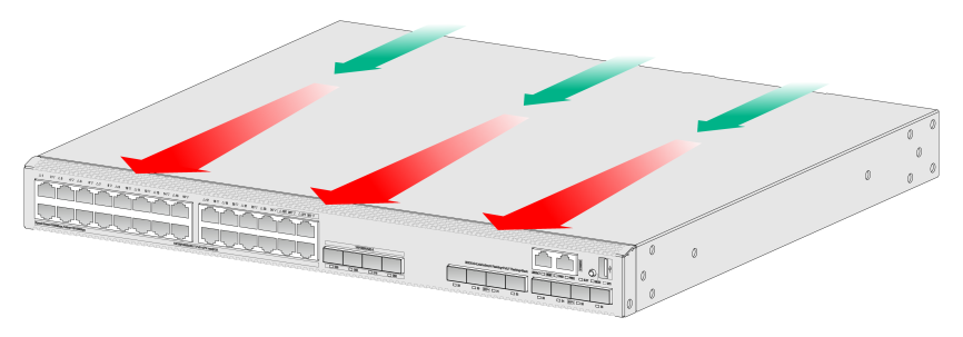

Ventilation aisle
Front-to-rear or rear-to-front airflow, determined by the selected fan tray model

Heat dissipation
Heat dissipation method
Air cooling
Ventilation aisle
Port-to-power supply airflow

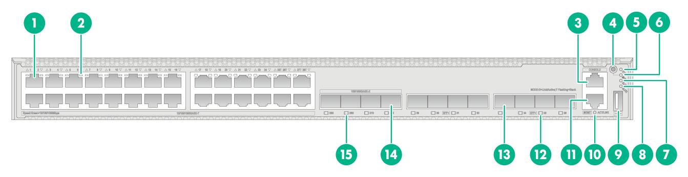

S5590-28T8XC-HI
Figure2-1 Front panel
(1) 10/100/1000BASE-T autosensing Ethernet port
(2) 10/100/1000BASE-T autosensing Ethernet port LED
(3) Console port (CONSOLE)
(4) Mode button
(5) System status LED (SYS)
(6) Mode LED (MODE)
(7) Expansion card status LED 1 (SLOT1)
(8) Expansion card status LED 2 (SLOT2)
(9) USB port
(10) Management Ethernet port LED (ACT/LINK)
(11) Management Ethernet port (MGMT)
(12) SFP+ port LED
(13) SFP+ port
(14) SFP port
(15) SFP port LED

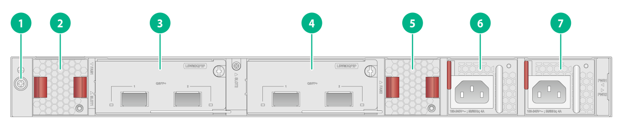

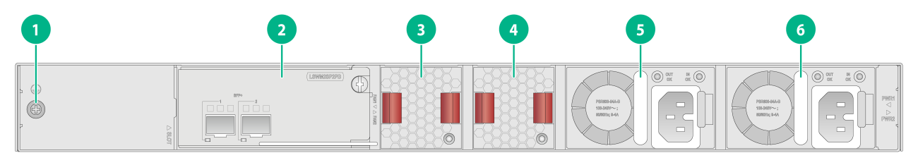

Figure2-2 Rear panel
(1) Grounding screw
(2) Fan tray 1
(3) Expansion card 1
(4) Expansion card 2
(5) Fan tray 2
(6) Power supply 1
(7) Power supply 2
The S5590-28T8XC-HI switch came with power supply slot 1 empty and power supply slot 2 installed with a filler panel. You can install one or two power supplies for the switch as required. In Figure2-2, two PSR250-12A1 AC power supplies are installed in the power supply slots.
The S5590-28T8XC-HI switch came with two fan tray slots empty. You must install two fan trays of the same model for the switch. In Figure2-2, two LSPM1FANSB-SN fan trays are installed in the fan tray slots.
The S5590-28T8XC-HI switch came with two expansion slots each installed with a filler panel. You can select expansion cards for the switch as required. In Figure2-2, two LSWM2QP2P interface cards are installed in the expansion slots.

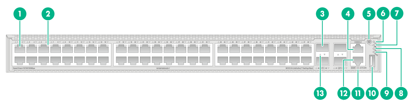

Figure2-3 Front panel
(3) SFP+ port
(4) Console port (CONSOLE)
(5) Mode button
(6) System status LED (SYS)
(7) Mode LED (MODE)
(8) Expansion card status LED 1 (SLOT1)
(9) Expansion card status LED 2 (SLOT2)
(10) USB port
(11) Management Ethernet port LED (ACT/LINK)
(12) Management Ethernet port (MGMT)
(13) SFP+ port LED

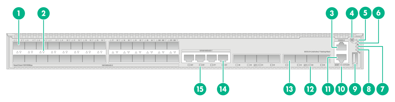

Figure2-5 Front panel
(1) SFP port
(2) SFP port LED
(4) Mode button
(6) Mode LED (MODE)
(9) USB port
(12) SFP+ port LED
(13) SFP+ port
(14) 10/100/1000BASE-T autosensing Ethernet port
(15) 10/100/1000BASE-T autosensing Ethernet port LED

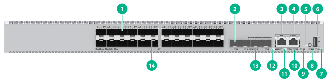

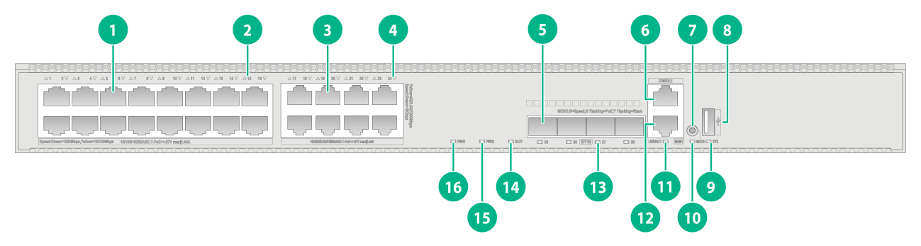

Figure2-9 Front panel
(3) SFP port
(4) SFP+ port
(5) Management Ethernet port (MGMT)
(6) Console port (CONSOLE)
(7) Mode button
(8) USB port
(9) System status LED (SYS)
(10) Mode LED (MODE)
(11) Expansion card status LED (SLOT)
(12) Power supply 2 status LED (PWR2)
(13) Power supply 1 status LED (PWR1)
(14) Management Ethernet port LED (ACT/LINK)
(15) SFP+ port LED
(16) SFP port LED

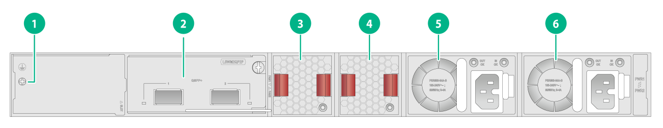

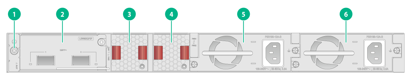

Figure2-10 Rear panel
(1) Grounding screw
(2) Expansion card
(3) Fan tray 1
(4) Fan tray 2
(5) Power supply 1
(6) Power supply 2
The S5590-28T8XC-EI switch came with power supply slot 1 empty and power supply slot 2 installed with a filler panel. You can install one or two power supplies for the switch as required. In Figure2-10, two PSR180-12A-B AC power supplies are installed in the power supply slots.
The S5590-28T8XC-EI switch came with two fan tray slots empty. You must install two fan trays of the same model for the switch. In Figure2-10, two LSPM1FANSB-SN fan trays are installed in the fan tray slots.
The S5590-28T8XC-EI switch came with one expansion slot installed with a filler panel. You can select an expansion card for the switch as required. In Figure2-10, an LSWM2QP2P interface card is installed in the expansion slot.

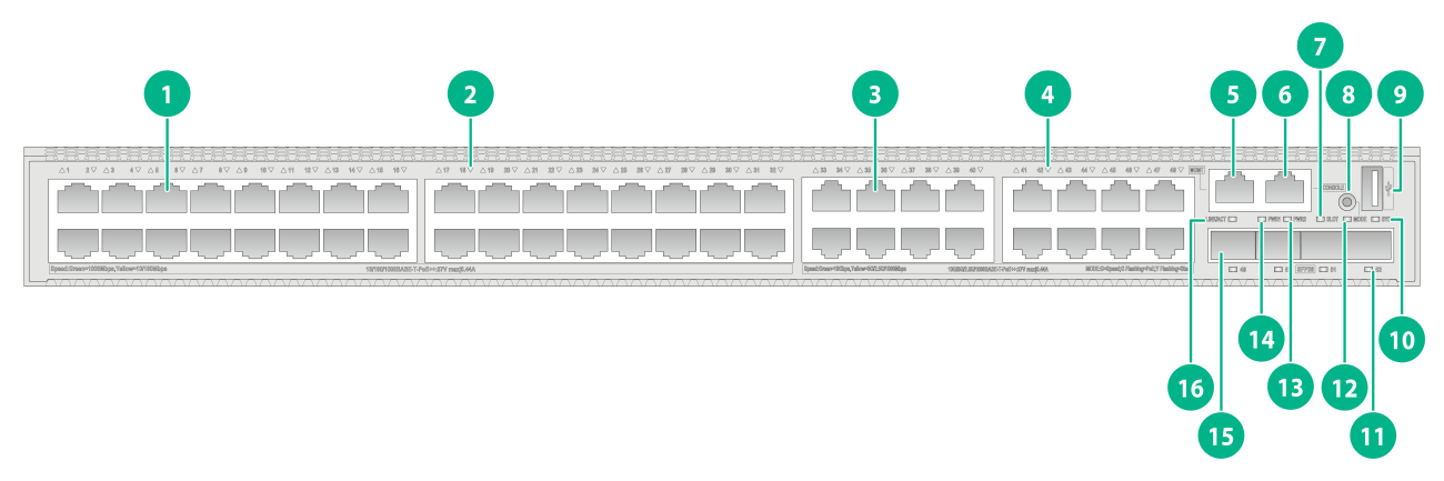

S5590-48T4XC-EI

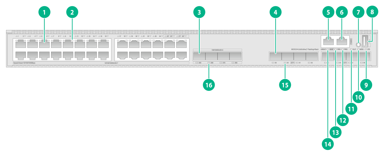

Figure2-11 Front panel
(3) Management Ethernet port (MGMT)
(5) Mode button
(6) USB port
(7) System status LED (SYS)
(8) SFP+ port
(9) Mode LED (MODE)
(10) Expansion card status LED (SLOT)
(11) Power supply 2 status LED (PWR2)
(12) Power supply 1 status LED (PWR1)
(13) Management Ethernet port LED (ACT/LINK)
(14) SFP+ port LED

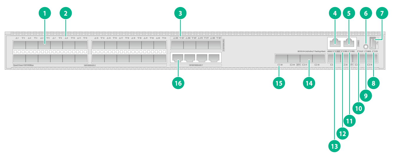

S5590-28S8XC-EI

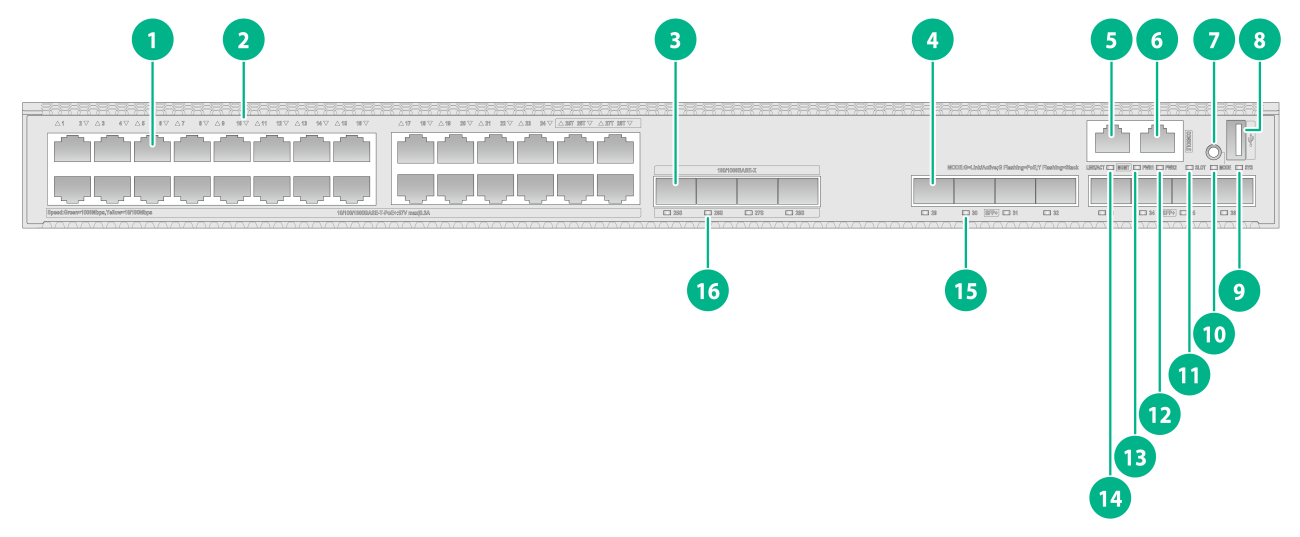

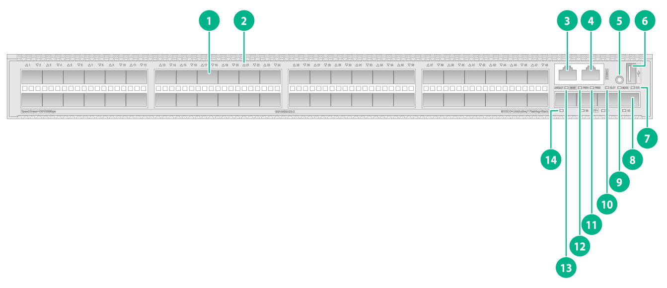

Figure2-13 Front panel
(1) SFP port
(2) SFP port LED
(3) 10/100/1000BASE-T autosensing Ethernet port LED
(4) Management Ethernet port (MGMT)
(5) Console port (CONSOLE)
(6) Mode button
(7) USB port
(8) System status LED (SYS)
(9) Mode LED (MODE)
(14) SFP+ port
(15) SFP+ port LED
(16) 10/100/1000BASE-T autosensing Ethernet port
Figure2-14 Rear panel
(1) Grounding screw
(2) Expansion card
(3) Fan tray 1
(4) Fan tray 2
(5) Power supply 1
(6) Power supply 2
The S5590-28S8XC-EI switch came with power supply slot 1 empty and power supply slot 2 installed with a filler panel. You can install one or two power supplies for the switch as required. In Figure2-14, two PSR180-12A-B AC power supplies are installed in the power supply slots.
The S5590-28S8XC-EI switch came with two fan tray slots empty. You must install two fan trays of the same model for the switch. In Figure2-14, two LSPM1FANSB-SN fan trays are installed in the fan tray slots.
The S5590-28S8XC-EI switch came with one expansion slot installed with a filler panel. You can select an expansion card for the switch as required. In Figure2-14, an LSWM2QP2P interface card is installed in the expansion slot.
The S5590-28S8XC-EI switch with PID LS-5590-28S8XC-EI-GL supports shipping with fan trays and power supplies installed. For the switch to be shipped with fan trays or power supplies installed, contact the marketing staff.

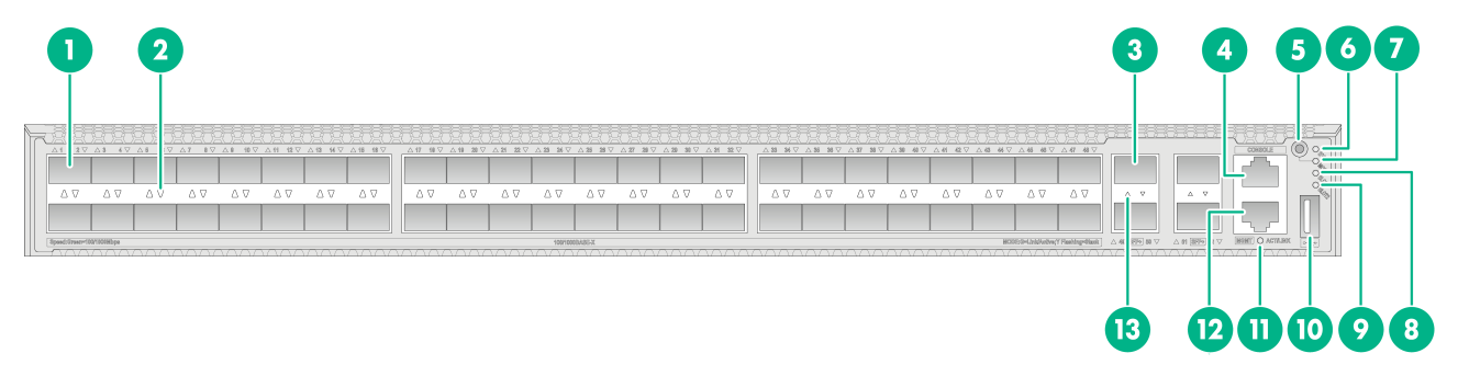

S5590-48S4XC-EI
Figure2-15 Front panel
(1) SFP port
(2) SFP port LED
(5) Mode button
(6) USB port
(8) SFP+ port
(9) Mode LED (MODE)
(14) SFP+ port LED

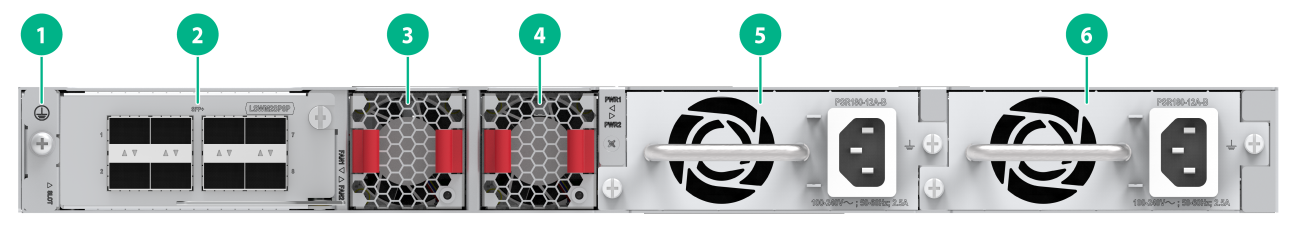

Figure2-16 Rear panel
(1) Grounding screw
(2) Expansion card
(3) Fan tray 1
(4) Fan tray 2
(5) Power supply 1
(6) Power supply 2
The S5590-48S4XC-EI switch came with power supply slot 1 empty and power supply slot 2 installed with a filler panel. You can install one or two power supplies for the switch as required. In Figure2-16, two PSR180-12A-B AC power supplies are installed in the power supply slots.
The S5590-48S4XC-EI switch came with two fan tray slots empty. You must install two fan trays of the same model for the switch. In Figure2-16, two LSPM1FANSB-SN fan trays are installed in the fan tray slots.
The S5590-48S4XC-EI switch came with one expansion slot installed with a filler panel. You can select an expansion card for the switch as required. In Figure2-16, an LSWM2QP2P interface card is installed in the expansion slot.
The S5590-48S4XC-EI switch with PID LS-5590-48S4XC-EI-GL supports shipping with fan trays and power supplies installed. For the switch to be shipped with fan trays or power supplies installed, contact the marketing staff.

Figure2-17 Front panel
(3) SFP port
(4) SFP+ port
(7) Mode button
(8) USB port
(15) SFP+ port LED
(16) SFP port LED
Figure2-18 Rear panel
(1) Grounding screw
(2) Expansion card
(3) Fan tray 1
(4) Fan tray 2
(5) Power supply 1
(6) Power supply 2
The S5590-28P8XC-EI switch came with power supply slot 1 empty and power supply slot 2 installed with a filler panel. You can install one or two power supplies for the switch as required. In Figure2-18, two PSR600-54A-B AC power supplies are installed in the power supply slots.
The S5590-28P8XC-EI switch came with two fan tray slots empty. You must install two fan trays of the same model for the switch. In Figure2-18, two LSPM1FANSB-SN fan trays are installed in the fan tray slots.
The S5590-28P8XC-EI switch came with one expansion slot installed with a filler panel. You can select an expansion card for the switch as required. In Figure2-18, an LSWM2QP2P interface card is installed in the expansion slot.
The S5590-28P8XC-EI switch with PID LS-5590-28P8XC-EI-GL supports shipping with fan trays and power supplies installed. For the switch to be shipped with fan trays or power supplies installed, contact the marketing staff.

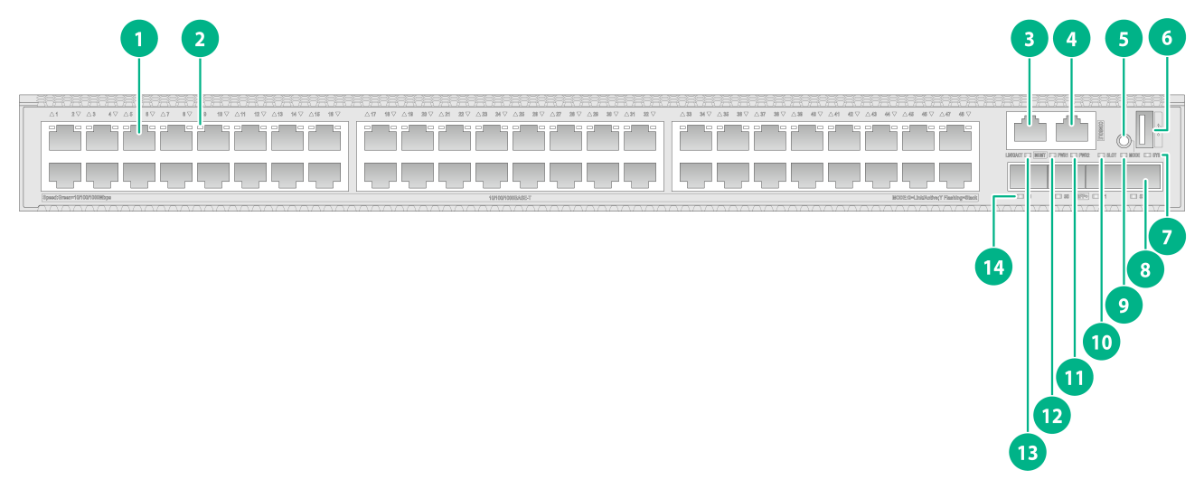

S5590-48P6XC-EI
Figure2-19 Front panel
(3) SFP+ port
(5) Mode LED (MODE)
(7) Power supply 1 status LED (PWR1)
(8) Power supply 2 status LED (PWR2)
(9) Expansion card status LED (SLOT)
(10) USB port
(11) Mode button
(12) Management Ethernet port LED (ACT/LINK)
(13) Management Ethernet port (MGMT)
(14) SFP+ port LED
Figure2-20 Rear panel
(1) Grounding screw
(2) Expansion card
(3) Fan tray 1
(4) Fan tray 2
(5) Power supply 1
(6) Power supply 2
The S5590-48P6XC-EI switch came with power supply slot 1 empty and power supply slot 2 installed with a filler panel. You can install one or two power supplies for the switch as required. In Figure2-20, two PSR600-54A-B AC power supplies are installed in the power supply slots.
The S5590-48P6XC-EI switch came with two fan tray slots empty. You must install two fan trays of the same model for the switch. In Figure2-20, two LSPM1FANSB-SN fan trays are installed in the fan tray slots.
The S5590-48P6XC-EI switch came with one expansion slot installed with a filler panel. You can select an expansion card for the switch as required. In Figure2-20, an LSWM2QP2P interface card is installed in the expansion slot.
The S5590-48P6XC-EI switch with PID LS-5590-48P6XC-EI-GL supports shipping with fan trays and power supplies installed. For the switch to be shipped with fan trays or power supplies installed, contact the marketing staff.
S5590-24X4YC-EI
Figure2-21 Front panel
(1) SFP+ port
(2) SFP28 port
(5) Mode button
(6) USB port
(8) Mode LED (MODE)
(10) Power supply 2 status LED (PWR2)
(11) Power supply 1 status LED (PWR1)
(12) Management Ethernet port LED (LINK/ACT)
(13) SFP28 port LED (SFP28)
(14) SFP+ port LED
Figure2-22 Rear panel
(1) Grounding screw
(2) Expansion card
(3) Fan tray 1
(4) Fan tray 2
(5) Power supply 1
(6) Power supply 2
The S5590-24X4YC-EI switch came with power supply slot 1 empty and power supply slot 2 installed with a filler panel. You can install one or two power supplies for the switch as required. In Figure2-22, two PSR180-12A-B AC power supplies are installed in the power supply slots.
The S5590-24X4YC-EI switch came with two fan tray slots empty. You must install two fan trays of the same model for the switch. In Figure2-22, two LSPM1FANSB-SN fan trays are installed in the fan tray slots.
The S5590-24X4YC-EI switch came with one expansion slot installed with a filler panel. You can select an expansion card for the switch as required. In Figure2-22, an LSWM2SP8P interface card is installed in the expansion slot.

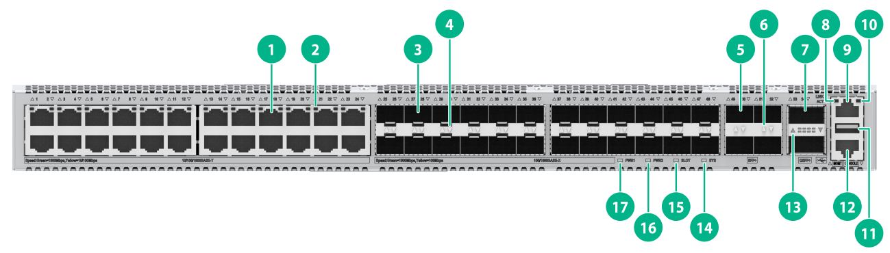

S5590-48TS4X2QC-EI
Figure2-23 Front panel
(3) SFP port
(4) SFP port LED
(5) SFP+ port
(6) SFP+ port LED
(7) QSFP+ port
(8) Management Ethernet port LED (ACT)
(9) Management Ethernet port (MGMT)
(10) Management Ethernet port LED (LINK)
(11) USB port
(12) Console port (CONSOLE)
(13) QSFP+ port LED
(14) System status LED (SYS)
(15) Expansion card status LED (SLOT)
(16) Power supply 2 status LED (PWR2)
(17) Power supply 1 status LED (PWR1)
Figure2-24 Rear panel
(1) Grounding screw
(2) Expansion card
(3) Fan tray 1
(4) Fan tray 2
(5) Power supply 1
(6) Power supply 2
The S5590-48TS4X2QC-EI switch came with power supply slot 1 empty and power supply slot 2 installed with a filler panel. You can install one or two power supplies for the switch as required. In Figure2-24, two PSR180-12A-B AC power supplies are installed in the power supply slots.
The S5590-48TS4X2QC-EI switch came with two fan tray slots empty. You must install two fan trays of the same model for the switch. In Figure2-24, two LSPM1FANSB-SN fan trays are installed in the fan tray slots.
The S5590-48TS4X2QC-EI switch came with one expansion slot installed with a filler panel. You can select an expansion card for the switch as required. In Figure2-24, an LSWM2SP8P interface card is installed in the expansion slot.
S5590-24UXM4YC-EI
Figure2-25 Front panel
(3) 10G/5G/2.5G/1000 BASE-T autosensing Ethernet port
(4) 10G/5G/2.5G/1000 BASE-T autosensing Ethernet port LED
(5) SFP28 port
(7) Mode button
(8) USB port
(11) Management Ethernet port LED (LINK/ACT)
(13) SFP28 port LED
(14) Expansion card status LED (SLOT)
(15) Power supply 2 status LED (PWR2)
(16) Power supply 1 status LED (PWR1)
Figure2-26 Rear panel
(1) Grounding screw
(2) Expansion card
(3) Fan tray 1
(4) Fan tray 2
(5) Power supply 1
(6) Power supply 2
The S5590-24UXM4YC-EI switch came with power supply slot 1 empty and power supply slot 2 installed with a filler panel. You can install one or two power supplies for the switch as required. In Figure2-26, two PSR600-54A-B AC power supplies are installed in the power supply slots.
The S5590-24UXM4YC-EI switch came with two fan tray slots empty. You must install two fan trays of the same model for the switch. In Figure2-26, two LSPM1FANSB-SN fan trays are installed in the fan tray slots.
The S5590-24UXM4YC-EI switch came with one expansion slot installed with a filler panel. You can select an expansion card for the switch as required. In Figure2-26, an LSWM2SP2PB interface module is installed in the expansion slot.
S5590-48UXM4YC-EI
Figure2-27 Front panel
(7) Expansion card status LED (SLOT)
(8) Mode button
(9) USB port
(10) System status LED (SYS)
(11) SFP28 port LED
(12) Mode LED (MODE)
(13) Power supply 2 status LED (PWR2)
(14) Power supply 1 status LED (PWR1)
(15) SFP28 port
(16) Management Ethernet port LED (LINK/ACT)
Figure2-28 Rear panel
(1) Grounding screw
(2) Expansion card
(3) Fan tray 1
(4) Fan tray 2
(5) Power supply 1
(6) Power supply 2
The S5590-48UXM4YC-EI switch came with power supply slot 1 empty and power supply slot 2 installed with a filler panel. You can install one or two power supplies for the switch as required. In Figure2-28, two PSR600-54A-B AC power supplies are installed in the power supply slots.
The S5590-48UXM4YC-EI switch came with two fan tray slots empty. You must install two fan trays of the same model for the switch. In Figure2-28, two LSPM1FANSB-SN fan trays are installed in the fan tray slots.
The S5590-48UXM4YC-EI switch came with one expansion slot installed with a filler panel. You can select an expansion card for the switch as required. In Figure2-28, an LSWM2SP2PB interface module is installed in the expansion slot.

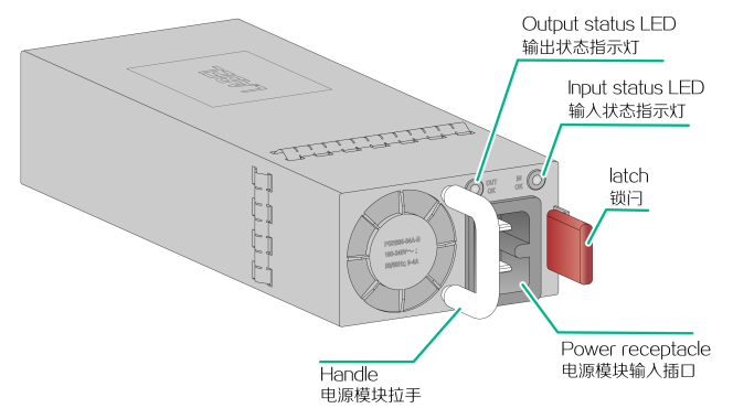

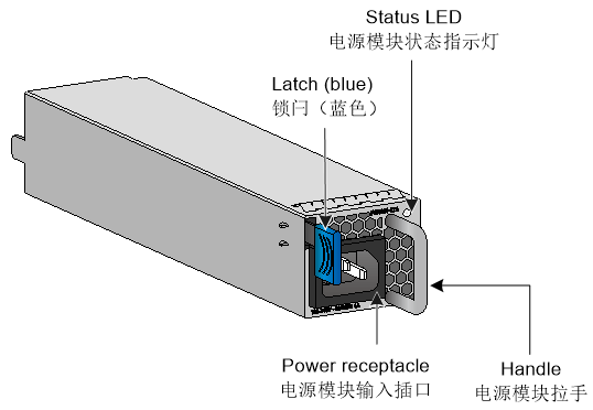

250W power supplies (PSR250-12A and PSR250-12A1)
View
Figure4-1 PSR250-12A AC power supply view
The views of the PSR250-12A and PSR250-12A1 AC power supplies are similar, with only differences in the latch color and identifier.
For information about the status LED, see "Status LED on a PSR250-12A/PSR250-12A1 power supply."
Features
PSR250-12A and PSR250-12A1 are AC power supplies with AC or HVDC input and DC output. Table4-1 describes the features provided by the PSR250-12A and PSR250-12A1 power supplies.
Table4-1 Features provided by the PSR250-12A and PSR250-12A1 power supplies
Feature
Description
Protection function
Protection against input overcurrent, input undervoltage, output overvoltage, output current limiting, output shortcircuit, and overtemperature conditions.
Support for redundancy
Two power supplies can be connected in parallel to achieve 1+1 redundancy and load balancing.
Support for hot swapping
You can remove one of the power supplies in 1+1 redundancy when the switch is operating correctly.
Technical specifications
Table4-2 Technical specifications
Item
Specification
Dimensions (H × W × D)
40.2 × 50.5 × 246 mm (1.58 × 1.99 × 9.69 in), including the handle
Weight
0.6 kg (1.32 lb)
Rated AC input voltage range
AC input: 100 VAC to 240 VAC @ 50 or 60 Hz
HVDC input: 240 VDC
Max AC input voltage range
AC input: 90 VAC to 290 VAC @ 47 to 63 Hz
HVDC input: 180 to 320 VDC
Rated input current
2 A to 4 A
Rated output current
2.5 A to 5 A
Rated output voltage
3.3 V to 12 V
Rated output power
250 W
Melting current of power supply fuse
15 A/250 V

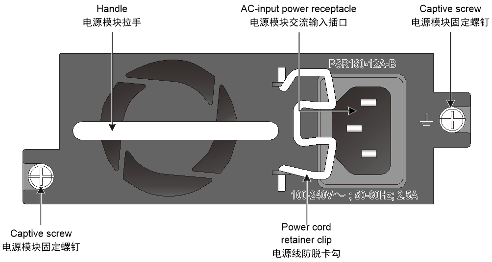

180W AC power supplies (PSR180-12A-F and PSR180-12A-B)
View
Figure4-2 PSR180-12A-B AC power supply view
The views of the PSR180-12A-F and PSR180-12A-B AC power supplies are similar, with only differences in the identifier.

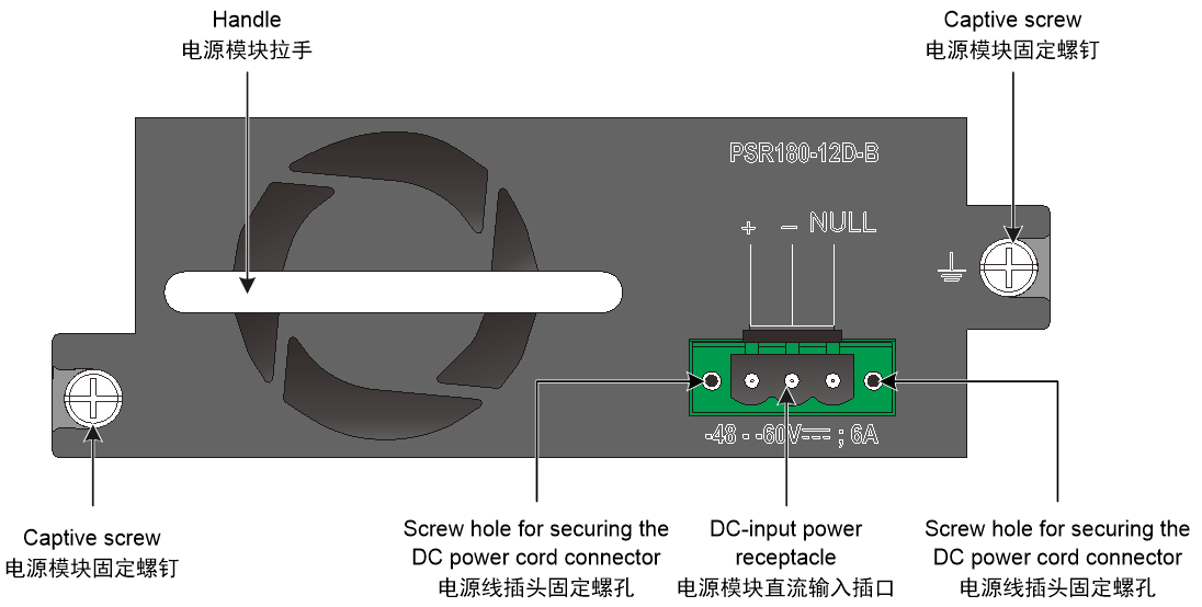

180W DC power supply (PSR180-12D-B)
View
Figure4-3 PSR180-12D-B DC power supply view
Features
PSR180-12D-B is a DC power supply with DC input and DC output. The power supply provides an output voltage of 12 V and a maximum output of 180 W. Table4-5 describes the features provided by the PSR180-12D-B power supply.
Table4-5 Features provided by the PSR180-12D-B power supply
Feature
Description
Protection function
Table4-6 Technical specifications
Item
Specification
41.1 × 101.6 × 207 mm (1.62 × 4.00 × 8.15 in), including the handle
Weight
1 kg (2.20 lb)
Rated input voltage range
–48 to –60 VDC
Max input voltage range
–36 to –72 VDC
Rated input current
N/A
15 A
12 V
Rated output power
180 W
8 A/125 V
600W power supply (PSR600-54A-B)
View
Figure4-4 PSR600-54A-B AC power supply view
For information about the status LEDs, see "Status LEDs on a 600W/920W/1600W power supply."
Features
PSR600-54A-B is an AC power supply with AC or HVDC input and DC output. Table4-7 describes the features provided by the PSR600-54A-B power supply.
Table4-7 Features provided by the PSR600-54A-B power supply
Feature
Description
Protection function
Table4-8 Technical specifications
Item
Specification
40.2 × 73.5 × 213.8 mm (1.58 × 2.89 × 8.42 in), including the handle
Weight
1 kg (2.20 lb)
HVDC input: 240 VDC
Rated input current
N/A
11 A
56 V
Rated output power
600 W
10 A/250 V

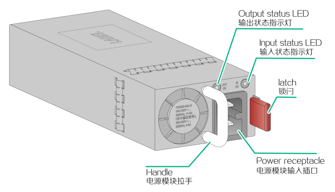

920W power supply (PSR920-54A-B)
View
Figure4-5 PSR920-54A-B AC power supply view

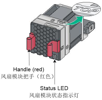

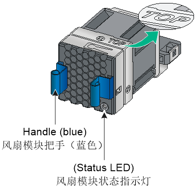

5 Removable fan trays
LSPM1FANSA-SN
View
Figure5-1 LSPM1FANSA-SN fan tray view
For information about the status LED, see "Fan tray status LED on a fan tray."
Features
The LSPM1FANSA-SN fan tray blows air from the power supply side to the port side. The fan tray features small size, fast heat dissipation, and hot swapping. It can automatically adjust the fan speed, providing powerful heat dissipation for the switch.
Table5-1 Technical specifications
Item
Specification
40 × 40.6 × 105 mm (1.57 × 1.60 × 4.13 in), including the handle
Fan quantity
1
Weight
N/A
Airflow direction
Air drawn in from the fan tray faceplate
Fan speed
20000 R.P.M
Max airflow
20 CFM (0.57 m3/min)
Input voltage
12 V
Max power consumption
9.8 W
LSPM1FANSB-SN
View
Figure5-2 LSPM1FANSB-SN fan tray view
Features
The LSPM1FANSB-SN fan tray draws air from the port side to the power supply side. The fan tray features small size, fast heat dissipation, and hot swapping. It can automatically adjust the fan speed, providing powerful heat dissipation for the switch.
Table5-2 Technical specifications
Item
Specification
Fan quantity
1
Weight
N/A
Airflow direction
Air exhausted from the fan tray faceplate
Fan speed
20000 R.P.M
Max airflow
Input voltage
12 V
9.8 W

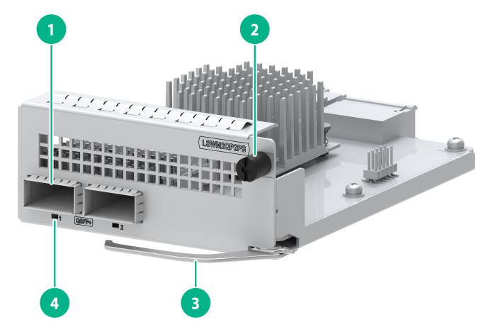

6 Expansion cards
LSWM2QP2P
About LSWM2QP2P
The LSWM2QP2P interface card provides two QSFP+ ports.
Figure6-1 LSWM2QP2P interface card view
Ports and LEDs
For information about the ports and transceiver modules and cables available for the ports, see "QSFP+ port."
For information about the LEDs, see "QSFP+ port LED."

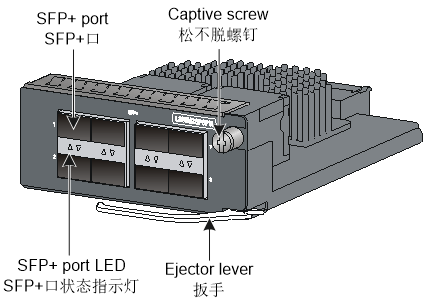

The LSWM2SP8PM and LSWM2SP8P interface cards each provide eight SFP+ ports. The SFP+ ports on the LSWM2SP8PM interface card support MACsec. The views of LSWM2SP8P and LSWM2SP8PM are the same. This figure uses the LSWM2SP8P as an example.
Figure6-2 LSWM2SP8P interface card view
Ports and LEDs
For information about the ports and transceiver modules and cables available for the ports, see "SFP port" and "SFP+ port."
For information about the LEDs, see "LEDs on an LSWM2SP8P/LSWM2SP8PM interface card."

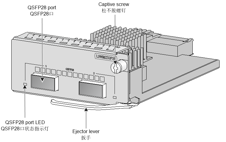

LSWM2ZQP2P
About LSWM2ZQP2P
The LSWM2ZQP2P interface module provides two QSFP28 ports.
Figure6-3 LSWM2ZQP2P interface module view
Ports and LEDs
For information about the ports and transceiver modules and cables available for the ports, see "QSFP+ port" and "QSFP28 ports."
For information about the LEDs, see "QSFP28 port LED."

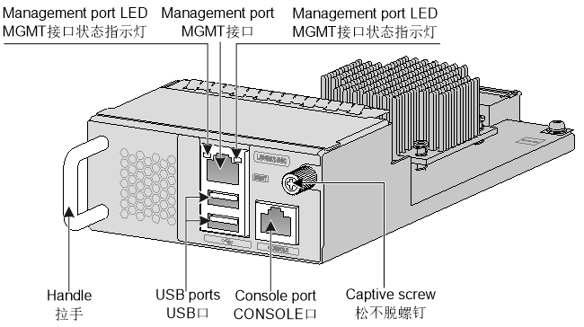

The LSWM2EC EPS scanner module scans network-wide endpoints as instructed by the EPS server for port type and operating system type automatically and sends scanning results to the EPS server. Upon receiving the port information, the EPS server provides a baseline management over the endpoints that access the network system. By using this module on a switch, you can save hardware resources, increase the number of endpoints that can be scanned, and perform incremental scanning.
Figure6-5 LSWM2EC EPS scanner module view
LEDs
For information about the management port LEDs, see "LEDs on an LSWM2EC EPS scanner module."

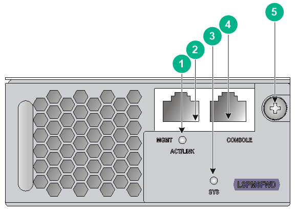

LSPM6FWD
About LSPM6FWD
The LSPM6FWD is a fourth-generation high performance firewall module. It provides features including firewall, VPN, content filtering, content identification, URL filtering, and NAT. By using this module on a switch, you can enhance the switch security capabilities without changing the network topology.
Figure6-7 LSPM6FWD front panel
(1) Management Ethernet port LED (ACT/LINK)
(2) 10/100/1000BASE-T management Ethernet port
(3) System status LED (SYS)
(5) Captive screw
Ports and LEDs
For information about the ports and transceiver modules and cables available for the ports, see "Ports on an LSPM6FWD firewall module."
For information about the LEDs, see "LEDs on an LSPM6FWD firewall module."

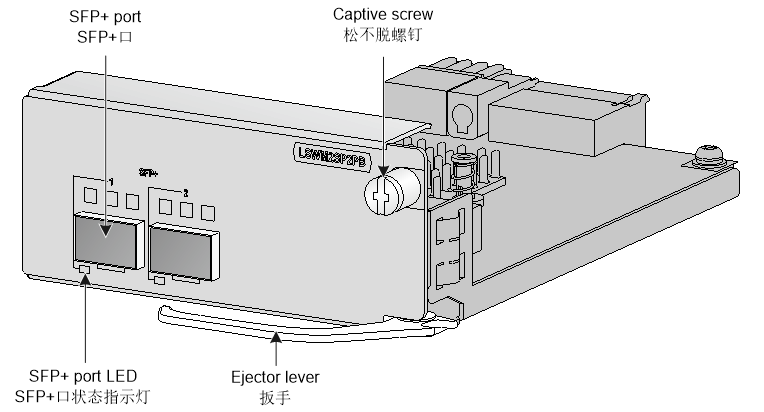

LSWM2SP2PB
About LSWM2SP2PB
The LSWM2SP2PB interface module provides two SFP+ ports.
Figure6-8 LSWM2SP2PB interface module view
Ports and LEDs

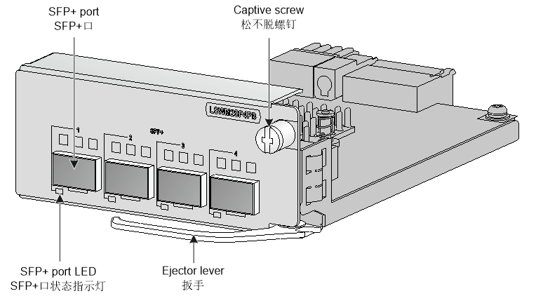

LSWM2SP4PB
About LSWM2SP4PB
The LSWM2SP4PB interface module provides four SFP+ ports.
Figure6-9 LSWM2SP4PB interface module view
Ports and LEDs

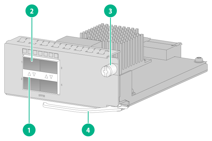

LSWM2ZSP4P
About LSWM2ZSP4P
The LSWM2ZSP4P interface module provides four SFP28 ports.
Figure6-10 LSWM2ZSP4P interface module view
(1) SFP28 port LED
(2) SFP28 port
(3) Captive screw
(4) Ejector lever
Ports and LEDs
For information about the ports and transceiver modules and cables available for the ports, see "SFP+ port" and "SFP28 port."
For information about the LEDs, see "SFP28 port LED."

LSWM2QP2PB
About LSWM2QP2PB
The LSWM2QP2PB interface module provides two QSFP+ ports.
Figure6-11 LSWM2QP2PB interface module view
(1) QSFP+ port
(2) Captive screw
(3) Ejector lever
(4) QSFP+ port LED
Ports and LEDs
Table6-6 Technical specifications
Item
Specification
40.1 × 95 × 147.5 mm (1.58 × 3.74 × 5.81 in)
Weight
0.4 kg (0.88 lb)
Power consumption (static)
9 W
Power consumption (with typical configuration)
10 W
Power consumption (fully configured)
14 W

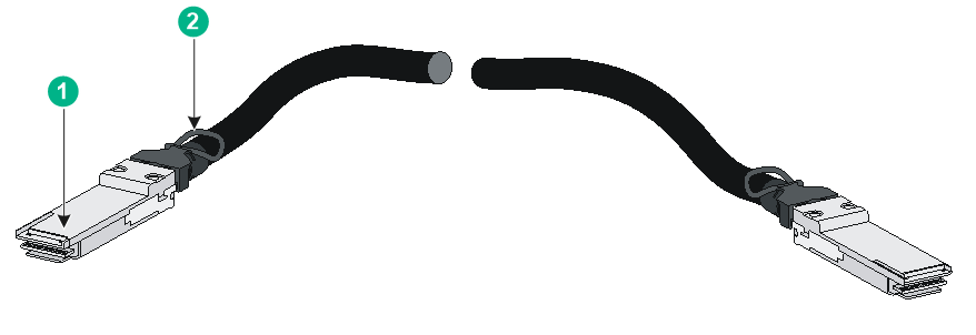

Figure7-1 SFP+ cable
(1) Connector
(2) Pull latch

Figure7-2 SFP28 cable
(1) Connector
(2) Pull latch

QSFP+ port
Each LSWM2QP2P interface card or S5590-48TS4X2QC-EI switch provides two QSFP+ ports. You can install the QSFP+ transceiver modules in Table7-13, QSFP+ copper cables in Table7-14, and QSFP+ fiber cables in Table7-15.

QSFP28 ports
QSFP28 ports support the following transceiver modules and cables:
·     QSFP28 transceiver modules in Table7-16.
·     QSFP28 fiber cables in Table7-17.
·     QSFP28 fiber cables in Table7-18.
·     QSFP+ transceiver modules in Table7-13.
·     QSFP+ copper cables in Table7-14.
·     QSFP+ fiber cables in Table7-15.

Figure7-4 100G QSFP28 copper cable
(1) Connector
(2) Pull tab
The LSPM1FANSA-SN and LSPM1FANSB-SN fan trays each have a LED to indicate the fan tray operating status.
Table7-40 Fan tray status LED description
Status
Description
On
The fan tray is faulty.
Off
The fan tray is operating correctly.
The PSR250-12A and PSR250-12A1 power supplies each have a LED to indicate the power input and output status.
Table7-41 Description for the status LED on a PSR250-12A/PSR250-12A1 power supply
LED status
Description
Steady green
The power supply is operating correctly in active state.
Flashing green
The power supply is operating correctly in standby state.
Steady red
The power supply has failed or entered protection state.
Red/Green flashing alternatively
The power supply has an output overvoltage, output undervoltage, output overcurrent, output overload, or overtemperature alarm but has not entered protection state.
Flashing red
The power supply does not have power input. If two power supplies are installed and only one power supply has power input, the status LED of the power supply that does not have power input flashes red.
Off
The PSR600-54A-B, PSR920-54A-B, and PSR1600-54A-B power supplies each have two status LEDs to indicate the power input and output status.
Table7-42 Description for the status LEDs on a 600W/920W/1600W power supply
LED
Mark
Status
Description
Output status LED
OUT OK
Steady green
Normal power output.
Steady red
Abnormal power output.
Off
No power output
Input status LED
IN OK
Steady green
Normal power input.
Steady red
Abnormal power input.
Off
No power input.
The LSWM2SP8P and LSWM2SP8PM interface cards each provide eight SFP+ ports.
Table7-43 SFP+ port LED description
LED status
Description
Steady green
A module has been installed and the port is operating at 10 Gbps.
Flashing green
The port is sending or receiving data at 10 Gbps.
Steady yellow
A module has been installed and the port is operating at 1 Gbps.
Flashing yellow
The port is sending or receiving data at 1 Gbps.
Off
No module has been installed or no link is present on the port.
Table7-44 Management port LED description
LED status
Description
Steady green
The port is operating at 1000/100/10 Mbps.
Flashing green
The port is sending or receiving data at 1000/100/10 Mbps.
Off
No link is present on the port.
Table7-45 Description for the LEDs on an LSPM6FWD firewall module
LED
Mark
Status
Description
ACT/LINK
Off
Steady green
A link is present on the port.
Flashing green
The port is sending or receiving data.
System status LED
SYS
Off
No power is input or the firewall module has failed.
Slowly flashing green
The system has started up and is operating correctly.
Fast flashing green
The system is loading software.

8 Cooling system
To dissipate heat timely and enhance system stability, the switch uses a high-performance cooling system. Consider the site ventilation design when you plan the installation site for the switch.
The switch uses removable fan trays and provides airflow from the port side to the power supply side or from the power supply side to the port side by using different types of fan trays. You must install both fan trays of the same model for the switch. Table8-1 describes the fan trays available for the switch.
Table8-1 Fan trays available for the switch
Switch model
Fan tray model
Airflow direction
S5590-28T8XC-HI
S5590-48T4XC-HI
S5590-28S8XC-HI
S5590-48S4XC-HI
S5590-28T8XC-EI
S5590-48T4XC-EI
S5590-28S8XC-EI
S5590-48S4XC-EI
S5590-28P8XC-EI
S5590-48P6XC-EI
S5590-24X4YC-EI
S5590-48TS4X2QC-EI
LSPM1FANSA-SN
From the power supply side to the port side
LSPM1FANSB-SN
From the port side to the power supply side
S5590-24UXM4YC-EI
S5590-48UXM4YC-EI
LSPM1FANSB-SN
Figure8-1 Airflow direction for LSPM1FANSA-SN (S5590-28P8XC-EI)
Figure8-2 Airflow direction for LSPM1FANSB-SN (S5590-28P8XC-EI)
