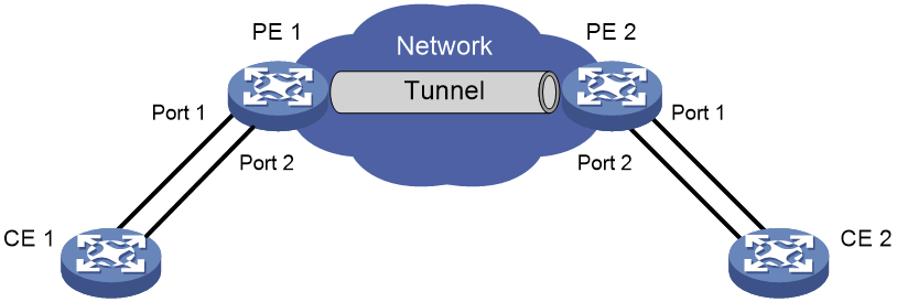

Enabling transparent LACPDU transmission
To establish a dynamic aggregation between two remote CEs in an L2VPN network, use transparent LACPDU transmission on the PEs to which the CEs are attached, as shown in Figure 6.
This feature enables the PEs to forward LACPDUs for the CEs to establish a dynamic aggregation.
If this feature is disabled, the PEs terminate the LACPDUs. The remote CEs cannot establish dynamic aggregations.
Figure 6 Application scenario of transparent LACPDU transmission
Perform the following tasks on PEs:
1.     Configure the untagged or default frame match criterion for the Ethernet service instances on the interfaces connected to CEs.
2.     Map the Ethernet service instances to different VSIs and set the access mode to Ethernet for the VSIs.
For more information about L2VPN and Ethernet service instances, see L2VPN configuration in MPLS Configuration Guide.
When you use this feature on the PEs, follow these guidelines:
·     Enable transparent LACPDU transmission on the interfaces that transmit traffic between CEs and PEs and between PEs.
·     Do not use an interface for dynamic link aggregation if you enable transparent LACPDU transmission on that interface. With transparent LACPDU transmission enabled, an interface cannot be selected for aggregation.
2.     Enter interface view.
3.     Enable transparent LACPDU transmission.
lacp transparent enable
By default, transparent LACPDU transmission is disabled.

Enabling local-first load sharing for link aggregation
Use local-first load sharing in a multidevice link aggregation scenario to distribute traffic preferentially across member ports on the ingress slot.
When you aggregate ports on different member devices in an IRF fabric, you can use local-first load sharing to reduce traffic on IRF links, as shown in Figure 7. For more information about IRF, see Virtual Technologies Configuration Guide.
Figure 7 Load sharing for multidevice link aggregation in an IRF fabric
Enabling local-first load sharing for link aggregation globally
2.     Enable local-first load sharing for link aggregation globally.
link-aggregation load-sharing mode local-first
By default, local-first load sharing is enabled globally.
