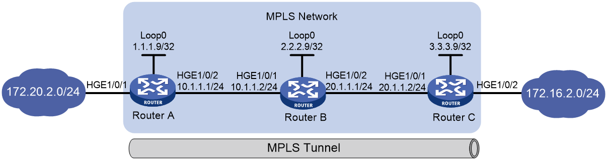

Example: Configuring static LSPs
As shown in Figure 1, establish static LSPs between Router A and Router C to allow communication between subnets 172.20.2.0/24 and 172.16.2.0/24 over the MPLS network.
Figure 1 Network diagram
Analysis
LSPs are unidirectional. To ensure that data can be bidirectionally forwarded, configure an LSP for each direction of the data forwarding path, and specify the ingress, transit, and egress nodes for each LSP.
To direct traffic to an LSP for MPLS forwarding, make sure the ingress node has a route to the FEC destination of the LSP. This example uses a static route. Route configuration is not needed on the transit and egress nodes.

Procedures
1.     Configure IP addresses and masks for interfaces, including the loopback interfaces, as shown in Figure 1. (Details not shown.)
2.     Configure a static route to the destination address of each LSP:
# Configure a static route to the FEC destination of the LSP from Router A to Router C.
<RouterA> system-view
[RouterA] ip route-static 172.16.2.1 24 10.0.3.2
# Configure a static route to the FEC destination of the LSP from Router C to Router A.
<RouterC> system-view
[RouterC] ip route-static 172.20.2.1 24 10.0.6.1
# Verify that the static route has been created on the ingress nodes, for example, on Router A.
[RouterA] display ip routing-table
Destinations : 13        Routes : 13
0.0.0.0/32          Direct 0    0            127.0.0.1       InLoop0
172.16.2.1/24       Static 60   0            10.0.3.2        HGE1/0/2
10.0.3.0/24         Direct 0    0            10.0.3.1        HGE1/0/2
10.0.3.0/32         Direct 0    0            10.0.3.1        HGE1/0/2
10.0.3.1/32         Direct 0    0            127.0.0.1       InLoop0
1.1.1.9/32          Direct 0    0            127.0.0.1       InLoop0
127.0.0.0/8         Direct 0    0            127.0.0.1       InLoop0
127.0.0.0/32        Direct 0    0            127.0.0.1       InLoop0
127.0.0.1/32        Direct 0    0            127.0.0.1       InLoop0
127.255.255.255/32  Direct 0    0            127.0.0.1       InLoop0
224.0.0.0/4         Direct 0    0            0.0.0.0         NULL0
224.0.0.0/24        Direct 0    0            0.0.0.0         NULL0
255.255.255.255/32  Direct 0    0            127.0.0.1       InLoop0
3.     Configure basic MPLS on the switches:
# Configure Router A.
[RouterA] mpls lsr-id 1.1.1.9
[RouterA] interface hundredgige 1/0/2
[RouterA-HundredGigE1/0/2] mpls enable
[RouterA-HundredGigE1/0/2] quit
# Configure Router B.
[RouterB] mpls lsr-id 2.2.2.9
[RouterB] interface hundredgige 1/0/1
[RouterB-HundredGigE1/0/1] mpls enable
[RouterB-HundredGigE1/0/1] quit
[RouterB] interface hundredgige 1/0/2
[RouterB-HundredGigE1/0/2] mpls enable
[RouterB-HundredGigE1/0/2] quit
# Configure Router C.
[RouterC] mpls lsr-id 3.3.3.9
[RouterC] interface hundredgige 1/0/1
[RouterC-HundredGigE1/0/1] mpls enable
[RouterC-HundredGigE1/0/1] quit
4.     Configure a static LSP from Router A to Router C:
# Configure the ingress node Router A. Specify the LSP name as AtoC, destination address as 172.16.2.1/24, next hop as 10.0.3.2, and outgoing label as 30.
[RouterA] static-lsp ingress AtoC destination 172.16.2.1 24 nexthop 10.0.3.2 out-label 30
# Configure the transit node Router B. Specify the LSP name as AtoC, incoming label as 30, next hop as 10.0.6.2, and outgoing label as 50.
[RouterB] static-lsp transit AtoC in-label 30 nexthop 10.0.6.2 out-label 50
# Configure the egress node Router C. Specify the LSP name as AtoC and incoming label as 50.
[RouterC] static-lsp egress AtoC in-label 50
5.     Configure a static LSP from Router C to Router A:
# Configure the ingress node Router C. Specify the LSP name as CtoA, destination address as 172.20.2.1/24, next hop as 10.0.6.1, and outgoing label as 40.
[RouterC] static-lsp ingress CtoA destination 172.20.2.1 24 nexthop 10.0.6.1 out-label 40
# Configure the transit node Router B. Specify the LSP name as CtoA, incoming label as 40, next hop as 10.0.3.1, and outgoing label as 70.
[RouterB] static-lsp transit CtoA in-label 40 nexthop 10.0.3.1 out-label 70
# Configure the egress node Router A. Specify the LSP name as CtoA and incoming label as 70.
[RouterA] static-lsp egress CtoA in-label 70
# Display static LSP information on switches, for example, on Router A.
[RouterA] display mpls static-lsp
Total: 2
Name            FEC                In/Out Label Nexthop/Out Interface    State
AtoC            172.16.2.1/24      NULL/30      10.0.3.2                 Up
CtoA            -/-                70/NULL      -                        Up
# Test the connectivity of the LSP from Router A to Router C.
[RouterA] ping mpls -a 172.20.2.1 ipv4 172.16.2.0 24
MPLS ping FEC 172.16.2.0/24 with 100 bytes of data:
100 bytes from 10.0.6.2: Sequence=1 time=3 ms
100 bytes from 10.0.6.2: Sequence=2 time=2 ms
100 bytes from 10.0.6.2: Sequence=3 time=2 ms
100 bytes from 10.0.6.2: Sequence=4 time=2 ms
100 bytes from 10.0.6.2: Sequence=5 time=27 ms
--- Ping statistics for FEC 172.16.2.0/24 ---
5 packets transmitted, 5 packets received, 0.0% packet loss
Round-trip min/avg/max = 2/7/27 ms
# Test the connectivity of the LSP from Router C to Router A.
[RouterC] ping mpls -a 172.16.2.1 ipv4 172.20.2.0 24
MPLS ping FEC 172.20.2.0/24 with 100 bytes of data:
100 bytes from 10.0.3.2: Sequence=1 time=3 ms
100 bytes from 10.0.3.2: Sequence=2 time=2 ms
100 bytes from 10.0.3.2: Sequence=3 time=2 ms
100 bytes from 10.0.3.2: Sequence=4 time=2 ms
100 bytes from 10.0.3.2: Sequence=5 time=27 ms
--- Ping statistics for FEC 172.20.2.0/24 ---

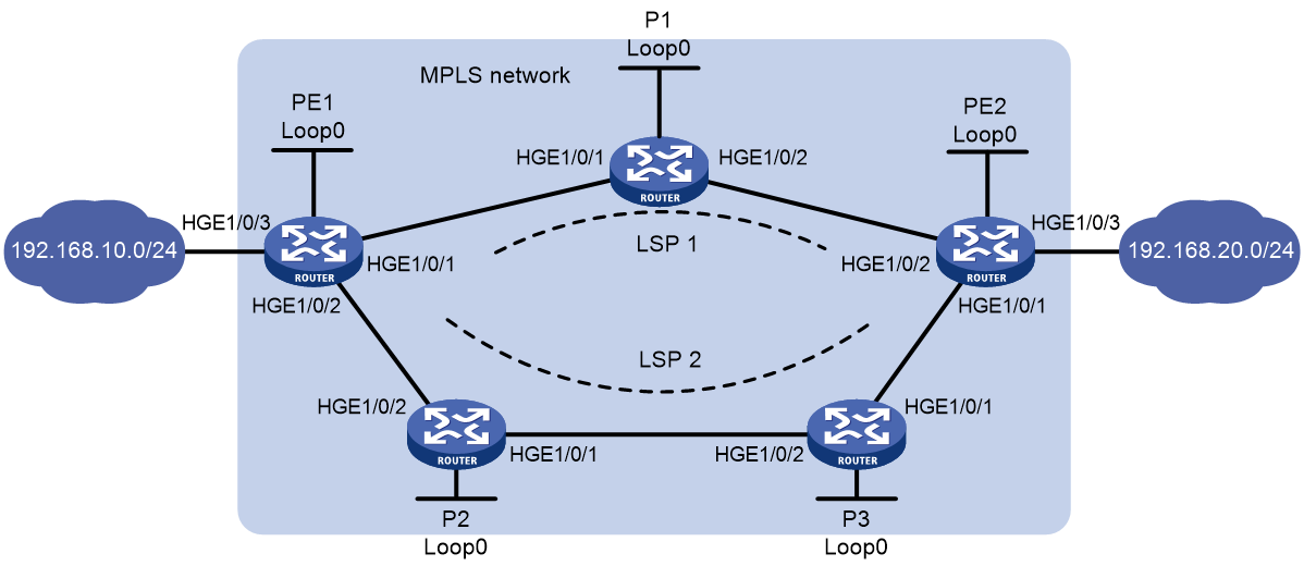

Example: Configuring LDP LSPs
As shown in Figure 2, two paths are available for PE 1 and PE 2 to communicate with each other.
·     Configure LDP to establish LSPs between PE 1 and PE 2 to allow communication between subnets 192.168.10.0/24 and 192.168.20.0/24 over the MPLS network.
¡     Use LSP 1 as the primary path.
¡     Use LSP 2 as the backup path, which takes over LSP 1 when LSP 1 fails.
·     Configure LDP to establish LSPs only for destinations 1.1.1.1/32, 2.2.2.2/32, 3.3.3.3/32, 4.4.4.4/32, 5.5.5.5/32, 192.168.10.0/24, and 192.168.20.0/24.
Figure 2 Network diagram
Device
Interface
IP address
Device
Interface
IP address
PE 1
Loop0
1.1.1.1/32
P 3
Loop0
5.5.5.5/32
HE1/0/1
12.12.12.1/24
HE1/0/1
35.35.35.5/24
HE1/0/2
14.14.14.1/24
HE1/0/2
45.45.45.5/24
HE1/0/3
192.168.10.1/24
PE 1
Loop0
3.3.3.3/32
P 1
Loop0
2.2.2.2/32
HE1/0/1
35.35.35.3/24
HE1/0/1
12.12.12.2/24
HE1/0/2
23.23.23.3/24
HE1/0/2
23.23.23.2/24
HE1/0/3
192.168.20.1/24
P 2
Loop0
4.4.4.4/32
HE1/0/1
45.45.45.4/24
HE1/0/2
14.14.14.4/24
Analysis
To establish LDP LSPs, configure a routing protocol to ensure IP connectivity among the devices. This example uses OSPF.
To use LSP 1 as the primary path and LSP 2 as the backup, configure the routes for LSP 1 and LSP 2 as the primary and backup routes, respectively. This example uses OSPF. The OSPF cost of the route for LSP 1 is smaller than that for LSP 2. Therefore, LSP 1 is used when it is available.
To control LSP establishment, configure LSP generation policies on each LSR.

[P1-ospf-1] quit
# Configure P 2.
[P2] ospf
[P2-ospf-1] area 0
[P2-ospf-1-area-0.0.0.0] network 4.4.4.4 0.0.0.0
[P2-ospf-1-area-0.0.0.0] network 14.14.14.0 0.0.0.255
[P2-ospf-1-area-0.0.0.0] network 45.45.45.0 0.0.0.255
[P2-ospf-1-area-0.0.0.0] quit
[P2-ospf-1] quit
# Configure P 3.
[P3] ospf
[P3-ospf-1] area 0
[P3-ospf-1-area-0.0.0.0] network 5.5.5.5 0.0.0.0
[P3-ospf-1-area-0.0.0.0] network 45.45.45.0 0.0.0.255
[P3-ospf-1-area-0.0.0.0] network 35.35.35.0 0.0.0.255
[P3-ospf-1-area-0.0.0.0] quit
[P3-ospf-1] quit
# Configure PE 2.
[PE2] ospf
[PE2-ospf-1] area 0
[PE2-ospf-1-area-0.0.0.0] network 3.3.3.3 0.0.0.0
[PE2-ospf-1-area-0.0.0.0] network 23.23.23.0 0.0.0.255
[PE2-ospf-1-area-0.0.0.0] network 35.35.35.0 0.0.0.255
[PE2-ospf-1-area-0.0.0.0] network 192.168.20.0 0.0.0.255
[PE2-ospf-1-area-0.0.0.0] quit
[PE2-ospf-1] quit
# On each switch, for example, on PE 1, verify that the switches have learned the routes to each other.
[PE1] display ospf routing
          OSPF Process 1 with Router ID 1.1.1.1
                   Routing Table
                Topology base (MTID 0)
 Routing for network
 Destination        Cost     Type    NextHop         AdvRouter       Area
 45.45.45.0/24      2        Transit 14.14.14.4      5.5.5.5         0.0.0.0
 35.35.35.0/24      3        Transit 14.14.14.4      5.5.5.5         0.0.0.0
 35.35.35.0/24      3        Transit 12.12.12.2      5.5.5.5         0.0.0.0
 192.168.10.0/24    1        Stub    192.168.10.1    1.1.1.1         0.0.0.0
 5.5.5.5/32         2        Stub    14.14.14.4      5.5.5.5         0.0.0.0
 14.14.14.0/24      1        Transit 14.14.14.1      4.4.4.4         0.0.0.0
 23.23.23.0/24      2        Transit 12.12.12.2      3.3.3.3         0.0.0.0
 4.4.4.4/32         1        Stub    14.14.14.4      4.4.4.4         0.0.0.0
 3.3.3.3/32         2        Stub    12.12.12.2      3.3.3.3         0.0.0.0
 12.12.12.0/24      1        Transit 12.12.12.1      2.2.2.2         0.0.0.0
 2.2.2.2/32         1        Stub    12.12.12.2      2.2.2.2         0.0.0.0
 1.1.1.1/32         0        Stub    1.1.1.1         1.1.1.1         0.0.0.0
 192.168.20.0/24    3        Stub    12.12.12.2      3.3.3.3         0.0.0.0
# On each switch, for example, on PE 1, verify that OSPF neighbor relationships in Full state have been established between PE 1, P devices, and PE 2.
[PE1] display ospf peer verbose
                  Neighbors
 Area 0.0.0.0 interface 14.14.14.1(HundredGigE1/0/2)'s neighbors
 Router ID: 4.4.4.4          Address: 14.14.14.4       GR state: Normal
   State: Full  Mode: Nbr is master  Priority: 1
   DR: 14.14.14.4  BDR: 14.14.14.1  MTU: 0
   Options is 0x42 (-|O|-|-|-|-|E|-)
   Dead timer due in 40  sec
   Neighbor is up for 00:03:30
   Authentication Sequence: [ 0 ]
   Neighbor state change count: 6
   BFD status: Disabled
                  Neighbors
 Area 0.0.0.0 interface 12.12.12.1(HundredGigE1/0/1)'s neighbors
 Router ID: 2.2.2.2          Address: 12.12.12.2       GR state: Normal
   DR: 12.12.12.2  BDR: 12.12.12.1  MTU: 0
   Dead timer due in 36  sec
   Neighbor is up for 00:03:24
 Last Neighbor Down Event:
 Router ID: 4.4.4.4
 Local Address: 14.14.14.1
 Remote Address: 14.14.14.4
 Time: May 14 09:07:19 2014
 Reason: Reset ospf command was performed
3.     Configure basic MPLS and MPLS LDP:
# Configure PE 1.
[PE1] mpls lsr-id 1.1.1.1
[PE1] mpls ldp
[PE1-ldp] quit
[PE1] interface hundredgige 1/0/1
[PE1-HundredGigE1/0/1] mpls enable
[PE1-HundredGigE1/0/1] mpls ldp enable
[PE1-HundredGigE1/0/1] quit
[PE1] interface hundredgige 1/0/2
[PE1-HundredGigE1/0/2] mpls enable
[PE1-HundredGigE1/0/2] mpls ldp enable
[PE1-HundredGigE1/0/2] quit
# Configure P 1.
[P1] mpls lsr-id 2.2.2.2
[P1] mpls ldp
[P1-ldp] quit
[P1] interface hundredgige 1/0/1
[P1-HundredGigE1/0/1] mpls enable
[P1-HundredGigE1/0/1] mpls ldp enable
[P1-HundredGigE1/0/1] quit
[P1] interface hundredgige 1/0/2
[P1-HundredGigE1/0/2] mpls enable
[P1-HundredGigE1/0/2] mpls ldp enable
[P1-HundredGigE1/0/2] quit
# Configure P 2.
[P2] mpls lsr-id 4.4.4.4
[P2] mpls ldp
[P2-ldp] quit
[P2] interface hundredgige 1/0/1
[P2-HundredGigE1/0/1] mpls enable
[P2-HundredGigE1/0/1] mpls ldp enable
[P2-HundredGigE1/0/1] quit
[P2] interface hundredgige 1/0/2
[P2-HundredGigE1/0/2] mpls enable
[P2-HundredGigE1/0/2] mpls ldp enable
[P2-HundredGigE1/0/2] quit
# Configure P 3.
[P3] mpls lsr-id 5.5.5.5
[P3] mpls ldp
[P3-ldp] quit
[P3] interface hundredgige 1/0/1
[P3-HundredGigE1/0/1] mpls enable
[P3-HundredGigE1/0/1] mpls ldp enable
[P3-HundredGigE1/0/1] quit
[P3] interface hundredgige 1/0/2
[P3-HundredGigE1/0/2] mpls enable
[P3-HundredGigE1/0/2] mpls ldp enable
[P3-HundredGigE1/0/2] quit
# Configure PE 2.
[PE2] mpls lsr-id 3.3.3.3
[PE2] mpls ldp
[PE2-ldp] quit
[PE2] interface hundredgige 1/0/1
[PE2-HundredGigE1/0/1] mpls enable
[PE2-HundredGigE1/0/1] mpls ldp enable
[PE2-HundredGigE1/0/1] quit
[PE2] interface hundredgige 1/0/2
[PE2-HundredGigE1/0/2] mpls enable
[PE2-HundredGigE1/0/2] mpls ldp enable
[PE2-HundredGigE1/0/2] quit
# On each switch, for example, on PE 1, verify that LDP sessions in Operational state have been established between PE 1, P devices, and PE 2.
[PE1 display mpls ldp peer
Total number of peers: 2
Peer LDP ID             State         Role     GR   MD5  KA Sent/Rcvd
2.2.2.2:0               Operational   Passive  Off  Off  55/55
4.4.4.4:0               Operational   Passive  Off  Off  6/6
4.     Configure LSP generation policies:
# On PE 1, create IP prefix list PE1, and configure LDP to use only the routes permitted by the prefix list to establish LSPs.
[PE1] ip prefix-list PE1 index 10 permit 1.1.1.1 32
[PE1] ip prefix-list PE1 index 20 permit 2.2.2.2 32
[PE1] ip prefix-list PE1 index 30 permit 3.3.3.3 32
[PE1] ip prefix-list PE1 index 40 permit 4.4.4.4 32
[PE1] ip prefix-list PE1 index 50 permit 5.5.5.5 32
[PE1] ip prefix-list PE1 index 60 permit 192.168.10.0 24
[PE1] ip prefix-list PE1 index 70 permit 192.168.20.0 24
[PE1] mpls ldp
[PE1-ldp] lsp-trigger prefix-list PE1
[PE1-ldp] quit
# On P 1, create IP prefix list P1, and configure LDP to use only the routes permitted by the prefix list to establish LSPs.
[P1] ip prefix-list P1 index 10 permit 1.1.1.1 32
[P1] ip prefix-list P1 index 20 permit 2.2.2.2 32
[P1] ip prefix-list P1 index 30 permit 3.3.3.3 32
[P1] ip prefix-list P1 index 40 permit 4.4.4.4 32
[P1] ip prefix-list P1 index 50 permit 5.5.5.5 32
[P1] ip prefix-list P1 index 60 permit 192.168.10.0 24
[P1] ip prefix-list P1 index 70 permit 192.168.20.0 24
[P1] mpls ldp
[P1-ldp] lsp-trigger prefix-list P1
[P1-ldp] quit
# On P 2, create IP prefix list P2, and configure LDP to use only the routes permitted by the prefix list to establish LSPs.
[P2] ip prefix-list P2 index 10 permit 1.1.1.1 32
[P2] ip prefix-list P2 index 20 permit 2.2.2.2 32
[P2] ip prefix-list P2 index 30 permit 3.3.3.3 32
[P2] ip prefix-list P2 index 40 permit 4.4.4.4 32
[P2] ip prefix-list P2 index 50 permit 5.5.5.5 32
[P2] ip prefix-list P2 index 60 permit 192.168.10.0 24
[P2] ip prefix-list P2 index 70 permit 192.168.20.0 24
[P2] mpls ldp
[P2-ldp] lsp-trigger prefix-list P2
[P2-ldp] quit
# On P 3, create IP prefix list P3, and configure LDP to use only the routes permitted by the prefix list to establish LSPs.
[P3] ip prefix-list P3 index 10 permit 1.1.1.1 32
[P3] ip prefix-list P3 index 20 permit 2.2.2.2 32
[P3] ip prefix-list P3 index 30 permit 3.3.3.3 32
[P3] ip prefix-list P3 index 40 permit 4.4.4.4 32
[P3] ip prefix-list P3 index 50 permit 5.5.5.5 32
[P3] ip prefix-list P3 index 60 permit 192.168.10.0 24
[P3] ip prefix-list P3 index 70 permit 192.168.20.0 24
[P3] mpls ldp
[P3-ldp] lsp-trigger prefix-list P3
[P3-ldp] quit
# On PE 2, create IP prefix list PE2, and configure LDP to use only the routes permitted by the prefix list to establish LSPs.
[PE2] ip prefix-list PE2 index 10 permit 1.1.1.1 32
[PE2] ip prefix-list PE2 index 20 permit 2.2.2.2 32
[PE2] ip prefix-list PE2 index 30 permit 3.3.3.3 32
[PE2] ip prefix-list PE2 index 40 permit 4.4.4.4 32
[PE2] ip prefix-list PE2 index 50 permit 5.5.5.5 32
[PE2] ip prefix-list PE2 index 60 permit 192.168.10.0 24
[PE2] ip prefix-list PE2 index 70 permit 192.168.20.0 24
[PE2] mpls ldp
[PE2-ldp] lsp-trigger prefix-list PE2
[PE2-ldp] quit
# Display LDP LSP information on PE 1. The output shows that the next hop is P 1 for the LSP associated with FEC 192.168.20.0/24.
[PE1] display mpls ldp lsp
Status Flags: * - stale, L - liberal, B - backup, N/A – unavailable
FECs: 7            Ingress: 5          Transit: 5      Egress: 2
FEC                In/Out Label        Nexthop         OutInterface/LSINDEX
1.1.1.1/32         3/-
                   -/1151(L)
                   -/1151(L)
2.2.2.2/32         -/3                12.12.12.2      HGE1/0/1
                   1151/3             12.12.12.2      HGE1/0/1
                   -/1150(L)
3.3.3.3/32         -/1150             12.12.12.2      HGE1/0/1
                   1150/1150          12.12.12.2      HGE1/0/1
                   -/1148(L)
4.4.4.4/32         -/1149(L)
                   -/3                14.14.14.4      HGE1/0/2
                   1149/3             14.14.14.4      HGE1/0/2
5.5.5.5/32         -/1148(L)
                   -/1149             14.14.14.4      HGE1/0/2
                   1148/1149          14.14.14.4      HGE1/0/2
192.168.10.0/24    1147/-
192.168.20.0/24    -/1147             12.12.12.2      HGE1/0/1
                   1146/1147          12.12.12.2      HGE1/0/1
                   -/1147(L)
# Power down P 1 and execute the display mpls ldp lsp command on PE 1. The output shows that the next hop becomes P 2 for the LSP associated with FEC 192.168.20.0/24.
1.1.1.1/32         3/-
                   -/1150(L)
2.2.2.2/32         -/1149              14.14.14.4      HGE1/0/2
                   1150/1149           14.14.14.4      HGE1/0/2
3.3.3.3/32         -/1148              14.14.14.4      HGE1/0/2
                   1147/1148           14.14.14.4      HGE1/0/2
4.4.4.4/32         -/3                 14.14.14.4      HGE1/0/2
5.5.5.5/32         -/1151              14.14.14.4      HGE1/0/2
                   1148/1151           14.14.14.4      HGE1/0/2
192.168.10.0/24    1151/-
                   -/1146(L)
192.168.20.0/24    -/1147              14.14.14.4      HGE1/0/2
                   1146/1147           14.14.14.4      HGE1/0/2
# Use the following command on PE 1 to verify its connectivity to PE 2.
[PE1] ping mpls -a 192.168.10.1 ipv4 192.168.20.0 24
MPLS ping FEC 192.168.20.0/24 with 100 bytes of data:
100 bytes from 23.23.23.3: Sequence=1 time=2 ms
100 bytes from 23.23.23.3: Sequence=2 time=2 ms
100 bytes from 23.23.23.3: Sequence=3 time=2 ms
100 bytes from 23.23.23.3: Sequence=4 time=2 ms
100 bytes from 23.23.23.3: Sequence=5 time=2 ms
--- Ping statistics for FEC 192.168.20.0/24 ---
Round-trip min/avg/max = 2/2/2 ms
Configuration files
·     P 3:
ospf 1
 area 0.0.0.0
 mpls lsr-id 5.5.5.5
mpls ldp
interface LoopBack0
 ip address 2.2.2.2 255.255.255.255
interface HundredGigE1/0/1
 port link-mode route
 ip address 35.35.35.5 255.255.255.0
 mpls enable
 mpls ldp enable
interface HundredGigE1/0/2
 ip address 45.45.45.5 255.255.255.0
 mpls enable
 mpls ldp enable
·     PE 2:
ospf 1
 area 0.0.0.0
 mpls lsr-id 3.3.3.3
mpls ldp
interface LoopBack0
 ip address 3.3.3.3 255.255.255.255
 ip address 35.35.35.3 255.255.255.0
 mpls enable
 mpls ldp enable
 ip address 23.23.23.3 255.255.255.0
 mpls enable
 mpls ldp enable
interface HundredGigE1/0/3
 ip address 192.168.20.1 255.255.255.0
