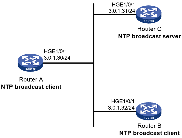

NTP for MPLS L3VPN instances
On an MPLS L3VPN network, a PE that acts as an NTP client or active peer can synchronize with the NTP server or passive peer in an MPLS L3VPN instance.
As shown in Figure 4, users in VPN 1 and VPN 2 are connected to the MPLS backbone network through provider edge (PE) devices. VPN instances vpn1 and vpn2 have been created for VPN 1 and VPN 2, respectively on the PEs. Services of the two VPN instances are isolated. Time synchronization between PEs and devices in the two VPN instances can be realized if you perform the following tasks:
·     Configure the PEs to operate in NTP client or symmetric active mode.
·     Specify the VPN instance to which the NTP server or NTP symmetric passive peer belongs.
Figure 4 Network diagram
For more information about MPLS L3VPN, VPN instance, and PE, see MPLS Configuration Guide.

NTP configuration examples
Example: Configuring NTP client/server association mode
As shown in Figure 5, perform the following tasks:
·     Configure Device A's local clock as its reference source, with stratum level 2.
·     Configure Device B to operate in client mode and Device A to be used as the NTP server for Device B.
Figure 5 Network diagram
By default, interfaces on the device are disabled (in ADM or Administratively Down state). To have an interface operate, you must use the undo shutdown command to enable that interface.
As shown in Figure 5, IP addresses are assigned to the interfaces. Device A and Device B are reachable to each other. (Details not shown.)
1.     Configure Device A:
# Enable the NTP service.
<DeviceA> system-view
[DeviceA] ntp-service enable
# Specify the local clock as the reference source, with stratum level 2.
[DeviceA] ntp-service refclock-master 2
2.     Configure Device B:
<DeviceB> system-view
[DeviceB] ntp-service enable
# Specify Device A as the NTP server of Device B so that Device B is synchronized to Device A.
[DeviceB] ntp-service unicast-server 1.0.1.11
# Verify that Device B has synchronized to Device A, and the clock stratum level is 3 on Device B and 2 on Device A.
[DeviceB] display ntp-service status
 Clock status: synchronized
 Clock stratum: 3
 System peer: 1.0.1.11
 Local mode: client
 Reference clock ID: 1.0.1.11
 Leap indicator: 00
 NTP version: 4
 Clock jitter: 0.000977 s
 Stability: 0.000 pps
 Clock precision: 2^-23
 Root delay: 0.00383 ms
 Root dispersion: 16.26572 ms
 Reference time: d0c6033f.b9923965  Wed, Dec 29 2019 18:58:07.724
 System poll interval: 64 s
# Verify that an IPv4 NTP association has been established between Device B and Device A.
[DeviceB] display ntp-service sessions
       source          reference       stra reach poll  now offset  delay disper
[12345]1.0.1.11        127.127.1.0        2     1   64   15   -4.0 0.0038 16.262
Notes: 1 source(master), 2 source(peer), 3 selected, 4 candidate, 5 configured.
 Total sessions: 1

Example: Configuring NTP broadcast association mode
As shown in Figure 9, Router C functions as the NTP server for multiple devices on a network segment and synchronizes the time among multiple devices.
·     Configure Router C's local clock as its reference source, with stratum level 2.
·     Configure Router C to operate in broadcast server mode and send broadcast messages from HundredGigE 1/0/1.
·     Configure Router B and Router A to operate in broadcast client mode and receive broadcast messages through their respective HundredGigE 1/0/1.
Figure 9 Network diagram
As shown in Figure 9, IP addresses are assigned to the interfaces. The devices are reachable to each other. (Details not shown.)
1.     Configure Router C:
<RouterC> system-view
[RouterC] ntp-service enable
[RouterC] ntp-service refclock-master 2
# Configure Router C to operate in broadcast server mode and send broadcast messages through HundredGigE 1/0/1.
[RouterC] interface hundredgige 1/0/1
[RouterC-HundredGigE1/0/1] ntp-service broadcast-server
2.     Configure Router A:
<RouterA> system-view
[RouterA] ntp-service enable
# Configure Router A to operate in broadcast client mode and receive broadcast messages on HundredGigE 1/0/1.
[RouterA] interface hundredgige 1/0/1
[RouterA-HundredGigE1/0/1] ntp-service broadcast-client
3.     Configure Router B:
<RouterB> system-view
[RouterB] ntp-service enable
# Configure Router B to operate in broadcast client mode and receive broadcast messages on HundredGigE 1/0/1.
[RouterB] interface hundredgige 1/0/1
[RouterB-HundredGigE1/0/1] ntp-service broadcast-client
# Verify that Router A has synchronized to Router C, and the clock stratum level is 3 on Router A and 2 on Router C.
[RouterA-HundredGigE1/0/1] display ntp-service status
 Clock stratum: 3
 System peer: 3.0.1.31
 Local mode: bclient
 Reference clock ID: 3.0.1.31
 Leap indicator: 00
 NTP version: 4
 Clock jitter: 0.044281 s
 Root delay: 0.00229 ms
 Root dispersion: 4.12572 ms
 Reference time: d0d289fe.ec43c720  Sat, Jan  8 2019  7:00:14.922
# Verify that an IPv4 NTP association has been established between Router A and Router C.
[RouterA-HundredGigE1/0/1] display ntp-service sessions
 [1245]3.0.1.31        127.127.1.0        2     1   64  519   -0.0 0.0022 4.1257
Notes: 1 source(master),2 source(peer),3 selected,4 candidate,5 configured.
 Total sessions: 1
Example: Configuring NTP multicast association mode
As shown in Figure 10, Router C functions as the NTP server for multiple devices on different network segments and synchronizes the time among multiple devices.
·     Configure Router C to operate in multicast server mode and send multicast messages from HundredGigE 1/0/1.
·     Configure Router D and Router A to operate in multicast client mode and receive multicast messages through their respective HundredGigE 1/0/1.
Figure 10 Network diagram
As shown in Figure 10, IP addresses are assigned to the interfaces. The devices are reachable to each other. (Details not shown.)
# Configure Router C to operate in multicast server mode and send multicast messages through HundredGigE 1/0/1.
[RouterC-HundredGigE1/0/1] ntp-service multicast-server
2.     Configure Router D:
<RouterD> system-view
[RouterD] ntp-service enable
# Configure Router D to operate in multicast client mode and receive multicast messages on HundredGigE 1/0/1.
[RouterD] interface hundredgige 1/0/1
[RouterD-HundredGigE1/0/1] ntp-service multicast-client
3.     Verify the configuration:

Example: Configuring NTP broadcast mode with authentication
As shown in Figure 13, Router C functions as the NTP server for multiple devices on different network segments and synchronizes the time among multiple devices. Router A and Router B authenticate the reference source.
·     Configure Router C's local clock as its reference source, with stratum level 3.
·     Configure Router A and Router B to operate in broadcast client mode and receive broadcast client through HundredGigE 1/0/1.
·     Configure NTP authentication on Router A, Router B, and Router C.
Figure 13 Network diagram
As shown in Figure 13, IP addresses are assigned to the interfaces. The devices are reachable to each other. (Details not shown.)

4.     Verify the configuration:
NTP authentication is enabled on Router A and Router B, but not enabled on Router C, so Router A and Router B cannot synchronize their local clocks to Router C.
# Verify that Router B has not synchronized to Router C.
[RouterB-HundredGigE1/0/1] display ntp-service status
 Clock status: unsynchronized
 Clock stratum: 16
 Reference clock ID: none
