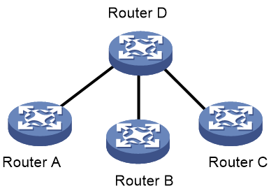

BGP peer flapping
Symptom
As shown in Figure 2, Router A is a route reflector. It establishes a BGP session with Router C via Router B. Both Router A and Router C are SR8800-X devices. Router B is a third-party device. During device deployment, the BGP peer session between Router A and Router C flaps repeatedly.
Figure 2 Network diagram
Troubleshooting procedure
1.     Verify that all peer sessions of Router A are normal except for the peer session between Router A and Router C. This session is repeatedly re-established.
2.     View the logfile. It prompts a session holdtime timeout error and the BGP state is changed from Established to Idle. After the BGP session is re-established, the BGP state transitions from OpenConfirm to Established. The BGP session is repeatedly terminated and re-established.
%Feb  4 12:24:47:654 2022 MPLS-RouterA-B-YueQ-10F-A02-PE BGP/5/BGP_STATE_CHANGED: BGP default.: 172.25.128.210 state has changed from ESTABLISHED to IDLE for a notification received: Hold Timer Expired/ErrSubCode Unspecified.
%Feb  4 12:24:49:819 2022 MPLS-RouterA-B-YueQ-10F-A02-PE BGP/5/BGP_STATE_CHANGED: BGP default.: 172.25.128.210 State is changed from OPENCONFIRM to ESTABLISHED.
3.     Execute the ping command on Router A and Router C. They can access each other. The possible cause for this issue might be that Router B discards BGP messages. You can collect BGP debug information from Router A and Router C.
a.     View BGP debug information on Router A. Router A transmits and receives keepalive messages.
*Feb 17 15:19:14:500 2022 MPLS-RouterA-B-YueQ-10F-A02-PE BGP/7/DEBUG: -MDC=1;
        BGP.: 172.25.128.210 Send KEEPALIVE
        Length: 19
 %Feb 17 15:19:57:037 2022 MPLS-RouterA-B-YueQ-10F-A02-PE SSHS/5/SSHS_ACL_DENY: -MDC=1; The SSH Connection 61.240.202.41(ZJWS_INTERNET) request was denied according to ACL rules.
*Feb 17 15:20:08:829 2022 MPLS-RouterA-B-YueQ-10F-A02-PE BGP/7/DEBUG: -MDC=1;
        BGP.: 172.25.128.210 Recv KEEPALIVE
        Length: 19
*Feb 17 15:20:10:500 2022 MPLS-RouterA-B-YueQ-10F-A02-PE BGP/7/DEBUG: -MDC=1;
 BGP_TIMER.: 172.25.128.210 KA Timer Expired.
        Length: 19
b.     View BGP debug information on Router C. Router C transmits keepalive messages, but does not receive keepalive messages.
Feb 17 15:20:07:314 2022 MPLS-RouterC-B-SD-1F-1-E10-RR BGP/7/DEBUG: -MDC=1;
        BGP.: 172.25.128.174 Send KEEPALIVE
        Length: 19
 *Feb 17 15:21:01:314 2022 MPLS-RouterC-B-SD-1F-1-E10-RR BGP/7/DEBUG: -MDC=1;
 BGP_TIMER.: 172.25.128.174 KA Timer Expired.
        Length: 19
*Feb 17 15:21:18:314 2022 MPLS-RouterC-B-SD-1F-1-E10-RR BGP/7/DEBUG: -MDC=1;
 BGP_TIMER.: 172.25.128.174 HD Timer Expired.
 BGP_TIMER.: 172.25.128.174 Restart Timer Created.
*Feb 17 15:21:18:315 2022 MPLS-RouterC-B-SD-1F-1-E10-RR BGP/7/DEBUG: -MDC=1;
 BGP_TIMER.: 172.25.128.174 KA Timer Deleted.
 BGP_TIMER.: 172.25.128.174 HD Timer Deleted.
%Feb 17 15:21:18:315 2022 MPLS-RouterC-B-SD-1F-1-E10-RR BGP/5/BGP_STATE_CHANGED: -MDC=1;
 BGP default.: 172.25.128.174 state has changed from ESTABLISHED to IDLE for hold timer expiration caused by peer device.
4.     Further inspect the on-site settings. The default MTU for the interface was modified.
interface Route-Aggregation11
description To_SD_E10_ASR9k_BE11
mtu 1586
ip address 172.25.140.202 255.255.255.252
isis enable 100
isis circuit-type p2p
link-aggregation mode dynamic
mpls enable
5.     View the BGP log. The BGP session is terminated every 18 seconds. This issue might be caused by packet fragmentation.
6.     Use the ping command on Router A to ping Router C. Specify different ICMP echo request lengths (1472, 1500, 1558, and 1559 bytes) and disable Router A from fragmenting these ICMP echo requests. Router A cannot ping Router C if the specified ICMP echo request length is 1558 or 1559 bytes. It is found that Router B's MTU is 1586 bytes. Therefore, messages exceeding 1586 bytes will be discarded by Router B.
<RouterA> ping -f -s 1472 172.25.128.174 172.25.128.210
<RouterA> ping -f -s 1500 172.25.128.174 172.25.128.210
<RouterA> ping -f -s 1558 172.25.128.174 172.25.128.210
<RouterA> ping -f -s 1559 172.25.128.174 172.25.128.210
7.     To avoid packet discarding by Router B, set a smaller TCP MSS or MTU. This operation makes TCP packet fragments smaller. As a best practice, set the TCP MSS to 1400. TCP MSS adjustment is required at only one end, because the two ends use the minimum TCP MSS for communication.
Root cause
Keepalive and update messages are transmitted during BGP session establishment. Router B discards the update messages of Router A because they exceed the MTU of Router B. As a result, Router C can receive the keepalive messages of Router A, but not the update messages of Router A, which causes the related TCP packets to be discarded due to discontiguous TCP sequence numbers. Router C only transmits keepalive messages and does not receive keepalive messages. Since the update messages of Router C do not exceed the MTU of Router B, Router A can transmit and receive keepalive messages.
Solution
Adjust the TCP MSS or MTU value for the  local and remote devices, ensuring that their BGP TCP packet segments are smaller than the MTU of the intermediate device.

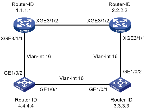

Packet filtering on an interface cannot control SSH login successfully
Symptom
The on-site network configuration is as follow:
·     Two interconnected SR8812-X routers and two interconnected Router As of the same model, act as the WAN egress devices for a certain site. Each device has three WAN egress interfaces and one inter-device interconnect interface.
·     In the inbound direction of all WAN egress interfaces on each device, the administrator the packet-filter command to block SSH login from the WAN network. That is, using an ACL to discard SSH packets with source addresses as public IPs and destination addresses as the device's loopback management interface address.
SSH packets received from two Router As are completely dropped. However, SSH packets received from two SR8812-X devices are not entirely dropped, allowing users to still log in to the devices via SSH from the WAN network.
1.     View detailed information about packet filtering configuration.
Verify that the configuration on the egress interfaces of Router As and SR8812-X routers on the WAN network is the same. Make sure the packet-filter command is executed on all the WAN egress interfaces and ACL rules used by packet filtering are correct.
Configure the following settings on all public interfaces of the devices:
interface HundredGigE4/0/3
port link-mode route
mtu 4470
ip address XXXX 255.255.255.252
isis enable 1
isis ipv6 enable 1
isis circuit-level level-2
isis cost 5000
level-2 isis ipv6 cost 5000 level-2
isis authentication-mode md5 cipher  c$3$3SxcYRonREfpUIE4pkhdkqFH1s8r7Jre9QnY
mpls enable
mpls ldp enable
ipv6 mtu 4470
packet-filter name DENY-XXX-SSH inbound
ipv6 address XXX/X
ipv6 address auto link-local
2.     Execute the packet-filter command and specify the with the hardware-count keyword to enable packet counting statistics for ACL filtering. Execute the display packet-filter statistics interface command to display packet filtering statistics for all ACLs. The fields from the output include the following:
Totally 0 packets permitted, 7 packets denied
Totally 0% permitted, 100% denied
Packet capturing identifies that a total of 20 SSH packets were sent from the WAN network, among which seven packets were successfully matched and discarded by the packet filtering policy on the interface. The remaining 13 packets did not match the packet filtering policy. The deivce might have SSH packets forwarded to this device from other interfaces.
3.     Execute the debugging ip packet command to enable IP packet debugging to search for SSH packets. The SSH packets from the device interconnect interfaces were sent to the CPU for processing. This indicates that the egress interfaces for the WAN egress interface have rejected SSH packets with the local loopback management interface address as the destination address, yet failed to block SSH packets with a destination address other than the local device.
4.     The analysis upon the network configuration identifies that both the WAN egress interfaces and the device interconnect interfaces are deployed with MPLS. All WAN traffic passes through MPLS LSP to access the devices.
Root cause
If the device acts as the last hop on the LSP, SSH packets generally do not carry any MPLS label. In this case, packet filtering applied on the device's WAN egress interface can correctly match these IP packets.
If the device is not the last hop on the LSP, SSH packets might carry MPLS labels. In this case, packet filtering applied on the WAN egress interfaces of the device might not be able to match the MPLS-labeled SSH packets. As a result, the SSH packets with MPLS labels are forwarded through the interconnect interface to another device and are then processed by the CPU of that device.
In the current software version, the SR8812-X device does not support using ACL rules to match IP addresses and protocol port information for packets encapsulated with MPLS labels. This issue does not occur on Router As, because these routers support using ACL rules to match IP addresses and protocol port information for packets encapsulated with MPLS labels.
Solution
Configure packet filtering on interconnect interface of the SR8812-X devices to filter SSH packets completely.

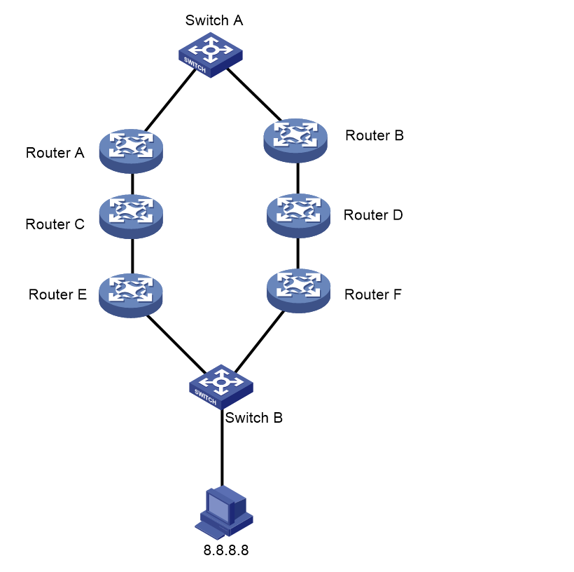

Inconsistent round-trip paths due to BGP and OSPF route selection
Symptom
On a typical three-level network, as shown in Figure 3, Router A and Router B operates as level-1 core PEs and Switch A as the level-1 core CE. Router C and Router D operates as level-2 core devices, and Router E and Router F operates as level-3 core devices. Switch B operates as the level-3 core CE and connects to a site whose IP address is 8.8.8.8.
Switch B connects to the level-3 PEs through primary and backup links.
·     The primary link is Router A <> Router C <> Router E. It passes routes to Router A via BGP and MPLS L3VPN. On Router A, BGP VPNv4 routes and OSPF routes are mutually redistributed. Finally, Router A passes the routes to Switch A via OSPF. Router A and Router E share the same OSPF domain ID, which is the default value of 0.
·     The backup link connects Router B <> Router D <> Router F. Router F redistributes the static routes from the access layer into OSPF, and then passes the routes to Switch A via OSPF.
On the network, two OSPF processes exist: OSPF 1 runs on Router A, Switch A, Router B, and Router D, and OSPF 2 runs on Router D and Router F. On Router D, the two OSPF processes redistribute routes into each other.
On this network, traffic passes through the primary link when it operates correctly, and switches to the backup link upon a fault in the primary link. After the primary link recovers, the traffic is steered back to the primary link. The current issue is that traffic is not steered back to the primary link after the primary link recovers.
Figure 3 Network diagram
The following output information is for illustration only.
1.     View the route destined for site 8.8.8.8 in VPN instance 1.
<RouterA> display ip routing-table vpn-instance 1 8.8.8.8
Summary count : 1
Destination/Mask   Proto   Pre Cost        NextHop         Interface
8.8.8.8/32         BGP     255 2           6.6.6.6         XGE3/1/1
The output shows that the route to 8.8.8.8 is learned from BGP. The next hop address is the loopback address of Router C and the preference is 255.
2.     View the LSDB information for OSPF 1 on Router A, and view the LSA corresponding to site 8.8.8.8.
<RouterA> display ospf 1 lsdb
              OSPF Process 1 with Router ID 10.0.0.2
                 Link State Database
                         Area: 0.0.0.0
 Type      LinkState ID    AdvRouter       Age  Len   Sequence  Metric
 Router    10.0.0.2        10.0.0.2        669  36    80000003  0
 Router    5.5.5.5         5.5.5.5         661  48    80000004  0
 Router    1.1.1.1         1.1.1.1         660  60    80000007  0
 Network   10.0.0.6        5.5.5.5         660  32    80000002  0
 Network   10.0.0.2        10.0.0.2        669  32    80000002  0
 Sum-Net   8.8.8.8         10.0.0.2        650  28    80000001  2
                 AS External Database
 External  10.0.0.0        5.5.5.5         642  36    80000001  1
 External  7.7.7.7         5.5.5.5         642  36    80000001  1
Route distinguisher: 1:6
 Total number of routes: 1
 Paths:   1 available, 1 best
 BGP routing table information of 8.8.8.8/32:
 From            : 6.6.6.6 (6.6.6.6)
 Rely nexthop    : 10.0.0.10
 Original nexthop: 6.6.6.6
 OutLabel        : 1279
 Ext-Community   : <OSPF Domain Id: 0.0.0.0:0>, <OSPF Router Id: 6.6.6.6:0:0>,
                   <OSPF AreaNum: 0.0.0.0 RouteType: 1 Option: 0>, <RT: 1:1>
 RxPathID        : 0x0
 TxPathID        : 0x0
 AS-path         : (null)
 Origin          : incomplete
 Attribute value : MED 2, localpref 100, pref-val 0
 State           : valid, internal, best
 IP precedence   : N/A
 QoS local ID    : N/A
 Traffic index   : N/A
Site 8.8.8.8 has an LSA of the Sum-Net type, which means it is a Network Summary LSA (Type-3). Router A and Router E share the same OSPF domain ID, 0. The OSPF domain ID carried by the BGP VPNv4 route for site 8.8.8.8 is 0. When Router A redistributes the BGP VPNv4 route into OSPF, it advertises the route to Switch A in a Network Summary LSA (Type-3 LSA), because Router A's primary domain ID matches the OSPF domain ID in the route.
Router B has two LSAs for site 8.8.8.8, a Type-3 LSA from Router A in OSPF 1 and a Type-5 LSA from Router F in OSPF 2. The Type-3 LSA has a higher preference than the Type-5 LSA. Consequently, when Router B's two OSPF processes import routes from each other, the Type-3 LSA from OSPF 2 is active instead of the Type-5 LSA from OSPF 1. Router B advertises the Type-3 LSA to the backup link, and traffic is forwarded based on the Type-3 LSA, passing through the primary link.
3.     On Router A, shut down and restore BGP peer sessions. Use the display ip routing-table command to display routes with destination address 8.8.8.8 in VPN instance 1.
<RouterA> display ip routing-table vpn 1 8.8.8.8
Summary count : 1
8.8.8.8/32         O_ASE2  150 1           10.0.0.1        XGE3/1/1
The output shows that the route for 8.8.8.8 is an OSPF route, not a BGP route. Router D redistributes this route as a Type-5 LSA, and traffic is forwarded via the backup link.
4.     On Router A, execute the display ip routing-table command to display BGP VPNv4 routes destined for 8.8.8.8.
<RouterA> display bgp routing-table vpnv4
 BGP local router ID is 2.2.2.2
 Status codes: * - valid, > - best, d - dampened, h - history
               s - suppressed, S - stale, i - internal, e - external
               a - additional-path
       Origin: i - IGP, e - EGP, ? - incomplete
 Total number of routes from all PEs: 1
 Route distinguisher: 1:2(1)
 Total number of routes: 6
     Network            NextHop         MED        LocPrf     PrefVal Path/Ogn
* >  1.1.1.1/32         10.0.0.1        2                     32768   ?
* >  5.5.5.5/32         10.0.0.1        3                     32768   ?
* >  7.7.7.7/32         10.0.0.1        2                     32768   ?
* >i 8.8.8.8/32         6.6.6.6         2          100        0       ?
* >  10.0.0.0/20        10.0.0.1        2                     32768   ?
* >  10.0.0.4/30        10.0.0.1        3                     32768   ?
The output shows that the BGP neighbor relationship has been successfully restored, but the traffic is not steered to the primary link.
5.     On Router A, configure a routing policy to set the preference to 130 for routes destined for 8.8.8.8.
a.     Create an IPv4 prefix list named p1 that only permits routes for 8.8.8.8/32 to pass.
<RouterA> system-view
[RouterA] ip prefix-list p1 permit 8.8.8.8 32
b.     Create a routing policy named policy1 with a node sequence number of 10 and the match mode of permit. If traffic matches IPv4 prefix list p1, the routing policy sets the route preference to 130.

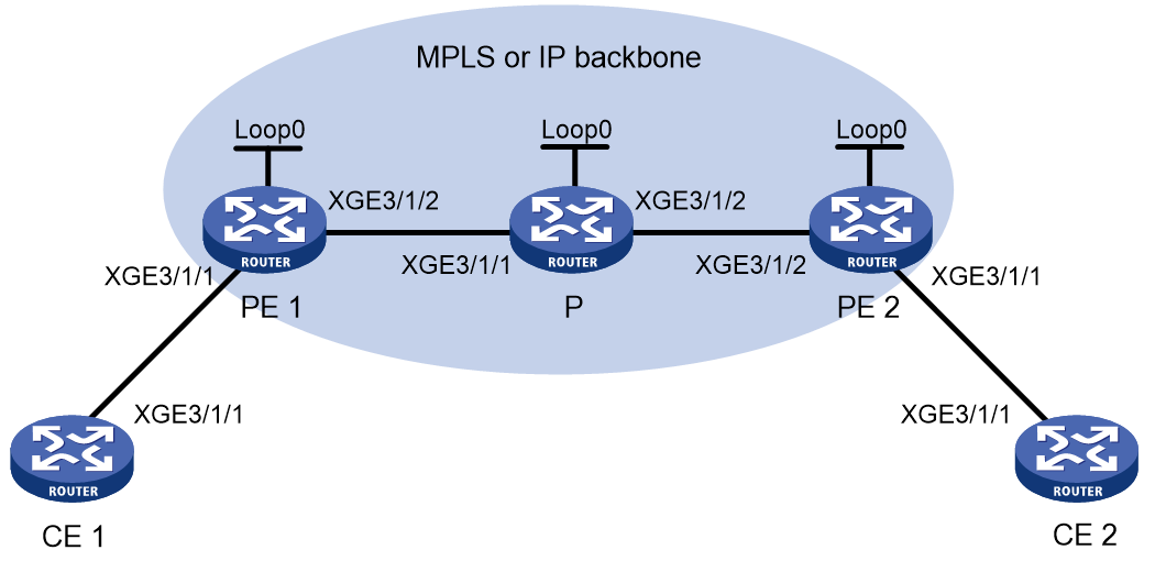

[RouterA] route-policy policy1 permit node 10
[RouterA-route-policy-policy1-10] if-match ip address prefix-list p1
[RouterA-route-policy-policy1-10] apply preference 130
6.     View routes destined for site 8.8.8.8 on Router A.
Summary count : 1
8.8.8.8/32         BGP     130 2           6.6.6.6         XGE3/1/1
The output shows that the route for 8.8.8.8 has been restored to the BGP route, and traffic is forwarded through the primary link.
Root cause
If you configure the OSPF domain ID by using the domain-id command, the PE attaches the primary domain ID to the route as an extended community attribute when redistributing an OSPF route into BGP. The domain ID is passed to the remote PE. Upon receiving the BGP route, the remote PE compares the locally configured primary and secondary OSPF domain IDs with the OSPF domain ID carried in the route. If the primary or secondary domain ID matches the domain ID in the route and the route is an intra-area or inter-area route, the route is advertised to the CE as a Network Summary LSA (Type-3 LSA) when redistributed into OSPF. If the primary or secondary domain ID does not matches the domain ID in the route, it is advertised to the CE as either an AS External LSA (Type-5 LSA) or an NSSA External LSA (Type-7 LSA).
When the primary link operates correctly, two LSAs about site 8.8.8.8 exist on Router D, a Type-3 LSA from Router A in OSPF 1 and a Type-5 LSA from Router F in OSPF 2. The Type-3 LSA has a higher preference than the Type-5 LSA. As a result, when Router D's two OSPF processes import routes from each other, the Type-3 LSA introduced by OSPF 2 is active instead of the Type-5 LSA redistributed by OSPF 1. Router D advertises the Type-3 LSA to the backup link but not the Type-5 LSA to the primary link. Traffic is forwarded according to the Type-3 LSA, passing through the primary link.
When the BGP route fails, the Type-3 LSA is withdrawn. Router A learns the Type-5 LSA redistributed by Router D, directing traffic through the backup link. After the BGP route is restored, its default preference is 255. Since the OSPF route generated from the Type-5 LSA has a preference of 150, the OSPF route takes precedence over the BGP route, placing the BGP route in inactive state. As a result, traffic continues to pass through the backup link.
Solution
Configure a routing policy that modifies the preference for BGP routes destined for the site through, ensuring those BGP routes take precedence over OSPF routes. Traffic will be automatically switched from the backup link to the primary link when the BGP routes are restored.

Failure to establish an IS-IS neighbor relationship between the device and Cisco N9000 with the same settings configured at both ends
Symptom
Although SR8800-X and Cisco N9000 use the same settings, they cannot establish an IS-IS neighbor relationship.
1.     Execute the debugging isis timer command on SR8800-X to enable IS-IS timer debugging. A Level-1 hello timer timeout error is prompted.
<Sysname> debugging isis adj-packet 1
*Mar  2 07:21:40:899 2022 H3C ISIS/7/ISISDBG: -MDC=1;
ISIS-1-TMR: Level-1 hello timer expired on the circuit GigabitEthernet3/1/1.
2.     Execute the debugging isis adj-packet send command on SR8800-X to enable debugging IS-IS hello packet transmission. Hello packets are transmitted normally and their length is 1541.
<Sysname> debugging isis adj-packet send 1
*Mar  2 07:21:40:919 2022 H3C ISIS/7/ISISDBG: -MDC=1;
ISIS-1-ADJ: Send a Lan L1 Hello packet on circuit(GigabitEthernet3/1/1)
*Mar  2 07:21:40:920 2022 H3C ISIS/7/ISISDBG: -MDC=1;
ISIS-1-ADJ:
0000: 83 1b 01 06  10 01 00 00  02 00 00 00  00 00 59 00
0010: 1e 06 05 40  00 00 00 00  00 59 02 01  02 01 00 84
// 0x605 = 1541 (MTU=1541)
3.     Execute the debugging isis adj-packet receive command on SR8800-X to enable debugging IS-IS hello packet reception. Hello packets are received normally and their length is 1527.
<Sysname> debugging isis adj-packet receive 1
*Mar  2 07:21:40:921 2022 H3C ISIS/7/ISISDBG: -MDC=1;
ISIS-1-ADJ: Receive a Lan L1 Hello packet from(0000.0000.0001) on circuit(GigabitEthernet3/1/1)
*Mar  2 07:21:40:922 2016 H3C ISIS/7/ISISDBG: -MDC=1;
ISIS-1-ADJ: Level-1 NBR(0000.0000.0001) two way pass.
*Mar  2 07:21:40:923 2022 H3C ISIS/7/ISISDBG: -MDC=1;
ISIS-1-ADJ:
0000: 83 1b 01 00  10 01 00 00  02 00 00 00  02 05 30 00
0010: 1e 05 f7 40  00 00 00 02  05 30 3d 81  01 cc d3 03
// 0x5f7 = 1527 (MTU=1527)
4.     Execute the show isis interface command on Cisco N9000 to view its IS-IS configuration. The IS-IS interface MTU is 1527.
N9000# show isis interface ten-gigabitethernet 0/0/0/1
Wed Mar  2 17:20:39.287 CST
TenGigE0/0/0/1              Enabled
  Adjacency Formation:      Enabled
  Prefix Advertisement:     Enabled
  IPv4 BFD:                 Disabled
  IPv6 BFD:                 Disabled
  BFD Min Interval:         150
  BFD Multiplier:           3
  Circuit Type:             level-2-only (Interface circuit type is level-1-2)
  Media Type:               LAN
  Circuit Number:           37
  Level-2
  Adjacency Count:        1
  LAN ID:
  Priority (Local/DIS):   64/64
  Next LAN IIH in:        226 ms
  LSP Pacing Interval:    33 ms
  PSNP Entry Queue Size:  0
  CLNS I/O
  Protocol State:         Up
  MTU:                    1527
5.     Execute the show interface command on Cisco N9000 to view the physical interface MTU. The physical interface MTU is 1541.
N9000# show interface ten-gigabitethernet 0/0/0/1
Wed Mar  2 17:20:50.379 CST
TenGigE0/0/0/1 is up, line protocol is up
  Interface state transitions: 27
  Hardware is TenGigE, address is
  Layer 1 Transport Mode is LAN
  Description:
  Internet address is
  MTU 1541 bytes, BW 10000000 Kbit (Max: 10000000 Kbit)
6.     Execute the mtu command on SR8800-X to configure the MTU value to 1527 for GigabitEthernet3/1/1. The two devices can then establish an IS-IS neighbor relationship.
<Sysname> system-view
[Sysname] interface gigabitethernet 3/1/1
[Sysname-GigabitEthernet3/1/1] mtu 1527
[Sysname-GigabitEthernet3/1/1] quit
Root cause
H3C devices and Cisco devices use different MTU calculation algorithms. When an H3C device calculates the MTU of an IS-IS interface, it does not take the length of the Ethernet frame header into account. The MTU of an IS-IS interface equals that configured on the interface. In contrast, Cisco devices take the length of the Ethernet frame header into account during IS-IS interface MTU calculation. The MTU of an IS-IS interface equals the configured MTU minus the Ethernet frame header length. As a result, when an H3C devices and a Cisco device use the same settings, their IS-IS interfaces have an MTU inconsistency. As a result, Cisco N9000 cannot receive the hello messages from the H3C device and thus prompts a hello timer timeout error.
Solution
To have SR8800-X and Cisco N9000 establish an IS-IS neighbor relationship, make sure the interface MTU on SR8800-X equals that on Cisco N9000 minus 14 (length of the Ethernet frame header).

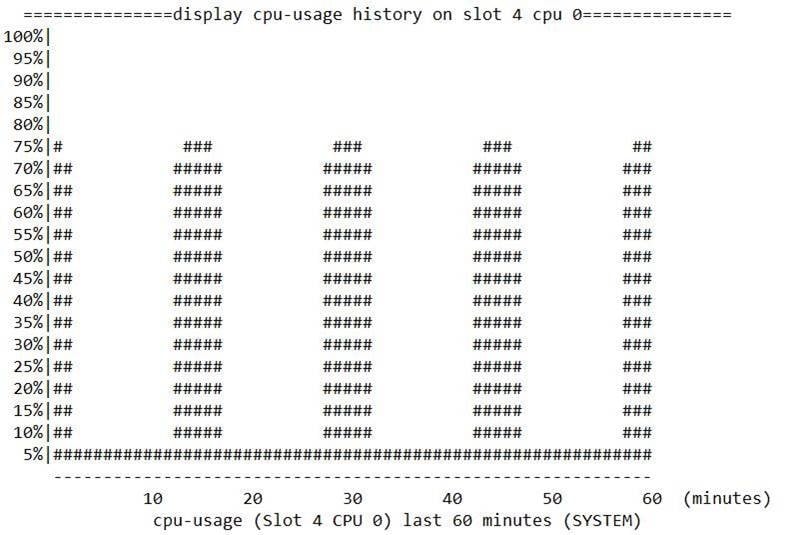

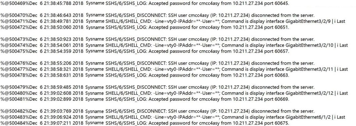

High CPU usage on the active MPU caused by frequent logins
Symptom
The CPU usage of the active MPU on multiple devices periodically rose to about 75%, as shown in the following figure:

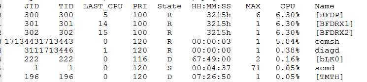

1.     When the CPU usage increases, the process statistics show that the comsh process occupies a high CPU usage.
<Sysname>monitor thread dumbtty slot 4 cpu 0
2.     View log files. The information shows that many SSH users continuously log in periodically.
Root cause
An abnormal server attempts periodic logins to the device and executes a series of commands within a short period. When users repeatedly log in and out of the device and execute display commands in a short period, many temporary processes will be created, resulting in a sudden increase in CPU usage.
Solution
To resolve server login anomaly, the device performs CPU optimization based on SSH exceptions to prevent a sudden increase in CPU usage.
Failure to issue OSPF default routes
Symptom
Routers A and Router B establish an OSPF neighbor relationship. After you execute the default-route-advertise command on Router A to redistribute a default route into the OSPF routing domain, Router B cannot learn the default route advertised by Router A.
1.     Execute the display ospf peer command to verify that the OSPF neighbor relationship between two devices is established correctly.
<RouterA> display ospf peer
         OSPF Process 1 with Router ID 2.2.2.1
               Neighbor Brief Information
 Area: 0.0.0.0
 Router ID       Address         Pri Dead-Time  State             Interface
 3.3.3.1         1.1.1.2         1   33         Full/ -           XGE3/1/1
<RouterB> display ospf peer
         OSPF Process 1 with Router ID 3.3.3.1
 Area: 0.0.0.0
 2.2.2.1         1.1.1.1         1   36         Full/ -           XGE3/1/1
2.     Verify that both ends are configured with the default-route-advertise command.
Execute the display current-configuration configuration ospf command to verify that both devices are configured with the default-route-advertise command and have no route filtering configuration.
<RouterA> display current-configuration configuration ospf
ospf 1
 default-route-advertise type 2
 area 0.0.0.0
  network 1.1.1.0 0.0.0.255
<RouterB> display current-configuration configuration ospf
ospf 1
 area 0.0.0.0
3.     Execute the display ip routing-table command to view the routing tables on both devices and verify that the route learning results are correct.
Router A has a default static route with a preference of 60 in its routing table.
Destinations : 17       Routes : 17
0.0.0.0/0          Static  60  0           2.2.2.2         XGE3/1/1
0.0.0.0/32         Direct  0   0           127.0.0.1       InLoop0
1.1.1.0/24         Direct  0   0           1.1.1.1         XGE3/1/1
1.1.1.0/32         Direct  0   0           1.1.1.1         XGE3/1/1
1.1.1.1/32         Direct  0   0           127.0.0.1       InLoop0
Router A has a default static route with a preference of 200 in its routing table, but does not have the default route with a preference of 150 advertised by OSPF.
<RouterB> display ip routing-table
0.0.0.0/0          Static  200 0           3.3.3.2         XGE3/1/1
1.1.1.0/24         Direct  0   0           1.1.1.2         XGE3/1/1
1.1.1.0/32         Direct  0   0           1.1.1.2         XGE3/1/1
4.     Execute the display ospf lsdb command to view OSPF LSDB information on Router B and verify that Router A has advertised the route.
The output shows that Router B has two default route entries: one generated by itself (3.3.3.1) and one advertised by Router A (2.2.2.1). This confirms that Router A has advertised a default route to Router B.
<RouterB> display ospf lsdb
                 Link State Database
                         Area: 0.0.0.0
 Router    3.3.3.1         3.3.3.1         361  48    80000006  0
 Router    2.2.2.1         2.2.2.1         362  48    80000006  0
 External  0.0.0.0         3.3.3.1         361  36    80000001  1
 External  0.0.0.0         2.2.2.1         1444 36    80000003  1

Route flapping caused by attribute changes of BGP summary routes
Symptom
As shown in Figure 4, Router D establishes an EBGP peer relationship with Router A, Router B, and Router C separately. Router D learns route 1.1.1.1/32 from Router A and route 1.1.1.2/32 from Router B. Router D summarize the two routes as route 1.1.1.0/24 before transmitting them to Router C. Route 1.1.1.1/32 is a local network route advertised by BGP on Router A after the configuration of the network command. Route 1.1.1.2/32 is a static route redistributed by Router B after the configuration of the import-route command. BGP route dampening is enabled on Router C by using the dampening command. When route 1.1.1.2/32 flaps on Router B, summary route 1.1.1.0/24 should remain stable on Router D. However, the summary route also flaps in fact.
Figure 4 Network diagram
The following information is for illustration only.
1.     Use the display bgp routing-table ipv4 unicast command to view the BGP routes learned by Router D.
a.     View route 1.1.1.1/32 learned from Router A.
<RouterD> display bgp routing-table ipv4 1.1.1.1 32
BGP local router ID: 20.0.0.2
Local AS number: 200
BGP routing table information of 1.1.1.1/32:
From            : 10.0.0.1 (1.1.1.1)
Original nexthop: 10.0.0.1
OutLabel        : NULL
RxPathID        : 0x0
TxPathID        : 0x0
AS-path         : 100
Origin          : igp
Attribute value : MED 0, pref-val 0
State           : suppressed, valid, external, best
IP precedence   : N/A
QoS local ID    : N/A
Traffic index   : N/A
b.     View route 1.1.1.2/32 learned from Router B.
<RouterD> display bgp routing-table ipv4 1.1.1.2 32
BGP routing table information of 1.1.1.2/32:
From            : 20.0.0.1 (20.0.0.1)
Rely nexthop    : 20.0.0.1
Original nexthop: 20.0.0.1
OutLabel        : NULL
RxPathID        : 0x0
TxPathID        : 0x0
AS-path         : 100
Origin          : incomplete
IP precedence   : N/A
QoS local ID    : N/A
Traffic index   : N/A
Router D can learn two detailed routes, one from Router A and the other from Router B. The two routes have different ORIGIN attributes.
¡     igp—Originated in the AS. The origin of routes advertised with the network command is IGP.
¡     egp—Learned through an exterior gateway protocol (EGP).
¡     incomplete—Unknown origin. The origin of routes redistributed from IGP protocols is INCOMPLETE.
Route 1.1.1.1/32 is a local network route advertised by BGP on Router A after the configuration of the network command. The ORIGIN attribute of route 1.1.1.1/32 is igp. Route 1.1.1.2/32 is a static route redistributed by using the import-route command. The ORIGIN attribute of route 1.1.1.2/32 is incomplete.
2.     Use the display bgp routing-table ipv4 unicast command to view the BGP summary routes on Router D before route flapping.
<RouterD> display bgp routing-table ipv4 1.1.1.0
BGP routing table information of 1.1.1.0/24:
Original nexthop: 127.0.0.1
OutLabel        : NULL
RxPathID        : 0x0
TxPathID        : 0x0
AS-path         : (null)
Origin          : incomplete
Attribute value : pref-val 32768
State           : valid, local, best
This route is an atomic-aggregated route
Aggregator      : AS 200, Aggregator ID: 20.0.0.2
IP precedence   : N/A
QoS local ID    : N/A
Traffic index   : N/A
When the summarized routes have different ORIGIN attributes, the ORIGIN attribute of the summary route is selected in descending order of Incomplete > EGP > IGP. In this example, the ORIGIN attribute of route 1.1.1.1/32 is IGP and the ORIGIN attribute of route 1.1.1.2/32 is Incomplete. Therefore, the ORIGIN attribute of summary route 1.1.1.0/24 is Incomplete.
3.     Use the display bgp routing-table ipv4 unicast command to view the BGP summary routes on Router D after route flapping.
OutLabel        : NULL
RxPathID        : 0x0
TxPathID        : 0x0
AS-path         : (null)
Origin          : igp
IP precedence   : N/A
QoS local ID    : N/A
Traffic index   : N/A
Host route 1.1.1.2/32 on Router B flaps and is withdrawn. In this situation, the summary route only has one summarized route, route 1.1.1.1/32. Since the ORIGIN attribute of route 1.1.1.1/32 is IGP, the ORIGIN attribute of the summary route changes to IGP. After route 1.1.1.2/32 is re-added, the ORIGIN attribute of the summary route restores to Incomplete. In conclusion, the cause for this issue is that the flapping of route 1.1.1.2/32 causes the ORIGIN attribute of the summary route to change. Repeated ORIGIN attribute changes trigger route suppression by Router C, which is enabled with BGP route dampening by the dampening command.
4.     Fix the ORIGIN attribute of summary route 1.1.1.0/24 at IGP.
a.     Create routing policy policy1 with a node number of 10. Set the match mode to permit and configure the routing policy to set the ORIGIN attribute of matching BGP routes to IGP.
<RouterD> system-view
[RouterD] route-policy policy1 permit node 10
[RouterD-route-policy-policy1-10] apply origin igp
b.     In BGP IPv4 unicast address family view, add summary route 1.1.1.0/24 to the BGP routing table and apply routing policy policy1 to that route.
[RouterD] bgp 200
[RouterD-bgp-default] address-family ipv4 unicast
[RouterD-bgp-default-ipv4] aggregate 1.1.1.0 255.255.255.0 attribute-policy policy1
Root cause
Flapping of a summarized route causes changes in the ORIGIN attribute of the summary route, which triggers route suppression.
Solution
Use a routing policy to fix the ORIGIN attribute of the summary route.
Tracert responses show unexpected addresses in a VPN network
Symptom
As shown in Figure 5, the device is deployed in a VPN network as a PE (PE 1 and PE 2). When the tracert command is used to display the VPN traffic path between CE 1 and CE 2, the command output shows addresses not on the path, but traffic forwarding remains normal.
Figure 5 Network diagram
Device
Interface
IP Address
Device
Interface
IP Address
CE 1
XGE3/1/1
30.0.0.2/24
P
Loop0
N/A
On PE 1
Loop0
8.8.8.8/32
XGE3/1/1
N/A
XGE3/1/1
30.0.0.1/24
XGE3/1/2
N/A
XGE3/1/2
N/A
On PE 2
Loop0
N/A
CE 2
XGE3/1/1
20.0.0.2/24
XGE3/1/1
20.0.0.1/24
XGE3/1/2
N/A
The following output information is for illustration only, and it might vary by software or hardware of the device.
1.     Use the tracert command on both CE 1 and CE 2 to check if the echo addresses on the service paths are displayed correctly.
# Run a tracert from CE 1 to CE 2.
[CE1] tracert 20.0.0.2
traceroute to 20.0.0.2 (30.0.0.2), 30 hops at most, 40 bytes each packet, press CTRL+C to break
1   30.0.0.1 (30.0.0.1)  1.000 ms  0.000 ms  1.000 ms
11  20.0.0.1 (20.0.0.1) [AS 65002]  1.000 ms  1.000 ms  1.000 ms
12  20.0.0.2 (20.0.0.2) [AS 65002]  2.000 ms  2.000 ms  2.000 ms
The echo addresses are displayed correctly. The first hop is a direct address, and the 11th hop is the direct address of CE 2.
Run a tracert from CE 2 to CE 1.
[CE2] tracert 30.0.0.2
traceroute to 30.0.0.2 (30.0.0.2), 30 hops at most, 40 bytes each packet, press CTRL+C to break
1   20.0.0.1 (20.0.0.1)  0.000 ms  1.000 ms  0.000 ms
11  8.8.8.8 (8.8.8.8)  2.000 ms  1.000 ms  2.000 ms
12  30.0.0.2 (30.0.0.2) [AS 65001]  2.000 ms  1.000 ms  3.000 ms
The echo addresses are displayed abnormally. Under normal circumstances, the 11th hop should display the direct address of CE 2, but the actual address shown is 8.8.8.8.
Normal service forwarding and normal final hop for tracert indicate that the routing and interfaces are free of anomalies.
2.     Use the display ip interface brief command on PE 1 to check if  address 8.8.8.8 exists.
[PE1] display ip interface brief
*down: administratively down
(s): spoofing  (l): loopback
Interface           Physical Protocol IP address/Mask    VPN instance Description
XGE3/1/1            up       up       30.0.0.1/24        v1           --
XGE3/1/2            up       up       1.1.1.2/8          --           --
Loop1               up       up(s)    2.2.2.2/32         --           --
Loop0               up       up(s)    8.8.8.8/32         v1           --
The interface with address 8.8.8.8 has also been bound to a VPN.
3.     Use packet capture software to capture packets and check if the device's tracert echo address is correct.
The device's echo address is 8.8.8.8.
Root cause
This symptom is a normal part of the device's packet processing. In a VPN network, if the device is not directly connected to the next hop when processing tracert messages, it will use the smallest IP address from all interfaces bound to the VPN service as the source IP to transmit ICMP messages. This can result in tracert echo information that does not match expectations.
Traffic not routed through a VPN does not have this issue.
Solution
This issue is a normal part of the device's packet processing and merely reflects a variation in tracert responses. It does not affect packet forwarding.
Traffic not load-balanced among member ports of a Layer 3 aggregate interface used as the ECMP route output interface
Symptom
The device has two equal-cost static routes to the destination. The output interfaces of the static routes are Layer 3 aggregate interfaces Route-Aggregation1 and Route-Aggregation2. Each Layer 3 aggregate interface has two member ports. Traffic is not load-balanced among the two member ports. For example, the traffic load on one 100GE member port is 70% of the total interface bandwidth, and traffic load on the other 100GE member port is empty.
The following output information is for illustration only. The output information might vary by device model.
1.     Use the display link-aggregation verbose command to display detailed information about the aggregation groups that correspond to the specified aggregate interfaces. The output shows that the two member ports are both in Selected state.
<Sysname> display link-aggregation verbose
Loadsharing Type: Shar -- Loadsharing, NonS -- Non-Loadsharing
Port Status: S -- Selected, U -- Unselected, I -- Individual
Port: A -- Auto
Flags:  A -- LACP_Activity, B -- LACP_Timeout, C -- Aggregation,
        G -- Defaulted, H -- Expired
Aggregate Interface: Route-Aggregation1
Aggregation Mode: Static
  Port             Status  Priority Oper-Key  Role
  HGE3/1/1         S       32768    8         None
  HGE3/1/2         S       32768    8         None
Aggregate Interface: Route-Aggregation2
2.     Upon receiving traffic, the device searches the routing table and obtains two matching ECMP routes.
a.     The device then performs the first hash calculation for route selection to forward matching traffic out of the specified Layer 3 aggregate interface. In the route selection process, the device calculates a hash value based on the packet characteristics such as 5-tuple. Then, it performs a modulo operation on this hash value with 2 (the number of ECMP routes). The selected ECMP route varies by modulo result.
b.     Assume the traffic hashes to ECMP route 1 with Layer 3 aggregate interface Route-Aggregation1 as the output interface. When forwarding traffic through Route-Aggregation1, the device performs the second hash calculation for route selection to forward the traffic out of the specified member port of Route-Aggregation1. The route selection process is similar to the first hash calculation process. The device calculates a hash value based on the packet characteristics. Then, it performs a modulo operation on this hash value with 2 (the number of aggregation group members). The selected member port varies by modulo result.
In the first hash calculation for selecting a Layer 3 aggregate interface, the traffic is already filtered. For traffic reaching Route-Aggregation1, the second hash calculation generates basically the same result as the first hash calculation. The traffic is forwarded through a specific member port on the Layer 3 aggregate interface. As a result, traffic is not load-balanced across the member ports.
According to the analysis, if the number of ECMP routes is the same as or a multiple of the number of member ports in the aggregation group, traffic might not be load-balanced across the member ports.
Root cause
The ECMP route and link aggregation hash parameters are the same. In addition, the number of ECMP routes is the same as or a multiple of the number of member ports in the aggregation group. As a result, traffic is not load-balanced across the member ports.
Solution
·     To avoid uneven traffic load on aggregation member ports, you can use the link-aggregation global load-sharing mode or ip load-sharing mode command to adjust the load sharing mode for generating different results in the two hash calculations. For more information about the link-aggregation global load-sharing mode or ip load-sharing mode commands, see Ethernet link aggregation or IP forwarding basics commands in H3C SR8800-X Routers Command Reference.
·     You can also make adjustments to have the number of ECMP routes different from the number of aggregation member ports, or to avoid the number of ECMP routes to be a multiple of the number of aggregation member ports. For example, you can change the number of ECMP routes to 2 and the number of member ports in the aggregation group to 3.
Device as the SSH client unable to log in to the SSH server
Symptom
After you enter the username on the device as the SSH client to log in to the SSH server, the system gets stuck in the connecting status and you cannot continue to enter the password, causing SSH login failure.

4.     Identify whether the packet interaction between the SSH client and the SSH server is normal.
Send an SSH connection request from the SSH client and execute the display tcp command to view breif TCP connection information. The output shows that no TCP connection information exists between the SSH client and the SSH server.

5.     Identify whether TCP-related settings affect TCP connection setup.
Execute the display current-configuration command to view the device configuration. The output shows that the attack prevention feature is configured, which enables the device to drop TCP messages over SSH from the peer. The SSH connection failed to be set up.
[Sysname]display current-configuration
 tcp syn-COOKIE enable
 tcp anti-naptha enable
 tcp anti-syn-flood flow-based enable
 tcp anti-syn-flood interface-based enable
Root cause
The on-site detection shows that attack prevention on the device as the SSH client and the SSH server is not consistent. As a result, the device cannot log in to the SSH server through SSH connection.
Solution
Execute the undo tcp anti-syn-flood flow-based enable command to disable flow-based TCP SYN flood attack prevention. Then, the device as the SSH client can log in to the SSH server when you enter the username and password correctly.
