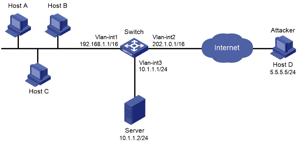

Attack detection and prevention configuration examples
Example: Configuring interface-based attack detection and prevention
As shown in Figure 1, configure an attack defense policy and apply the policy to VLAN-interface 2 to meet the following requirements:
·     Provide low-level scanning attack detection for internal hosts and servers. If a scanning attack is detected, log the attack and keep the attacker on the blacklist for 10 minutes.
·     Protect internal hosts and servers against smurf attacks. If a smurf attack is detected, log the attack.
·     Protect the internal server against SYN flood attacks. If the number of SYN packets sent to the server per second reaches or exceeds 5000, log the attack and drop subsequent packets.
Figure 1 Network diagram
# Configure IP addresses for the interfaces on the switch. (Details not shown.)
# Enable the global blacklist feature.
<Switch> system-view
[Switch] blacklist global enable
# Create attack defense policy a1.
[Switch] attack-defense policy a1
# Configure signature detection for smurf attacks, and specify logging as the prevention action.
[Switch-attack-defense-policy-a1] signature detect smurf action logging
# Configure low-level scanning attack detection, specify logging and block-source as the prevention actions, and set the blacklist entry aging time to 10 minutes.
[Switch-attack-defense-policy-a1] scan detect level low action logging block-source timeout 10
# Configure SYN flood attack detection for 10.1.1.2, set the attack prevention triggering threshold to 5000, and specify logging and drop as the prevention actions.
[Switch-attack-defense-policy-a1] syn-flood detect ip 10.1.1.2 threshold 5000 action logging drop
[Switch-attack-defense-policy-a1] quit
# Apply attack defense policy a1 to VLAN-interface 2.
[Switch-Vlan-interface2] attack-defense apply policy a1
[Switch-Vlan-interface2] quit
# Verify that attack defense policy a1 is successfully configured.
[Switch] display attack-defense policy a1
          Attack-defense Policy Information
Policy name                        : a1
Applied list                       : Vlan2
Exempt IPv4 ACL                    : Not configured
Exempt IPv6 ACL                    : Not configured
  Actions: CV-Client verify  BS-Block source  L-Logging  D-Drop  N-None
Signature attack defense configuration:
Signature name                     Defense      Level             Actions
Fragment                           Disabled     low               L
Impossible                         Disabled     medium            L,D
Teardrop                           Disabled     medium            L,D
Tiny fragment                      Disabled     low               L
IP option abnormal                 Disabled     medium            L,D
Smurf                              Enabled      medium            L
Traceroute                         Disabled     low               L
Ping of death                      Disabled     medium            L,D
Large ICMP                         Disabled     info              L
  Max length                       4000 bytes
Large ICMPv6                       Disabled     info              L
TCP invalid flags                  Disabled     medium            L,D
TCP null flag                      Disabled     medium            L,D
TCP all flags                      Disabled     medium            L,D
TCP SYN-FIN flags                  Disabled     medium            L,D
TCP FIN only flag                  Disabled     medium            L,D
TCP Land                           Disabled     medium            L,D
Winnuke                            Disabled     medium            L,D
UDP Bomb                           Disabled     medium            L,D
UDP Snork                          Disabled     medium            L,D
UDP Fraggle                        Disabled     medium            L,D
IP option record route             Disabled     info              L
IP option internet timestamp       Disabled     info              L
IP option security                 Disabled     info              L
IP option loose source routing     Disabled     info              L
IP option stream ID                Disabled     info              L
IP option strict source routing    Disabled     info              L
IP option route alert              Disabled     info              L
ICMP echo request                  Disabled     info              L
ICMP echo reply                    Disabled     info              L
ICMP source quench                 Disabled     info              L
ICMP destination unreachable       Disabled     info              L
ICMP redirect                      Disabled     info              L
ICMP time exceeded                 Disabled     info              L
ICMP parameter problem             Disabled     info              L
ICMP timestamp request             Disabled     info              L
ICMP timestamp reply               Disabled     info              L
ICMP information request           Disabled     info              L
ICMP information reply             Disabled     info              L
ICMP address mask request          Disabled     info              L
ICMP address mask reply            Disabled     info              L
ICMPv6 echo request                Disabled     info              L
ICMPv6 echo reply                  Disabled     info              L
ICMPv6 group membership query      Disabled     info              L
ICMPv6 group membership report     Disabled     info              L
ICMPv6 group membership reduction  Disabled     info              L
ICMPv6 destination unreachable     Disabled     info              L
ICMPv6 time exceeded               Disabled     info              L
ICMPv6 parameter problem           Disabled     info              L
ICMPv6 packet too big              Disabled     info              L
Scan attack defense configuration:
 Defense : Enabled
 Level   : low
 Actions : L,BS(10)
Flood attack defense configuration:
Flood type      Global thres(pps)  Global actions  Service ports   Non-specific
SYN flood       1000(default)      -               -               Disabled
ACK flood       1000(default)      -               -               Disabled
SYN-ACK flood   1000(default)      -               -               Disabled
RST flood       1000(default)      -               -               Disabled
FIN flood       1000(default)      -               -               Disabled
UDP flood       1000(default)      -               -               Disabled
ICMP flood      1000(default)      -               -               Disabled
ICMPv6 flood    1000(default)      -               -               Disabled
DNS flood       1000(default)      -               53              Disabled
HTTP flood      1000(default)      -               80              Disabled
Flood attack defense for protected IP addresses:
 Address                 VPN instance Flood type    Thres(pps) Actions Ports
 10.1.1.2                --           SYN-FLOOD     5000       L,D     -
# Verify that the attack detection and prevention takes effect on VLAN-interface 2.
[Switch] display attack-defense statistics interface vlan-interface 2
Attack policy name: a1
Scan attack defense statistics:
 AttackType                          AttackTimes Dropped
 Port scan                           2           0
 IP sweep                            3           0
 Distribute port scan                1           0
Flood attack defense statistics:
 SYN flood                           1           5000
Signature attack defense statistics:
 Smurf                               1           0
# Verify that the IPv4 blacklist feature collaborates with the scanning attack detection.
[Switch] display blacklist ip
IP address      VPN instance   DS-Lite tunnel peer  Type    TTL(sec) Dropped
5.5.5.5         --             --                   Dynamic 600      353452

# Enable global SYN flood attack detection, set the global threshold for triggering SYN flood attack prevention to 2000, and specify logging as the global attack prevention action.
[Switch-attack-defense-policy-a1] syn-flood detect non-specific
[Switch-attack-defense-policy-a1] syn-flood threshold 2000
[Switch-attack-defense-policy-a1] syn-flood action logging
# Apply the attack defense policy to the device.
[Switch] attack-defense local apply policy a1
