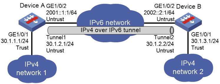

IPv4 over IPv6 tunneling
About IPv4 over IPv6 tunneling
Implementation
IPv4 over IPv6 tunneling adds an IPv6 header to IPv4 packets so that the IPv4 packets can pass an IPv6 network through a tunnel to realize interworking between isolated IPv4 networks.
Figure 15 IPv4 over IPv6 tunnel
Figure 15 shows the encapsulation and de-encapsulation processes.
·     Encapsulation:
a.     Upon receiving an IPv4 packet, Device A delivers it to the IPv4 protocol stack.
b.     The IPv4 protocol stack uses the destination address of the packet to determine the egress interface. If the egress interface is the tunnel interface, the IPv4 protocol stack delivers the packet to the tunnel interface.
c.     The tunnel interface adds an IPv6 header to the original IPv4 packet and delivers the packet to the IPv6 protocol stack.
d.     The IPv6 protocol stack uses the destination IPv6 address of the packet to look up the routing table, and then sends it out.
·     De-encapsulation:
a.     Upon receiving the IPv6 packet from the attached IPv6 network, Device B delivers the packet to the IPv6 protocol stack to examine the protocol type encapsulated in the data portion of the packet.
b.     If the protocol type is IPv4, the IPv6 protocol stack delivers the packet to the tunneling module.
c.     The tunneling module removes the IPv6 header and delivers the remaining IPv4 packet to the IPv4 protocol stack.
d.     The IPv4 protocol stack forwards the IPv4 packet.

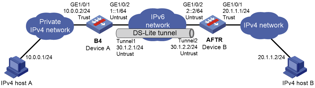

DS-Lite tunnel
Dual Stack Lite (DS-Lite) is a combination of the tunneling and NAT technologies. NAT translates the private IPv4 addresses of the IPv4 hosts before the hosts reach the IPv4 public network.
DS-Lite tunnel supports only an IPv4 host in a private network initiating communication with an IPv4 host on the Internet. It does not support an IPv4 host on the Internet initiating communication with an IPv4 host in a private network.
Figure 16 DS-Lite tunnel
As shown in Figure 16, the DS-Lite feature contains the following components:
·     Basic Bridging BroadBand (B4) element
The B4 element is typically a CPE router that connects end hosts. IPv4 packets entering the B4 router are encapsulated into IPv6 packets and sent to the AFTR. IPv6 packets from the AFTR are de-encapsulated into IPv4 packets and sent to the subscriber's network.
Hosts that can act as the B4 router are referred to as DS-Lite hosts.
·     Address Family Transition Router (AFTR)
An AFTR resides in the ISP network and terminates the tunnel from the B4 router. NAT is also implemented on the interface that is connected to the public IPv4 network.
An AFTR de-encapsulates the tunneled packet, translates the network address, and routes the packet to the destination IPv4 network. For IPv4 packets coming from the public IPv4 network, the AFTR performs reverse address translation and sends them to the B4 router by using the DS-Lite tunnel.
Figure 17 Packet forwarding process in DS-Lite
As shown in Figure 17, the packet forwarding process in DS-Lite is as follows:
1.     Upon receiving a packet from the private IPv4 network, the B4 router adds an IPv6 header to the packet and sends the IPv6 packet to the AFTR through the tunnel.
2.     The AFTR performs the following operations:
a.     Removes the IPv6 header from the tunneled packet.
b.     Assigns a tunnel ID for the B4 router.
c.     Records the mapping between the IPv6 address of the B4 router (the source IPv6 address of the packet), and the tunnel ID.
3.     After de-encapsulation, the AFTR translates the source private IPv4 address of the packet into a public IPv4 address and sends the packet to the destination IPv4 host. The AFTR also maps the NAT entries to the tunnel ID so that IPv4 networks connected to different B4 routers can use the same address space.
4.     Upon receiving the response packet from the public network, the AFTR translates the destination public IPv4 address into the private IPv4 address. The AFTR performs the following operations:
a.     Looks up the IPv6 address-tunnel ID mapping to obtain the IP address of the B4 router.
b.     Uses the address as the destination address of the encapsulated IPv6 packet.
c.     Forwards the packet to the B4 router.
Figure 17 shows an example of PAT translation for dynamic NAT. Typically, dynamic NAT is used. When you use static NAT for DS-Lite tunneling, make sure the IP addresses of private IPv4 networks connected to different B4 routers do not overlap. For more information about NAT, see NAT Configuration Guide.

Example: Configuring an IPv4 over IPv6 manual tunnel
As shown in Figure 18, configure an IPv4 over IPv6 manual tunnel between Device A and Device B so the two networks can reach each other over the IPv6 network.
Figure 18 Network diagram

Example: Configuring a DS-Lite tunnel
As shown in Figure 19, to enable hosts in the private IPv4 network to access the public IPv4 network over the IPv6 network, perform the following tasks:
·     Configure a DS-Lite tunnel between Device A and Device B.
·     Configure NAT on GigabitEthernet 1/0/1 on the AFTR.
Figure 19 Network diagram

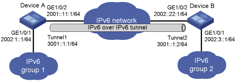

IPv6 over IPv6 tunneling
About IPv6 over IPv6 tunneling
IPv6 over IPv6 tunneling (RFC 2473) enables isolated IPv6 networks to communicate with each other over another IPv6 network. For example, two isolated IPv6 networks that do not want to show their addresses to the Internet can use an IPv6 over IPv6 tunnel to communicate with each other.
Figure 20 Principle of IPv6 over IPv6 tunneling
Figure 20 shows the encapsulation and de-encapsulation processes.
·     Encapsulation:
a.     After receiving an IPv6 packet, Device A submits it to the IPv6 protocol stack.
b.     The IPv6 protocol stack uses the destination IPv6 address of the packet to find the egress interface. If the egress interface is the tunnel interface, the stack delivers it to the tunnel interface.
c.     After receiving the packet, the tunnel interface adds an IPv6 header to it and submits it to the IPv6 protocol stack.
d.     The IPv6 protocol stack forwards the packet according to its destination IPv6 address.
·     De-encapsulation:
a.     Upon receiving the IPv6 packet, Device B delivers it to the IPv6 protocol stack.
b.     The IPv6 protocol stack checks the protocol type of the data portion encapsulated in the IPv6 packet. If the encapsulation protocol is IPv6, the stack delivers the packet to the tunnel module.
c.     The tunnel module de-encapsulates the packet and sends it back to the IPv6 protocol stack.
d.     The IPv6 protocol stack forwards the IPv6 packet.

IPv6 over IPv6 tunnel configuration examples
Example: Configuring an IPv6 over IPv6 tunnel
As shown in Figure 22, configure an IPv6 over IPv6 tunnel between Device A and Device B so the IPv6 groups can reach each other without disclosing their IPv6 addresses.
Figure 22 Network diagram
Make sure Device A and Device B can reach each other through IPv6.
1.     Configure Device A:
# Assign an IPv6 address to interface GigabitEthernet 1/0/1.
<DeviceA> system-view
[DeviceA-GigabitEthernet1/0/1] ipv6 address 2002:1::1 64
[DeviceA-GigabitEthernet1/0/1] quit
# Assign an IPv6 address to interface GigabitEthernet 1/0/2, the physical interface of the tunnel.
[DeviceA] interface gigabitethernet 1/0/2
[DeviceA-GigabitEthernet1/0/2] ipv6 address 2001::11:1 64
[DeviceA-GigabitEthernet1/0/2] quit
# Create IPv6 over IPv6 tunnel interface Tunnel 1.
[DeviceA] interface tunnel 1 mode ipv6-ipv6
# Specify an IPv6 address for the tunnel interface.
[DeviceA-Tunnel1] ipv6 address 3001::1:1 64
# Specify the IP address of GigabitEthernet 1/0/2 as the source address of the tunnel.
[DeviceA-Tunnel1] source 2001::11:1
# Specify the IP address of GigabitEthernet 1/0/2 on Device B as the destination address of the tunnel.
[DeviceA-Tunnel1] destination 2002::22:1
[DeviceA-Tunnel1] quit
# Configure a static route destined for the IPv6 network group 2 through the tunnel.
[DeviceA] ipv6 route-static 2002:3:: 64 tunnel 1
2.     Configure Device B:
<DeviceB> system-view
[DeviceB-GigabitEthernet1/0/1] ipv6 address 2002:3::1 64
[DeviceB-GigabitEthernet1/0/1] quit
[DeviceB] interface gigabitethernet 1/0/2
[DeviceB-GigabitEthernet1/0/2] ipv6 address 2002::22:1 64
[DeviceB-GigabitEthernet1/0/2] quit
# Create IPv6 over IPv6 tunnel interface Tunnel 2.
[DeviceB] interface tunnel 2 mode ipv6-ipv6
[DeviceB-Tunnel2] ipv6 address 3001::1:2 64
[DeviceB-Tunnel2] source 2002::22:1
# Specify the IP address of GigabitEthernet 1/0/2 on Device A as the destination address of the tunnel.
[DeviceB-Tunnel2] destination 2001::11:1
[DeviceB-Tunnel2] quit
# Configure a static route destined for the IPv6 network group 1 through the tunnel.
[DeviceB] ipv6 route-static 2002:1:: 64 tunnel 2
# Use the display ipv6 interface command to display the status of the tunnel interfaces on Device A and Device B. Verify that the tunnel interfaces are up. (Details not shown.)
# Verify that Device A and Device B can ping the IPv6 address of interface GigabitEthernet 1/0/1 of each other. This example uses Device A.
[DeviceA] ping ipv6 -a 2002:1::1 2002:3::1
Ping6(56 data bytes) 2002:1::1 --> 2002:3::1, press CTRL_C to break
56 bytes from 2002:3::1, icmp_seq=0 hlim=64 time=9.000 ms
56 bytes from 2002:3::1, icmp_seq=1 hlim=64 time=1.000 ms
56 bytes from 2002:3::1, icmp_seq=2 hlim=64 time=0.000 ms
56 bytes from 2002:3::1, icmp_seq=3 hlim=64 time=0.000 ms
56 bytes from 2002:3::1, icmp_seq=4 hlim=64 time=0.000 ms
--- Ping6 statistics for 2002:3::1 ---
round-trip min/avg/max/std-dev = 0.000/2.000/9.000/3.521 ms
