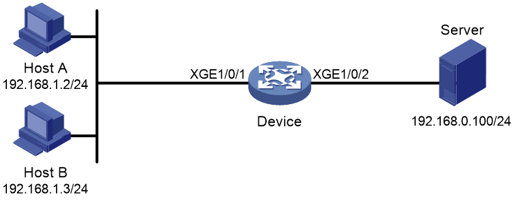

As shown in Figure 1, configure an ACL on the device to allow Host A to access the server only during 8:00 and 18:00 on working days from June 2015 to the end of the year.
Figure 1 Network diagram
# Create a periodic time range during 8:00 and 18:00 on working days from June 2015 to the end of the year.

# Verify that the time range work is active on the device.
[Device] display time-range all
Current time is 13:58:35 6/19/2015 Friday
Time-range : work (Active)
 08:00 to 18:00 working-day
 from 00:00 6/1/2015 to 00:00 1/1/2016
