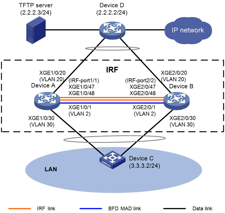

As shown in Figure 1, Device A and Device B are S10500 switches. They have set up an IRF fabric. Device A is the master device and its member ID is 1, and Device B is the standby device and its member ID is 2. BFD MAD is used for multi-active collision detection.
The current software version of the IRF fabric is R2432P06. Upgrade the software version to R2720. After software upgrade, Device A is still the master device.
Figure 1 Network diagram

To upgrade software on an IRF fabric from the CLI by using the boot loader method:
1.     Shut down all uplink and downlink service interfaces on the master device (Device A) in bulk to switch traffic from Device A to Device B. To enter interface range view, use the interface rang command.
2.     Upgrade software on Device A from the CLI by using the boot loader method and reboot the device. During the reboot, shut down IRF physical interfaces Ten-GigabitEthernet 2/0/47 and Ten-GigabitEthernet 2/0/48 on Device B. The IRF fabric splits.
CAUTION
CAUTION:
To prevent configuration loss from affecting interface status and causing IRF merge failure or service traffic interruption, do not save the running configuration on any IRF member device when the IRF fabric splits.
To split an IRF fabric, you can remove cables from IRF physical interfaces or shut down all IRF physical interfaces on the standby device. The latter method is simpler. In this example, the latter method is used.
3.     Shut down all uplink and downlink service interfaces on the standby device (Device B) in bulk. Bring up all uplink and downlink service interfaces on Device A to switch service traffic back to Device A.
4.     Upgrade software on Device B. After Device B reboots, Device A and Device B automatically form an IRF fabric.

Disabling MAD (BFD MAD in the example)
# Disable MAD and remove cables from the interfaces used for MAD. In this example, VLAN-interface 2 is used for BFD MAD.
<IRF> system-view
[IRF] interface vlan-interface 2
[IRF-Vlan-interface2] undo mad bfd enable
[IRF-Vlan-interface2] display this
interface Vlan-interface2
return
Shutting down service interfaces on the master device and saving the configuration
# Shut down all uplink and downlink interfaces on Device A. Do not shut down IRF physical interfaces and the interfaces used for BFD MAD on Device A.
[IRF] interface range name yewu interface ten-gigabitethernet 1/0/2 to ten-gigabitethernet 1/0/46 fortygige 1/0/49 to fortygige 1/0/54
[IRF-if-range-yewu] shutdown
[IRF-if-range-yewu] quit
[IRF] quit
# On Device D and Device C, ping each other. If the ping operations succeed, Device C and Device D are reachable. If the ping operations fail, locate and resolve the communication failure issue. (Details not shown.)
# Verify that all services have been switched from Device A to Device B. (Details not shown.)
# Save the running configuration.
<IRF> save
The current configuration will be written to the device. Are you sure? [Y/N]:y
Please input the file name(*.cfg)[flash:/startup.cfg]
(To leave the existing filename unchanged, press the enter key):
Validating file. Please wait...
The startup.cfg file already exists.
Compared with the startup.cfg file, The current configuration adds 0 commands and deletes 0 commands.
If you want to see the configuration differences, please cancel this operation, and then use the display diff command to show the details.
If you continue the save operation, the file will be overwritten.
Are you sure you want to continue the save operation? [Y/N]:y
Saving the current configuration to the file. Please wait...
Saved the current configuration to mainboard device successfully.
Slot 2:
Save next configuration file successfully.
Rebooting the master device and splitting the IRF fabric
# Reboot the master device (Device A).
<IRF> reboot slot 1
Start to check configuration with next startup configuration file, please wait..
.......DONE!
Current configuration may be lost after the reboot, save current configuration?
[Y/N]:y
flash:/startup.cfg exists, overwrite? [Y/N]:y
This command will reboot the device. Continue? [Y/N]:y
Now rebooting, please wait..........
# Shut down IRF physical interfaces Ten-GigabitEthernet 2/0/47 and Ten-GigabitEthernet 2/0/48 on Device B to cause IRF split.
CAUTION
CAUTION:
The IRF fabric splits after you shut down all IRF physical interfaces on Device B. To prevent configuration loss from affecting interface status and causing IRF merge failure or service traffic interruption, do not save the running configuration on the master device (Device A) when the IRF fabric splits.
<IRF> system-view
[IRF] interface range name irf-port interface ten-gigabitethernet 2/0/47 to ten-gigabitethernet 2/0/48
[IRF-if-range-irf-port] shutdown
Shutting down service interfaces on the standby device and bringing up service interfaces on the master device
IMPORTANT
IMPORTANT:
To reduce the service interruption time, shorten the operation time as much as possible. As a best practice, prepare the required command lines in advance and copy and paste the command lines to the devices.
# After Device A finishes startup, verify that all interfaces are displayed.
<IRF> display interface
# Wait for about 2 minutes for forwarding entry update.
# Verify that Device A is stable.
<IRF> display system stable state
System state     : Stable
Redundancy state : No redundancy
  Slot    CPU    Role       State
  1        0          Active     Stable
# Log in to Device B and shut down all service interfaces on the device. Do not shut down IRF physical interfaces and the interfaces used for BFD MAD.
<IRF> system-view
[IRF] interface range name yewu-2 interface ten-gigabitethernet 2/0/2 to ten-gigabitethernet 2/0/46 fortygige 2/0/49 to fortygige 2/0/54
[IRF-if-range-yewu-2] shutdown
# Log in to Device A and bring up all service interfaces on the device.
<IRF> system-view
[IRF-if-range-yewu] undo shutdown
Rebooting the standby device
# Verify that services have been switched back to Device A, and then log in to Device B and reboot Device B.
<IRF> reboot slot 2
.......DONE!
[Y/N]:y
After Device B reboots, it acts as a standby device to complete IRF merge with Device A.
Checking the environment after IRF software upgrade
1.     Check IRF status and services:
# After Device B reboots, check IRF status and service status, collect status information, and compare the status information with that before upgrade. If the status information is inconsistent before and after upgrade, locate and resolve the issue.
[IRF] display system stable state
[IRF] display irf
[IRF] display irf configuration
[IRF] display irf link
[IRF] display irf topology
2.     Enable MAD, verify the configuration, and save the configuration.
[IRF-Vlan-interface2] mad bfd enable
[IRF-Vlan-interface2] mad ip address 192.168.2.1 24 member 1
[IRF-Vlan-interface2] mad ip address 192.168.2.2 24 member 2
[IRF-Vlan-interface2] quit
[IRF] display mad verbose
Multi-active recovery state: No
Excluded ports (user-configured):
Excluded ports (system-configured):
  IRF physical interfaces:
    Ten-GigabitEthernet1/0/47
    Ten-GigabitEthernet1/0/48
    Ten-GigabitEthernet2/0/47
    Ten-GigabitEthernet2/0/48
  BFD MAD interfaces:
    Vlan-interface2
MAD ARP disabled.
MAD ND disabled.
MAD LACP disabled.
MAD BFD enabled interface: Vlan-interface2
  MAD status                 : Normal
  Member ID   MAD IP address       Neighbor   MAD status
  1           192.168.2.1/24       2          Normal
  2           192.168.2.2/24       1          Normal
