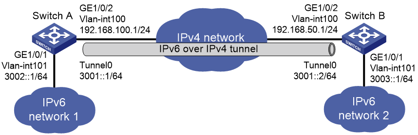

IPv6 over IPv4 tunneling enables isolated IPv6 networks to communicate, as shown in Figure 1.
The devices at both ends of an IPv6 over IPv4 tunnel must support the IPv4/IPv6 dual stack.
Figure 1 IPv6 over IPv4 tunnel
The IPv6 over IPv4 tunnel processes packets by using the following steps:
1.     A host in the IPv6 network sends an IPv6 packet to Device A at the tunnel source.
2.     After Device A receives the IPv6 packet, it processes the packet as follows:
a.     Searches the routing table to identify the outgoing interface for the IPv6 packet.
The outgoing interface is the tunnel interface, so Device A knows that the packet needs to be forwarded through the tunnel.
b.     Adds an IPv4 header to the IPv6 packet and forwards the packet through the physical interface of the tunnel.
In the IPv4 header, the source IPv4 address is the IPv4 address of the tunnel source, and the destination IPv4 address is the IPv4 address of the tunnel destination.
3.     Upon receiving the packet, Device B de-encapsulates the packet.
4.     If the destination address of the IPv6 packet is itself, Device B forwards it to the upper-layer protocol. If it is not, Device B forwards it according to the routing table.

Manual tunneling provides the following solutions:
·     Connects isolated IPv6 networks over an IPv4 network.
·     Connects an IPv6 network and an IPv4/IPv6 dual-stack host over an IPv4 network.

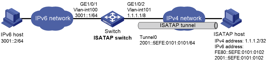

ISATAP tunneling
An ISATAP tunnel is a point-to-multipoint automatic tunnel. It provides a solution to connect an IPv6 host and an IPv6 network over an IPv4 network.
The destination address of an ISATAP tunnel is an ISATAP address. The address format is prefix:0:5EFE:abcd:efgh/64.
·     The 64-bit prefix is a valid IPv6 unicast address prefix.
·     The abcd:efgh/64 segments represent a 32-bit IPv4 address in hexadecimal notation, which identifies the tunnel destination but does not require global uniqueness.
ISATAP tunnels are mainly used for communication between IPv6 routers or between an IPv6 host and an IPv6 router over an IPv4 network.
Figure 3 Principle of ISATAP tunneling
IPv6 over IPv4 tunneling tasks at a glance
To configure IPv6 over IPv4 tunneling, perform the following tasks:
1.     Configuring an IPv6 over IPv4 tunnel
¡     Configuring an IPv6 over IPv4 manual tunnel
¡     Configuring a 6to4 tunnel
¡     Configuring an ISATAP tunnel
2.     (Optional.) Enabling dropping IPv6 packets that use IPv4-compatible IPv6 addresses
When you perform tasks in this section, follow these restrictions and guidelines:
·     The tunnel destination address specified on the local device must be identical with the tunnel source address specified on the tunnel peer device.
·     Do not specify the same tunnel source and destination addresses for the tunnel interfaces in the same mode on a device.
·     To ensure correct packet forwarding, identify whether the destination IPv6 network and the IPv6 address of the local tunnel interface are on the same subnet. If they are not, configure a route reaching the destination IPv6 network through the tunnel interface. You can configure the route by using one of the following methods:
¡     Configure a static route, and specify the local tunnel interface as the egress interface or specify the IPv6 address of the peer tunnel interface as the next hop.
¡     Enable a dynamic routing protocol on the tunnel interface.
The route configuration is required on both ends of the tunnel. For more information about route configuration, see Layer 3—IP Routing Configuration Guide.

Example: Configuring an ISATAP tunnel
As shown in Figure 7, configure an ISATAP tunnel between the switch and the ISATAP host so the ISATAP host in the IPv4 network can access the IPv6 network.
Figure 7 Network diagram
1.     Configure the switch:
# Add GigabitEthernet 1/0/1 to VLAN 100.
<Switch> system-view
[Switch] vlan 100
[Switch-vlan100] port gigabitethernet 1/0/1
[Switch-vlan100] quit
# Specify an IPv6 address for VLAN-interface 100.
[Switch-Vlan-interface100] ipv6 address 3001::1/64
# Add GigabitEthernet 1/0/2 (the physical interface of the tunnel) to VLAN 101.
[Switch] vlan 101
[Switch-vlan101] port gigabitethernet 1/0/2
[Switch-vlan101] quit
# Specify an IPv4 address for VLAN-interface 101.
[Switch] interface vlan-interface 101
[Switch-Vlan-interface101] ip address 1.1.1.1 255.0.0.0
[Switch-Vlan-interface101] quit
# Create ISATAP tunnel interface Tunnel 0.
[Switch] interface tunnel 0 mode ipv6-ipv4 isatap
# Specify an EUI-64 IPv6 address for the tunnel interface.
[Switch-Tunnel0] ipv6 address 2001:: 64 eui-64
# Specify VLAN-interface 101 as the source interface of the tunnel interface.
[Switch-Tunnel0] source vlan-interface 101
# Disable RA suppression so that the ISATAP host can acquire information such as the address prefix from the RA message advertised by the ISATAP switch.
[Switch-Tunnel0] undo ipv6 nd ra halt
[Switch-Tunnel0] quit
2.     Configure the ISATAP host:
Configurations on the ISATAP host vary by operating system. The following configuration is performed on Windows 7.
# Specify an IPv4 address for the ISATAP switch.
C:\>netsh interface ipv6 isatap set router 1.1.1.1
3.     On the IPv6 host, configure a route to the ISATAP switch.
C:\>netsh interface ipv6 set route 2001::/64 5 3001::1
# Verify that the ISATAP host can ping the IPv6 host.
C:\>ping 3001::2
Pinging 3001::2 with 32 bytes of data:
Reply from 3001::2: time=1ms
Ping statistics for 3001::2:

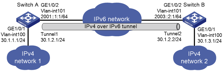

IPv4 over IPv6 tunneling
About IPv4 over IPv6 tunneling
Implementation
IPv4 over IPv6 tunneling adds an IPv6 header to IPv4 packets so that the IPv4 packets can pass an IPv6 network through a tunnel to realize interworking between isolated IPv4 networks.
Figure 10 IPv4 over IPv6 tunnel
Figure 10 shows the encapsulation and de-encapsulation processes.
·     Encapsulation:
a.     Upon receiving an IPv4 packet, Device A delivers it to the IPv4 protocol stack.
b.     The IPv4 protocol stack uses the destination address of the packet to determine the egress interface. If the egress interface is the tunnel interface, the IPv4 protocol stack delivers the packet to the tunnel interface.
c.     The tunnel interface adds an IPv6 header to the original IPv4 packet and delivers the packet to the IPv6 protocol stack.
d.     The IPv6 protocol stack uses the destination IPv6 address of the packet to look up the routing table, and then sends it out.
·     De-encapsulation:
a.     Upon receiving the IPv6 packet from the attached IPv6 network, Device B delivers the packet to the IPv6 protocol stack to examine the protocol type encapsulated in the data portion of the packet.
b.     If the protocol type is IPv4, the IPv6 protocol stack delivers the packet to the tunneling module.
c.     The tunneling module removes the IPv6 header and delivers the remaining IPv4 packet to the IPv4 protocol stack.
d.     The IPv4 protocol stack forwards the IPv4 packet.

Example: Configuring an IPv4 over IPv6 tunnel
As shown in Figure 11, configure an IPv4 over IPv6 tunnel between Switch A and Switch B so the two networks can reach each other over the IPv6 network.
Figure 11 Network diagram
Make sure Switch A and Switch B have the corresponding VLAN interfaces created and can reach each other through IPv6.
1.     Configure Switch A:
<SwitchA> system-view
[SwitchA] vlan 100
[SwitchA-vlan100] port gigabitethernet 1/0/1
[SwitchA-vlan100] quit
# Specify an IPv4 address for VLAN-interface 100.
[SwitchA-Vlan-interface100] ip address 30.1.1.1 255.255.255.0
[SwitchA] vlan 101
[SwitchA-vlan101] port gigabitethernet 1/0/2
[SwitchA-vlan101] quit
# Specify an IPv6 address for VLAN-interface 101.
[SwitchA] interface vlan-interface 101
[SwitchA-Vlan-interface101] ipv6 address 2001::1:1 64
[SwitchA-Vlan-interface101] quit
# Create IPv4 over IPv6 tunnel interface Tunnel 1.
[SwitchA] interface tunnel 1 mode ipv4-ipv6
# Specify an IPv4 address for the tunnel interface.
[SwitchA-Tunnel1] ip address 30.1.2.1 255.255.255.0
# Specify the IP address of VLAN-interface 101 as the source address for the tunnel interface.
[SwitchA-Tunnel1] source 2001::1:1
# Specify the IP address of VLAN-interface 101 on Switch B as the destination address for the tunnel interface.
[SwitchA-Tunnel1] destination 2003::2:1
[SwitchA-Tunnel1] quit
# Configure a static route destined for IPv4 network 2 through the tunnel interface.
[SwitchA] ip route-static 30.1.3.0 255.255.255.0 tunnel 1
2.     Configure Switch B:
<SwitchB> system-view
[SwitchB] vlan 100
[SwitchB-vlan100] port gigabitethernet 1/0/1
[SwitchB-vlan100] quit
[SwitchB-Vlan-interface100] ip address 30.1.3.1 255.255.255.0
[SwitchB] vlan 101
[SwitchB-vlan101] port gigabitethernet 1/0/2
[SwitchB-vlan101] quit
[SwitchB] interface vlan-interface 101
[SwitchB-Vlan-interface101] ipv6 address 2003::2:1 64
[SwitchB-Vlan-interface101] quit
# Create IPv4 over IPv6 tunnel interface Tunnel 2.
[SwitchB] interface tunnel 2 mode ipv4-ipv6
[SwitchB-Tunnel2] ip address 30.1.2.2 255.255.255.0
# Specify the IP address of VLAN-interface 101 as the source address for the tunnel interface (IP address of VLAN-interface 101).
[SwitchB-Tunnel2] source 2003::2:1
# Specify the IP address of VLAN-interface 101 on Switch A as the destination address for the tunnel interface.
[SwitchB-Tunnel2] destination 2001::1:1
[SwitchB-Tunnel2] quit
# Configure a static route destined for IPv4 network 1 through the tunnel interface.
[SwitchB] ip route-static 30.1.1.0 255.255.255.0 tunnel 2
# Use the display interface tunnel command to display the status of the tunnel interfaces on Switch A and Switch B. Verify that the tunnel interfaces are up. (Details not shown.)
# Verify that Switch A and Switch B can ping the IPv4 address of the peer interface. This example uses Switch A.
[SwitchA] ping -a 30.1.1.1 30.1.3.1
Ping 30.1.3.1 (30.1.3.1) from 30.1.1.1: 56 data bytes, press CTRL+C to break
56 bytes from 30.1.3.1: icmp_seq=0 ttl=255 time=3.000 ms
56 bytes from 30.1.3.1: icmp_seq=1 ttl=255 time=1.000 ms
56 bytes from 30.1.3.1: icmp_seq=2 ttl=255 time=0.000 ms
56 bytes from 30.1.3.1: icmp_seq=3 ttl=255 time=1.000 ms
56 bytes from 30.1.3.1: icmp_seq=4 ttl=255 time=1.000 ms
--- Ping statistics for 30.1.3.1 ---
round-trip min/avg/max/std-dev = 0.000/1.200/3.000/0.980 ms
