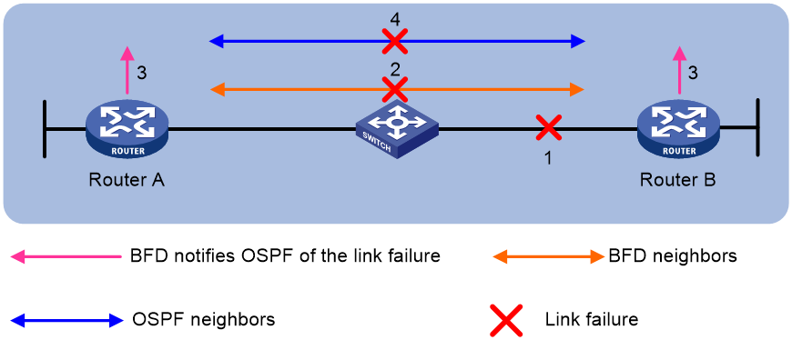

Figure 2 describes the BFD fault detection process.
1.     BFD detects a link failure and tears down the session.
2.     BFD notifies the neighbor unreachability to OSPF.
3.     OSPF terminates the neighbor relationship on the link.
Figure 2 BFD fault detection

·     Multihop detection—Detects any of the paths between two systems, for example, Device A and Device B as shown in Figure 4. These paths have multiple hops, and might overlap.
Figure 4 Multihop detection

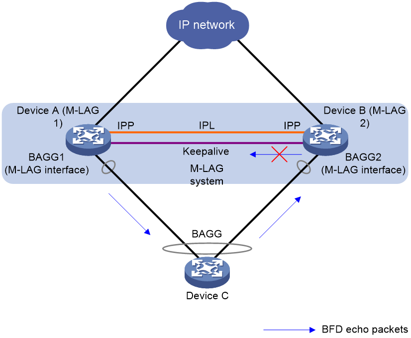

5.     Forwarding the specified BFD echo packets through the peer link in an M-LAG system
Typically, only local discriminators are required for static BFD sessions in echo packet mode, and you do not need to configure remote discriminators. In an M-LAG system, a BFD session state anomaly might occur if the following conditions exist:
·     AN M-LAG member device uses a static BFD session in echo packet mode to detect the link to the downlink device.
·     The destination IP address in the BFD echo packets is the same as the IP address of the other M-LAG member device.
For example, as shown in Figure 5, Device C in the user network is dual-homed to an OSPF network through an M-LAG system. The M-LAG member devices are configured as gateways to implement Layer 3 forwarding. The gateway interfaces (for example, VLAN interfaces or VSI interfaces) on the M-LAG member devices use the same IP address and MAC address. Each M-LAG member device uses a static BFD session in echo packet mode to detect the link to Device C. The destination IP address in the BFD echo packets sent by the M-LAG member devices is the gateway IP address. Upon receiving the BFD echo packet sent by M-LAG 1, Device C might forward the packet to M-LAG 2. M-LAG 2 does not send the packet to M-LAG 1 because the destination IP address in the packet is the local device. Because no BFD echo packet is received from Device C, the BFD session state will become abnormal on M-LAG 1.
To resolve this issue, you can specify the local discriminator on M-LAG 1 for M-LAG 2 as a remote discriminator. Upon receiving a BFD echo packet matching a remote discriminator, M-LAG 2 sends the packet to M-LAG 1 through the peer link. This ensures that the BFD session on M-LAG 1 can come up correctly. Similarly, you can specify the local discriminator on M-LAG 2 for M-LAG 1 as a remote discriminator to ensure that the BFD session on M-LAG 2 can come up correctly.
Figure 5 BFD for M-LAG
As a best practice, make sure the BFD session discriminators on the M-LAG member interfaces do not overlap in an M-LAG system.
1.     Enter system view
2.     Specify remote discriminators of static BFD sessions for the local device.
bfd forwarding match remote-discriminator discr-value-list { discr-value1 [ to discr-value2 ] } &<1-10>
By default, no remote discriminators of static BFD sessions are specified for the local device.
