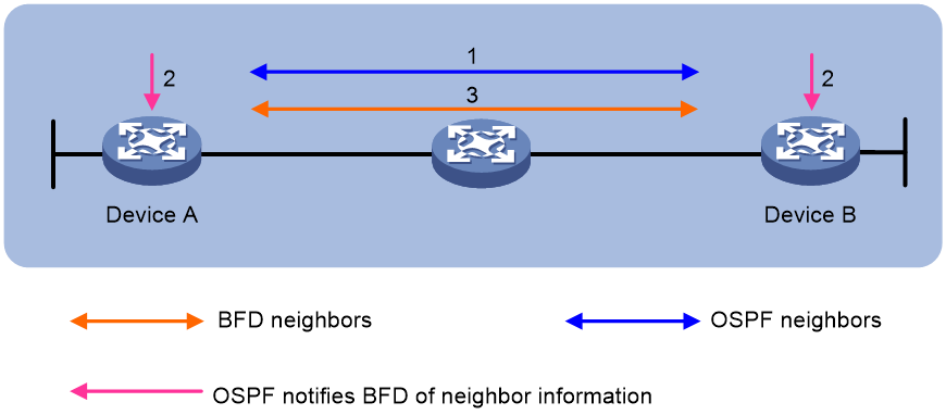

Figure 1 describes the operation of BFD for OSPF.
1.     OSPF discovers neighbors by sending Hello packets and establishes neighbor relationships.
2.     After establishing neighbor relationships, OSPF notifies BFD of the neighbor information, including destination and source addresses.
3.     BFD uses the information to establish BFD sessions.
Figure 1 BFD session establishment

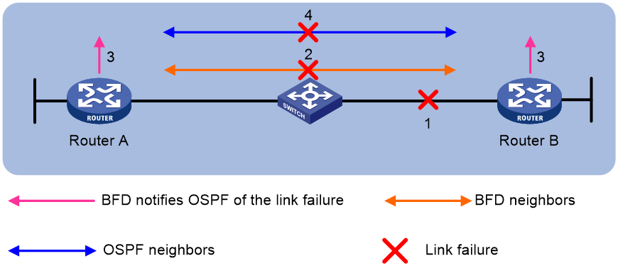

Figure 2 describes the BFD fault detection process.
1.     BFD detects a link failure and tears down the session.
2.     BFD notifies the neighbor unreachability to OSPF.
3.     OSPF terminates the neighbor relationship on the link.
Figure 2 BFD fault detection

Enabling the echo function
When you use Asynchronous mode BFD to detect the connectivity between directly connected devices, you can enable the echo function. This function enables the local system to periodically send echo packets to the remote system and reduces the control packet receiving rate to save bandwidth usage. The remote system loops back the echo packets to the local system without processing them. If the local system does not receive echo packets looped back from the remote system in a consecutive number of times, the local system declares the BFD session down.
This function is supported only for single-hop detection.
This function does not take effect on BFD sessions associated with interface states.
2.     Enter interface view.
3.     Enable the echo function.
bfd echo [ receive | send ] enable
By default, the echo function is disabled.
Associating the interface state with BFD
By creating a BFD session for single-hop detection through exchange of BFD control packets, this feature implements fast link detection. When BFD detects a link fault, it sets the link layer protocol state to DOWN(BFD). This behavior helps applications relying on the link layer protocol state achieve fast convergence. The source IP address of control packets is specified manually, and the destination IP address is fixed at 224.0.0.184. As a best practice, specify the IP address of the interface as the source IP address. If the interface does not have an IP address, specify a unicast IP address other than 0.0.0.0 as the source IP address.
You can associate the state of the following interfaces with BFD:
·     Layer 3 Ethernet interfaces and subinterfaces. For BFD detection to take effect, do not configure this feature on both a Layer 3 Ethernet interface and its subinterface.
·     Layer 3 aggregate interfaces, Layer 3 aggregate subinterfaces, and member ports (Layer 3 Ethernet interfaces only) in a Layer 3 aggregation group. For BFD detection to take effect, do not configure this feature on any two of the interface types at the same time.
·     VLAN interfaces.
The echo function does not take effect on BFD sessions associated with interface states.
3.     Associate the interface state with BFD.
bfd detect-interface source-ip ip-address [ discriminator local local-value remote remote-value ] [ template template-name ]
By default, the interface state is not associated with BFD. BFD does not set the link layer protocol of the interface to DOWN(BFD) state when detecting a failure.

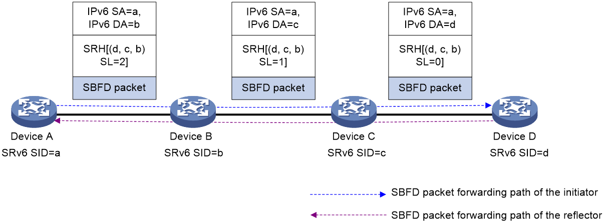

Configuring the initiator for SRv6 TE policy detection
SBFD can detect the connectivity of an SRv6 TE policy and provides millisecond-level fault detection and fast fault switchover. In an SRv6 TE policy, the candidate path with the greatest preference value acts as the primary path and that with the second greatest preference value acts as the backup path. SBFD detects both primary and backup paths and all SID lists of each path. If all the SID lists for the primary path are faulty, SBFD triggers a primary-to-back path switchover.
As shown in Figure 5, configure an SRv6 TE policy on Device A and use SBFD to detect the SRv6 TE policy. The detection process is as follows:
1.     The source node (Device A, the initiator) sends SBFD control packets that encapsulate the SID lists of the primary and backup candidate paths of the SRv6 TE policy.
2.     After the destination node (Device D, the reflector) receives an SBFD control packet, it checks whether the remote discriminator carried the packet is the same as the local discriminator. If they are the same, the reflector sends the response SBFD control packet to the initiator according to the IPv6 routing table. If they are different, the reflector drops the SBFD control packet.
3.     If the source node receives the response SBFD control packet before the detection time expires, it considers the corresponding SID list (forwarding path) of the SRv6 TE policy available. Otherwise, the device considers the SID list faulty. If all the SID lists for the primary path are faulty, SBFD triggers a primary-to-back path switchover.
Figure 5 SBFD for SRv6 TE policy procedure
You can enable SBFD for all SRv6 TE policies globally in SRv6 TE view or for a specific SRv6 TE policy in SRv6 TE policy view. The policy-specific configuration takes precedence over the global configuration. An SRv6 TE policy uses the global configuration only when it has no policy-specific configuration.
When informing SBFD to establish an SBFD session, the SRv6 TE policy sends the source and destination IP addresses of the packet to SBFD. The source IP address is specified by the sbfd source-ipv6 command. To configure SRv6 TE policy detection, make sure the remote device has a route to the IPv6 address specified by the sbfd source-ipv6 command.
In the current software version, you can enable SRv6 TE policy detection through BFD echo packets or SBFD. If you configure both detection methods for the same SRv6 TE policy, SBFD takes effect.
