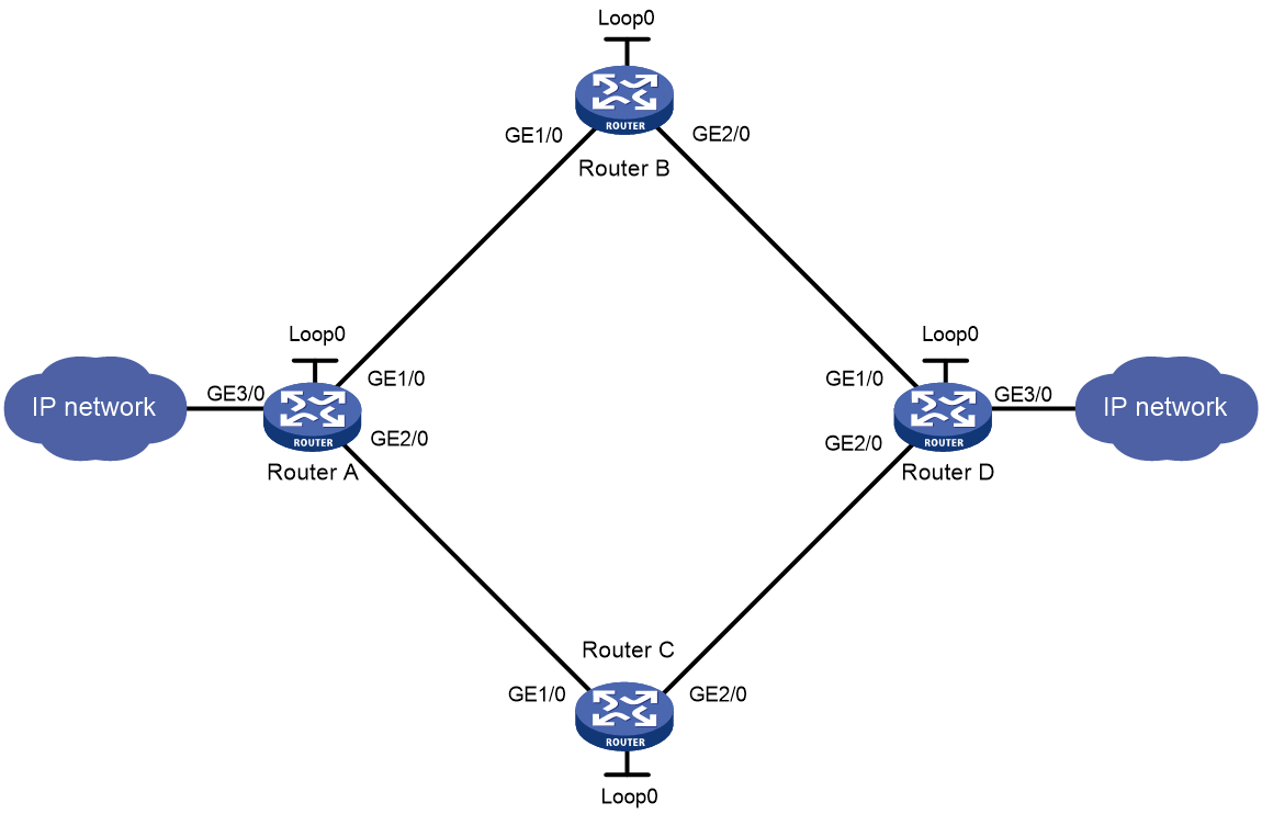

MPLS protection switching provides an end-to-end linear protection mechanism for MPLS TE tunnels. It associates an MPLS TE tunnel (working tunnel) with another MPLS TE tunnel (protection tunnel) to form a protection group. When the working tunnel fails, traffic is immediately switched to the protection tunnel, ensuring continuous traffic forwarding.
Protection switching triggering modes
A failure on the working tunnel triggers a protection switching. Protection switching can also be triggered by a command or a signal fail indication.
· Command switching (external switching)—A protection switching is triggered by an externally configured switching command, which can define the following switching actions (in the descending order of priority):
¡ Clear—Clears all configured switching actions.
¡ Lockout of protection—Always uses the working tunnel to forward traffic.
¡ Forced switch—Forces traffic to be switched from the working tunnel to the protection tunnel.
¡ Manual switch—Manually switches traffic from the working tunnel to the protection tunnel. If a failure has occurred on the protection tunnel, traffic is not switched.
· Signal fail switching—A protection switching is automatically triggered by a signal fail indication. The signaling can be BFD detection for MPLS TE tunnels or interface state (up/down) detection through link layer. For more information about configuring BFD for MPLS TE tunnels, see "Configuring MPLS OAM."
The following shows the protection switching triggers in the descending order of priority:

Protection switching modes
MPLS protection switching supports the following protection switching modes:
· 1:1 protection switching—Typically, traffic travels along the working tunnel. When either of the following events occurs, the ingress node selects the traffic forwarding tunnel (working or protection tunnel) according to the protection state:
¡ The ingress or egress node detects a failure on the working tunnel.
¡ An external switching command is executed on the node.
· 1+1 protection switching—Typically, traffic travels along both the working and protection tunnels, and the egress node receives traffic from the working tunnel. When either of the following events occurs, the egress node determines from which tunnel it receives traffic according to the protection state:
NOTE: · The tunnel ingress or egress node can detect tunnel failures through BFD for MPLS or other detection mechanisms. For more information about BFD for MPLS, see "Configuring MPLS OAM." · The protection state indicates the comprehensive status of a protection switching protection group. For more information, see the display mpls forwarding protection command in MPLS Command Reference. |
Path switching modes
A bidirectional MPLS TE tunnel switches the traffic forwarding path in one of the following modes:
· Unidirectional path switching—When an external switching command or a signal fail triggers protection switching for traffic in one direction, protection switching switches the traffic forwarding tunnel only in this direction. The traffic forwarding tunnel in the other direction does not change.
· Bidirectional path switching—When an external switching command or a signal fail triggers protection switching for traffic in one direction, protection switching switches the traffic forwarding tunnels in both directions.
The ingress node and the egress node periodically send Protection State Coordination (PSC) packets to each other to coordinate the protection state. When one tunnel end performs a protection switching, the other end also performs a protection switching.

MPLS protection switching configuration examples
Example: Configuring MPLS TE tunnel 1:1 protection switching
Router A, Router B, Router C, and Router D run IS-IS.
Establish two MPLS TE tunnels (Tunnel 1 and Tunnel 2) from Router A to Router D to allow communication between two IP networks over the MPLS TE tunnels. Tunnel 1 uses the path Router A—Router B—Router D. Tunnel 2 uses the path Router A—Router C—Router D.
Configure protection switching on Router A by creating an MPLS protection group, and specify Tunnel 1 as the working tunnel and Tunnel 2 as the protection tunnel.
Device |
Interface |
IP address |
Device |
Interface |
IP address |
Router A |
Loop0 |
1.1.1.1/32 |
Router D |
Loop0 |
4.4.4.4/32 |
GE1/0 |
2.1.1.1/24 |
GE1/0 |
4.1.1.2/24 |
GE2/0 |
3.1.1.1/24 |
GE2/0 |
5.1.1.2/24 |
GE3/0 |
100.1.1.1/24 |
GE3/0 |
100.1.2.1/24 |
Router B |
Loop0 |
2.2.2.2/32 |
Router C |
Loop0 |
3.3.3.3/32 |
GE1/0 |
2.1.1.2/24 |
GE1/0 |
3.1.1.2/24 |
GE2/0 |
4.1.1.1/24 |
GE2/0 |
5.1.1.1/24 |
1. Configure IP addresses and masks for interfaces as shown in Figure 1. (Details not shown.)
2. Create MPLS TE tunnels on Router A:
# Create two MPLS TE tunnels (Tunnel 1 and Tunnel 2) to Router D. For more information, see "Configuring MPLS TE."
# Display information about the two MPLS TE tunnels on Router A.
<RouterA> display mpls tunnel all
Destination Type Tunnel/NHLFE VPN Instance
4.4.4.4 CRLSP Tunnel1 -
4.4.4.4 CRLSP Tunnel2 -
# Display tunnel interface information on Router A. The output shows that the tunnel interface is up. This example uses Tunnel 1.
<RouterA> display interface tunnel 1
Tunnel1
Current state: UP
Line protocol state: UP
Description: Tunnel1 Interface
Bandwidth: 64kbps
Maximum transmission unit: 1496
Internet Address is 10.1.10.1/24 Primary
Tunnel source unknown, destination 4.4.4.4
Tunnel TTL 255
Tunnel protocol/transport CR_LSP
Output queue - Urgent queuing: Size/Length/Discards 0/100/0
Output queue - Protocol queuing: Size/Length/Discards 0/500/0
Output queue - FIFO queuing: Size/Length/Discards 0/75/0
Last clearing of counters: Never
Last 300 seconds input rate: 0 bytes/sec, 0 bits/sec, 0 packets/sec
Last 300 seconds output rate: 0 bytes/sec, 0 bits/sec, 0 packets/sec
Input: 0 packets, 0 bytes, 0 drops
Output: 0 packets, 0 bytes, 0 drops
3. Configure a tunnel bundle interface for the protection group:
# Enable MPLS protection switching.
<RouterA> system-view
[RouterA] mpls protection
[RouterA-mpls-protection] quit
# Create a tunnel bundle interface in 1:1 protection switching mode.
[RouterA] interface tunnel-bundle 0 protection onetoone
# Specify 4.4.4.4 (Router D's LSR ID) as the tunnel destination address.
[RouterA-Tunnel-Bundle0] destination 4.4.4.4
# Configure an IP address for the tunnel bundle interface. This example uses 101.1.101.1/24.
[RouterA-Tunnel-Bundle0] ip address 101.1.101.1 24
# Specify tunnel interface Tunnel 1 as the primary member interface, and Tunnel 2 as the backup member interface.
[RouterA-Tunnel-Bundle0] member interface tunnel 1
[RouterA-Tunnel-Bundle0] member interface tunnel 2 protection
[RouterA-Tunnel-Bundle0] quit
4. Configure BFD for the protection group:
# Enable BFD for MPLS.
[RouterA] mpls bfd enable
# Enable BFD for primary member interface Tunnel 1 to test the connectivity of the working tunnel.
[RouterA] interface tunnel 1
[RouterA-Tunnel1] mpls bfd
[RouterA-Tunnel1] quit
# Enable BFD for backup member interface Tunnel 2 to test the connectivity of the protection tunnel.
[RouterA] interface tunnel 2
[RouterA-Tunnel2] mpls bfd
[RouterA-Tunnel2] quit
# Display BFD information for the MPLS TE tunnels on Router A.
[RouterA] display bfd session
Total Session Num: 2 Up Session Num: 2 Init Mode: Active
IPv4 Session Working Under Ctrl Mode:
LD/RD SourceAddr DestAddr State Holdtime Interface
513/513 1.1.1.1 127.0.0.1 Up 2297ms Tunnel1
514/514 1.1.1.1 127.0.0.1 Up 1127ms Tunnel2
5. Configure a static route to 100.1.2.0/24 through Tunnel-Bundle 0.
[RouterA] ip route-static 100.1.2.0 24 tunnel-bundle 0 preference 1
# Display information about the tunnel bundle interface and its member interfaces on Router A.
[RouterA] display tunnel-bundle
Total number of tunnel bundles: 1, 1 up, 0 down
Tunnel bundle name: Tunnel-Bundle 0
Bundle state : Up
Bundle attributes :
Working mode : 1:1
Tunnel type : CR-LSP
Tunnel destination : 4.4.4.4
Bundle members:
Member State Role
Tunnel1 Up Working
Tunnel2 Up Protection
# Display information about the tunnel bundle for the tunnel bundle interface on Router A.
[RouterA] display mpls tunnel all
4.4.4.4 CRLSP Tunnel-Bundle0 -
# Display information about local LSPs for the tunnel bundle interface on Router A.
[RouterA] display mpls lsp protocol local verbose
Destination : 4.4.4.4
FEC : Tunnel-Bundle0
Protocol : Local
LSR Type : Ingress
Service : -
NHLFE ID : 536870912
State : Active
Out-Interface: Tun1
BkInterface : Tun2
# Display MPLS protection group information on Router A.
[RouterA] display mpls protection
Total number of protection-groups: 1
State:
N: Normal UA: Unavailable PA: Protecting administrative
PF: Protecting failure WTR: Wait-to-Restore DNR: Do-not-Revert
M: Manual switch F: Forced switch P: Protection tunnel failure
W: Working tunnel failure HO: Hold off LO: Lockout of protection
L: Local R: Remote
Group ID Type Working tunnel Protection tunnel State
0 Tunnel bundle 1 2 N
