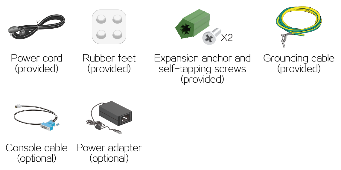

Installation accessories
EWP-WSG1808X-PWR
Figure1-1  Installation accessories
EWP-WSG1808X-PWR-JP
No power adapter is provided with the EWP-WSG1808X-PWR-JP. Purchase the EWPX100POE power adapter from H3C as required.
Figure1-2  Installation accessories

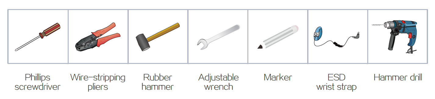

Installation tools
No installation tools are provided with the device. Prepare installation tools as required.
Figure1-3 Installation tools
