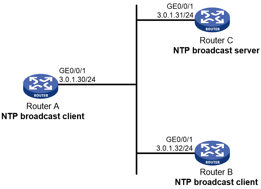

Figure 1 shows how NTP synchronizes the system time between two devices (Device A and Device B, in this example). Assume that:
·     Prior to the time synchronization, the time is set to 10:00:00 am for Device A and 11:00:00 am for Device B.
·     Device B is used as the NTP server. Device A is to be synchronized to Device B.
·     It takes 1 second for an NTP message to travel from Device A to Device B, and from Device B to Device A.
·     It takes 1 second for Device B to process the NTP message.
Figure 1 Basic work flow
The synchronization process is as follows:
1.     Device A sends Device B an NTP message, which is timestamped when it leaves Device A. The time stamp is 10:00:00 am (T1).
2.     When this NTP message arrives at Device B, Device B adds a timestamp showing the time when the message arrived at Device B. The timestamp is 11:00:01 am (T2).
3.     When the NTP message leaves Device B, Device B adds a timestamp showing the time when the message left Device B. The timestamp is 11:00:02 am (T3).
4.     When Device A receives the NTP message, the local time of Device A is 10:00:03 am (T4).
Up to now, Device A can calculate the following parameters based on the timestamps:
·     The roundtrip delay of the NTP message: Delay = (T4 – T1) – (T3 – T2) = 2 seconds.
·     Time difference between Device A and Device B: Offset = [ (T2 – T1) + (T3 – T4) ] /2 = 1 hour.
Based on these parameters, Device A can be synchronized to Device B.
This is only a rough description of the work mechanism of NTP. For more information, see the related protocols and standards.

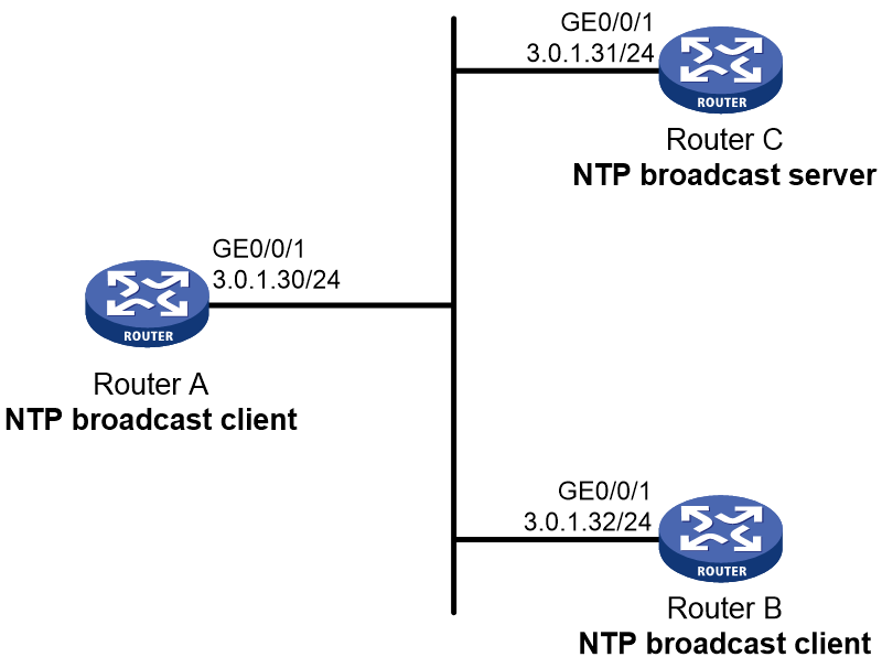

NTP uses stratums 1 to 16 to define clock accuracy, as shown in Figure 2. A lower stratum value represents higher accuracy. Clocks at stratums 1 through 15 are in synchronized state, and clocks at stratum 16 are not synchronized.
Figure 2 NTP architecture
A stratum 1 NTP server gets its time from an authoritative time source, such as an atomic clock. It provides time for other devices as the primary NTP server. A stratum 2 time server receives its time from a stratum 1 time server, and so on.
To ensure time accuracy and availability, you can specify multiple NTP servers for a device. The device selects an optimal NTP server as the clock source based on parameters such as stratum. The clock that the device selects is called the reference source. For more information about clock selection, see the related protocols and standards.
If the devices in a network cannot synchronize to an authoritative time source, you can perform the following tasks:
·     Select a device that has a relatively accurate clock from the network.
·     Use the local clock of the device as the reference clock to synchronize other devices in the network.

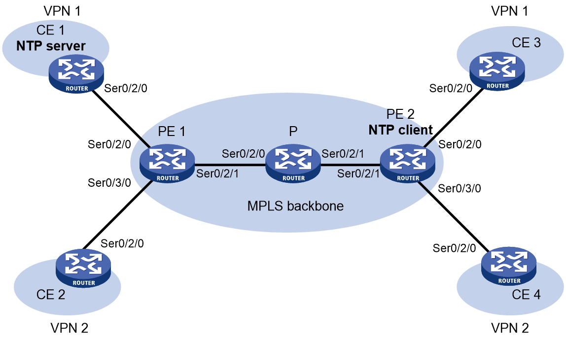

NTP for MPLS L3VPN instances
On an MPLS L3VPN network, a PE that acts as an NTP client or active peer can synchronize with the NTP server or passive peer in an MPLS L3VPN instance.
As shown in Figure 4, users in VPN 1 and VPN 2 are connected to the MPLS backbone network through provider edge (PE) devices. VPN instances vpn1 and vpn2 have been created for VPN 1 and VPN 2, respectively on the PEs. Services of the two VPN instances are isolated. Time synchronization between PEs and devices in the two VPN instances can be realized if you perform the following tasks:
·     Configure the PEs to operate in NTP client or symmetric active mode.
·     Specify the VPN instance to which the NTP server or NTP symmetric passive peer belongs.
Figure 4 Network diagram
For more information about MPLS L3VPN, VPN instance, and PE, see MPLS Configuration Guide.

Example: Configuring NTP broadcast association mode
As shown in Figure 9, Router C functions as the NTP server for multiple devices on a network segment and synchronizes the time among multiple devices.
·     Configure Router C's local clock as its reference source, with stratum level 2.
·     Configure Router C to operate in broadcast server mode and send broadcast messages from GigabitEthernet 0/0/1.
·     Configure Router B and Router A to operate in broadcast client mode and receive broadcast messages through their respective GigabitEthernet 0/0/1.
Figure 9 Network diagram
As shown in Figure 9, IP addresses are assigned to the interfaces. The devices are reachable to each other. (Details not shown.)

Example: Configuring NTP multicast association mode
As shown in Figure 10, Router C functions as the NTP server for multiple devices on different network segments and synchronizes the time among multiple devices.
·     Configure Router C to operate in multicast server mode and send multicast messages from GigabitEthernet 0/0/1.
·     Configure Router D and Router A to operate in multicast client mode and receive multicast messages through their respective GigabitEthernet 0/0/1.
Figure 10 Network diagram
As shown in Figure 10, IP addresses are assigned to the interfaces. The devices are reachable to each other. (Details not shown.)

Example: Configuring IPv6 NTP multicast association mode
As shown in Figure 11, Router C functions as the NTP server for multiple devices on different network segments and synchronizes the time among multiple devices.
·     Configure Router C to operate in IPv6 multicast server mode and send IPv6 NTP multicast messages from GigabitEthernet 0/0/1.
·     Configure Router D and Router A to operate in multicast client mode and receive IPv6 multicast messages through their respective GigabitEthernet 0/0/1.
Figure 11 Network diagram
As shown in Figure 11, IP addresses are assigned to the interfaces. The devices are reachable to each other. (Details not shown.)

As shown in Figure 13, Router C functions as the NTP server for multiple devices on different network segments and synchronizes the time among multiple devices. Router A and Router B authenticate the reference source.
·     Configure Router C's local clock as its reference source, with stratum level 3.
·     Configure Router A and Router B to operate in broadcast client mode and receive broadcast client through GigabitEthernet 0/0/1.
·     Configure NTP authentication on Router A, Router B, and Router C.
Figure 13 Network diagram
As shown in Figure 13, IP addresses are assigned to the interfaces. The devices are reachable to each other. (Details not shown.)

4.     Verify the configuration:
NTP authentication is enabled on Router A and Router B, but not enabled on Router C, so Router A and Router B cannot synchronize their local clocks to Router C.
# Verify that Router B has not synchronized to Router C.
[RouterB-GigabitEthernet0/0/1] display ntp-service status
 Clock status: unsynchronized
 Clock stratum: 16
 Reference clock ID: none

As shown in Figure 14, two MPLS L3VPN instances are present on PE 1 and PE 2: vpn1 and vpn2. CE 1 and CE 3 are devices in VPN 1.
To synchronize time between PE 2 and CE 1 in VPN 1, perform the following tasks:
·     Configure CE 1's local clock as its reference source, with stratum level 2.
·     Configure CE 1 in the VPN instance vpn1 as the NTP server of PE 2.

As shown in Figure 14, IP addresses are assigned to the interfaces. The devices are reachable to each other. (Details not shown.)
MPLS L3VPN-related configurations have been configured. For information about configuring MPLS L3VPN, see MPLS Configuration Guide.

As shown in Figure 15, two VPN instances are present on PE 1 and PE 2: vpn1 and vpn2. CE 1 and CE 3 belong to VPN 1.
To synchronize time between PE 1 and CE 1 in VPN 1, perform the following tasks:
·     Configure CE 1 in the VPN instance vpn1 as the symmetric passive peer of PE 1.

As shown in Figure 15, IP addresses are assigned to the interfaces. The devices are reachable to each other. (Details not shown.)

<DeviceA> system-view
[DeviceA] ntp-service enable
# Configure the local clock as the reference source, with stratum level 2.
[DeviceA] ntp-service refclock-master 2
# Enable NTP authentication on Device A.
[DeviceA] ntp-service authentication enable
# Configure an NTP authentication key, with the key ID of 10 and key value of aNiceKey. Input the key in plain text.
[DeviceA] ntp-service authentication-keyid 10 authentication-mode md5 simple aNiceKey
# Specify the key as a trusted key.
[DeviceA] ntp-service reliable authentication-keyid 10
2.     Configure Device B:
# Enable the SNTP service.
<DeviceB> system-view
[DeviceB] sntp enable
# Enable SNTP authentication on Device B.
[DeviceB] sntp authentication enable
# Configure an SNTP authentication key, with the key ID of 10 and key value of aNiceKey. Input the key in plain text.
[DeviceB] sntp authentication-keyid 10 authentication-mode md5 simple aNiceKey
[DeviceB] sntp reliable authentication-keyid 10
# Specify Device A as the NTP server of Device B, and associate the server with key 10.
[DeviceB] sntp unicast-server 1.0.1.11 authentication-keyid 10
# Verify that an SNTP association has been established between Device B and Device A, and Device B has synchronized to Device A.
[DeviceB] display sntp sessions
NTP server     Stratum   Version    Last receive time
1.0.1.11        2         4          Tue, May 17 2019  9:11:20.833 (Synced)
