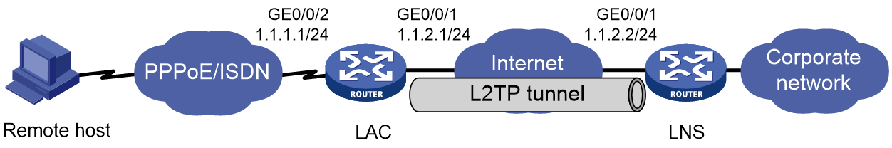

NAS-initiated tunneling mode
As shown in Figure 4, a remote system dials in to the LAC through a PPPoE/ISDN network. The LAC initiates a tunneling request to the LNS over the Internet.
Figure 4 NAS-initiated tunneling mode
A NAS-initiated tunnel has the following characteristics:
·     The remote system only needs to support PPP, and it does not need to support L2TP.
·     Authentication and accounting of the remote system can be implemented on the LAC or LNS.

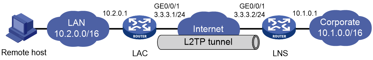

LAC-auto-initiated tunneling mode
In NAS-initiated mode, a remote system must successfully dial in to the LAC through PPPoE or ISDN.
In LAC-auto-initiated mode, you can use the l2tp-auto-client command on the LAC to trigger the LAC to initiate a tunneling request to the LNS. When a remote system accesses the private network, the LAC forwards data through the L2TP tunnel.
Figure 8 LAC-auto-initiated tunneling mode
An LAC-auto-initiated tunnel has the following characteristics:
·     The connection between a remote system and the LAC is not confined to a dial-up connection and can be any IP-based connection.
·     An L2TP session is established immediately after an L2TP tunnel is established. Then, the LAC and LNS, acting as the PPPoE client and PPPoE server, respectively, perform PPP negotiation.
·     The LNS assigns a private IP address to the LAC instead of to the remote system.

Example: Configuring a NAS-initiated L2TP tunnel
As shown in Figure 11, a PPP user is connected to an LNS through an LAC.
Set up an L2TP tunnel between the LAC and LNS to allow the PPP user to access the corporate network.
Figure 11 Network diagram
1.     Configure the LAC:
# Configure IP addresses for the interfaces. (Details not shown.)
# Create a local user named vpdnuser, set the password, and enable the PPP service.

Example: Configuring a client-initiated L2TP tunnel
As shown in Figure 12, a PPP user directly initiates a tunneling request to the LNS to access the corporate network.
Figure 12 Network diagram
1.     Configure the LNS:

Example: Configuring an LAC-auto-initiated L2TP tunnel
As shown in Figure 13, configure the LAC to establish an L2TP tunnel with the LNS in LAC-auto-initiated mode. When the PPP user initiates a connection, it uses the established tunnel to access the corporate network.
Figure 13 Network diagram
