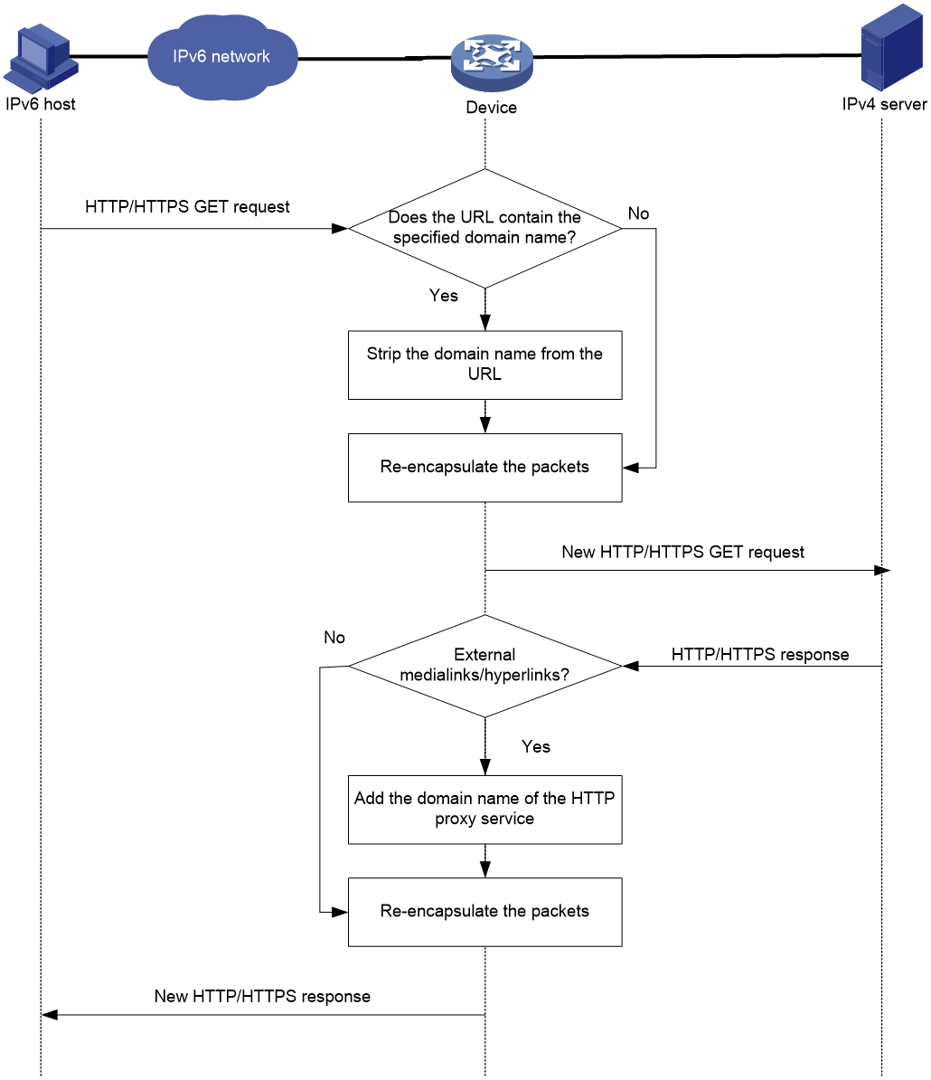

Working mechanism
Figure 1 shows the working mechanism.
Figure 1 HTTP proxy mechanism
1.     The IPv6 host obtains the IPv6 address corresponding to the requested domain name (the IPv6 address of the HTTP proxy service configured on the device) through the DNS server. The IPv6 host sends an HTTP or HTTPS GET request to the device.
2.     The device checks whether the URL of the request contains the domain name of the HTTP proxy service:
¡     If yes, the device strips the domain name from the URL and restores the URL of the request to the original URL.
¡     If not, the device re-encapsulates the HTTP or HTTPS GET request.
3.     The device sends the request to the IPv4 Web server. If the IPv4 Web server is an external Web server, a DNS server is required on the device to resolve URL of the IPv4 Web server to an IPv4 address.
4.     The IPv4 Web server sends an HTTP or HTTPS response to the device. The devices checks whether the response contains external media links or hyperlinks:
¡     If yes, the device adds the domain name of the HTTP proxy service to the URL of the response. In this way, the IPv6 host can send the HTTP or HTTPS request to the device when it accesses the IPv4 Web server again.
¡     If not, the device re-encapsulates the HTTP or HTTPS response.
5.     The device sends the HTTP or HTTPS response to the IPv6 host.

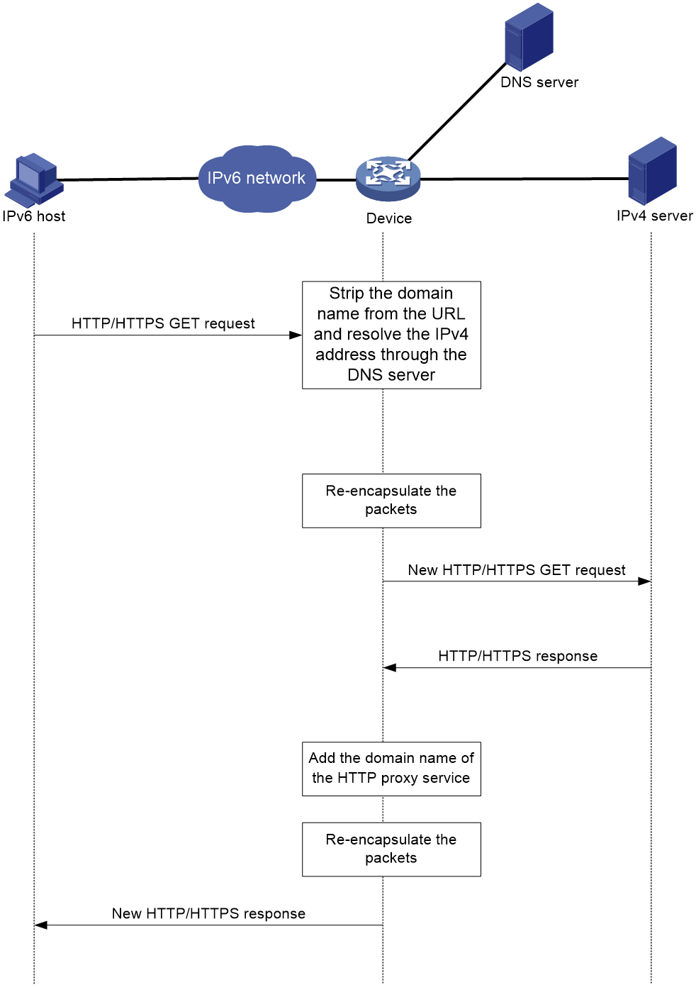

External link proxy
Figure 2 shows the mechanism of external link proxy when an IPv6 user accesses external media links or hyperlinks on webpages of the IPv4 Web server.
Figure 2 External link proxy mechanism
1.     When the device receives an HTTP or HTTPS response from the IPv4 Web server, it adds the domain name specified for the HTTP proxy service to the URL of the response.
2.     When the IPv6 user accesses the IPv4 Web server again, the DNS server resolves domain name contained in the URL of the Web request to the IPv6 address of the HTTP proxy service. The IPv6 user sends an HTTP or HTTPS GET request for accessing an external link to the device.
3.     Upon receiving the GET request, the device strips the domain name from the URL of the request.
4.     The device resolves the domain name to the IPv4 address of the GET request.
5.     The device re-encapsulates the GET request and sends it to the external IPv4 Web server.
6.     The external IPv4 Web server sends the HTTP or HTTPS response to the device.
7.     The device re-encapsulates the response and sends it the IPv6 host.

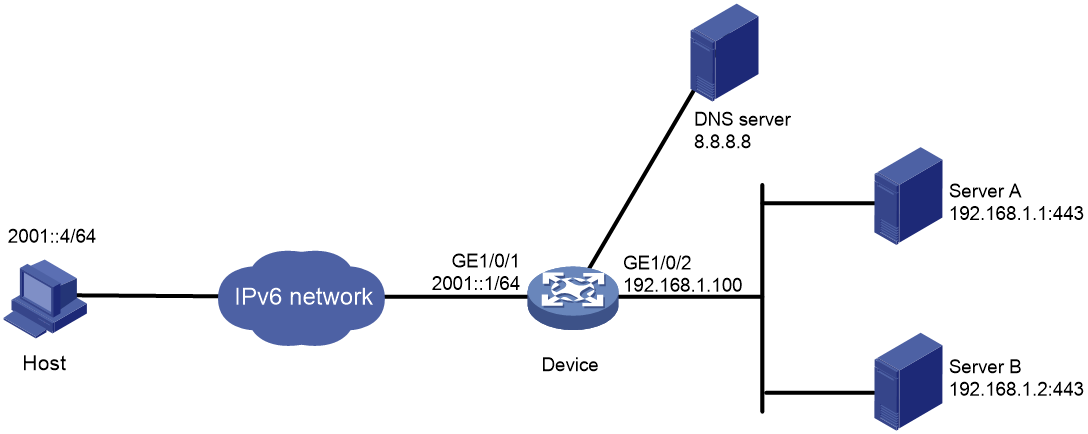

Load balancing of Web access
You can add multiple IPv4 Web servers to a Web server group for the HTTP proxy service. When the device receives HTTP or HTTPS requests, it distributes the traffic to different Web servers according to a certain algorithm, implementing load balancing. This increases network bandwidth and improves network availability and flexibility.

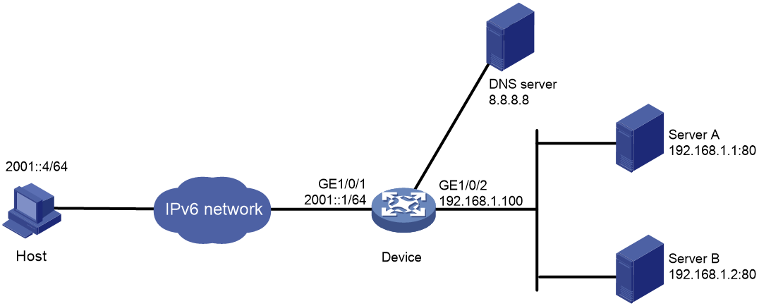

As shown in Figure 3, configure HTTP proxy on the device to proxy HTTP requests for the IPv6 host, so that the IPv6 host can access the IPv4 Web servers.
·     Specify domain name test.gov.cn for the HTTP proxy service and specify 2001::1/64 as the IPv6 address of the HTTP proxy service.
·     Add external hyperlink www.hyperlink.org to be proxied by the HTTP proxy service and enable the external media link proxy feature.
·     Specify the DNS server with IP address 8.8.8.8 for the HTTP proxy service.
·     Enable the HTTP proxy operation recording.
Figure 3 Network diagram
Assign IP addresses and subnet mask to interfaces. (Details not shown.)
Make sure the domain name test.gov.cn of the HTTP proxy service can be resolved into IPv6 address 2001::1/64.

Example: Configuring HTTPS-based HTTP proxy
As shown in Figure 3, configure HTTP proxy on the device to proxy HTTPS requests for the IPv6 host, so that the IPv6 host can access the IPv4 Web servers.
Figure 4 Network diagram

HTTP proxy configuration examples (in IRF mode)
Example: Configuring HTTP-based HTTP proxy
Figure 5 Network diagram
