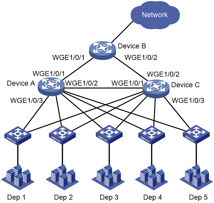

As shown in Figure 1, Device A, Device B, and Device C run MSTP. Device B acts as the root bridge, and Twenty-FiveGigE 1/0/1 on Device C is blocked.
Configure the following features to prevent link layer attacks:
·     Configure root guard on Twenty-FiveGigE 1/0/1 and Twenty-FiveGigE 1/0/2 of Device B for Device B to act as the root bridge.
·     Configure loop guard on Twenty-FiveGigE 1/0/2 of Device C to prevent temporary loops. The loop guard feature keeps the port in Discarding state in all MSTIs when it receives no BPDU.
·     Configure BPDU guard on ports at the access side of Device A and Device C. The BPDU guard feature prevents the ports from performing spanning tree calculations when it receives forged BPDUs with a higher priority.
·     Enable TC-BPDU guard on Device A, Device B, and Device C. The TC-BPDU guard feature prevents a large number of TC-BPDUs from affecting the network in a short time.
·     Set the maximum number of MAC addresses that can be learned by ports at the access side of Device A and Device C. This configuration protects the devices from a large number of attack packets that have different source MAC addresses. The attack packets might cause a large MAC table and low forwarding performance.
·     Configure broadcast and multicast suppression on the designated ports of Device B and all ports on Device A and Device C. When incoming broadcast or multicast traffic exceeds the threshold (6400 pps), an interface discards broadcast or multicast packets until the traffic drops below the threshold.
Figure 1 Network diagram
Analysis
For the ports at the access side of Device A and Device C to rapidly transit to the forwarding state, use the stp edged-port command to configure these ports as edge ports.
This example uses Twenty-FiveGigE 1/0/3 to illustrate the configuration on the ports at the access side on Device A and Device C.

When you configure link layer attack protection, follow these restrictions and guidelines:
·     On a port, the loop guard feature is mutually exclusive with the root guard feature or the edge port setting.
·     Do not configure the loop guard feature on ports at the access side. Otherwise, the ports stay in Discarding state in all MSTIs because they cannot receive BPDUs.
Procedures
Configuring Device B
# Specify IP addresses for interfaces. (Details not shown.)
# Configure root guard on Twenty-FiveGigE 1/0/1 and Twenty-FiveGigE 1/0/2.
<DeviceB> system-view
[DeviceB] interface range twenty-fivegige 1/0/1 to twenty-fivegige 1/0/2
[DeviceB-if-range] stp root-protection
[DeviceB-if-range] quit
# Configure TC-BPDU guard.
[DeviceB] stp tc-protection
[DeviceB] stp tc-protection threshold 10
# Configure broadcast and multicast suppression on Twenty-FiveGigE 1/0/1 and Twenty-FiveGigE 1/0/2.
[DeviceB-if-range] broadcast-suppression pps 6400
[DeviceB-if-range] multicast-suppression pps 6400
Configuring Device A
# Configure STP BPDU guard.
<DeviceA> system-view
[DeviceA] stp bpdu-protection
# Configure Twenty-FiveGigE 1/0/3 as an edge port.
[DeviceA] interface twenty-fivegige 1/0/3
[DeviceA-Twenty-FiveGigE1/0/3] stp edged-port
[DeviceA-Twenty-FiveGigE1/0/3] quit
[DeviceA] stp tc-protection
[DeviceA] stp tc-protection threshold 10
# Set the maximum number of MAC addresses that Twenty-FiveGigE 1/0/3 can learn.
[DeviceA-Twenty-FiveGigE1/0/3] mac-address max-mac-count 1024
# Configure broadcast and multicast suppression on all ports.
[DeviceA] interface range twenty-fivegige 1/0/1 to twenty-fivegige 1/0/3
[DeviceA-if-range] broadcast-suppression pps 6400
[DeviceA-if-range] multicast-suppression pps 6400
[DeviceA-if-range] quit
Configuring Device C
<DeviceC> system-view
[DeviceC] stp bpdu-protection
[DeviceC] interface twenty-fivegige 1/0/3
[DeviceC-Twenty-FiveGigE1/0/3] stp edged-port
[DeviceC-Twenty-FiveGigE1/0/3] quit
# Configure loop guard on Twenty-FiveGigE 1/0/2.
[DeviceC] interface twenty-fivegige 1/0/2
[DeviceC-Twenty-FiveGigE1/0/2] stp loop-protection
[DeviceC-Twenty-FiveGigE1/0/2] quit
[DeviceC] stp tc-protection
[DeviceC] stp tc-protection threshold 10
[DeviceC-Twenty-FiveGigE1/0/3] mac-address max-mac-count 1024
[DeviceC] interface range twenty-fivegige 1/0/1 to twenty-fivegige 1/0/3
[DeviceC-if-range] broadcast-suppression pps 6400
[DeviceC-if-range] multicast-suppression pps 6400
[DeviceC-if-range] quit
# Verify that the edge ports go down after they receives STP BPDUs. (Details not shown.)
# Bring the edge ports up by using the undo shutdown command. (Details not shown.)
# Verify that the root bridge ID of Device B does not change and that the STP topology remains stable after STP BPDUs with higher priority are sent to Device B. (Details not shown.)
# Verify that the devices do not refresh the FIB table frequently and that no serious packet loss occurs after a large number of TC BPDUs are sent to the devices. (Details not shown.)
# Verify that the uplink ports are not flooded after a large number of broadcasts are sent to the edge ports on Device A and Device C. (Details not shown.)

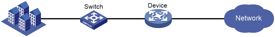

Example: Configuring ARP attack protection
As shown in Figure 2, the device is the gateway for the internal network. Configure ARP attack protection on the device to prevent ARP attacks.
Figure 2 Network diagram

Procedures
# Enable ARP source suppression.
<Device> system-view
[Device] arp source-suppression enable
# Configure the device to accept a maximum of 8 unresolvable packets per source IP address in 5 seconds.
[Device] arp source-suppression limit 8
# Enable ARP black hole routing to prevent unresolvable IP packet attacks.
[Device] arp resolving-route enable
# Enable ARP active acknowledgment to prevent user spoofing.
[Device] arp active-ack enable
# Configure source MAC-based ARP attack detection to prevent ARP packet attacks from the same source MAC.
[Device] arp source-mac filter
[Device] arp source-mac threshold 25
# Enable ARP packet source MAC address consistency check to prevent attacks from ARP packets with different source MAC addresses in the Ethernet header and in the message body.
[Device] arp valid-check enable
1.     Verify that ARP attack protection functions on the device:
# Send ARP attack packets to the device. (Details not shown.)
# Verify that the CPU usage does not surge. (Details not shown.)
2.     Verify that each ARP attack protection feature functions on the device (this example uses the ARP source suppression feature):
# Send the device 20 forged packets with the same source IP address and unresolvable destination IP addresses. (Details not shown.)
# Verify that the device stops resolving the packets after receiving 8 forged packets within 5 seconds. (Details not shown.)
# Verify the ARP source suppression configuration.
[Device] display arp source-suppression
 ARP source suppression is enabled
 Current suppression limit: 8
 Current cache length: 16

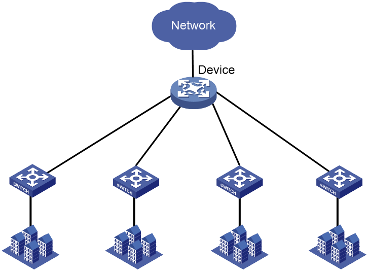

Example: Configuring network layer attack protection
As shown in Figure 3, Device A is the gateway for the internal network. To protect Device A against IP packet attacks from internal and external networks, configure the following network layer attack protection features:
·     Configure strict uRPF check to prevent source address spoofing attacks.
·     Disabling sending ICMP time exceeded messages. The device will not be flooded by ICMP time exceeded messages when receiving a large number of packets with TTL set to 1.
Figure 3 Network diagram

As shown in Figure 4, the device is the gateway for the internal network. Configure SYN Cookie protection on the device to protect against SYN flood attacks. With this feature enabled, the device responds to a SYN packet with a SYN ACK packet without establishing a TCP semi-connection. The device establishes a TCP connection only when it receives an ACK packet from the sender.
Figure 4 Network diagram
Hardware
Software version
S6550X-HI switch series
Release 1116 and later, Release 1213P51 and later
S6880 switch series
S9820-8M switch
S5580X-HI switch series
Release 1213P50 and later
S5580X-EI switch series
S5580S-EI switch series
Procedures
# Enable SYN Cookie.
[Device] tcp syn-cookie enable
# Verify that the device does not have any TCP semi-connections. The state "SYN_RECEIVED" represents semi-connections.
[Device] display tcp
 *: TCP connection with authentication
 Local Addr:port       Foreign Addr:port     State       Slot  PCB
 0.0.0.0:21            0.0.0.0:0             LISTEN      1     0xffffffffffffff9
d
 0.0.0.0:23            0.0.0.0:0             LISTEN      1     0xffffffffffffff9
f
 192.168.2.88:23       192.168.2.79:2197     ESTABLISHED 1     0xffffffffffffffa
3
 192.168.2.88:23       192.168.2.89:2710     ESTABLISHED 1     0xffffffffffffffa
2
 192.168.2.88:23       192.168.2.110:50199   ESTABLISHED 1     0xffffffffffffffa
5
Configuration files
