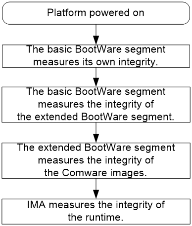

·     Trusted startup—TC measures the integrity of software during device startup, and saves the integrity measurements to integrity measurement logs (IMLs).

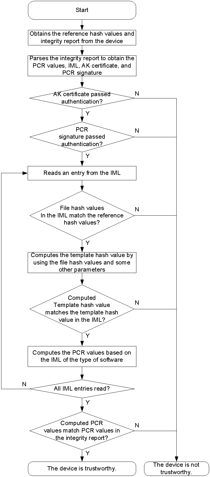

For more information about IMLs, integrity self-verification, and integrity authentication, see "Configuring PTS."

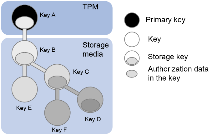

Primary key, storage key, and child key
As shown in Figure 2, TCSM keys are managed in a tree structure. The following are the roles of TCSM keys:
·     Primary keyRoot key. Its key parameters are stored on a TC chip and protected by the chip. This key will be automatically created by using the parameters when you load the key to the TC chip.
·     Storage key—Key that has authorization data. A storage key can have child keys.
In Figure 2, keys A through D are all storage keys. Key A is the primary key.
·     Child key—A child key is encrypted and stored on a storage medium. You can load it to the TC chip when necessary.
In Figure 2, a parent key and its child keys are in the same color.
Figure 2 TCSM key hierarchy

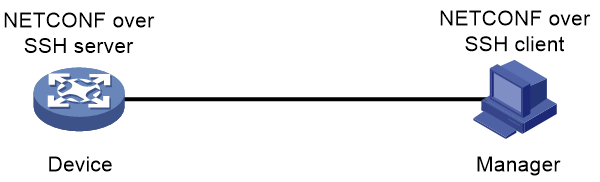

Example: Requesting a certificate from the manager
As shown in Figure 3, the device is integrated with TC chips and connected to a TC manager.
Configure the device as the NETCONF over SSH server so the TC manager can manage the device.
Create an AK for the device and obtain an AK certificate from the manager so the manager can authenticate the integrity of the device.
Figure 3 Network diagram
1.     Assign IP addresses to the device and manager. Make sure a network connection is available. (Details not shown.)

Figure 4 depicts the integrity measurement operations that occur on types of software during platform startup.
Figure 4 Integrity measurement process during platform startup
During integrity measurement of a type of software, the following operations are performed for each program file:
1.     Computes the hash value of the file.
2.     Computes the template hash value based on the file hash value, measurement time, and hash algorithm.
3.     Writes the two hash values to the IML.
The TC chip of a platform also extends the template hash value of each type of software to the corresponding PCR.

Integrity authentication
As shown in Figure 5, a manager authenticates the integrity of a platform by using the integrity measurement reference hash values and integrity report of the platform.
Compared with integrity self-verification, integrity authentication includes the following extra authentication items:
·     Examines the AK certificate of the platform to authenticate the identity of the platform.
·     Uses the AK certificate of the platform to authenticate the PCR signature, and thereby determines the authenticity of the PCR values of the platform.
Figure 5 Integrity authentication process
