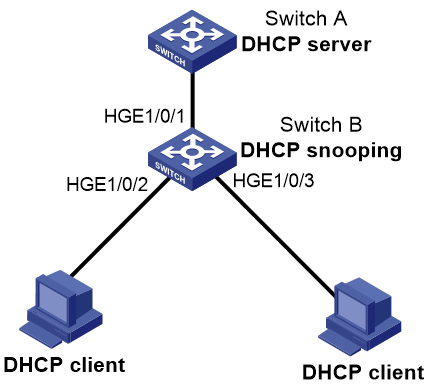

Application of trusted and untrusted ports
Configure ports facing the DHCP server as trusted ports, and configure other ports as untrusted ports.
As shown in Figure 1, configure the DHCP snooping device's port that is connected to the DHCP server as a trusted port. The trusted port forwards response messages from the DHCP server to the client. The untrusted port connected to the unauthorized DHCP server discards incoming DHCP response messages.
Figure 1 Trusted and untrusted ports
In a cascaded network as shown in Figure 2, configure the DHCP snooping devices' ports facing the DHCP server as trusted ports. To save system resources, you can enable only the untrusted ports directly connected to the DHCP clients to record DHCP snooping entries.
Figure 2 Trusted and untrusted ports in a cascaded network

DHCP snooping configuration examples
Example: Configuring basic DHCP snooping features globally
As shown in Figure 3, Switch B is connected to the authorized DHCP server through HundredGigE 1/0/1, to the unauthorized DHCP server through HundredGigE 1/0/3, and to the DHCP client through HundredGigE 1/0/2.
Configure only the port connected to the authorized DHCP server to forward the responses from the DHCP server. Enable the DHCP snooping device to record clients' IP-to-MAC bindings by reading DHCP-ACK messages received from the trusted port and the DHCP-REQUEST messages.
Figure 3 Network diagram

Example: Configuring basic DHCP snooping features for a VLAN
As shown in Figure 4, Switch B is connected to the authorized DHCP server through HundredGigE 1/0/1, to the unauthorized DHCP server through HundredGigE 1/0/3, and to the DHCP client through HundredGigE 1/0/2.
Configure only the port in VLAN 100 connected to the authorized DHCP server to forward the responses from the DHCP server. Enable the port in VLAN 100 to record clients' IP-to-MAC bindings by reading DHCP-ACK messages received from the trusted port and the DHCP-REQUEST messages.
Figure 4 Network diagram

Example: Configuring DHCP snooping support for Option 82
As shown in Figure 5, enable DHCP snooping and configure Option 82 on Switch B as follows:
·     Configure the handling strategy for DHCP requests that contain Option 82 as replace.
·     On HundredGigE 1/0/2, configure the padding content for the Circuit ID sub-option as company001 and for the Remote ID sub-option as device001.
·     On HundredGigE 1/0/3, configure the padding mode for the Circuit ID sub-option as verbose, access node identifier as sysname, and padding format as ascii. Configure the padding content for the Remote ID sub-option as device001.
Figure 5 Network diagram
