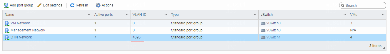

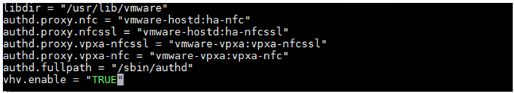

When the DTN host is deployed on a VM, you must enable the nested virtualization feature. For more information, see “When I deploy a DTN host on a VM, how can I enable the nested virtualization feature for VMware and the DTN host?.”

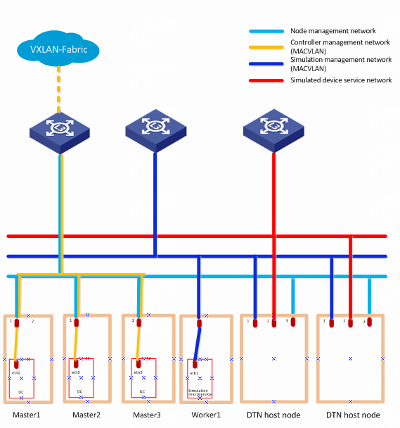

Plan the network
Plan network topology

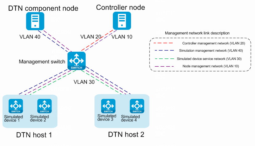

A simulation network includes four types of networks, including node management network, controller management network, simulation management network, and simulated device service network.
·     Node management networkNetwork over which you can log in to servers to perform routine maintenance.
·     Controller management networkNetwork for cluster communication between controllers and device management.
·     Simulation management networkNetwork over which the digital twin network (DTN) microservice component and DTN hosts exchange management information.
·     Simulated device service networkNetwork over which the DTN hosts exchange service data.
Before you deploy the simulation system, plan the simulation management network and simulated device service network.
Figure 1 Typical simulation network topology design for the Cloud DC scenario in non-remote disaster recovery mode
CAUTION
CAUTION:
·     If the controller management network and simulation management network use the same management switch, configure VLANs for isolation on the management switch to isolate the simulation network from the production network. If the controller management network uses the Layer 3 networking mode, you must also configure VPN instances for isolation on the management switch to prevent IP address conflicts from affecting the services. If the controller management network and simulation management network use different management switches, physically isolate these switches. For information about Layer 3 network configuration, see "Configure the management networks."
·     Configure routes to provide Layer 3 connectivity between simulation management IPs and simulated device management IPs.
·     On the port connecting the switch to the service interface of a DTN host, execute the port link-type trunk command to configure the link type of the port as trunk, and execute the port trunk permit vlan vlan-id-list command to assign the port to 150 contiguous VLAN IDs. Among these VLAN IDs, the start ID is the VLAN ID specified when installing the DTN host, and the end VLAN ID is the start VLAN ID+149. For example, if the start VLAN ID is 11, the permitted VLAN ID range is 11 to 160. When you plan the network, do not use any VLAN ID permitted by the port.

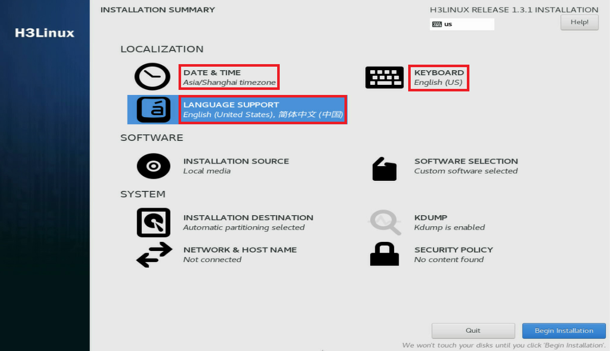

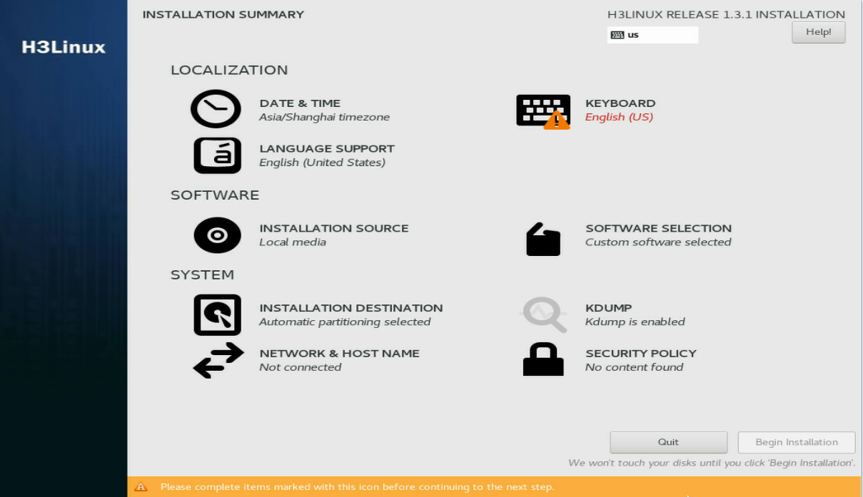

After the ISO image is loaded, the INSTALLATION SUMMARY page opens.
Figure 2 INSTALLATION SUMMARY page

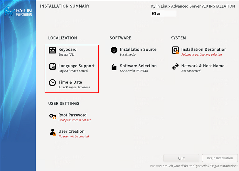

4.     In the LOCALIZATION area, perform the following steps:
¡     Click DATE & TIME to modify the date and time settings.
¡     Click KEYBOARD to modify keyboard settings as needed.
¡     Click LANGUAGE SUPPORT to select your preferred language.
IMPORTANT
IMPORTANT:
Make sure you select the same time zone across the hosts. In this document, [Asia/Shanghai] is selected for example.
Figure 3 INSTALLATION SUMMARY page

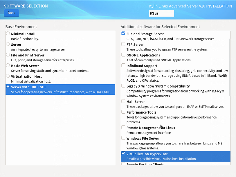

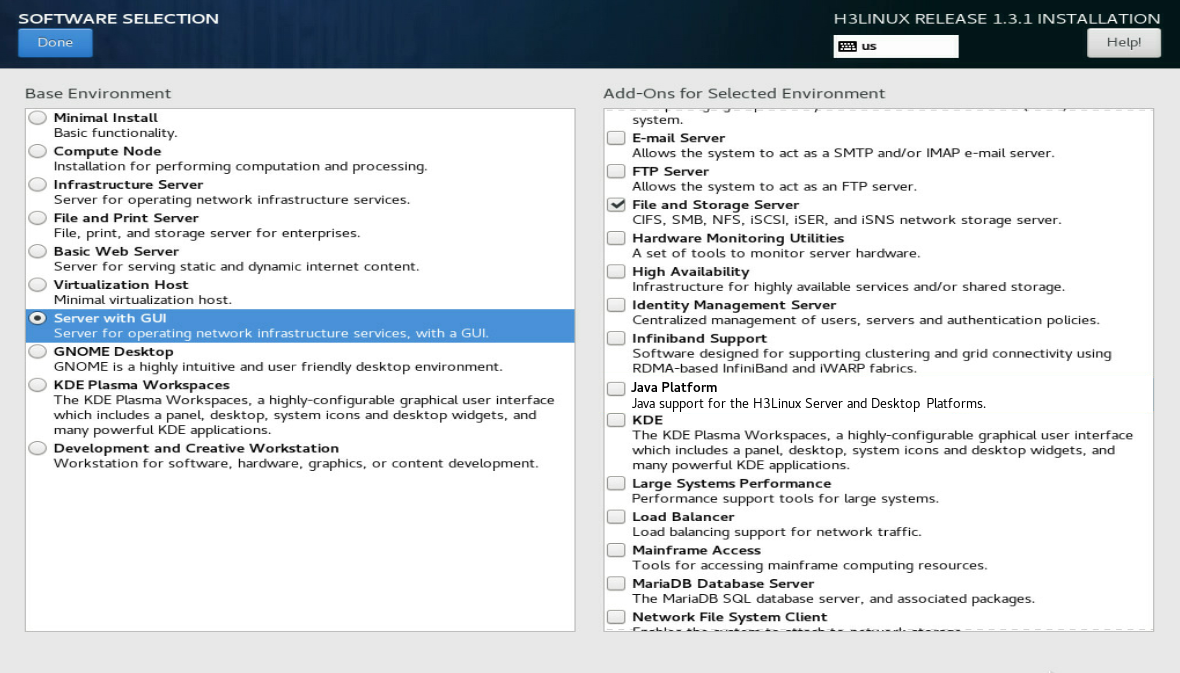

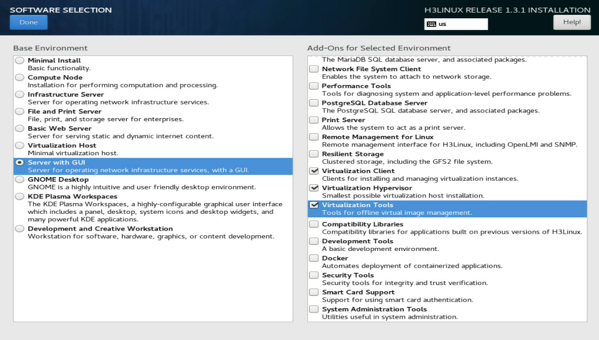

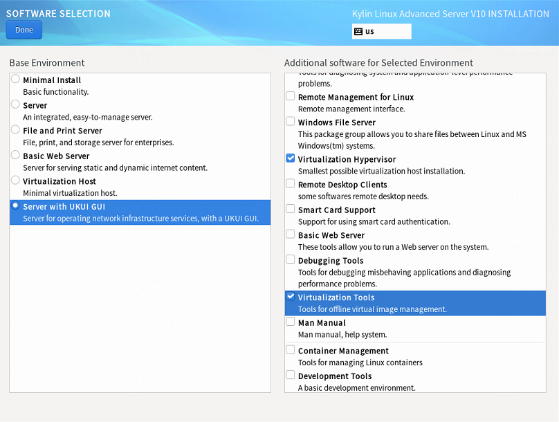

5.     Click SOFTWARE SELECTION in the SOFTWARE area to enter the page for selecting software. Select the Server with GUI base environment and the File and Storage Server, Virtualization Client, Virtualization Hypervisor, and Virtualization Tools add-ons. Then, click Done to return to the INSTALLATION SUMMARY page.
Figure 4 SOFTWARE SELECTION page (1)
Figure 5 SOFTWARE SELECTION page (2)

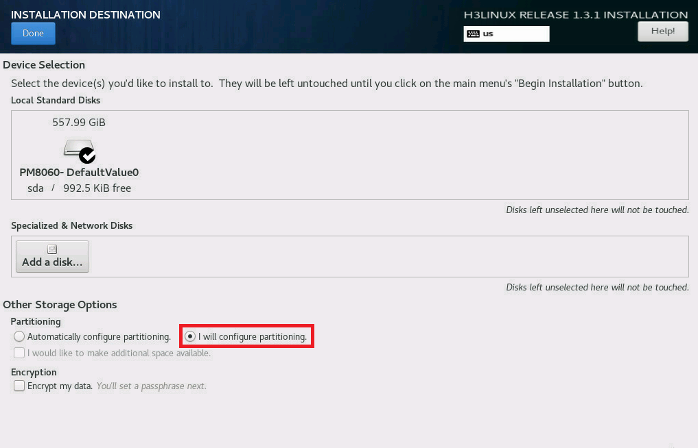

6.     In the SYSTEM area, click INSTALLATION DESTINATION.
Figure 6 INSTALLATION DESTINATION dialog box
7.     In the dialog box that opens, perform the following operations:
a.     Select a local disk from the Local Standard Disks area.
b.     In the Other Storage Options area, select I will configure partitioning.
c.     Click Done.

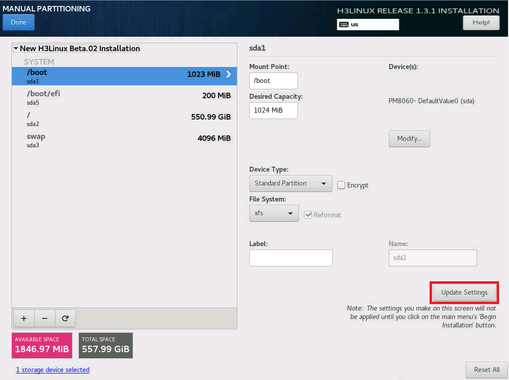

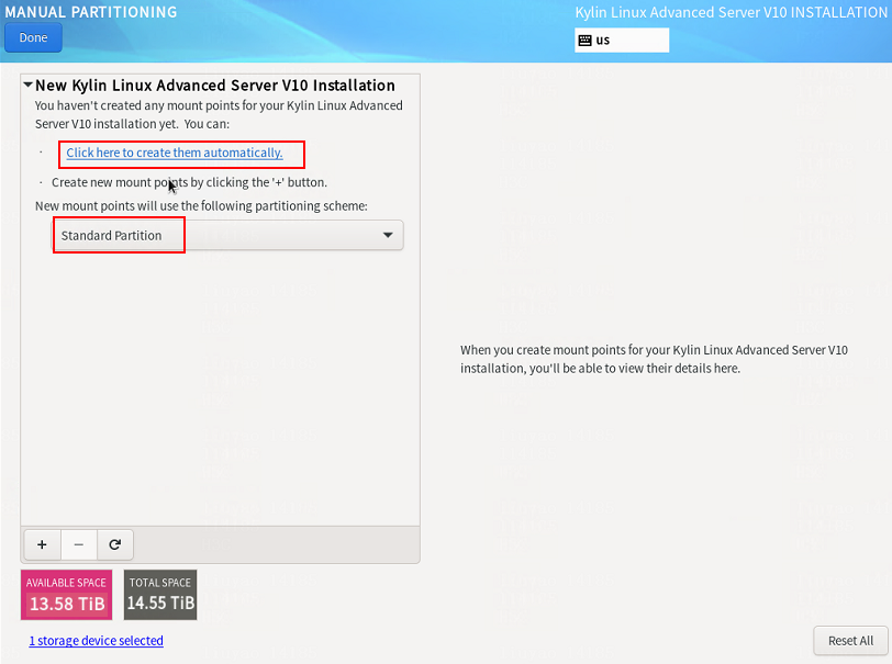

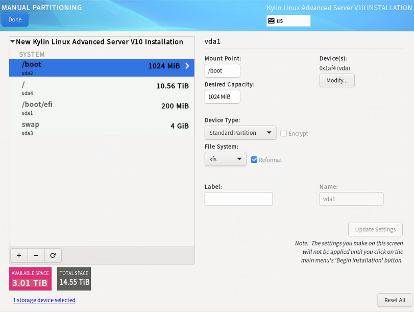

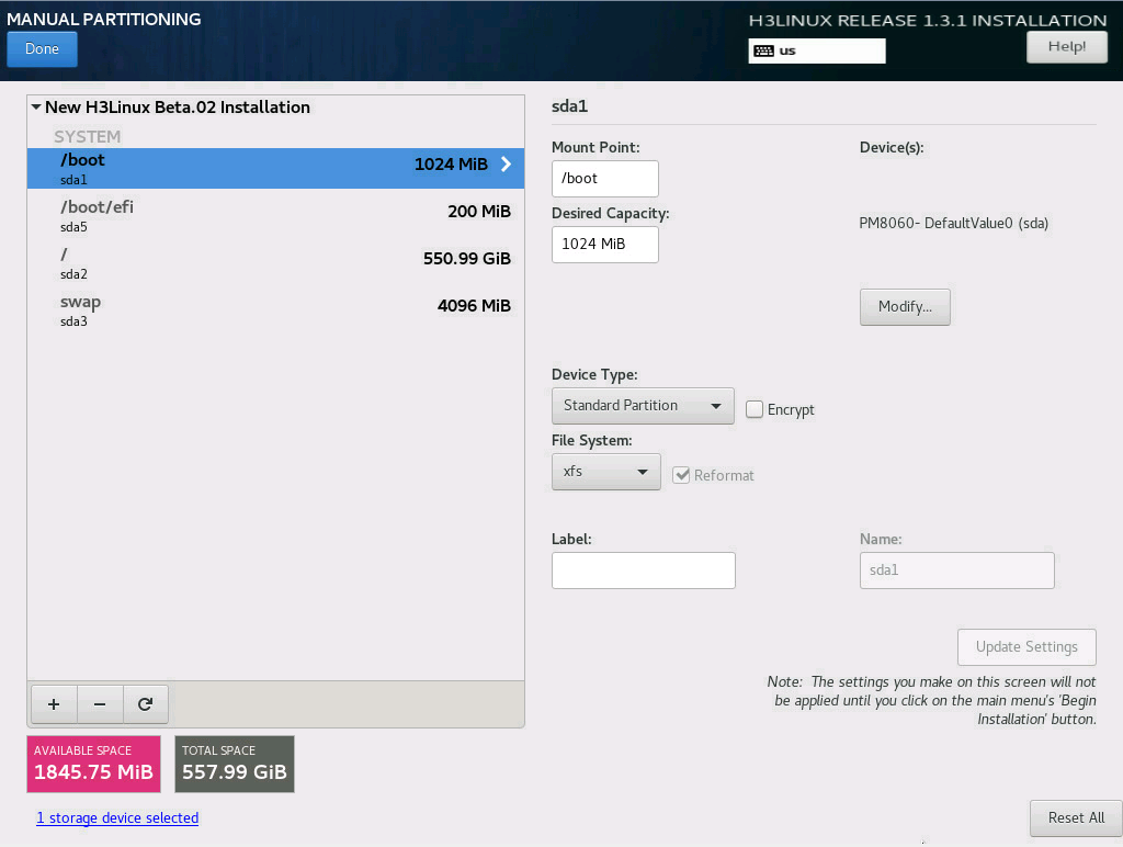

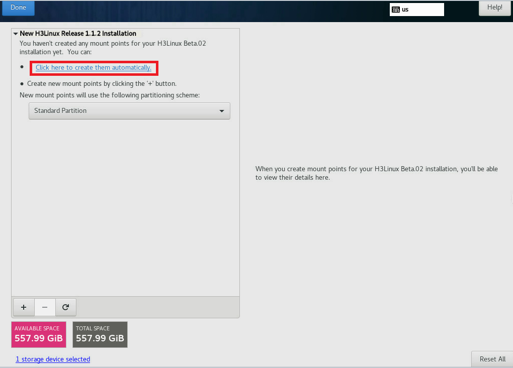

8.     In the MANUAL PARTITIONING dialog box, click Click here to create them automatically to automatically generate recommended partitions.
Figure 7 MANUAL PARTITIONING dialog box
The list of automatically created partitions opens. Figure 8 shows the list of automatically created partitions when the disk size is 600 GiB.
IMPORTANT
IMPORTANT:
The /boot/efi partition is available only if UEFI mode is enabled for OS installation.
Figure 8 Automatically created partition list

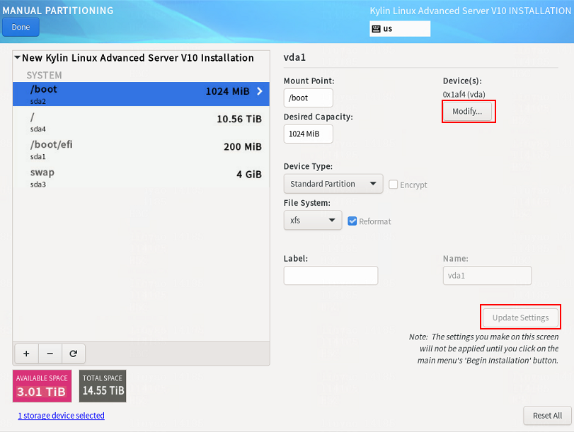

9.     Set the device type and file system of a partition. As a best practice, set the device type to Standard Partition to improve system stability. Table 5 shows the device type and file system of each partition used in this document.
Table 5 Partition settings
Partition name
Device type
File system
/boot
Standard Partition
xfs
/boot/efi (UEFI mode)
Standard Partition
EFI System Partition
Standard Partition
xfs
/swap
Standard Partition
swap
10.     Edit the device type and file system of a partition as shown in Table 6. Take the /boot partition for example. Select a partition on the left, and select Standard Partition from the Device Type list and xfs from the File System list. Then, click Update Settings.
Table 6 Configuring partitions

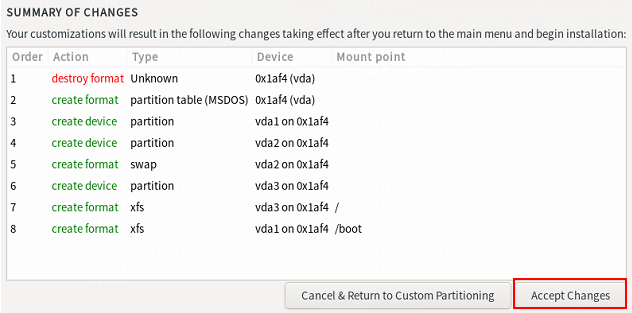

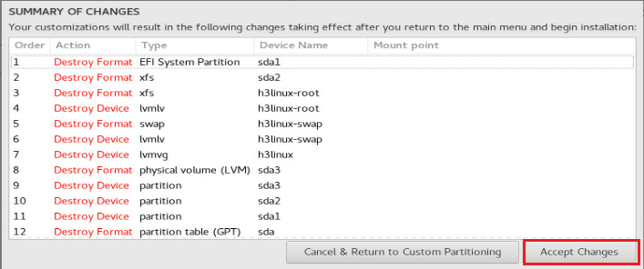

11.     After you finish the partitioning task, click Done in the upper left corner. In the dialog box that opens, select Accept Changes.
Figure 9 Accepting changes

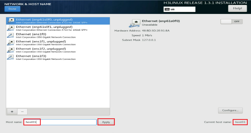

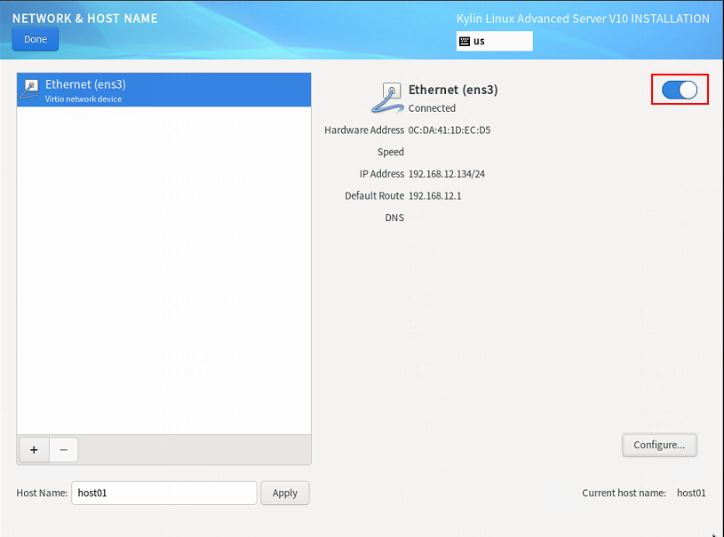

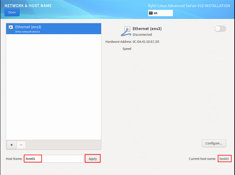

12.     In the INSTALLATION SUMMARY window that opens, click NETWORK & HOSTNAME in the SYSTEM area to configure the host name and network settings.
13.     In the Host name field, enter the host name (for example, host01) for this server, and then click Apply.
Figure 10 Setting the host name

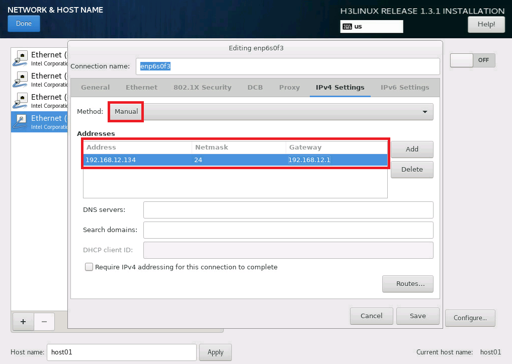

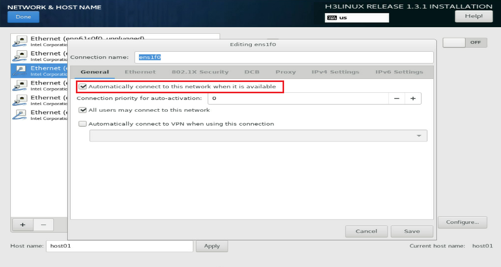

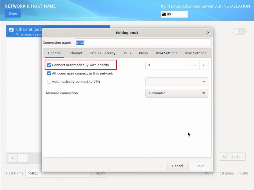

14.     Configure the network settings:
IMPORTANT
IMPORTANT:
Configure network ports as planned. The server requires a minimum of three network ports.
·     The network port IP for the simulation management network is used for communication with the DTN component.
·     The network port IP for the simulated device service network is used for service communication between simulated devices. Specify this IP address in the installation script in “Deploy the DTN host”, and you do not need to specify this IP address in this section.
·     The network port IP for the node management network is used for routine maintenance of servers.
a.     Select a network port and then click Configure.
b.     In the dialog box that opens, configure basic network port settings on the General tab:
-     Select the Automatically connect to this network when it is available option .
-     Verify that the All users may connect to this network option is selected. By default, this option is selected.
Figure 11 General settings for a network port

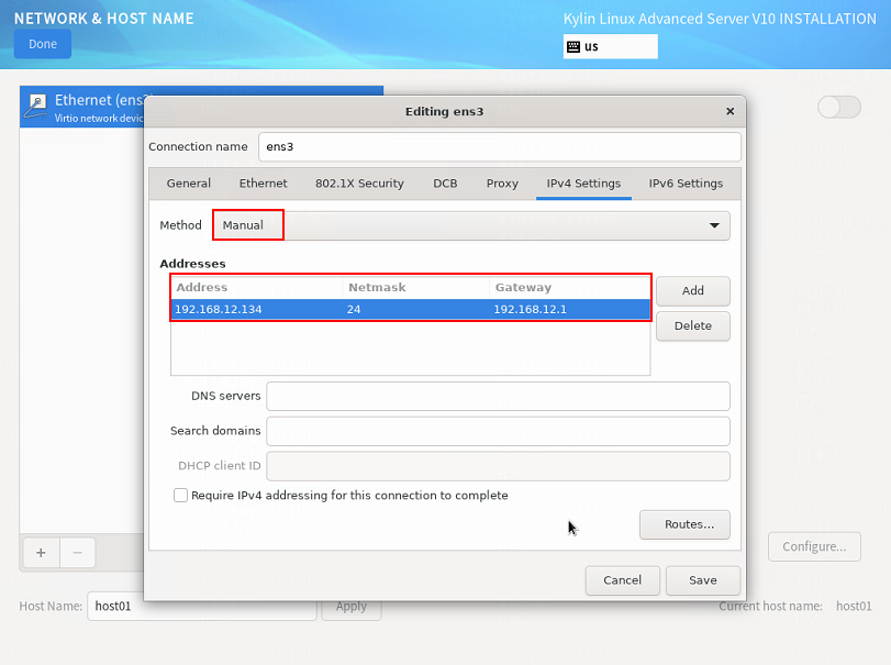

15.     Configure IP address settings:
a.     Click the IPv4 Settings or IPv6 Settings tab.
b.     From the Method list, select Manual.
c.     Click Add, assign a simulation management IP address to the DTN host, and then click Save.
d.     Click Done in the upper left corner of the dialog box.
IMPORTANT
IMPORTANT:
DTN service supports IPv4 and IPv6. In the current software version, only a single stack is supported.
Figure 12 Configuring IPv4 address settings for a network port
16.     Repeat Step 14 and Step 15 to configure the management IP addresses for other DTN hosts. The IP addresses must be in the network address pool containing IP addresses 192.168.10.110 to 192.168.10.120, for example, 192.168.10.110.

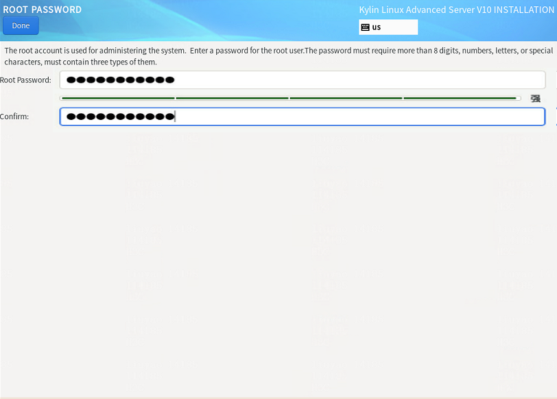

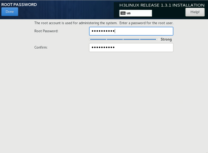

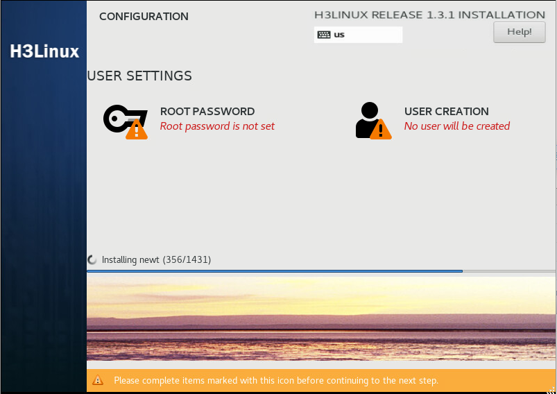

18.     During the installation, configure the root password as prompted:
IMPORTANT
IMPORTANT:
You must configure a root password before you can continue with the installation.
a.     In the USER SETTINGS area, click ROOT PASSWORD.
b.     In the dialog box that opens, set the root password for the system, and then click Done in the upper left corner.
Figure 13 Configuration window for H3Linux OS installation
Figure 14 Setting the root password
Then, the system automatically reboots to finish OS installation.

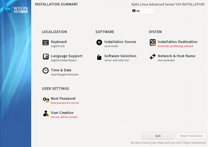

Kylin V10SP02 operating system
Installing the Kylin V10SP02 operating system
IMPORTANT
IMPORTANT:
Before you install the Kylin V10SP02 operating system on a server, back up server data. Kylin will replace the original OS (if any) on the server with data removed.

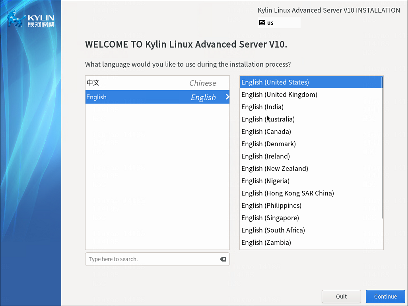

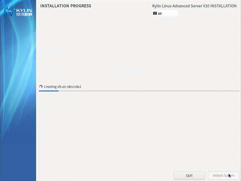

The Kylin operating system installation package is named in the Kylin-Server-version.iso (where version is the version number) format. The following information uses a server without an OS installed as an example to describe the installation procedure for the Kylin V10SP02 operating system.
1.     Obtain the required version of the Kylin-Server-version.iso image.
2.     Access the remote console of the server, and then mount the ISO image on a virtual optical drive.
3.     Configure the server to boot from the virtual optical drive, and then restart the sever.
4.     After the ISO image is loaded, select a language used during the installation process.
English is selected in this example.
Figure 15 Selecting a language used during the installation process
5.     The INSTALLATION SUMMARY page opens.
Figure 16 INSTALLATION SUMMARY page
6.     In the LOCALIZATION area, perform the following tasks:
¡     Click KEYBOARD to select the keyboard layout.
¡     Click TIME & DATE to set the system date and time. Make sure you configure the same time zone for all hosts. The Asia/Shanghai timezone is specified in this example.
Figure 17 INSTALLATION SUMMARY page
7.     Click SOFTWARE SELECTION in the SOFTWARE area to enter the page for selecting software. Select the Server with UKUI GUI base environment and the File and Storage Server, Virtualization Hypervisor, and Virtualization Tools additional software for the selected environment. Then, click Done to return to the INSTALLATION SUMMARY page.
Figure 18 Selecting software (1)
Figure 19 Selecting software (2)
8.     In the SYSTEM area, click INSTALLATION DESTINATION.
9.     On the INSTALLATION DESTINATION page, perform the following tasks:
a.     Select the target disk from the Local Standard Disks area.
b.     Select Custom in the Storage Configuration area.
c.     Click Done.
Figure 20 INSTALLATION DESTINATION page
10.     On the MANUAL PARTITIONING page, select the Standard Partition partitioning scheme and then click Click here to create them automatically to automatically generate recommended partitions.
Figure 21 MANUAL PARTITIONING page
11.     The list of automatically created partitions is displayed.
The /boot/efi partition is available only if UEFI mode is enabled for OS installation. If this partition does not exist, add it manually.
Figure 22 Automatically created partition list
12.     Set the device type and file system for each partition. As a best practice, set the device type to Standard Partition to improve system stability. Table 5 shows the device type and file system of each partition used in this document.
Table 7 Partition settings
Partition name
Device type
File system
/boot
Standard Partition
xfs
Standard Partition
Standard Partition
xfs
/swap
Standard Partition
swap
13.     Edit the device type and file system of a partition as shown in Table 6. Take the /boot partition for example. Select a partition on the left, and select Standard Partition from the Device Type list and xfs from the File System list. Then, click Update Settings.
Figure 23 Configuring partitions
14.     After you finish the partitioning task, click Done in the upper left corner. In the dialog box that opens, select Accept Changes.
Figure 24 Accepting changes
15.     In the INSTALLATION SUMMARY window that opens, click NETWORK & HOSTNAME in the SYSTEM area to configure the host name and network settings.
16.     In the Host name field, enter the host name (for example, host01) for this server, and then click Apply.
Figure 25 Setting the host name
17.     Configure the network settings:
IMPORTANT
IMPORTANT:
-     Select the Connect automatically with priority option.
Figure 26 General settings for a network port
18.     Configure IP address settings:
IMPORTANT
IMPORTANT:
Figure 27 Configuring IPv4 address settings for a network port
Figure 28 Enabling Ethernet connection

20.     On the INSTALLATION SUMMARY page, click Root Password in the USER SETTINGS area. In the dialog box that opens, set the root password for the system, and then click Done in the upper left corner.
Figure 29 Setting the root password
21.     Click Begin Installation to install the OS. After the installation is complete, click Reboot System in the lower right corner.
Figure 30 Installation in progress

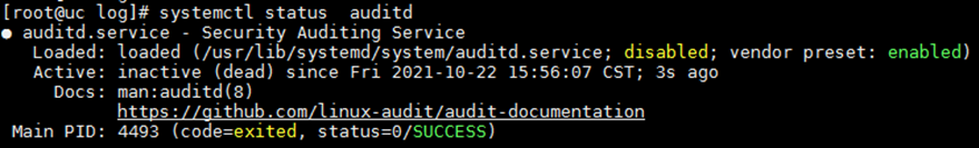

Disabling the auditd service
The auditd service might be memory intensive. If you are not to use the auditd service on the Kylin V10SP02 operating system, disable the auditd service.
To disable the auditd service:
1.     Stop the auditd service.
[root@uc log]# systemctl stop auditd
2.     Disable the auditd service.
[root@uc log]# systemctl disable auditd
3.     Confirm the state of the auditd service.
[root@uc log]# systemctl status auditd
Figure 31 Disabling the auditd service
In this example, the controller management network, node management network, simulation management network, and simulated device service network share one switch to deploy the Layer 3 management networks for simulation.
Figure 32 Management network diagram
Table 8 IP planning for the simulation management network
Component/node name
IP address plan
Interfaces
DTN component
IP address: 192.168.15.133/24 (gateway address: 192.168.15.1)
Ten-GigabitEthernet 1/0/25, VLAN 40
DTN host 1
IP address: 192.168.12.134/24 (gateway address: 192.168.12.1, NIC: ens1f0)
Ten-GigabitEthernet 1/0/26, VLAN 40
DTN host 2
IP address: 192.168.12.135/24 (gateway address: 192.168.12.1, NIC: ens1f0)
Ten-GigabitEthernet 1/0/27, VLAN 40
Simulated device 1
IP address: 192.168.11.136/24 (gateway address: 192.168.11.1)
N/A
Simulated device 2
IP address: 192.168.11.137/24 (gateway address: 192.168.11.1)
N/A
Simulated device 3
IP address: 192.168.21.134/24 (gateway address: 192.168.21.1)
N/A
Simulated device 4
IP address: 192.168.21.135/24 (gateway address: 192.168.21.1)
N/A
Table 9 IP planning for the simulated device service network
Component/node name
IP address plan
Interfaces
DTN host 1
IP address: 192.168.11.134/24 (gateway address: 192.168.11.1)
Ten-GigabitEthernet 1/0/28, VLAN 30
DTN host 2
IP address: 192.168.11.135/24 (gateway address: 192.168.11.1)
Ten-GigabitEthernet 1/0/29, VLAN 30
Table 10 IP planning for the node management network
Component/node name
IP address plan
Interfaces
Controller
IP: 192.168.10.110/24 (gateway address: 192.168.10.1)
Ten-GigabitEthernet 1/0/21, VLAN 10
DTN component
IP address: 192.168.10.111/24 (gateway address: 192.168.10.1)
Ten-GigabitEthernet 1/0/22, VLAN 10
DTN host 1
IP address: 192.168.10.112/24 (gateway address: 192.168.10.1)
Ten-GigabitEthernet 1/0/23, VLAN 10
DTN host 2
IP address: 192.168.10.113/24 (gateway address: 192.168.10.1)
Ten-GigabitEthernet 1/0/24, VLAN 10

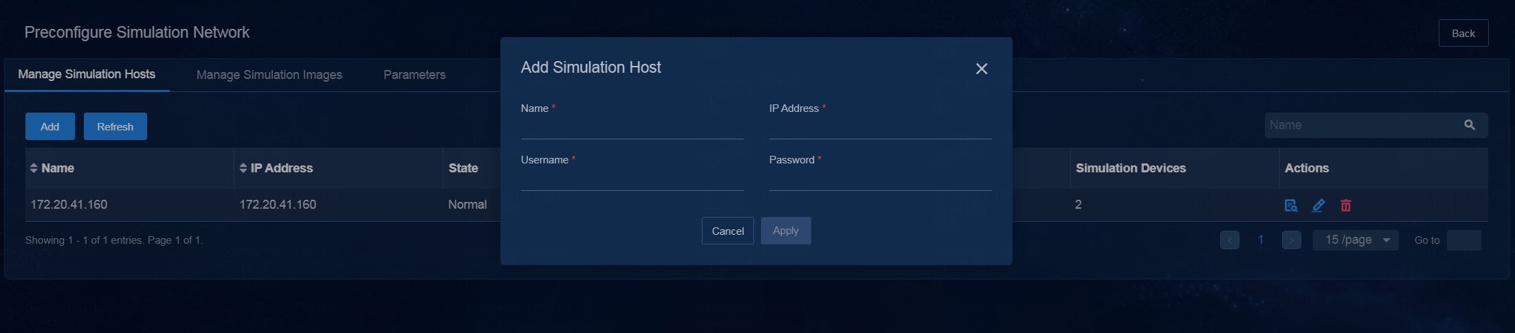

1.     Log in to the controller. Navigate to the Automation > Data Center Networks > Simulation > Build Simulation Network page. Click Preconfigure. The DTN host management page opens.
2.     Click Add. In the dialog box that opens, configure the host name, IP address, username, and password.
Figure 33 Adding DTN hosts
3.     Click Apply.

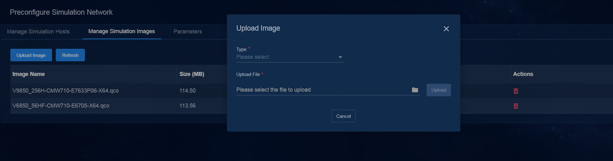

Upload simulation images
1.     Log in to the controller. Navigate to the Automation > Data Center Networks > Simulation > Build Simulation Network page. After clicking Preconfigure, click the Manage Simulation Images tab. The page for uploading simulation images opens.
2.     Click Upload Image. In the dialog box that opens, select the type of the image to be uploaded and image of the corresponding type, and then click Upload.
Figure 34 Uploading simulation images

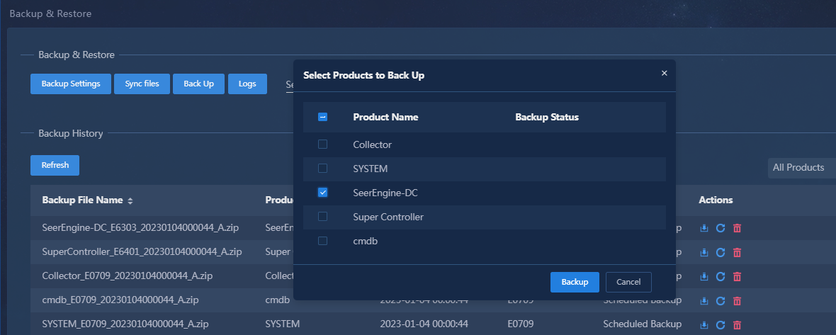

Back up the SeerEngine-DC environment
1.     Log in to the controller that is operating normally. Navigate to the System > Backup & Restore page.
2.     Click Start Backup. In the dialog box that opens, select SeerEngine-DC. Click Backup to start backup.
Figure 35 Back up SeerEngine-DC
3.     After the backup is completed, click Download in the Actions column for the backup file to download it.

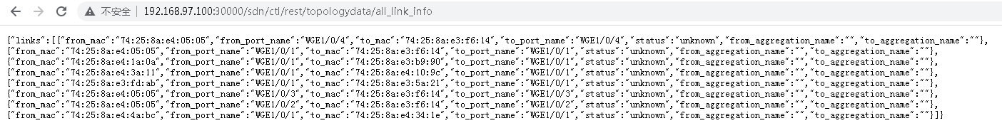

Obtain the link information file
1.     In the address bar of the browser, enter http://ip_address:port/sdn/ctl/rest/topologydata/all_link_info.
Link information of all fabrics in the environment will be displayed.
¡     ip_address: IP address of the controller.
¡     port: Port number.
Figure 36 Link info
2.     Copy the obtained link information to a .txt file, and save the file.
The file name is not limited. The file is the link information file.

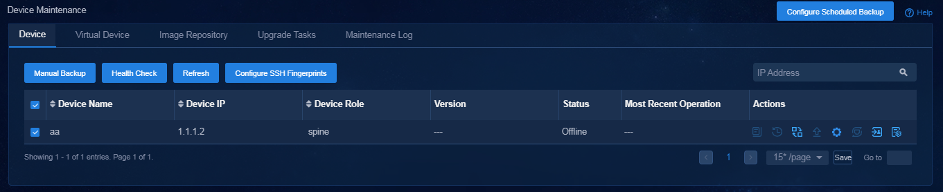

1.     Log in to the controller that is operating normally. Navigate to the Automation > Configuration Deployment > Device Maintenance > Physical Devices page.
2.     Select all devices, and click Manual Backup.
Figure 37 Manually backing up all device information
3.     Click the  icon in the Actions column for a device. The configuration file management page opens. Click Download to download the configuration file of the specified device to your local host.
4.     Compress all download configuration files into one .zip package.

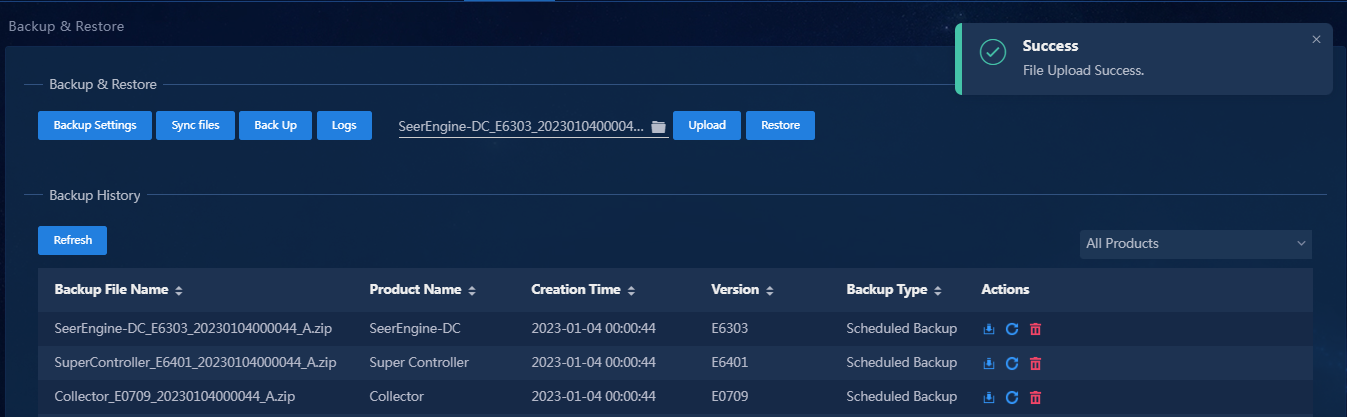

Restore the SeerEngine-DC environment
1.     Log in to the environment where you want to build a simulation network based on offline data.
2.     Navigate to the System > Backup & Restore page. Use the backup file to restore the environment.
Figure 38 Restore the environment

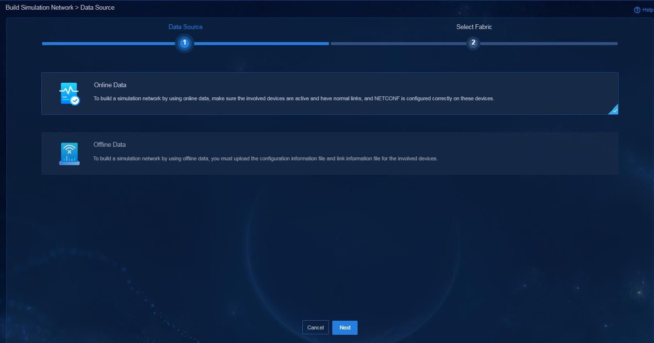

Building a simulation network includes the following steps: select the data source and select fabrics. The data source can be online data or offline data.
¡     Online Data: After you select this option, directly click Next.
Figure 39 Selecting a data source

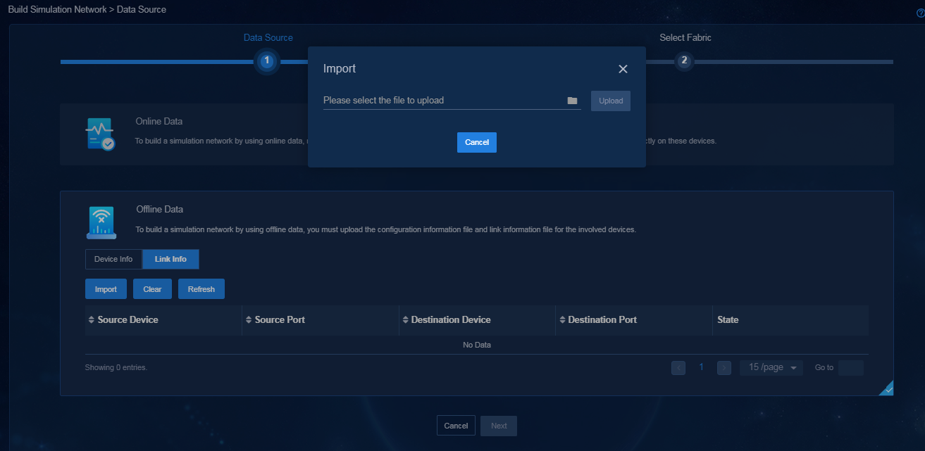

-     Down Link Info page, click Import. In the dialog box that opens, import and upload the link information file.
Figure 41 Importing and uploading the link information file

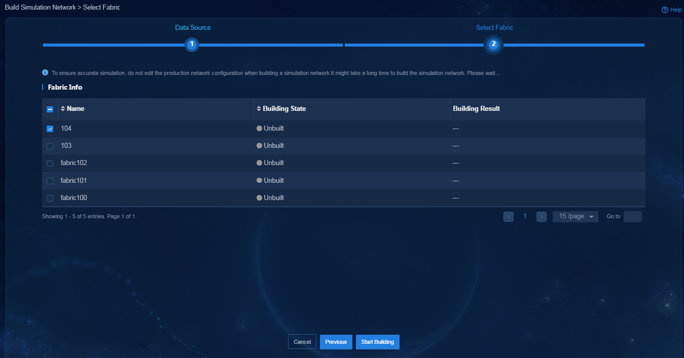

3.     Select fabrics as needed, and click Start Building to start building the simulation network. You can select multiple fabrics.
Figure 42 Selecting fabrics

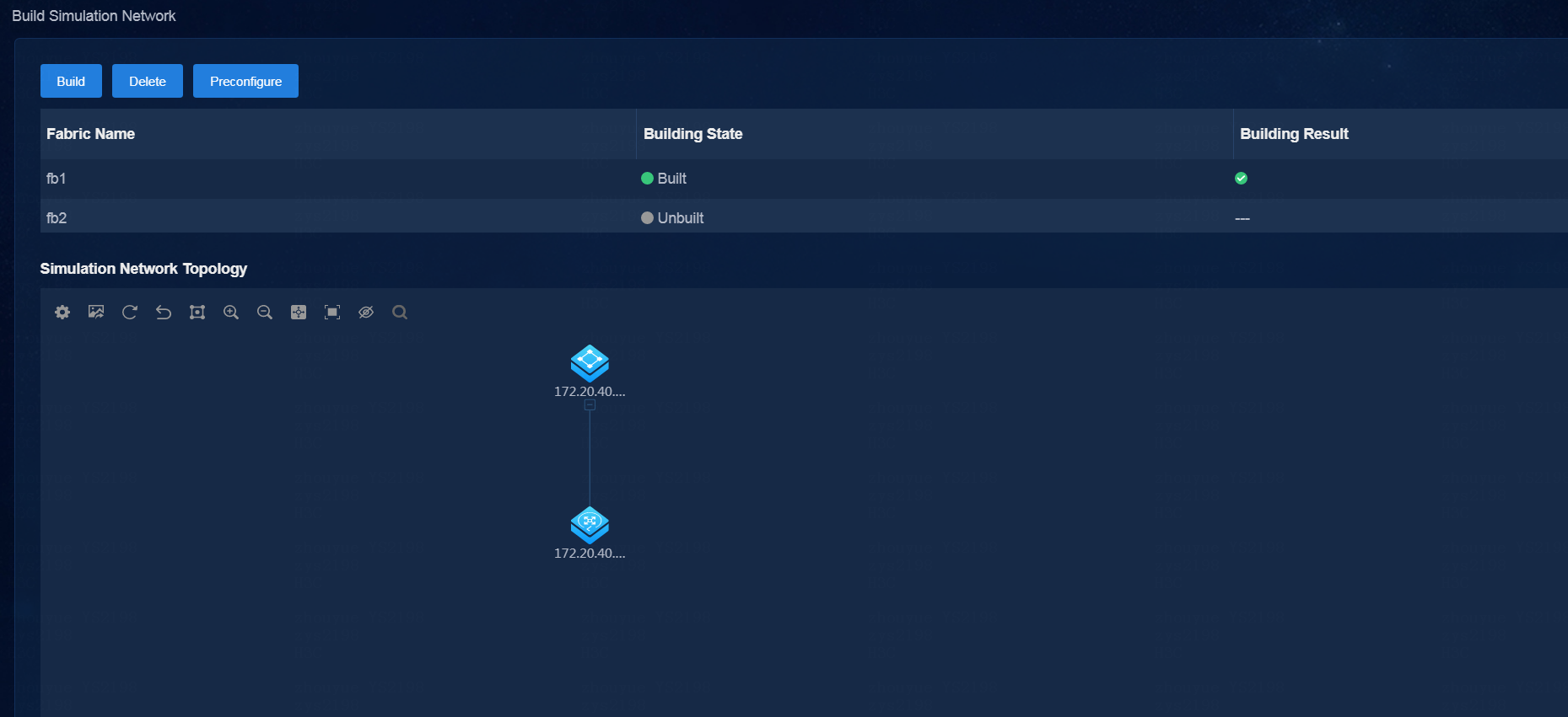

After the simulation network is built successfully, its state is displayed as Built on the page.
Figure 43 Simulation network built successfully

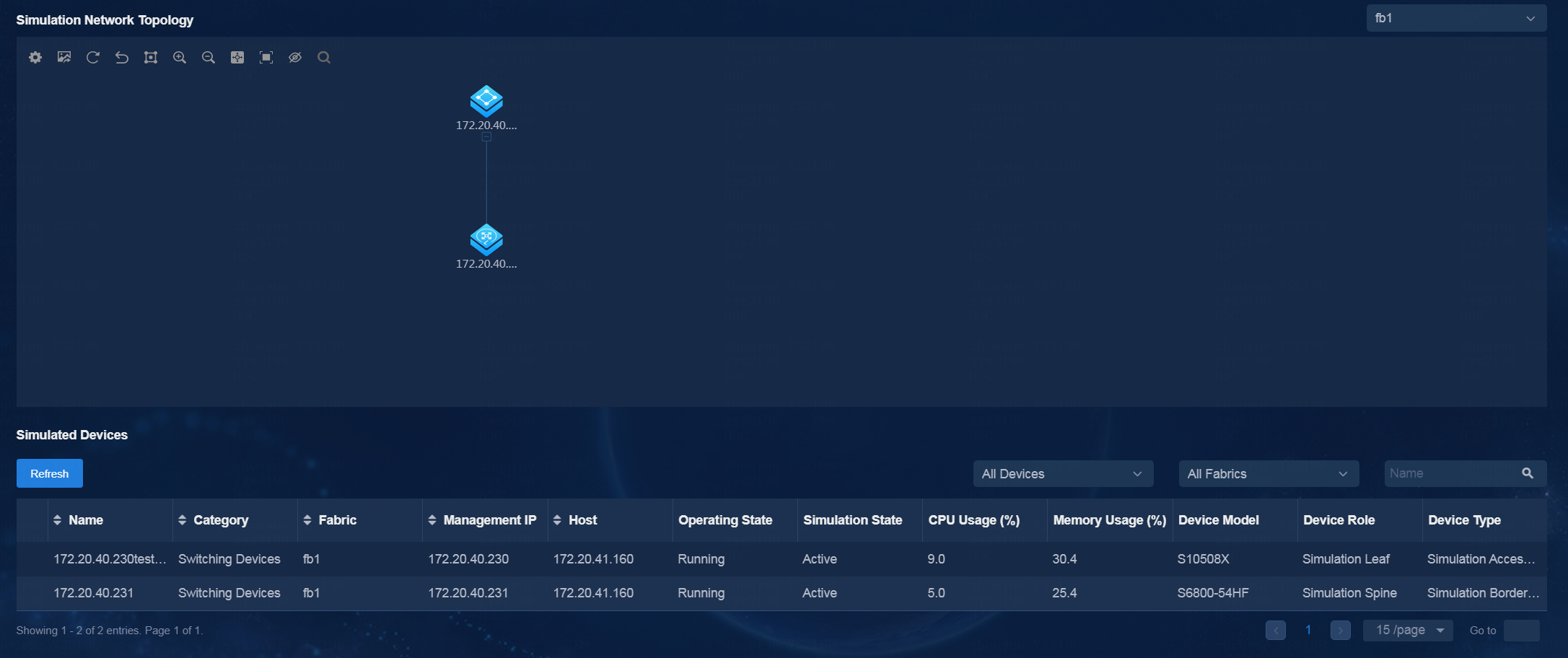

4.     After the simulation network is built successfully, you can view the simulated device information:
¡     The simulated device running state is Active.
¡     The device model is displayed correctly on the real network and the simulation network.
The VMs in the simulation network model are created on the host created. If multiple hosts are available, the controller selects a host with optimal resources for creating VMs.
Figure 44 Viewing simulated devices

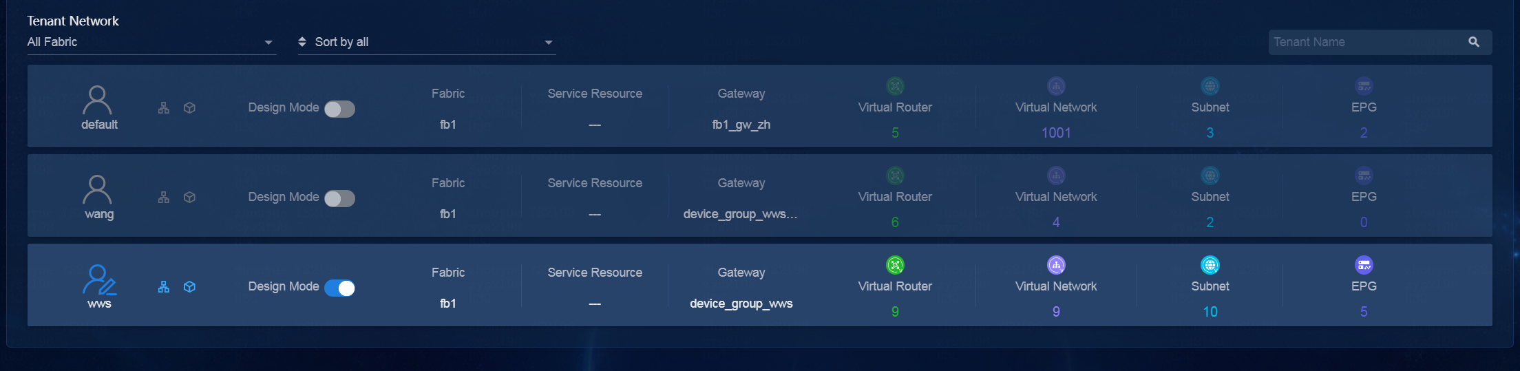

Enable the design mode for the tenant
1.     Navigate to the Automation > Data Center Networks > Simulation > Tenant Service Simulation page. Click the design mode icon for a tenant to enable or disable design mode for the tenant. After design mode is enabled for a tenant, the tenant icon becomes , which means that the tenant is editable. After design mode is disabled for a tenant, the tenant icon becomes , which indicates that the tenant is not editable.
2.     Click the icon for the tenant to enter the Tenant Service Simulation (Tenant Name) > Logical Networks page. On this page, you can perform tenant service simulation.
You can enable the design mode and then perform tenant service simulation only when the simulation network is built normally.
Figure 45 Enabling the design mode for the tenant

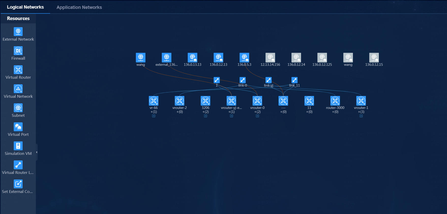

Configure tenant service simulation
1.     On the logical network page, you can perform the following operations:
¡     Drag a resource icon in the Resources area to the canvas area. Then, a node of this resource is generated in the canvas area, and the configuration panel for the resource node opens on the right.
¡     In the canvas area, you can adjust node locations, bind/unbind resource, and zoom in/out the topology.
Figure 46 Logical networks

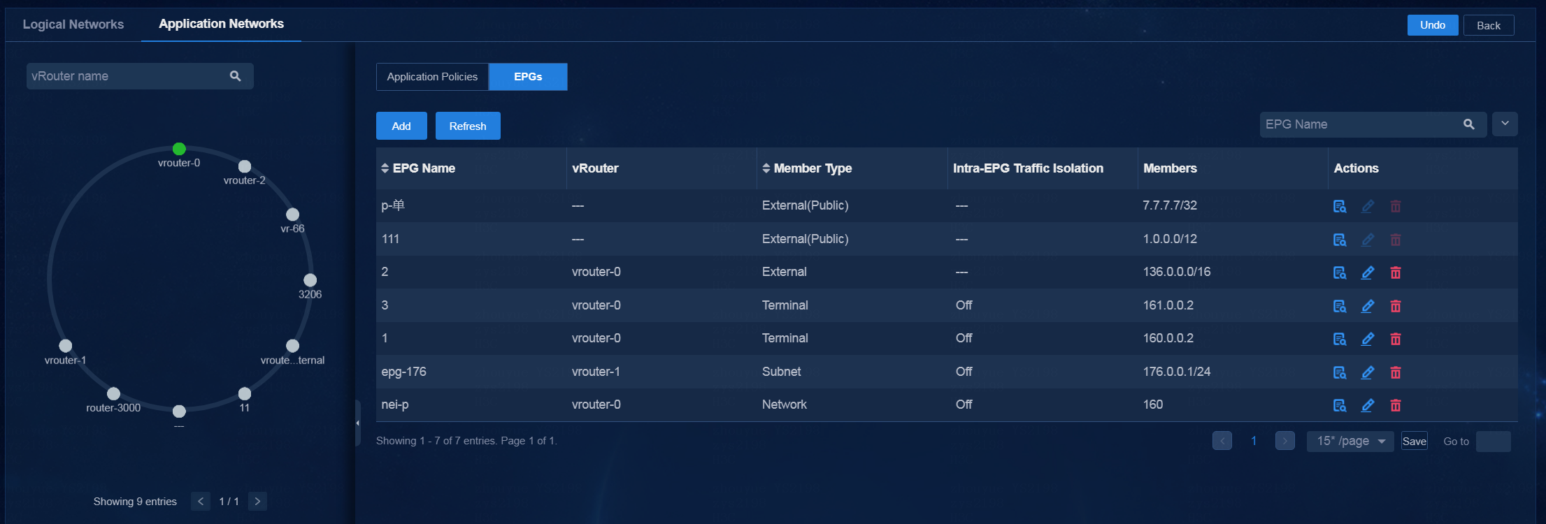

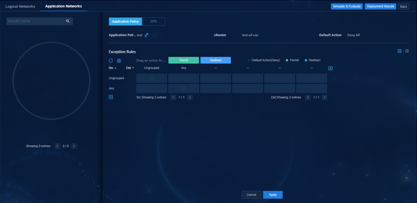

2.     On the application network page, configure EPGs and application policies in a graphical way.
Figure 47 Application networks > EPGs
Figure 48 Application networks > Application policies

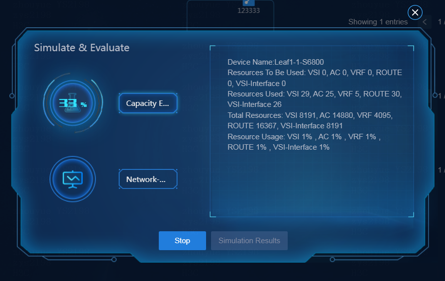

Evaluate the simulation and view the simulation result
Simulate and evaluate services

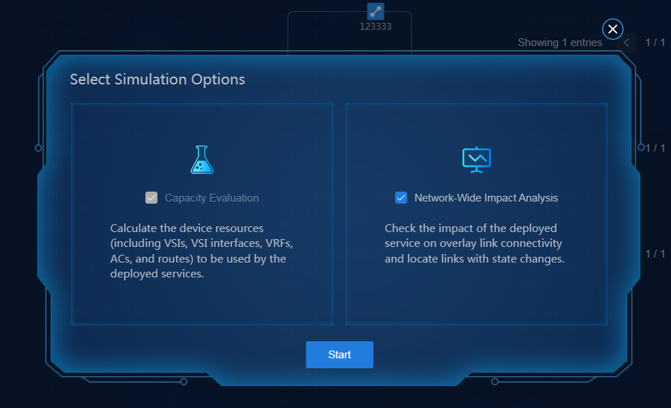

After resource configuration, click Simulate & Evaluate. In the dialog box that opens, select Network-Wide Impact Analysis, and click Start. In the left area of the Simulate & Evaluate dialog box, the progress in percentage is displayed. In the right area, the corresponding resource changes are displayed.
Figure 49 Simulating and evaluating services (1)
Figure 50 Simulating and evaluating services (2)

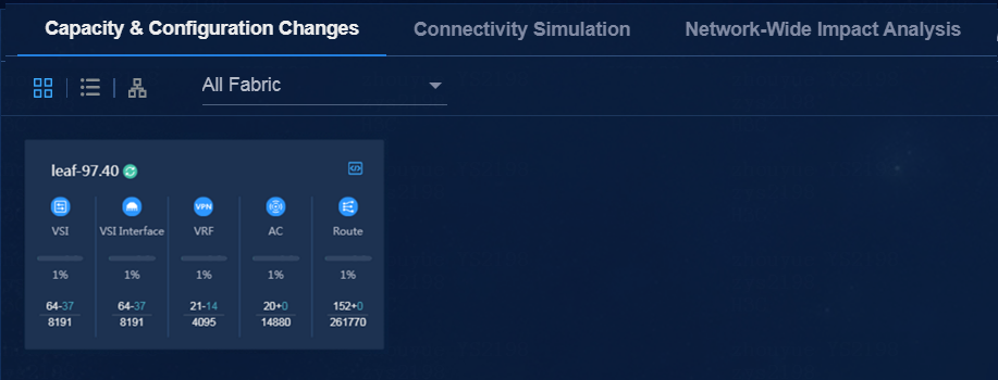

View the simulation result
After simulation evaluation is completed, click Simulation Results to enter the simulation result page. On this page, you can view the following simulation results:
·     Capacity & Configuration Changes—This page displays resource usages and the configuration changes before and after simulation in a list or block diagrams.
Figure 51 Capacity and configuration changes

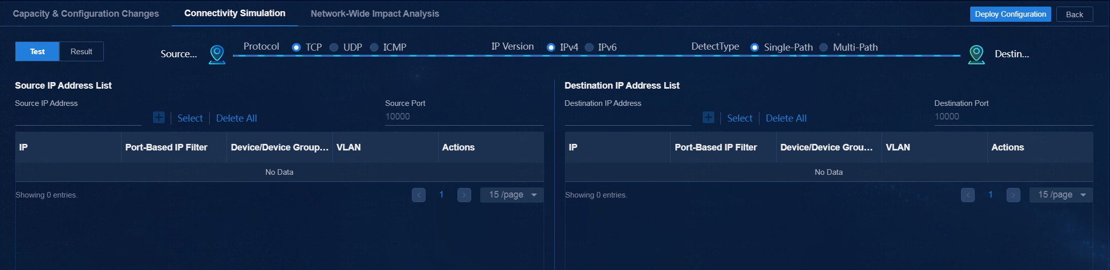

·     Connectivity Simulation—Perform this task to detect connectivity between source addresses and destination addresses. When specifying the source/destination addresses, you can input IP addresses or click Select and configure filter conditions in the dialog box that opens. Then, all the specified IP addresses are displayed on the source or destination IP address list. After completing the configuration, click Test to detect connectivity.
Figure 52 Connectivity detection

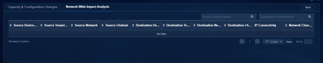

·     Network-Wide Impact Analysis—From this tab, you can view details of network information and perform a detection again. A single tenant supports performing network-wide impact analysis for up to 254 ports.
Figure 53 Network-wide impact analysis

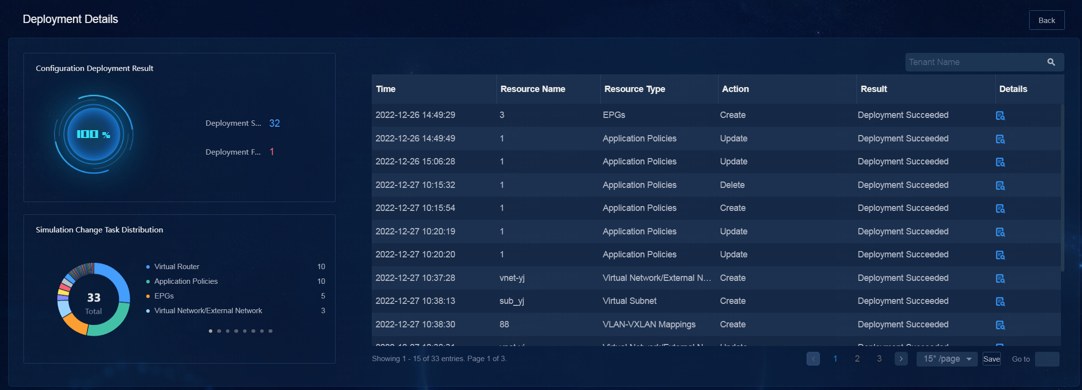

Deploy configuration and view deployment details
You can click Deploy Configuration to deploy the service configuration to real devices when the simulation evaluation result is as expected. Additionally, you can view details on the deployment details page.
Figure 54 Viewing deployment details

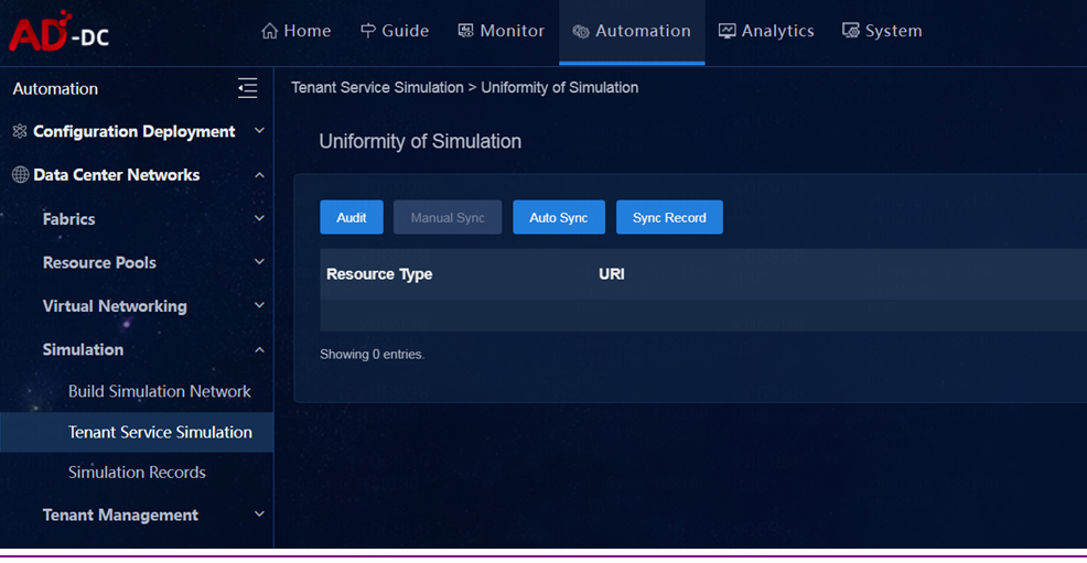

Synchronize date with the production environment
Typically, if the configuration data in the controller production environment changes after the simulation network is built, the user must rebuild the simulation network and then synchronize the incremented configuration data into the simulation environment.
The simulation data consistency feature is developed to resolve this issue. This feature supports synchronizing the configuration data within the specified range of the production environment to the simulation environment without rebuilding the simulation network.
To synchronize simulation date with that in the production environment:
1.     Log in to the controller. Navigate to the Automation > Data Center Networks > Simulation > Tenant Service Simulation page. Then click Uniformity of Simulation in the upper right corner of the page.
2.     Click Audit to audit the configuration between the simulation network and production environment and display the incremental configuration data after the simulation network is built.
Figure 55 Auditing the configuration between the simulation network and production environment
3.     Synchronize the configuration data manually or automatically.
¡     To synchronize the configuration data manually, click Manual Sync.
¡     To synchronize the configuration data automatically, click Auto Sync and configure the parameters. The system will synchronize incremental data in the specified range from the production environment to the simulation network periodically or at a specified time.

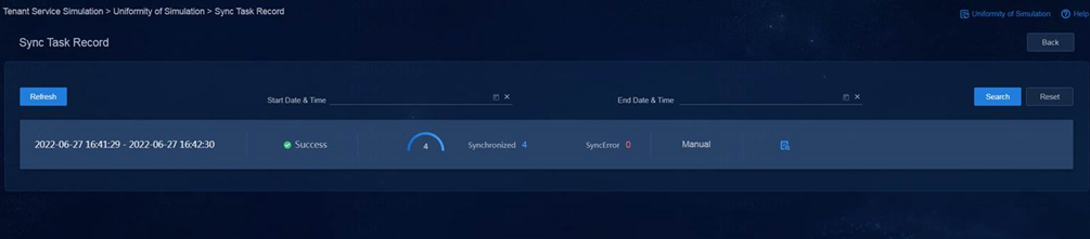

4.     View the synchronization task details and synchronization records.
¡     The Sync Task Detail page displays information of a synchronization task, including the overall progress and synchronization status of each configuration item.
¡     The Sync Task Record page displays the synchronization tasks in progress and completed synchronization tasks. The synchronization results are arranged in chronological order.
Figure 56 Viewing synchronization task details
Figure 57 Viewing the synchronization records

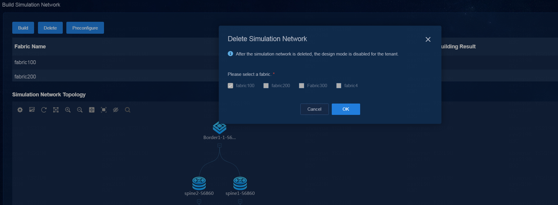

Delete a simulation network
2.     Click Delete. In the dialog box that opens, the fabric for which a simulation network has been built is selected by default.
Figure 58 Deleting a simulation network
3.     Click OK to start deleting the simulation network. When all operation results are displayed as Succeeded and the progress is 100%, the simulation network is deleted completely.

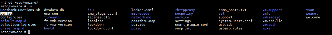

1.     Enable the nested virtualization feature for Vmware:
a.     Log in to the back end of the host of VMware. View the file named config in the /etc/vmware directory.
Figure 59 File named config in the /etc/vmware directory
a.     Execute the vi command to enter the configuration file named config. Add the following configuration to the end of the configuration file: vhv.enable = ”TRUE”
Figure 60 Editing the configuration file named config
a.     After the operation, execute the reboot command to restart the ESXi server.

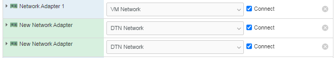

b.     After the configuration is completed, add a port group on VMware. The port group name is DTN Network in this example. Make sure the VLAN ID of the newly added port group is 4095 (the VLAN ID of 4095 means all VLANs are permitted).
Figure 62 Adding a port group
a.     After the port group is added, change the port group bound to the NIC of the DTN host.
Figure 63 Configuring the DTN host NIC
·     The network bound to the port group named DTN Network is used as the simulation management network and simulated device service network. The network bound to the port group named VM Network is used as the node management network.
·     If multiple DTN hosts are bound to the port group named DTN Network, make sure each physical network associated with the port group is reachable.
