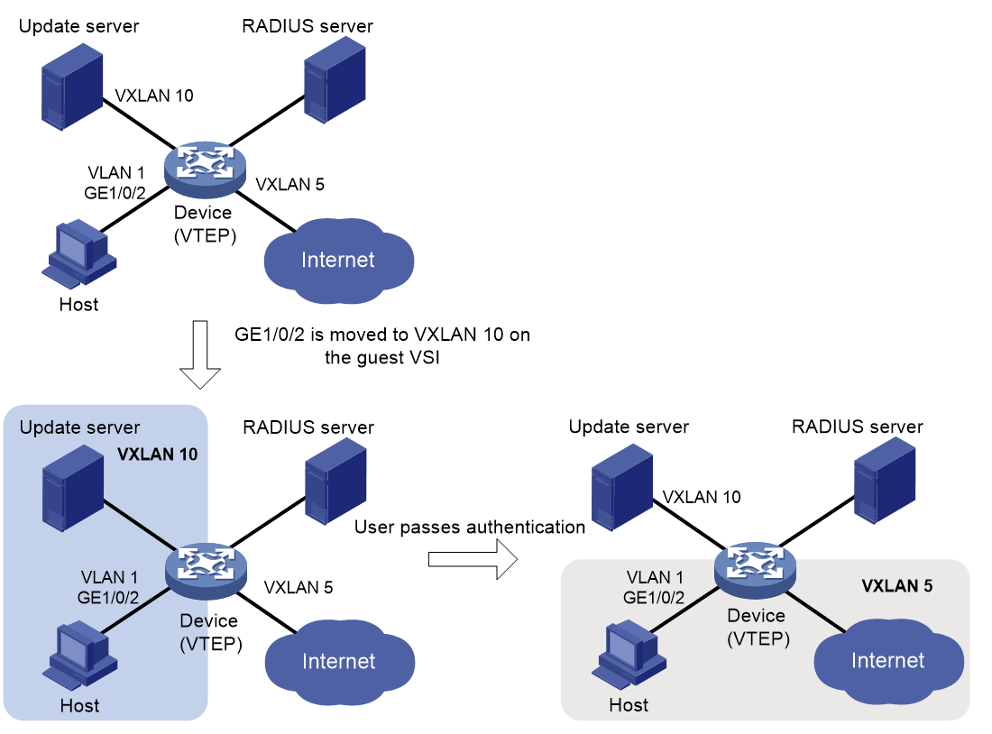

802.1X VSI manipulation
802.1X support for VXLANs
As shown in Figure 11, when the device acts as both a VXLAN VTEP and a NAS, users' service information cannot be identified by VLANs. To resolve this issue, you must configure the RADIUS server to assign VSIs to authenticated 802.1X users. The NAS will map a user's traffic to the VXLAN that is associated with the user's authorization VSI. The mapping criteria include the user's access VLAN, access port, and MAC address. MAC address information is required only when the access port performs MAC-based access control.
For information about VSIs and VXLANs, see VXLAN Configuration Guide.
Figure 11 VXLAN network diagram for 802.1X authentication

Critical VSI
The 802.1X critical VSI on a port accommodates 802.1X users that have failed authentication because none of the RADIUS servers in their ISP domain are reachable. Users in the critical VSI can access a limited set of network resources in the VXLAN associated with this VSI.
The critical VSI feature takes effect when 802.1X authentication is performed only through RADIUS servers. If an 802.1X user fails local authentication after RADIUS authentication, the user is not assigned to the critical VSI. For more information about the authentication methods, see "Configuring AAA."
The VTEP handles VSIs on an 802.1X-enabled port based on its 802.1X access control method.
Port-based access control
Authentication status
VSI manipulation
A user accesses the port and fails 802.1X authentication because all the RADIUS servers are unreachable.
The VTEP assigns the port to the critical VSI. The 802.1X user and all subsequent 802.1X users from the same VLAN on this port can access only resources in the VXLAN associated with the critical VSI.
A user in the 802.1X critical VSI fails authentication because all the RADIUS servers are unreachable.
The port is still in the critical VSI, and all 802.1X users from the same VLAN on this port are in the critical VSI.
A user in the 802.1X critical VSI fails authentication for any reason other than unreachable servers.
If an 802.1X Auth-Fail VSI has been configured for the port, the VTEP removes the port to the 802.1X Auth-Fail VSI.
If no 802.1X Auth-Fail VSI is configured for the port, the VTEP logs off the user.
A user in the 802.1X critical VSI passes 802.1X authentication.
The VTEP removes the port from the 802.1X critical VSI and assigns the port to the authorization VSI. After the user logs off, the port is removed from the authorization VSI. If the port has been configured with the 802.1X guest VSI, the VTEP assigns the port to the guest VSI.
A user in the 802.1X guest VSI fails authentication because all the RADIUS servers are unreachable.
The VTEP assigns the port to the critical VSI. All 802.1X users on this port can access only resources in the VXLAN associated with the 802.1X critical VSI.
A user in the 802.1X Auth-Fail VSI fails authentication because all the RADIUS servers are unreachable.
The PVID of the port remains unchanged. All 802.1X users on this port can access only resources in the VXLAN associated with the 802.1X Auth-Fail VSI.
A user that has passed authentication fails reauthentication because all the RADIUS servers are unreachable, and the user is logged out of the device.

Example: Configuring 802.1X guest VSI and authorization VSI configuration (port-based)
As shown in Figure 15:
·     The device acts as both a VXLAN VTEP and a network access device. It uses the RADIUS server to perform authentication, authorization, and accounting for 802.1X users that connect to GigabitEthernet 1/0/2.
·     GigabitEthernet 1/0/2 uses port-based access control and is configured with the 802.1X guest VSI. VXLAN 10 is created on the guest VSI. Users in the guest VSI can access the update server in VXLAN 10 and download the 802.1X client software.
·     The RADIUS server assigns an authorization VSI to the host. The VSI is associated with VXLAN 5 on the device. After passing authentication, the host can access the Internet.
Figure 15 Network diagram
For information about the RADIUS commands used on the access device in this example, see Security Command Reference.
1.     Configure the RADIUS server to provide authentication, authorization, and accounting services. Configure user accounts and authorization VSI (VSI vpn5 in this example) for the users. (Details not shown.)
If an ADCAM server is used for authentication and authorization, configure VSIs on the server. The server will assign these VSIs to the device. You do not need to configure VSIs on the device.
2.     Enable L2VPN on the access device.

# Specify VSI vpn10 as the 802.1X guest VSI on GigabitEthernet 1/0/2.
[Device-GigabitEthernet1/0/2] dot1x guest-vsi vpn10
[Device-GigabitEthernet1/0/2] quit
# Enable 802.1X globally.
[Device] dot1x
7.     Configure the 802.1X client. Make sure the 802.1X client can update its IP address after the access port is assigned to the guest VSI or an authorization VSI. (Details not shown.)
# Verify that GigabitEthernet 1/0/2 is assigned to VSI vpn10 before any user passes authentication on the port.
[Device] display l2vpn forwarding ac verbose
# Verify that GigabitEthernet 1/0/2 is assigned to VSI vpn5 after a user passes authentication on the port.
