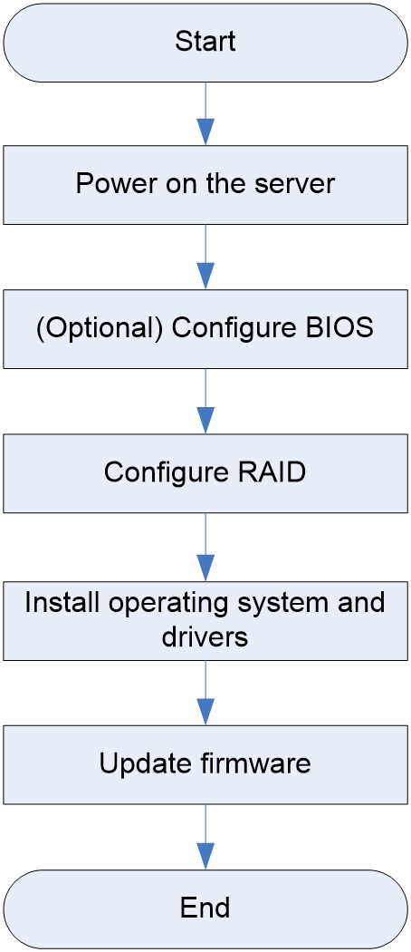

Configuring the server 24
Configuration flowchart 24
Powering on the server 24
Configuring basic BIOS settings· 25
Setting the server boot order 25
Setting the BIOS passwords· 25
Configuring RAID·· 25
Installing the operating system and hardware drivers· 25
Installing the operating system·· 25
Installing hardware drivers· 25
Updating firmware· 26

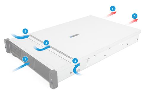

Airflow direction of the server
Figure 2 Airflow direction of the server
(1) to (4) Directions of the airflow into the chassis and power supplies
(5) Direction of the airflow out of the power supplies
(6) Direction of the airflow out of the chassis

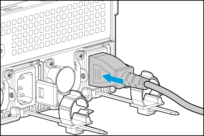

1.     Insert the power cord plug into the power receptacle of a power supply at the rear panel, as shown in Figure 8.
Figure 8 Connecting the power cord
2.     Connect the other end of the power cord to the power source, for example, the power strip on the rack.
3.     Secure the power cord to avoid unexpected disconnection of the power cord.
Multiple types of wire fasteners can be used for securing the power cord. In this procedure, a cable clamp is used.
a.     If the cable clamp is positioned too near the power cord that it blocks the power cord plug connection, press down the tab on the cable mount and slide the clip backward.
Figure 9 Sliding the cable clamp backward
b.     Open the cable clamp, place the power cord through the opening in the cable clamp, and then close the cable clamp, as shown by callouts 1, 2, 3, and 4 in Figure 10.
Figure 10 Securing the AC power cord
c.     Slide the cable clamp forward until it is flush against the edge of the power cord plug, as shown in Figure 11.
Figure 11 Sliding the cable clamp forward
The following information describes the procedures to configure the server after the server installation is complete.
Figure 14 Configuration flowchart
1.     Power on the server. For information about the procedures, see "Powering on the server."
2.     Verify that the health LED on the front panel is steady green, which indicates that the system is operating correctly. For more information about the health LED status, see "LEDs and buttons."
You can set the server boot order and the BIOS passwords from the BIOS setup utility of the server.
The BIOS setup utility screens are subject to change without notice.
The server has a default boot order. You can change the server boot order from the BIOS. For the default boot order and the procedure of changing the server boot order, see the BIOS user guide for the server.
BIOS passwords include a boot password as well as an administrator password and a user password for the BIOS setup utility. By default, no passwords are set.
To prevent unauthorized access and changes to the BIOS settings, set both the administrator and user passwords for accessing the BIOS setup utility. Make sure the two passwords are different.
After setting the administrator password and user password for the BIOS setup utility, you must enter the administrator password or user password each time you access the BIOS setup utility.
·     To obtain administrator privileges, enter the administrator password.
·     To obtain the user privileges, enter the user password.
For the difference between the administrator and user privileges and guidelines for setting the BIOS passwords, see the BIOS user guide for the server.
Configuring RAID

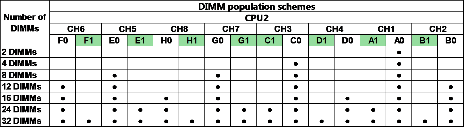

·     In Figure 15, Figure 16, and Figure 17, the black DIMM slots (for example, the F1 slot) are grey colored, and the white DIMM slots (for example, the F0 slot) are not colored.
Figure 15 DDR4-only DIMM population schemes for one processor
Figure 16 DDR4-only DIMM population schemes for two processors (1)
Figure 17 DDR4-only DIMM population schemes for two processors (2)

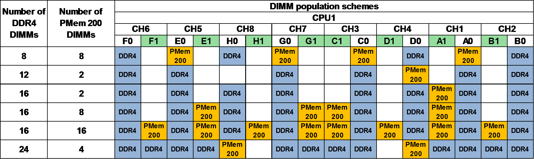

·     Depending on the processor and DIMM configuration, use the schemes shown in Figure 18, Figure 19, and Figure 20 to populate the DIMM slots.
In Figure 18, Figure 19, and Figure 20, the black DIMM slots (for example, the B1 slot) are grey colored, and the white DIMM slots (for example, the B0 slot) are not colored.
If one processor is present, populate DIMMs as shown in Figure 18.
Figure 18 Mixed DDR4 and PMem DIMM population schemes for one processor
If two processors are present, populate DIMMs as shown in Figure 19 or Figure 20.
Figure 19 Mixed DDR4 and PMem DIMM population schemes for two processors (1)
Figure 20 Mixed DDR4 and PMem DIMM population schemes for two processors (1)

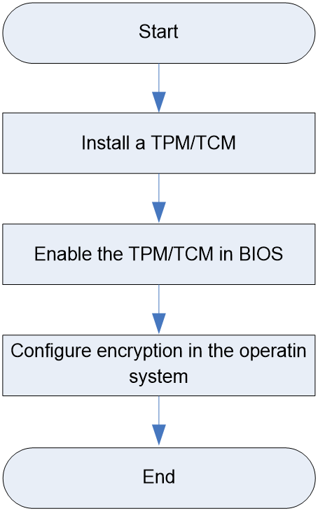

Installing and setting up a TCM or TPM
Trusted platform module (TPM) is a microchip embedded in the system board. It stores encryption information (such as encryption keys) for authenticating server hardware and software. The TPM operates with drive encryption programs such as Microsoft Windows BitLocker to provide operating system security and data protection. For information about Microsoft Windows BitLocker, visit the Microsoft website at http://www.microsoft.com.
Trusted cryptography module (TCM) is a trusted computing platform-based hardware module with protected storage space, which enables the platform to implement password calculation.
Installation and setup flowchart
Figure 21 TCM/TPM installation and setup flowchart

The installation procedure is the same for a TPM and a TCM. The following information uses a TPM to show the procedure:
a.     Press the TPM into the TPM connector on the system board.
b.     Insert the rivet pin.
c.     Insert the security rivet into the hole in the rivet pin and press the security rivet until it is firmly seated.
6.     Install the removed riser cards, if any.
7.     Install the access panel:
a.     Place the access panel onto the server.
b.     Slide the access panel to the server front until it snaps into place.
8.     Rack-mount the server. For more information, see "Rack-mounting the server."
9.     Connect the power cord. For more information, see "Connecting the power cord."
10.     Power on the server. For more information, see "Powering on the server."
Enabling the TCM or TPM in the BIOS
1.     Access the BIOS utility. For information about how to enter the BIOS utility, see the BIOS user guide.
2.     Select Advanced > Trusted Computing, and press Enter.
3.     Enable TCM or TPM. By default, the TCM and TPM are enabled for a server.
If the server is installed with a TPM, select TPM State > Enabled, and then press Enter.
If the TPM is installed with a TCM, select TCM State > Enabled, and then press Enter.
4.     Log in to HDM to verify that the TCM or TPM is operating correctly. For more information, see HDM online help.

3.     Remove the power cord from the power supply:
a.     Press the tab to disengage the ratchet from the tie mount, slide the cable clamp outward, and then release the tab.
b.     Open the cable clamp and remove the power cord out of the clamp.
c.     Unplug the power cord.

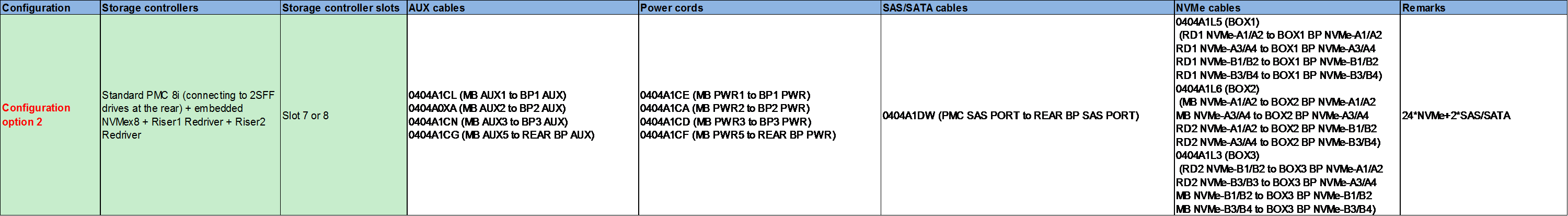

Figure 24 Drive configuration and cabling scheme for configuration option 2
Table 14 Cabling scheme for drive configuration option 2
Cable type
Cable code
Cabling method
Remarks
AUX signal cable
0404A1CL
MB AUX1 to BP1 AUX, connecting connector AUX1 on the system board to connector AUX on the drive backplane in drive bay 1.
Figure 28 and Figure 31
0404A0XA
MB AUX2 to BP2 AUX, connecting connector AUX2 on the system board to connector AUX on the drive backplane in drive bay 2.
0404A1CN
MB AUX3 to BP3 AUX, connecting connector AUX3 on the system board to connector AUX on the drive backplane in drive bay 3.
0404A1CG
MB AUX5 to REAR BP AUX, connecting connector AUX5 on the system board to connector AUX on the rear drive backplane.
Power cord
0404A1CE
MB PWR1 to BP1 PWR, connecting connector PWR1 on the system board to connector PWR on the drive backplane in drive bay 1.
Figure 29 and Figure 32
0404A1CA
MB PWR2 to BP2 PWR, connecting connector PWR2 on the system board to connector PWR on the drive backplane in drive bay 2.
0404A1CD
MB PWR3 to BP3 PWR, connecting connector PWR3 on the system board to connector PWR on the drive backplane in drive bay 3.
0404A1CF
MB PWR5 to REAR BP PWR, connecting connector PWR5 on the system board to connector PWR on the rear drive backplane.
SAS/SATA data cable
0404A1DW
PMC SAS PORT to REAR BP SAS PORT, connecting the SAS connector on the PMC storage controller to connector SAS PORT on the rear drive backplane.
Figure 30
NVMe data cable
0404A1L5
Four 0404A1L5 NVMe drive data cables:
·     RD1 NVME-A1/A2 to BOX1 BP NVME-A1/A2, connecting connector NVMe-A1/A2 on the NVMe SSD expander module on riser connector 1 to connector NVMe A1/A2 on the drive backplane in drive bay 1.
·     RD1 NVME-A3/A4 to BOX1 BP NVME-A3/A4, connecting connector NVMe-A3/A4 on the NVMe SSD expander module on riser connector 1 to connector NVMe A3/A4 on the drive backplane in drive bay 1.
·     RD1 NVME-B1/B2 to BOX1 BP NVME-B1/B2, connecting connector NVMe-B1/B2 on the NVMe SSD expander module on riser connector 1 to connector NVMe B1/B2 on the drive backplane in drive bay 1.
·     RD1 NVME-B3/B4 to BOX1 BP NVME- B3/B4, connecting connector NVMe B3/B4 on the NVMe SSD expander module on riser connector 1 to connector NVMe B3/B4 on the drive backplane in drive bay 1.
Figure 25, Figure 26, and Figure 27
0404A1L6
Four 0404A1L6 NVMe drive data cables:
·     MB NVME-A1/A2 to BOX2 BP NVME-A1/A2, connecting connector NVMe-A1/A2 on the system board to connector NVMe A1/A2 on the drive backplane in drive bay 2.
·     MB NVME-A3/A4 to BOX2 BP NVME-A3/A4, connecting connector NVMe-A3/A4 on the system board to connector NVMe A3/A4 on the drive backplane in drive bay 2.
·     RD2 NVME-B1/B2 to BOX2 BP NVME-B1/B2, connecting connector NVMe-B1/B2 on the NVMe SSD expander module on riser connector 2 to connector NVMe B1/B2 on the drive backplane in drive bay 2.
·     RD2 NVME-B3/B4 to BOX2 BP NVME-B3/B4, connecting connector NVMe-A3/A4 on the NVMe SSD expander module on riser connector 2 to connector NVMe B3/B4 on the drive backplane in drive bay 2.
0404A1L3
Four 0404A1L3 NVMe drive data cables:
·     RD2 NVME-B1/B2 to BOX3 BP NVME-A1/A2, connecting connector NVMe-B1/B2 on the NVMe SSD expander module on riser connector 2 to connector NVMe A1/A2 on the drive backplane in drive bay 3.
·     RD2 NVME-B3/B4 to BOX3 BP NVME-A3/A4, connecting connector NVMe-A3/A4 on the NVMe SSD expander module on riser connector 2 to connector NVMe A3/A4 on the drive backplane in drive bay 3.
·     MB NVME-B1/B2 to BOX3 BP NVME-B1/B2, connecting connector NVMe-B1/B2 on the system board to connector NVMe B1/B2 on the drive backplane in drive bay 3.
·     MB NVME-B3/B4 to BOX3 BP NVME-B3/B4, connecting connector NVMe B3/B4 on the system board to connector NVMe B3/B4 on the drive backplane in drive bay 3.

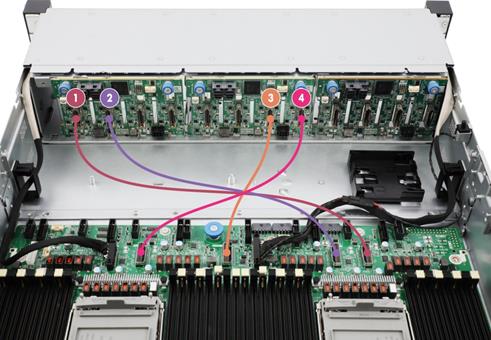

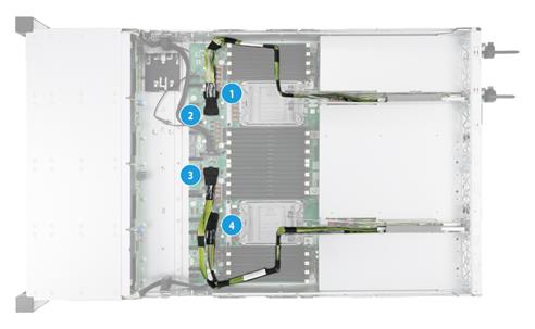

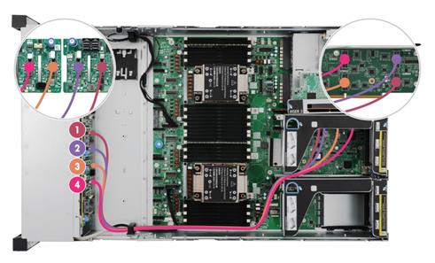

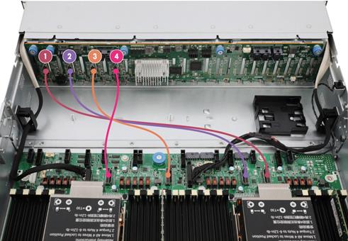

Figure 25 Connecting NVMe data cables for the three 8SFF UniBay NVMe drives at the front (1)
(1) to (4): NVMe data cables connected to the LP SlimSAS connectors on the system board

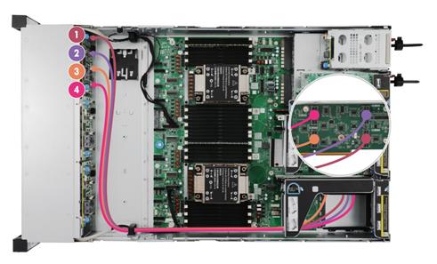

Figure 26 Connecting NVMe data cables for the three 8SFF UniBay NVMe drives at the front (2)
(1) to (4): NVMe data cables connected to the NVMe SSD expander module on riser connector 1
Figure 27 Connecting NVMe data cables for the three 8SFF UniBay NVMe drives at the front (3)
(1) to (4): NVMe data cables connected to the NVMe SSD expander module on riser connector 2

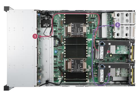

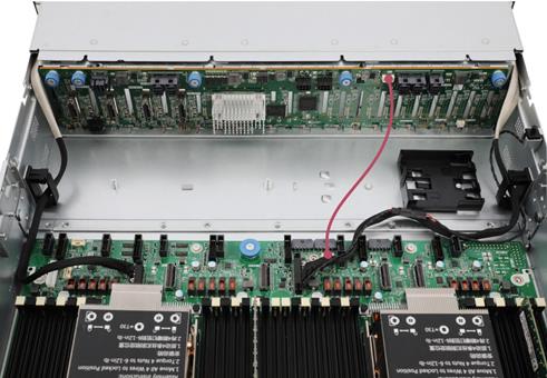

Figure 28 Connecting AUX cables for the three 8SFF UniBay drives at the front
(1): AUX cable for the 8SFF UniBay drive backplane in drive bay 3
(2): AUX cable for the 8SFF UniBay drive backplane in drive bay 2
(3): AUX cable for the 8SFF UniBay drive backplane in drive bay 1

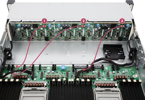

Figure 29 Connecting power cords for the three 8SFF UniBay drives at the front
(1): Power cord for the 8SFF UniBay drive backplane in drive bay 3
(2): Power cord for the 8SFF UniBay drive backplane in drive bay 2
(3): Power cord for the 8SFF UniBay drive backplane in drive bay 1

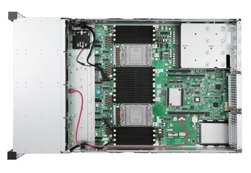

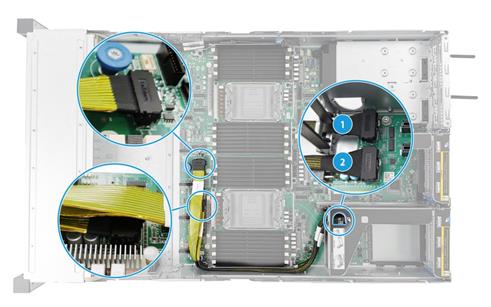

Figure 30 Connecting an SAS/SATA data cable for the 2SFF drives at the rear

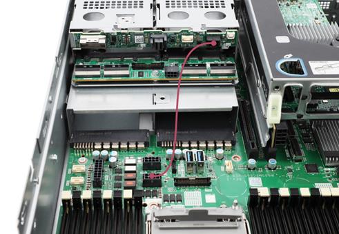

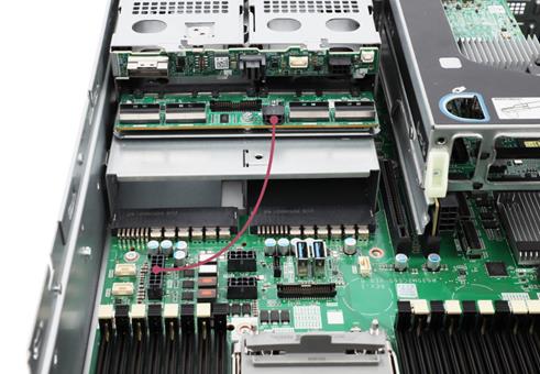

Figure 31 Connecting an AUX cable for the 2SFF drives at the rear

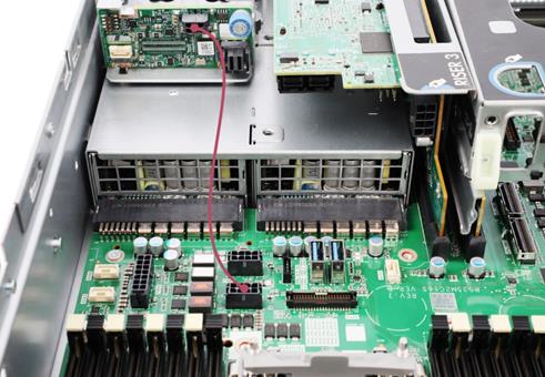

Figure 32 Connecting a power cord  for the 2SFF drives at the rear

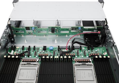

8LFF drives at the front
1.     Connect an SAS/SATA data cable for the 8LFF drives at the front.

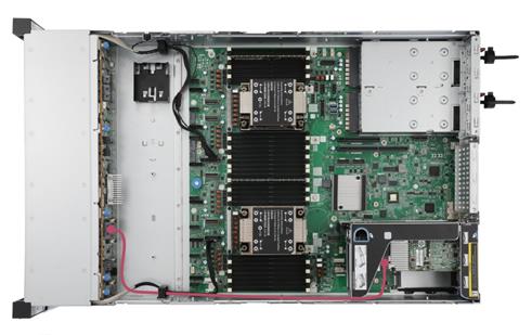

Figure 33 Connecting an SAS/SATA data cable for the 8LFF drives at the front
2.     Connect an AUX cable for the 8LFF drives at the front.
Figure 34 Connecting an AUX cable for the 8LFF drives at the front
3.     Connect a power cord for the 8LFF drives at the front.
Figure 35 Connecting a power cord for the 8LFF drives at the front.

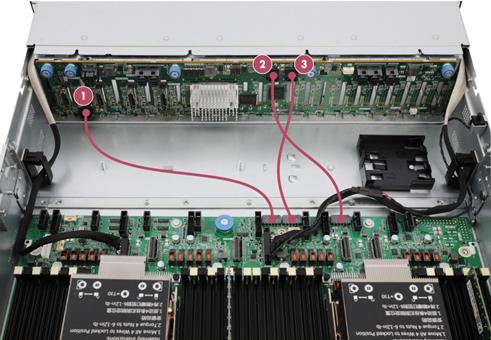

25SFF drives at the front
1.     Connect NVMe data cables for the 25SFF drives at the front.
Figure 36 Connecting NVMe data cables for the 25SFF drives at the front

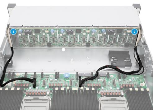

3.     Connect power cords for the three 8SFF UniBay drives at the front.
Figure 44 Connecting power cords for the three 8SFF UniBay drives at the front
(1): Power cord from the 8SFF UniBay drive backplane in drive bay 3 to the system board
(2): Power cord from the 8SFF UniBay drive backplane in drive bay 2 to the system board
(3): Power cord from the 8SFF UniBay drive backplane in drive bay 1 to the system board

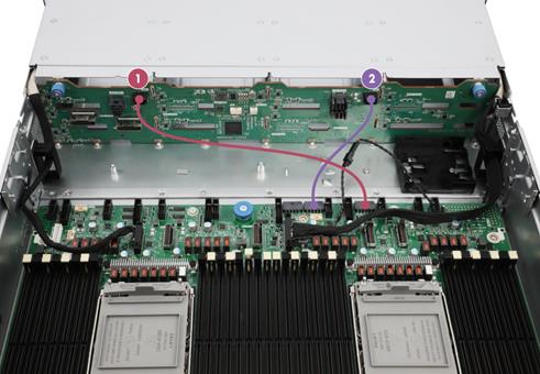

1.     Connect SAS/SATA data cables for the 12LFF drives at the front.
Figure 48 Connecting SAS/SATA data cables for the 12LFF drives at the front
(1) and (2): SAS/SATA data cables for the 12LFF SAS/SATA drive backplane

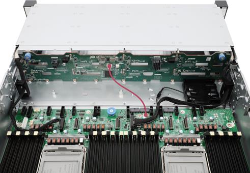

2.     Connect an AUX cable for the 12LFF drives at the front.
Figure 49 Connecting an AUX cable for the 12LFF drives at the front
3.     Connect power cords for the 12LFF drives at the front.
Figure 50 Connecting power cords for the 12LFF drives at the front
(1) to (2): Power cords from the 12LFF SAS/SATA drive backplane to the system board

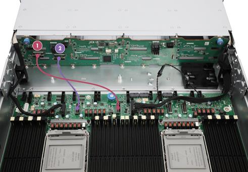

Figure 54 Connecting NVMe data cables for the 12LFF drives at the front

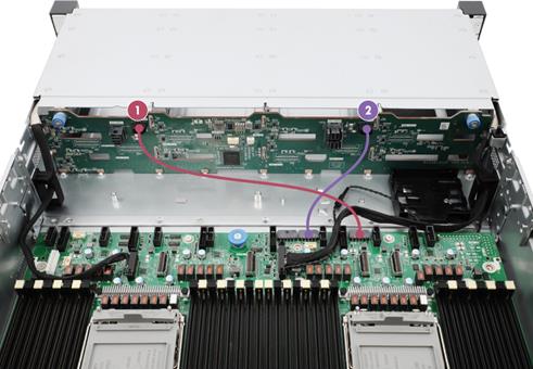

(1) and (2): NVMe data cables for the 12LFF drives at the front

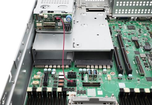

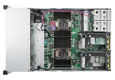

Connecting OCP adapter cables
Figure 60 Connecting an AUX cable for the OCP adapter
Figure 61 Connecting a power cord for the OCP adapter

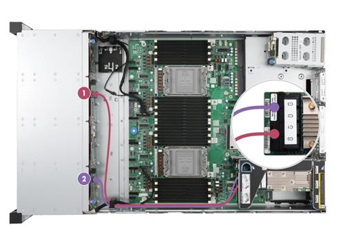

Figure 62 Connecting data cables for the OCP adapter
(1) and (2): Data cables for the OCP adapter

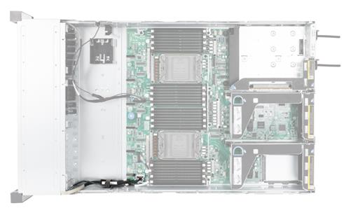

Connecting supercapacitor extension cables

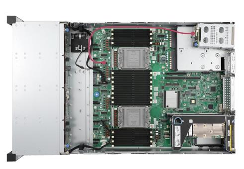

Figure 63 Connecting supercapacitor extension cables

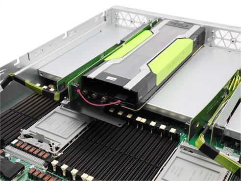

Connecting cables for the GPU at the rear
Figure 64 Connecting data cables for the GPU at the rear
(1) to (4): Data cables for the GPU at the rear
Figure 65 Connecting a power cord for the GPU module at the rear

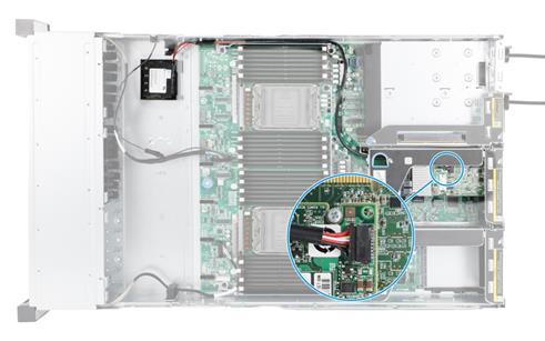

Connecting the SATA M.2 SSD data cables
Figure 66 Connecting the SATA M.2 SSD data cables
Connecting the PCIe signal cables
Figure 67 Connecting the PCIe signal cables
Table 15 Cabling method
Riser card connector
Cable code
Cable number
Connector on the riser card
Connector on the system board
Riser1
0404A1EB
1
SlimSAS connector 1
LP SlimSAS connector A1/A2
2
SlimSAS connector 2
LP SlimSAS connector A3/A4
Riser2
0404A1ED
1
SlimSAS connector 1
LP SlimSAS connector B1/B2
2
SlimSAS connector 2
LP SlimSAS connector B3/B4
