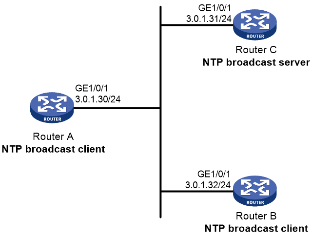

Figure 1 shows how NTP synchronizes the system time between two devices (Device A and Device B, in this example). Assume that:
·     Prior to the time synchronization, the time is set to 10:00:00 am for Device A and 11:00:00 am for Device B.
·     Device B is used as the NTP server. Device A is to be synchronized to Device B.
·     It takes 1 second for an NTP message to travel from Device A to Device B, and from Device B to Device A.
·     It takes 1 second for Device B to process the NTP message.
Figure 1 Basic work flow
The synchronization process is as follows:
1.     Device A sends Device B an NTP message, which is timestamped when it leaves Device A. The time stamp is 10:00:00 am (T1).
2.     When this NTP message arrives at Device B, Device B adds a timestamp showing the time when the message arrived at Device B. The timestamp is 11:00:01 am (T2).
3.     When the NTP message leaves Device B, Device B adds a timestamp showing the time when the message left Device B. The timestamp is 11:00:02 am (T3).
4.     When Device A receives the NTP message, the local time of Device A is 10:00:03 am (T4).
Up to now, Device A can calculate the following parameters based on the timestamps:
·     The roundtrip delay of the NTP message: Delay = (T4 – T1) – (T3 – T2) = 2 seconds.
·     Time difference between Device A and Device B: Offset = [ (T2 – T1) + (T3 – T4) ] /2 = 1 hour.
Based on these parameters, Device A can be synchronized to Device B.

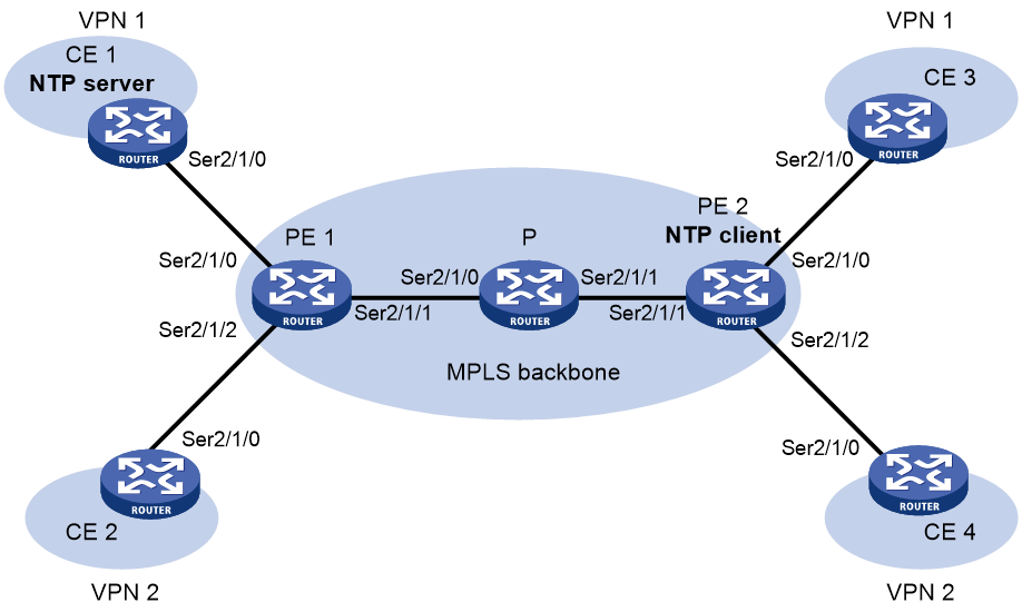

NTP for MPLS L3VPN instances
On an MPLS L3VPN network, a PE that acts as an NTP client or active peer can synchronize with the NTP server or passive peer in an MPLS L3VPN instance.
As shown in Figure 4, users in VPN 1 and VPN 2 are connected to the MPLS backbone network through provider edge (PE) devices. VPN instances vpn1 and vpn2 have been created for VPN 1 and VPN 2, respectively on the PEs. Services of the two VPN instances are isolated. Time synchronization between PEs and devices in the two VPN instances can be realized if you perform the following tasks:
·     Configure the PEs to operate in NTP client or symmetric active mode.
·     Specify the VPN instance to which the NTP server or NTP symmetric passive peer belongs.
Figure 4 Network diagram
For more information about MPLS L3VPN, VPN instance, and PE, see MPLS Configuration Guide.

Example: Configuring NTP broadcast association mode
As shown in Figure 9, configure Router C as the NTP server for multiple devices on a network segment to synchronize the time of the devices.
·     Configure Router C's local clock as its reference source, with stratum level 2.
·     Configure Router C to operate in broadcast server mode and send broadcast messages from GigabitEthernet 1/0/1.
·     Configure Router B and Router A to operate in broadcast client mode and receive broadcast messages on GigabitEthernet 1/0/1.
Figure 9 Network diagram
1.     Assign an IP address to each interface, and make sure the routers are reachable to each other, as shown in Figure 9. (Details not shown.)
2.     Configure Router C:

Example: Configuring NTP multicast association mode
As shown in Figure 10, configure router C as the NTP server for multiple devices on different network segments to synchronizes the time of the devices.
·     Configure Router C to operate in multicast server mode and send multicast messages from GigabitEthernet 1/0/1.
·     Configure Router D and Router A to operate in multicast client mode and receive multicast messages on GigabitEthernet 1/0/1.
Figure 10 Network diagram
1.     Assign an IP address to each interface, and make sure the routers can reach each other, as shown in Figure 10. (Details not shown.)

Figure 13 Network diagram
1.     Assign an IP address to each interface, and make sure Router A, Router B, and Router C can reach each other, as shown in Figure 13. (Details not shown.)
2.     Configure Router A:
# Enable the NTP service.
<RouterA> system-view
[RouterA] ntp-service enable
# Specify NTP for obtaining the system time.
[RouterA] clock protocol ntp
# Enable NTP authentication on Router A. Create a plaintext NTP authentication key, with the key ID of 88 and key value of 123456. Specify the key as a trusted key.
[RouterA] ntp-service authentication enable
[RouterA] ntp-service authentication-keyid 88 authentication-mode md5 simple 123456
[RouterA] ntp-service reliable authentication-keyid 88
# Configure Router A to operate in broadcast client mode and receive NTP broadcast messages on GigabitEthernet 1/0/1.
[RouterA] interface gigabitethernet 1/0/1
[RouterA-GigabitEthernet1/0/1] ntp-service broadcast-client
3.     Configure Router B:
<RouterB> system-view
[RouterB] ntp-service enable
[RouterB] clock protocol ntp
# Enable NTP authentication on Router B. Create a plaintext NTP authentication key, with the key ID of 88 and key value of 123456. Specify the key as a trusted key.
[RouterB] ntp-service authentication enable
[RouterB] ntp-service authentication-keyid 88 authentication-mode md5 simple 123456
[RouterB] ntp-service reliable authentication-keyid 88
# Configure Router B to operate in broadcast client mode and receive NTP broadcast messages on GigabitEthernet 1/0/1.
[RouterB-GigabitEthernet1/0/1] ntp-service broadcast-client
4.     Configure Router C:
<RouterC> system-view
[RouterC] ntp-service enable
[RouterC] clock protocol ntp
# Specify the local clock as the reference source, with stratum level 3.
[RouterC] ntp-service refclock-master 3
# Configure Router C to operate in the NTP broadcast server mode and send NTP broadcast messages from GigabitEthernet 1/0/1.
[RouterC] interface gigabitethernet 1/0/1
[RouterC-GigabitEthernet1/0/1] ntp-service broadcast-server
[RouterC-GigabitEthernet1/0/1] quit
5.     Verify the configuration:
NTP authentication is enabled on Router A and Router B, but not enabled on Router C, so Router A and Router B cannot synchronize their local clocks with Router C.
[RouterB-GigabitEthernet1/0/1] display ntp-service status
 Clock status: unsynchronized
 Clock stratum: 16
 Reference clock ID: none
6.     Configure NTP authentication on Router C:
# Enable NTP authentication on Router C. Create a plaintext NTP authentication key, with the key ID of 88 and key value of 123456. Specify the key as a trusted key.
[RouterC] ntp-service authentication enable
[RouterC] ntp-service authentication-keyid 88 authentication-mode md5 simple 123456
[RouterC] ntp-service reliable authentication-keyid 88
# Specify Router C as an NTP broadcast server, and associate key 88 with Router C.
[RouterC-GigabitEthernet1/0/1] ntp-service broadcast-server authentication-keyid 88
The following procedure uses Router B as an example to verify the configuration.
# Verify that Router B has synchronized its time with Router C, and the clock stratum level of Router B is 4.
 Clock status: synchronized
 Clock stratum: 4
 System peer: 3.0.1.31
 Local mode: bclient
 Reference clock ID: 3.0.1.31
 Leap indicator: 00
 Clock jitter: 0.006683 s
 Stability: 0.000 pps
 Clock precision: 2^-10
 Root delay: 0.00127 ms
 Root dispersion: 2.89877 ms
 Reference time: d0d287a7.3119666f  Sat, Jan  8 2011  6:50:15.191
# Verify that an IPv4 NTP association has been established between Router B and Router C.
[RouterB-GigabitEthernet1/0/1] display ntp-service sessions
       source          reference       stra reach poll  now offset  delay disper
 [1245]3.0.1.31        127.127.1.0        3     3   64   68   -0.0 0.0000    0.0
Notes: 1 source(master),2 source(peer),3 selected,4 candidate,5 configured.
 Total sessions: 1
Example: Configuring MPLS L3VPN network time synchronization in client/server mode
As shown in Figure 14, two MPLS L3VPN instances are present on PE 1 and PE 2: vpn1 and vpn2. CE 1 and CE 3 are devices in VPN 1.
To synchronize time between PE 2 and CE 1 in VPN 1, perform the following tasks:
·     Configure CE 1's local clock as its reference source, with stratum level 2.
·     Configure CE 1 in the VPN instance vpn1 as the NTP server of PE 2.
Figure 14 Network diagram
Device
Interface
IP address
Device
Interface
IP address
CE 1
Ser2/1/0
10.1.1.1/24
PE 1
Ser2/1/0
10.1.1.2/24
CE 2
CE 3
Ser2/1/0
Ser2/1/0
10.2.1.1/24
10.3.1.1/24
Ser2/1/1
Ser2/1/2
172.1.1.1/24
10.2.1.2/24
CE 4
Ser2/1/0
10.4.1.1/24
PE 2
Ser2/1/0
10.3.1.2/24
P
Ser2/1/0
172.1.1.2/24
Ser2/1/1
172.2.1.2/24
Ser2/1/1
172.2.1.1/24
Ser2/1/2
10.4.1.2/24
Before you perform the following configuration, be sure you have completed MPLS L3VPN-related configurations. For information about configuring MPLS L3VPN, see MPLS Configuration Guide.
1.     Assign an IP address to each interface, as shown in Figure 14. Make sure CE 1 and PE 1, PE 1 and PE 2, and PE 2 and CE 3 can reach each other. (Details not shown.)
2.     Configure CE 1:
<CE1> system-view
[CE1] ntp-service enable
# Specify the local clock as the reference source, with stratum level 2.
[CE1] ntp-service refclock-master 2
3.     Configure PE 2:
<PE2> system-view
[PE2] ntp-service enable
[PE2] clock protocol ntp
# Specify CE 1 in the VPN instance vpn1 as the NTP server of PE 2.
[PE2] ntp-service unicast-server 10.1.1.1 vpn-instance vpn1
# Verify that PE 2 has synchronized to CE 1, with stratum level 3.
[PE2] display ntp-service status
 Clock stratum: 3
 System peer: 10.1.1.1
 Local mode: client
 Reference clock ID: 10.1.1.1
 Leap indicator: 00
 Clock jitter: 0.005096 s
 Root delay: 0.00655 ms
 Root dispersion: 1.15869 ms
 Reference time: d0c62687.ab1bba7d  Wed, Dec 29 2010 21:28:39.668
# Verify that an IPv4 NTP association has been established between PE 2 and CE 1.
[PE2] display ntp-service sessions
 [1245]10.1.1.1        127.127.1.0        2     1   64  519   -0.0 0.0065    0.0
 Total sessions: 1
# Verify that server 127.0.0.1 has synchronized to server 10.1.1.1, and server 10.1.1.1 has synchronized to the local clock.
[PE2] display ntp-service trace
Server     127.0.0.1
Stratum    3 , jitter  0.000, synch distance 796.50.
Server     10.1.1.1
Stratum    2 , jitter 939.00, synch distance 0.0000.
RefID      127.127.1.0

·     Configure Device B to operate in SNTP client mode, and specify Device A as the NTP server.
·     Configure NTP authentication on Device A and SNTP authentication on Device B.
Figure 16 Network diagram
1.     Assign an IP address to each interface, and make sure Device A and Device B can reach each other, as shown in Figure 16. (Details not shown.)
2.     Configure Device A:
<DeviceA> system-view
[DeviceA] ntp-service enable
[DeviceA] clock protocol ntp
# Configure the local clock as the reference source, with stratum level 2.
[DeviceA] ntp-service refclock-master 2
# Enable NTP authentication on Device A.
[DeviceA] ntp-service authentication enable
# Create authentication key 10 and set the key value of aNiceKey, in plain text.
[DeviceA] ntp-service authentication-keyid 10 authentication-mode md5 simple aNiceKey
# Specify key 10 as a trusted key.
[DeviceA] ntp-service reliable authentication-keyid 10
3.     Configure Device B:
# Enable the SNTP service.
<DeviceB> system-view
[DeviceB] sntp enable
[DeviceB] clock protocol ntp
# Enable SNTP authentication on Device B.
[DeviceB] sntp authentication enable
[DeviceB] sntp authentication-keyid 10 authentication-mode md5 simple aNiceKey
[DeviceB] sntp reliable authentication-keyid 10
# Specify Device A as the NTP server of Device B, and associate the server with key 10.
[DeviceB] sntp unicast-server 1.0.1.11 authentication-keyid 10
# Verify that an SNTP association has been established between Device B and Device A, and Device B has synchronized to Device A.
[DeviceB] display sntp sessions
NTP server     Stratum   Version    Last receive time
1.0.1.11        2         4          Tue, May 17 2011  9:11:20.833 (Synced)
