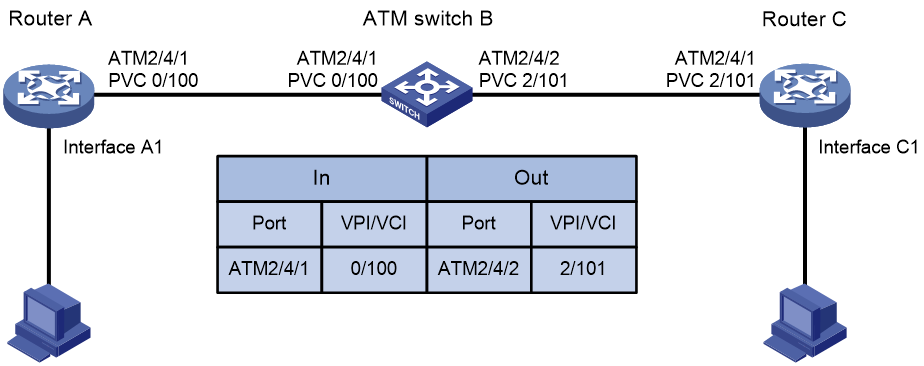

ATM interfaces support only manually created permanent virtual circuits (PVCs), not switched virtual circuits (SVCs) created through the exchange of signals. A PVC is identified by a VPI/VCI pair.
In an ATM network, an ATM switch forwards ATM cells by looking up the switching entries and changing the VPIs/VCIs. In PVC mode, the network administrator configures the switching entries and assigns VPIs/VCIs. Users can use the assigned VPIs/VCIs to configure the PVCs. If the ATM interfaces of two ATM devices are directly connected, they must be configured with the same VPIs/VCIs.
Figure 2 shows a typical ATM switching process:
1.     Router A forwards a cell through PVC 0/100 on interface ATM 2/4/1.
2.     ATM switch B receives the cell through PVC 0/100 on interface ATM 2/4/1.
3.     ATM switch B looks up its switching entries and forwards the cell through PVC 2/101 on interface ATM 2/4/2.
4.     Router C receives the cell through PVC 2/101 on interface ATM 2/4/1.
Figure 2 ATM switching

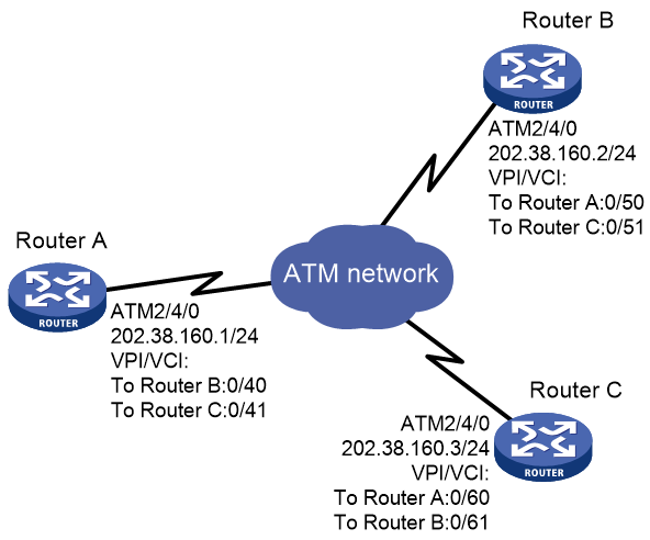

To enable the upper-layer protocols to find a remote device by its IP address, map the IP address of the remote device to the local PVC or PVC group.
To configure an IP mapping, use one of the following methods:
·     Static IP address mapping—Maps the IP address of the remote interface to the PVC or PVC group.
·     Default mapping—If a packet cannot find the mapping for the next hop address, the packet is transmitted through the PVC or PVC group configured with the default mapping.
·     InARP mapping—Uses Inverse Address Resolution Protocol (InARP) to resolve the IP address of the remote interface that is connected to the local PVC or PVC group. You do not need to configure a static IP address for the PVC or PVC group. Figure 4 shows the InARP working process. The IP addresses are the IP addresses of the ATM interfaces to which the PVC or PVC group belongs.
Figure 4 InARP working process
All encapsulation types support IPoA mapping, but only aal5snap supports InARP mapping. You cannot configure InARP mapping when aal5mux or aal5nlpid is used.
Multiple IP addresses can be mapped to the same PVC or PVC group. You can configure static IP mapping, default mapping, and InARP mapping at the same time. Different PVCs or PVC groups on the same interface cannot be mapped to the same IP address. The PVCs or PVC groups on the same interface can be configured with only one default mapping.
If the interfaces of two routers are connected back-to-back, the local PVC mapped to the remote IP address must have the same VPI/VCI value as the remote PVC mapped to the local IP address.

ATM configuration examples
Example: Configuring IPoA
As shown in Figure 5, Router A, B, and C are connected to the ATM network for intercommunication.
The IP addresses of the ATM interfaces of the three routers are 202.38.160.1/24, 202.38.160.2/24, and 202.38.160.3/24.
In the ATM network:
·     The VPIs/VCIs of Router A are 0/40 and 0/41, connected to Router B and Router C, respectively.
·     The VPIs/VCs of Router B are 0/50 and 0/51, connected to Router A and Router C, respectively.
·     The VPIs/VCIs of Router C are 0/60 and 0/61, connected to Router A and Router B, respectively.
All the PVCs on ATM interfaces of the three routers operate in IPoA application mode.
Figure 5 Network diagram
1.     Configure Router A:
# Enter the view of interface ATM 2/4/0 and configure an IP address for it.
<RouterA> system-view
[RouterA] interface atm 2/4/0
[RouterA-ATM2/4/0] ip address 202.38.160.1 255.255.255.0
# Create PVCs, and enable them to carry IP.
[RouterA-ATM2/4/0] pvc to_b 0/40
[RouterA-ATM2/4/0-pvc-to_b-0/40] map ip 202.38.160.2
[RouterA-ATM2/4/0-pvc-to_b-0/40] quit
[RouterA-ATM2/4/0] pvc to_c 0/41
[RouterA-ATM2/4/0-pvc-to_c-0/41] map ip 202.38.160.3
2.     Configure Router B:
<RouterB> system-view
[RouterB] interface atm 2/4/0
[RouterB-ATM2/4/0] ip address 202.38.160.2 255.255.255.0
[RouterB-ATM2/4/0] pvc to_a 0/50
[RouterB-ATM2/4/0-pvc-to_a-0/50] map ip 202.38.160.1
[RouterB-ATM2/4/0-pvc-to_a-0/50] quit
[RouterB-ATM2/4/0] pvc to_c 0/51
[RouterB-ATM2/4/0-pvc-to_c-0/51] map ip 202.38.160.3
3.     Configure Router C:
<RouterC> system-view
[RouterC] interface atm 2/4/0
[RouterC-ATM2/4/0] ip address 202.38.160.3 255.255.255.0
[RouterC-ATM2/4/0] pvc to_a 0/60
[RouterC-ATM2/4/0-pvc-to_a-0/60] map ip 202.38.160.1
[RouterC-ATM2/4/0-pvc-to_a-0/60] quit
[RouterC-ATM2/4/0] pvc to_b 0/61
[RouterC-ATM2/4/0-pvc-to_b-0/61] map ip 202.38.160.2
# Use the ping command to verify that the three routers can ping each other successfully. (Details not shown.)

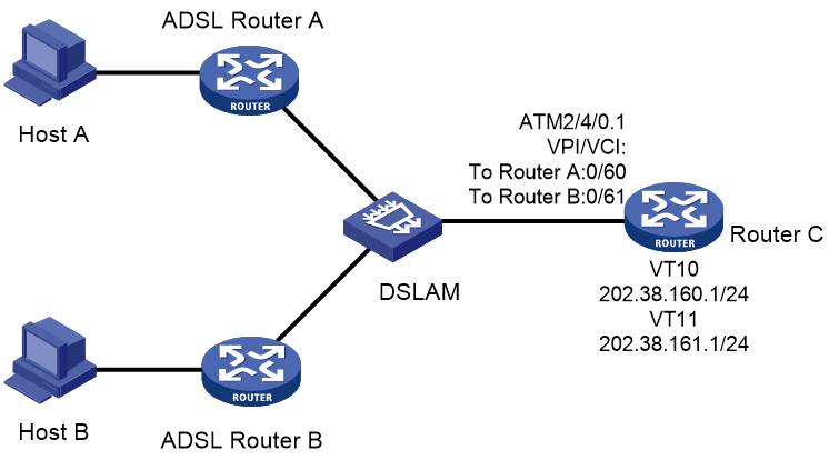

Example: Configuring IPoEoA
As shown in Figure 6, the hosts in the two Ethernets are connected to the ATM network through ADSL Router A and ADSL Router B. They communicate with Router C through DSLAM.
The IP address of the VEth interface of Router C is 202.38.160.1.
The VPI/VCI values of the two PVCs connecting Router C and DSLAM are 0/60 and 0/61, pointing to Router A and Router B, respectively.
Both the WAN port of Router C and the DSL interfaces of the ADSL routers use IPoEoA.
Figure 6 Network diagram
1.     Configure Router C:
# Create a VEth interface and configure an IP address for it.
[RouterC] interface virtual-ethernet 1
[RouterC-Virtual-Ethernet1] ip address 202.38.160.1 255.255.255.0
[RouterC-Virtual-Ethernet1] quit
# Create PVCs, and enable them to carry IPoE.
[RouterC] interface atm 2/4/0.1
[RouterC-ATM2/4/0.1] pvc to_adsl_a 0/60
[RouterC-ATM2/4/0.1-pvc-to_adsl_a-0/60] map bridge virtual-ethernet 1
[RouterC-ATM2/4/0.1-pvc-to_adsl_a-0/60] quit
[RouterC-ATM2/4/0.1] pvc to_adsl_b 0/61
[RouterC-ATM2/4/0.1-pvc-to_adsl_b-0/61] map bridge virtual-ethernet 1
2.     Configure ADSL Router A:
[RouterA] interface virtual-ethernet 1
[RouterA-Virtual-Ethernet1] ip address 202.38.160.2 255.255.255.0
[RouterA-Virtual-Ethernet1] quit
# Create a PVC and enable it to carry IPoE.
[RouterA] interface atm 2/4/0.1
[RouterA-ATM2/4/0.1] pvc to_c 0/60
[RouterA-ATM2/4/0.1-pvc-to_c-0/60] map bridge virtual-ethernet 1
3.     Configure ADSL Router B in the same way ADSL Router A is configured.
# Use the ping command to verify that both ADSL Router A and ADSL Router B can ping Router C successfully. (Details not shown.)

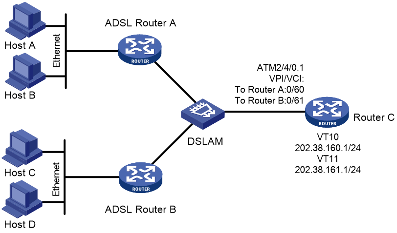

Example: Configuring PPPoA
As shown in Figure 7, two hosts dial into the ATM network each through an ADSL router, and communicate with Router C through DSLAM. This configuration example has the following requirements:
·     Create VT for multiuser on Router C, and configure PPP mapping on VT.
·     The VPI/VCI values of two PVCs connecting Router C and DSLAM are 0/60 and 0/61, pointing to ADSL Router A and ADSL Router B, respectively.
·     Both the WAN port of Router C and the DSL interfaces of the two ADSL routers use PPPoA. PPP authentication is not performed. The IP addresses of the two ADSL routers are assigned by Router C.
Figure 7 Network diagram
1.     Configure Router C (PPPoA server):
# Create VT interfaces and configure IP addresses for them. Assign IP addresses to the remote ends.
[RouterC] interface virtual-template 10
[RouterC-Virtual-Template10] ip address 202.38.160.1 255.255.255.0
[RouterC-Virtual-Template10] remote address 202.38.162.1
[RouterC-Virtual-Template10] quit
[RouterC] interface virtual-template 11
[RouterC-Virtual-Template11] ip address 202.38.161.1 255.255.255.0
[RouterC-Virtual-Template11] remote address 202.38.162.2
[RouterC-Virtual-Template11] quit
# Create PVCs, and enable them to carry PPP.
[RouterC-ATM2/4/0.1-pvc-to_adsl_a-0/60] map ppp virtual-template 10
[RouterC-ATM2/4/0.1-pvc-to_adsl_b-0/61] map ppp virtual-template 11
2.     Configure ADSL Router A (PPPoA client):
# Create a VT interface, and enable IP address negotiation.
[RouterA] interface virtual-template 0
[RouterA-Virtual-Template0] ip address ppp-negotiate
[RouterA-Virtual-Template0] quit
# Create a PVC, and enable it to carry PPP.
[RouterA-ATM2/4/0] pvc pppoa 0/60
[RouterA-ATM2/4/0-pvc-pppoa-0/60] map ppp virtual-template 0
[RouterA-ATM2/4/0-pvc-pppoa-0/60] quit
[RouterA-ATM2/4/0] quit
Both ADSL Router A and ADSL Router B can ping Router C successfully.

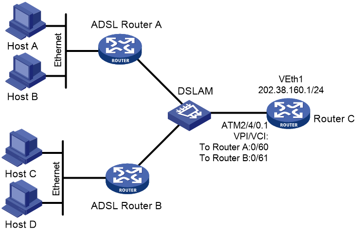

Example: Configuring PPPoEoA
As shown in Figure 8, the hosts in the two Ethernets are connected to the ATM network through ADSL Router A and ADSL Router B. They communicate with Router C through DSLAM.
The IP addresses of the VT interfaces of Router C are 202.38.160.1 and 202.38.161.1.
Both the WAN port of Router C and the DSL interfaces of the ADSL routers use PPPoEoA. PPP authentication is not performed. The IP addresses of the two ADSL routers are assigned by Router C.
Figure 8 Network diagram
1.     Configure Router C (PPPoEoA server):
# Create VEth interfaces, and enable them to carry PPP.
[RouterC-Virtual-Ethernet1] pppoe-server bind virtual-template 10
[RouterC] interface virtual-ethernet 2
[RouterC-Virtual-Ethernet2] pppoe-server bind virtual-template 11
[RouterC-Virtual-Ethernet2] quit
# Create PVCs, and enable them to carry PPPoE.
[RouterC-ATM2/4/0.1-pvc-to_adsl_b-0/61] map bridge virtual-ethernet 2
2.     Configure ADSL Router A (PPPoEoA client):
# Create dialer access group 1 and configure a dial access rule for it.
[RouterA] dialer-group 1 rule ip permit
# Create dialer interface Dialer 1 and enable bundle DDR on the interface.
[RouterA] interface dialer 1
[RouterA-Dialer1] dialer bundle enable
# Assign interface Dialer 1 to dialer access group 1.
[RouterA-Dialer1] dialer-group 1
# Configure the PPPoE client to operate in permanent online mode.
[RouterA-Dialer1] dialer timer idle 0
# Set the auto-dial interval of DDR to 1 second.
[RouterA-Dialer1] dialer timer autodial 1
# Enable IP address negotiation.
[RouterA-Dialer1] ip address ppp-negotiate
[RouterA-Dialer1] quit
# Create a VEth interface and enable it to carry PPP.
[RouterA] interface virtual-ethernet 2
[RouterA-Virtual-Ethernet2] pppoe-client dial-bundle-number 1
[RouterA-Virtual-Ethernet2] quit
# Create a PVC and enable it to carry PPPoE.
[RouterA-ATM2/4/0] pvc 0/60
[RouterA-ATM2/4/0-pvc-0/60] map bridge virtual-ethernet 2
