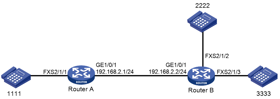

# As shown in Figure 1, after Telephone 2222 (the calling party) establishes a call with Telephone 1111, display control information for voice calls in progress.
Figure 1 Network diagram

# As shown in Figure 1, after Telephone 1111 (the calling party) establishes a call with Telephone 2222 and then Telephone 2222 presses hookflash to place the call on hold, display control information for voice calls in progress.
