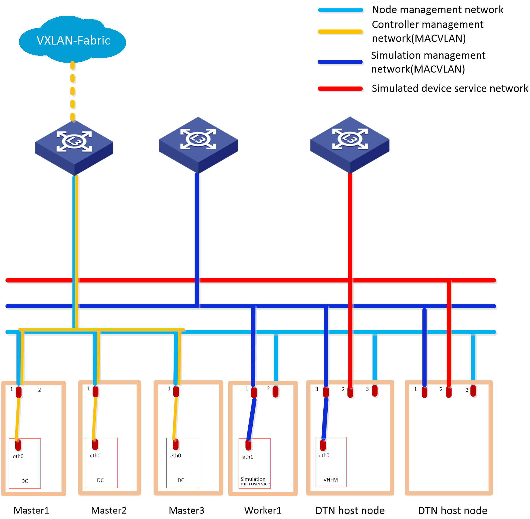

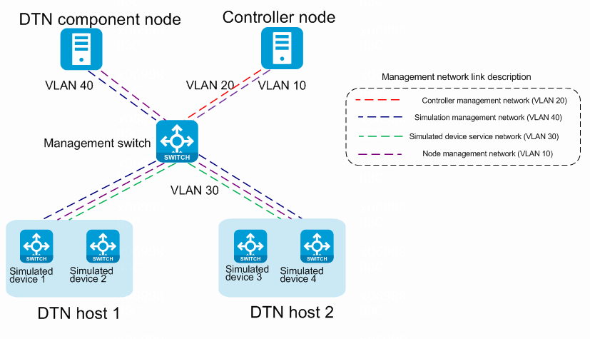

A simulation network includes four types of networks, including node management network, controller management network, simulation management network, and simulated device service network.
·     Node management networkNetwork over which you can log in to servers to perform routine maintenance.
·     Controller management networkNetwork for cluster communication between controllers and device management.
·     Simulation management networkNetwork over which the digital twin network (DTN) microservice component and DTN hosts exchange management information.
·     Simulated device service networkNetwork over which the DTN hosts exchange service data.
Before you deploy the simulation system, plan the simulation management network and simulated device service network.
Figure 1 Typical simulation network topology design for the Cloud DC scenario in non-remote disaster recovery mode
CAUTION
CAUTION:
·     If the controller management network and simulation management network use the same management switch, configure VLANs for isolation on the management switch to isolate the simulation network from the production network. If the controller management network uses the Layer 3 networking mode, you must also configure VPN instances for isolation on the management switch to prevent IP address conflicts from affecting the services. If the controller management network and simulation management network use different management switches, physically isolate these switches. For more information about Layer 3 network configuration, see "Configure the management networks."
·     Configure routes to provide Layer 3 connectivity between simulation management IPs and simulated device management IPs.
·     The simulated device service network of the DTN hosts needs to be reachable at Layer 2.

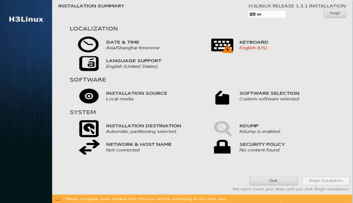

After the ISO image is loaded, the INSTALLATION SUMMARY page opens.
Figure 2 INSTALLATION SUMMARY page

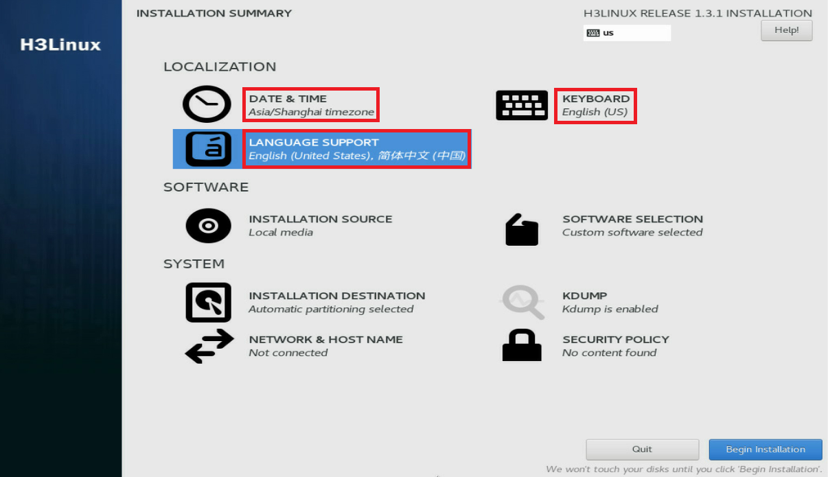

4.     In the LOCALIZATION area, perform the following steps:
¡     Click DATE & TIME to modify the date and time settings.
¡     Click KEYBOARD to modify keyboard settings as needed.
¡     Click LANGUAGE SUPPORT to select your preferred language.
IMPORTANT
IMPORTANT:
Make sure you select the same time zone across the hosts. In this document, [Asia/Shanghai] is selected for example.
Figure 3 INSTALLATION SUMMARY page

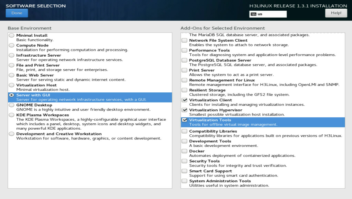

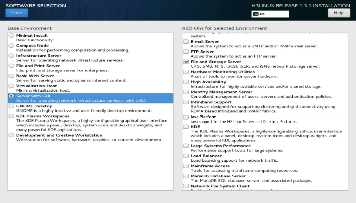

5.     Click SOFTWARE SELECTION in the SOFTWARE area to enter the page for selecting software. Select the Server with GUI base environment and the File and Storage Server, Virtualization Client, Virtualization Hypervisor, and Virtualization Tools add-ons. Then, click Done to return to the INSTALLATION SUMMARY page.
Figure 4 SOFTWARE SELECTION page (1)
Figure 5 SOFTWARE SELECTION page (2)

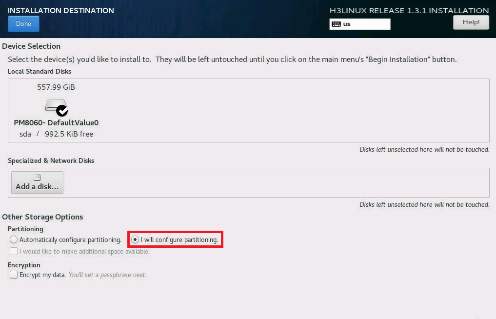

6.     In the SYSTEM area, click INSTALLATION DESTINATION.
Figure 6 INSTALLATION DESTINATION dialog box
7.     In the dialog box that opens, perform the following operations:
a.     Select a local disk from the Local Standard Disks area.
b.     In the Other Storage Options area, select I will configure partitioning.
c.     Click Done.

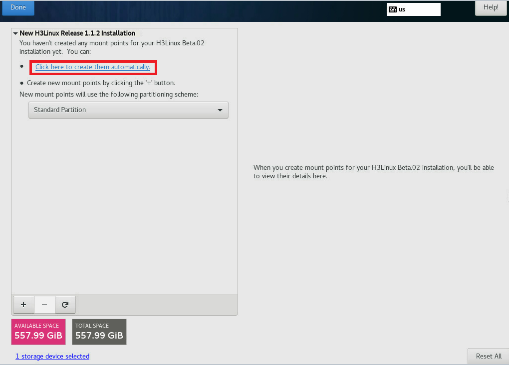

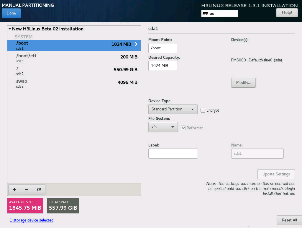

8.     In the MANUAL PARTITIONING dialog box, click Click here to create them automatically to automatically generate recommended partitions.
Figure 7 MANUAL PARTITIONING dialog box
The list of automatically created partitions opens. Figure 8 shows the list of automatically created partitions when the disk size is 600 GiB.
IMPORTANT
IMPORTANT:
The /boot/efi partition is available only if UEFI mode is enabled for OS installation.
Figure 8 Automatically created partition list
9.     Set the device type and file system of a partition. As a best practice, set the device type to Standard Partition to improve system stability. Table 6 shows the device type and file system of each partition used in this document.

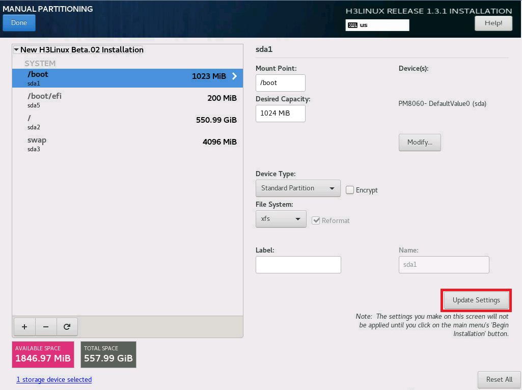

10.     Edit the device type and file system of a partition as shown in Figure 9. Take the /boot partition for example. Select a partition on the left, and select Standard Partition from the Device Type list and xfs from the File System list. Then, click Update Settings.
Figure 9 Configuring partitions

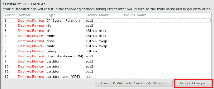

11.     After you finish the partitioning task, click Done in the upper left corner. In the dialog box that opens, select Accept Changes.
Figure 10 Accepting changes

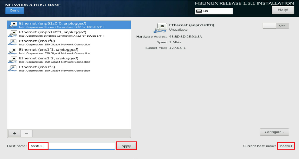

12.     In the INSTALLATION SUMMARY window that opens, click NETWORK & HOSTNAME in the SYSTEM area to configure the host name and network settings.
13.     In the Host name field, enter the host name for this server, and then click Apply.
Figure 11 Setting the host name

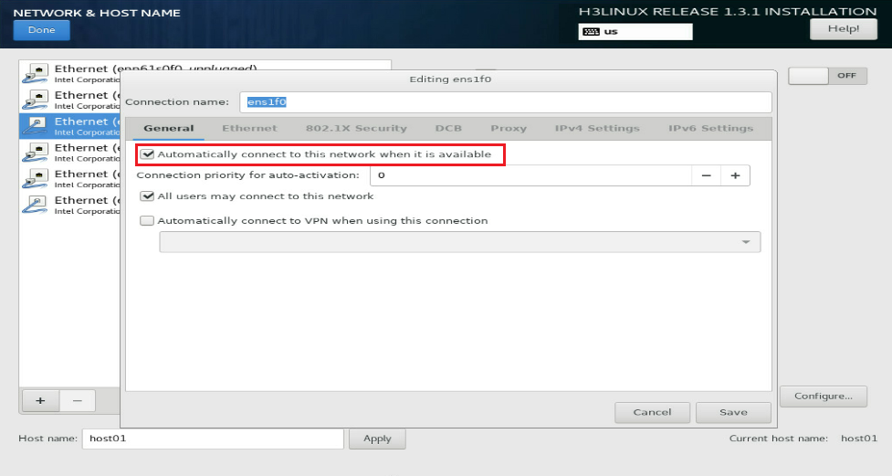

14.     Configure the network settings:
IMPORTANT
IMPORTANT:
Configure network ports as planned. The server requires a minimum of three network ports.
·     The network port IP for the simulation management network is used for communication with the DTN component.
·     The network port IP for the simulated device service network does not need to be configured with IP.
·     The network port IP for the node management network is used for routine maintenance of servers.
a.     Select a network port and then click Configure.
b.     In the dialog box that opens, configure basic network port settings on the General tab:
-     Select the Automatically connect to this network when it is available option .
-     Verify that the All users may connect to this network option is selected. By default, this option is selected.
Figure 12 General settings for a network port

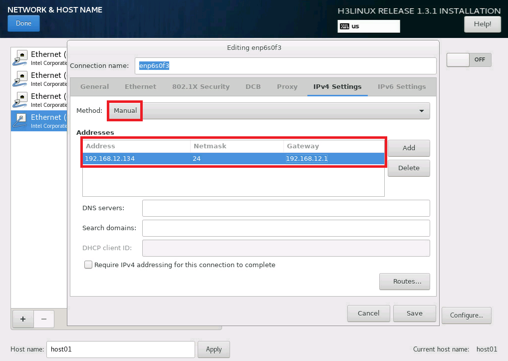

15.     Configure IP address settings:
a.     Click the IPv4 Settings or IPv6 Settings tab.
b.     From the Method list, select Manual.
c.     Click Add, assign a simulation management IP address to the DTN host, and then click Save.
d.     Click Done in the upper left corner of the dialog box.

DTN service supports IPv4 and IPv6. In the current software version, only a single stack is supported.
Figure 13 Configuring IPv4 address settings for a network port

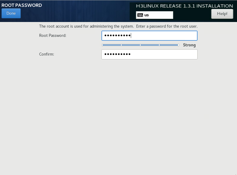

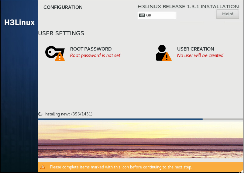

18.     During the installation, configure the root password as prompted:
IMPORTANT
IMPORTANT:
You must configure a root password before you can continue with the installation.
a.     In the USER SETTINGS area, click ROOT PASSWORD.
b.     In the dialog box that opens, set the root password for the system, and then click Done in the upper left corner.
Figure 14 Configuration window for H3Linux OS installation
Figure 15 Setting the root password
Then, the system automatically reboots to finish OS installation.

IMPORTANT:
IP addresses of simulated devices are the same as their twin devices on the product network. To avoid IP conflict, make sure the IP address of a DTN host on the simulation management network is different from the IP address of any simulated device.
Before you create bridges for the network ports connected to the simulation network, you must assign an IP address to the network port mapped to the mge_bridge bridge. The IP address is used for communication with the DTN microservice component and will be used when you add hosts to the simulation network.
Skip this section if you have assigned an IP address to the network port mapped to the mge_bridge bridge during OS installation, as described in "Install the operating system."
To configure IP address settings for the network port connected to the mge_bridge bridge:
1.     Open the /etc/sysconfig/network-scripts/ directory.
[root@host01 ~]# cd /etc/sysconfig/network-scripts/
2.     Press I to access the edit mode, configure IP settings, save the configuration, and then exit. This step uses network port ens1f0 for example.
[root@host01 network-scripts]# vi ifcfg-ens1f0
TYPE=Ethernet
PROXY_METHOD=none
BROWSER_ONLY=no
BOOTPROTO=none
DEFROUTE=yes
IPV4_FAILURE_FATAL=no
IPV6INIT=yes
IPV6_AUTOCONF=yes
IPV6_DEFROUTE=yes
IPV6_FAILURE_FATAL=no
IPV6_ADDR_GEN_MODE=stable-privacy
NAME=ens1f0
UUID=2e5b13dc-bd05-4d65-93c7-c0d9228e1b72
DEVICE=ens1f0
ONBOOT=yes
IPADDR=192.168.12.134
PREFIX=24
GATEWAY=192.168.12.1
IPV6_PRIVACY=no
3.     Restart the network service.
[root@host01 network-scripts]# service network restart
In this example, the controller management network, node management network, simulation management network, and simulated device service network share one switch to deploy the Layer 3 management networks for simulation.
Figure 1 Management network diagram
Table 8 IP planning for the simulation management network
Component/node name
IP address plan
Interfaces
DTN component
IP address: 192.168.15.133/24 (gateway address: 192.168.15.1)
Ten-GigabitEthernet 1/0/25, VLAN 40
DTN host 1
IP address: 192.168.12.134/24 (gateway address: 192.168.12.1, NIC: ens1f0)
Ten-GigabitEthernet 1/0/26, VLAN 40
DTN host 2
IP address: 192.168.12.135/24 (gateway address: 192.168.12.1, NIC: ens1f0)
Ten-GigabitEthernet 1/0/27, VLAN 40
Simulated device 1
IP address: 192.168.11.136/24 (gateway address: 192.168.11.1)
N/A
Simulated device 2
IP address: 192.168.11.137/24 (gateway address: 192.168.11.1)
N/A
Simulated device 3
IP address: 192.168.21.134/24 (gateway address: 192.168.21.1)
N/A
Simulated device 4
IP address: 192.168.21.135/24 (gateway address: 192.168.21.1)
N/A

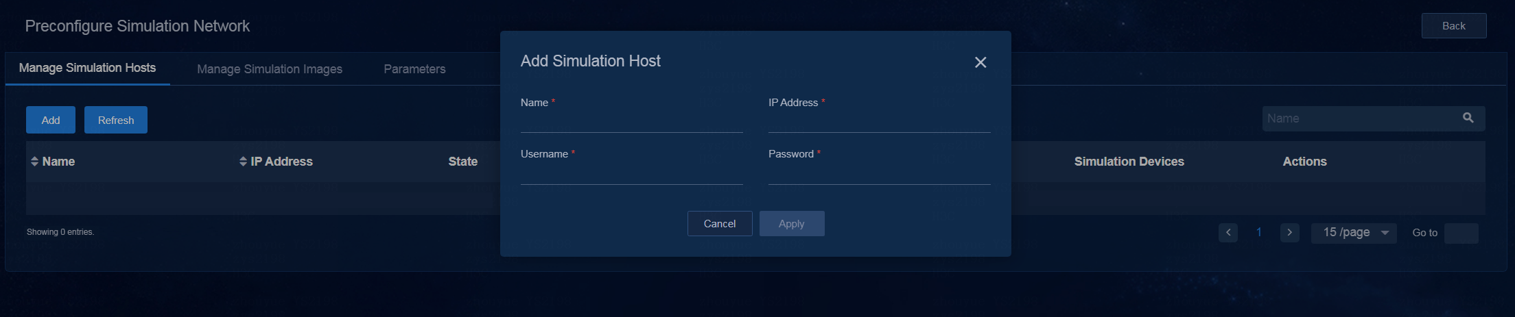

Add simulation hosts
1.     Log in to the controller. Navigate to the Automation > Data Center Networks > Simulation > Build Simulation Network page. Click Preconfigure. The Manage Simulation Hosts page opens.
2.     Click Add. In the dialog box that opens, configure the host name, IP address, username, and password.
Figure 2 Adding simulation hosts
3.     Click Apply.

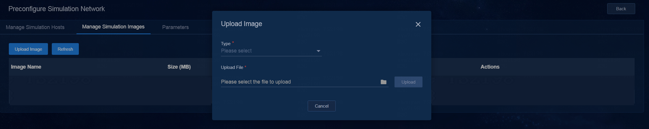

Upload simulation images
1.     Log in to the controller. Navigate to the Automation > Data Center Networks > Simulation > Build Simulation Network page. After clicking Preconfigure, click the Manage Simulation Images tab. The page for uploading simulation images opens.
2.     Click Upload Image. In the dialog box that opens, select the type of the image to be uploaded and image of the corresponding type, and then click Upload.
Figure 3 Uploading simulation images

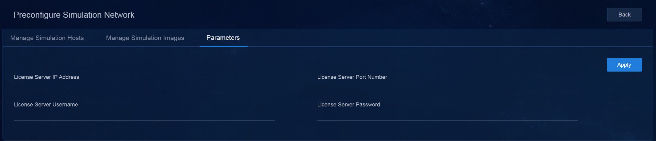

Configure parameters
Because the simulation network is isolated from the controller network, simulated devices cannot connect to the license server configured for the SeerEngine-DC controller. Therefore, you must separately deploy a license server for the simulated devices. The license server provides licensing services for simulated devices.
Deploy the license server on a simulation host
Obtain the license server installation package and upload it to the server where the DTN host resides. If there are multiple DTN hosts, upload the package to any server. For more information, see H3C License Server Installation Guide.
In the address bar of the browser, enter the Web login address for the license server in the format of https://lics_ipv4_address:port/licsmgr or https://[lics_ipv6_address]:port/licsmgr. In the Web login address, the lics_ipv4_address or lics_ipv6_address parameter specifies the management IP address of the DTN host node where the license server is deployed, and the port parameter specifies the HTTPS port for the Web login when the license server is deployed.
Configure license server-related parameters on the page
1.     Navigate to the Automation > Data Center Networks > Simulation > Build Simulation Network page. Click Preconfigure. On the page that opens, click the Parameters tab.
2.     Configure license server-related parameters on this tab.
Figure 4 Parameters page
3.     Click Apply.

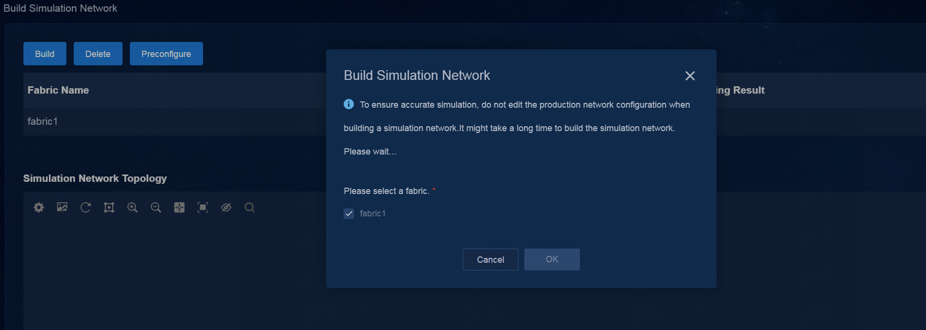

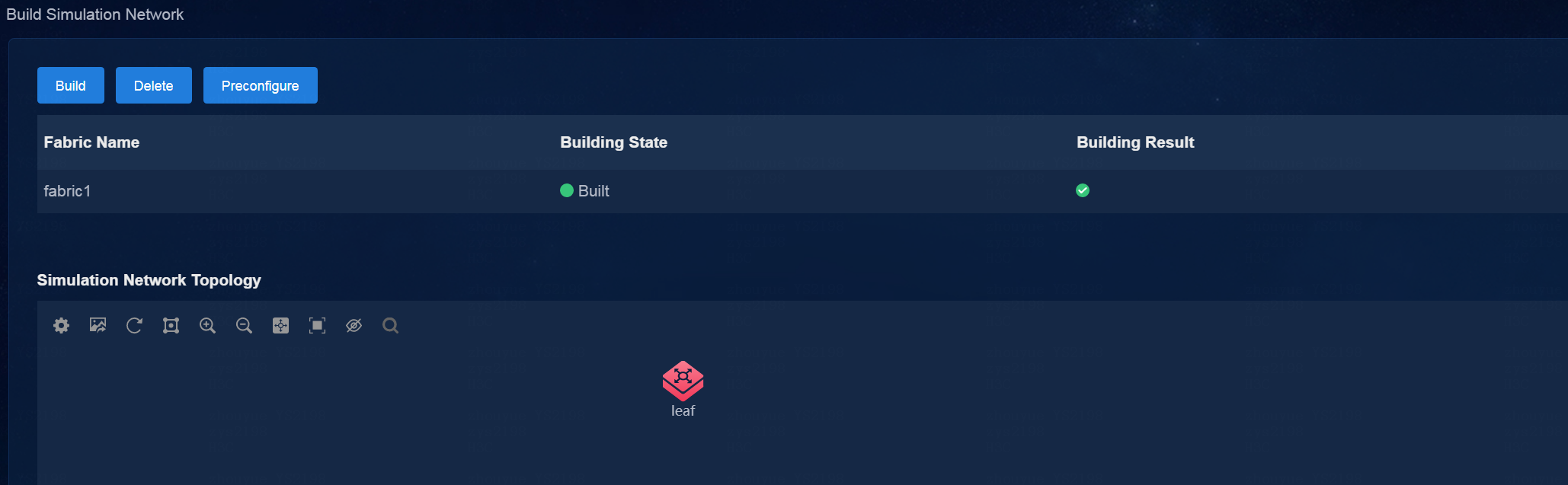

Follow these steps to build a simulation network:
Figure 5 Building a simulation network
2.     Click Build Simulation Network. In the dialog box that opens, select fabric1.
Figure 6 Selecting a fabric
3.     Click OK to start building a simulation network. In the current software version, you can build a simulation network for only one fabric. During the process of building a simulation network, you can view the building workflow and result.
Figure 7 Built a simulation network successfully

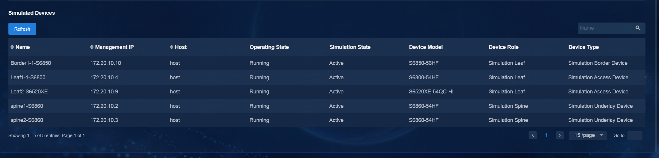

4.     After the simulation network is built successfully, you can view the simulated device information:
¡     The simulated state is Active.
¡     The device model is displayed correctly on the real network and the simulation network.
The VMs in the simulation network model are created on the host created. If multiple hosts are available, the controller selects a host with optimal resources for creating VMs.
Figure 8 Viewing simulated devices

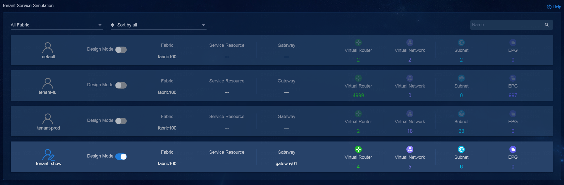

Enabling the design mode for the tenant
1.     Navigate to the Automation > Data Center Networks > Simulation > Tenant Service Simulation page. Click the design mode icon for a tenant to enable or disable design mode for the tenant. After design mode is enabled for a tenant, the tenant icon becomes , which means that the tenant is editable. After design mode is disabled for a tenant, the tenant icon becomes , which indicates that the tenant is not editable.
2.     Click the icon for the tenant to enter the Tenant Service Simulation (Tenant Name) > Logical Networks page. On this page, you can perform tenant service simulation.
You can enable the design mode and then perform tenant service simulation only when the simulation network is built normally.
Figure 9 Enabling the design mode for the tenant

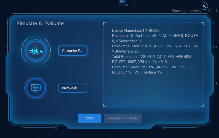

2.     After resources are configured, click Simulate & Evaluate to evaluate the simulation.
Evaluate the simulation and view the simulation result

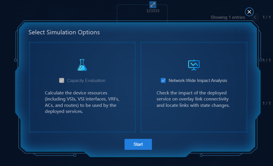

Simulate and evaluate services
Click Simulate & Evaluate. In the dialog box that opens, select Network-Wide Impact Analysis, and click Start. In the left area of the Simulate & Evaluate dialog box, the progress in percentage is displayed. In the right area, the corresponding resource changes are displayed.
Figure 11 Simulating and evaluating services (1)
Figure 12 Simulating and evaluating services (2)

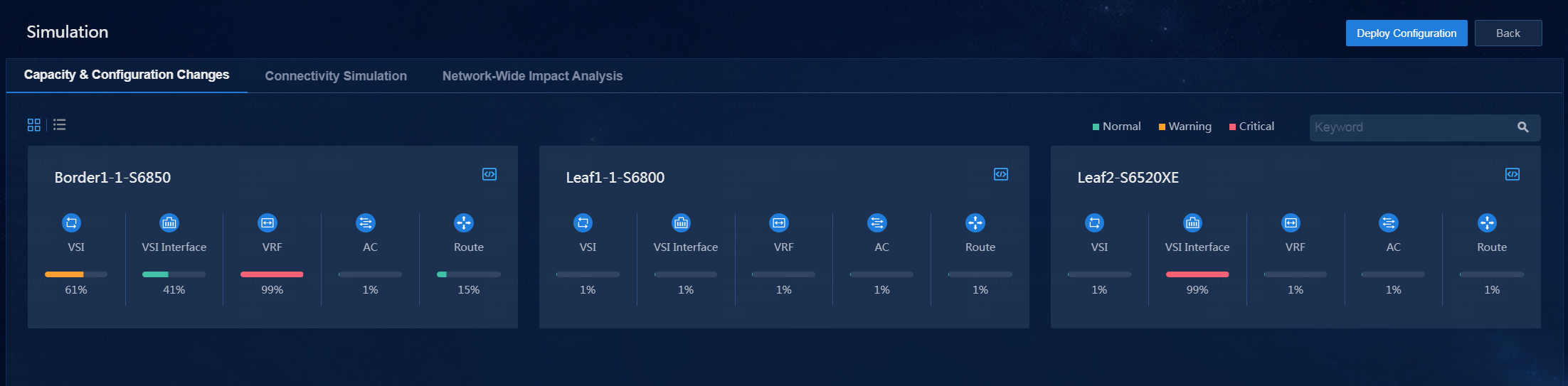

After simulation evaluation is completed, click Simulation Results to enter the simulation result page. On this page, you can view the following simulation results:
·     Capacity & Configuration Changes—This page displays resource usages and the configuration changes before and after simulation in a list or block diagrams.
Figure 13 Capacity and configuration changes

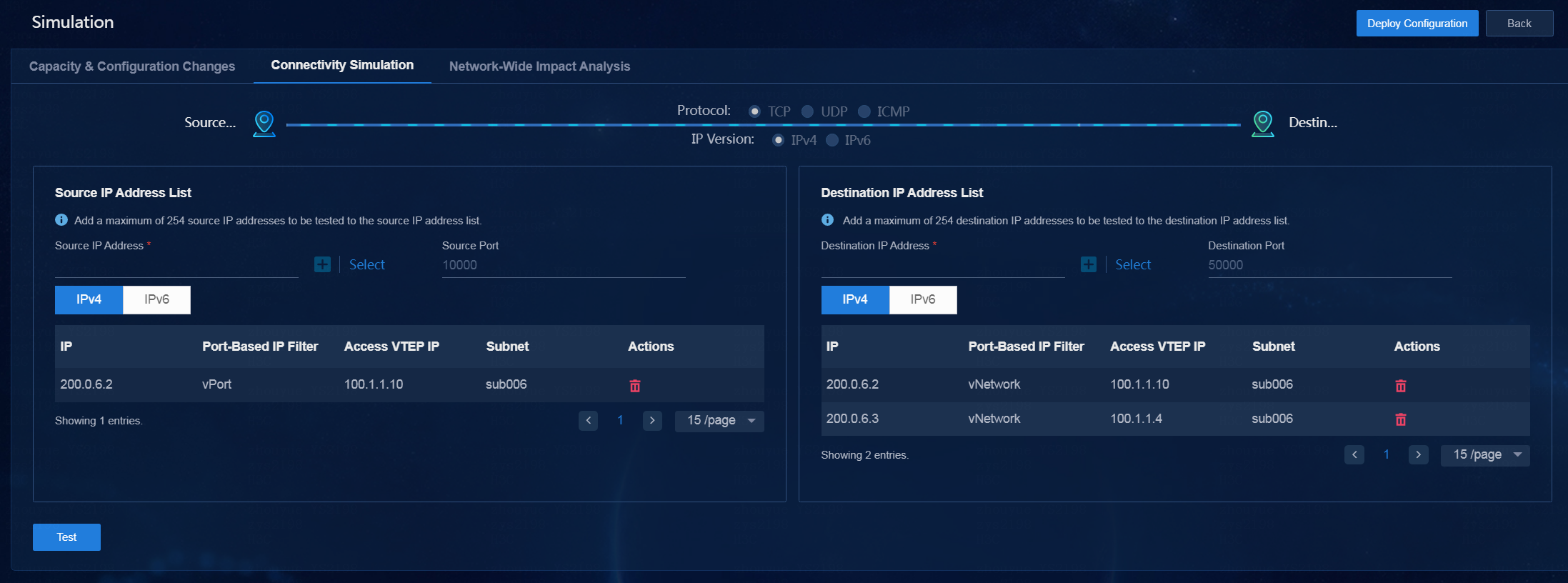

·     Connectivity Simulation—Perform this task to detect connectivity between source addresses and destination addresses. When specifying the source/destination addresses, you can input IP addresses or click Select and configure filter conditions in the dialog box that opens. Then, all the specified IP addresses are displayed on the source or destination IP address list. After completing the configuration, click Test to detect connectivity.
Figure 14 Connectivity detection

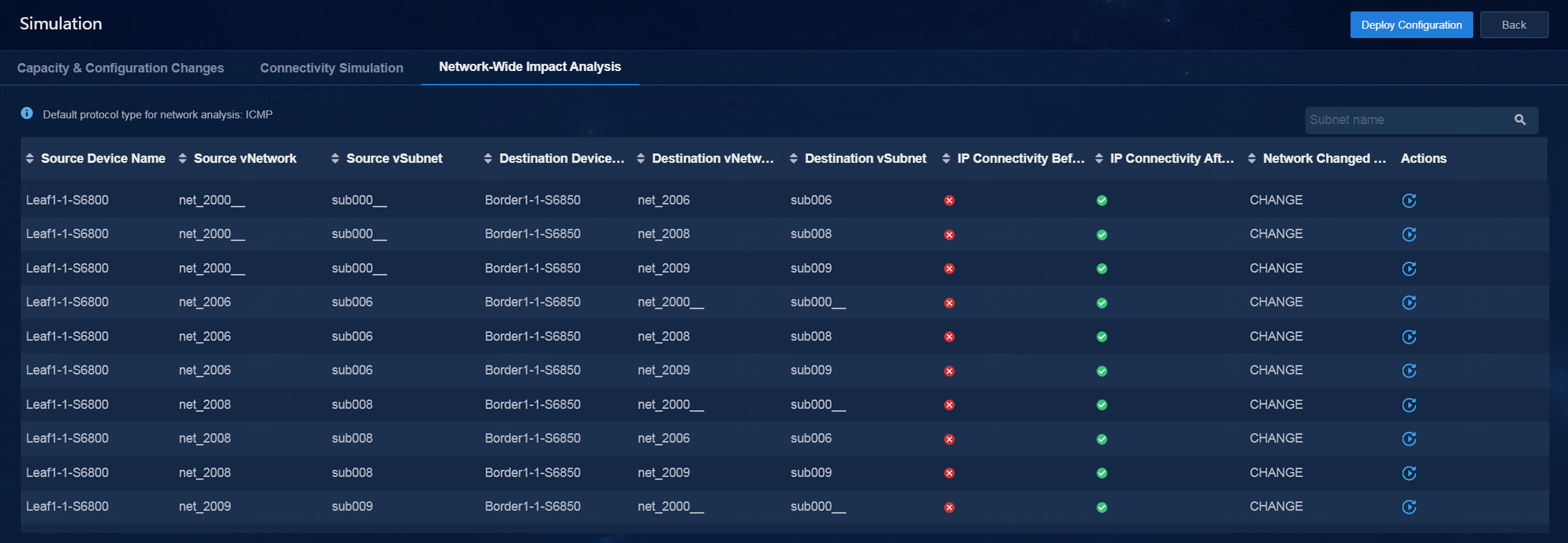

·     Network-Wide Impact Analysis—From this tab, you can view details of network information and perform a detection again. A single tenant supports performing network-wide impact analysis for up to 254 ports.
Figure 15 Network-wide impact analysis

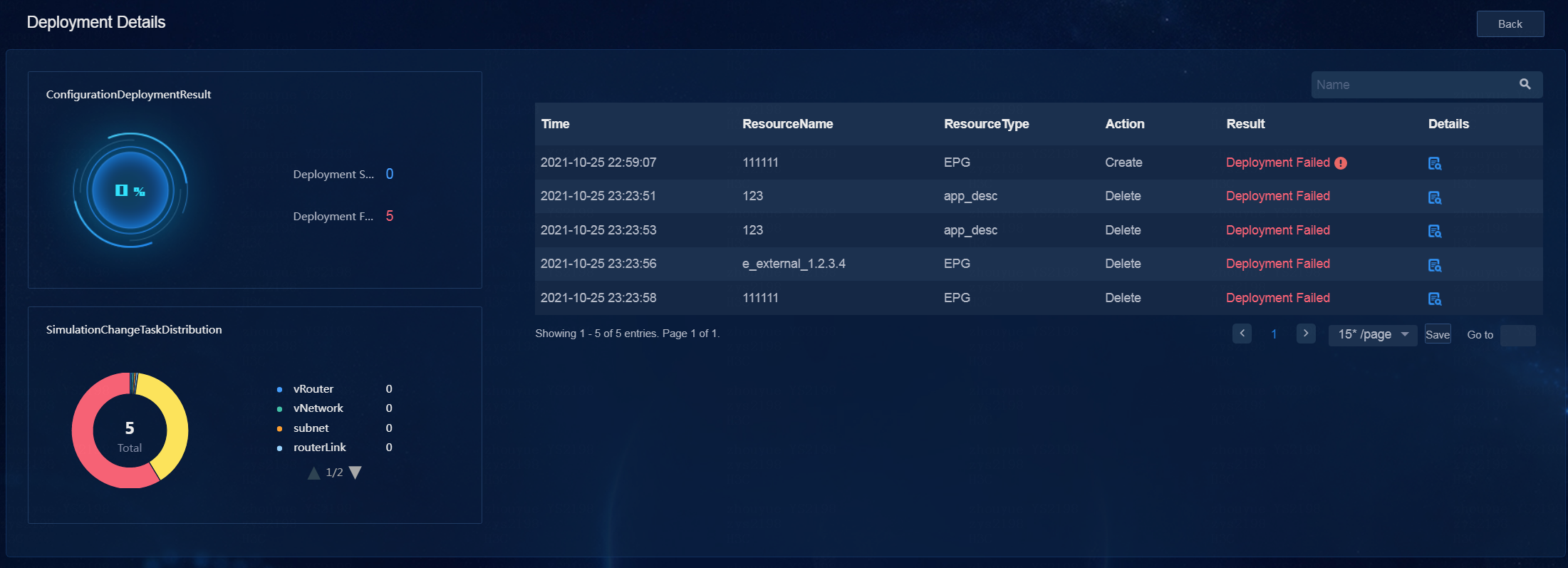

Deploy configuration and view deployment details
You can click Deploy Configuration to deploy the service configuration to real devices when the simulation evaluation result is as expected. Additionally, you can view details on the deployment details page.
Figure 16 Viewing deployment details

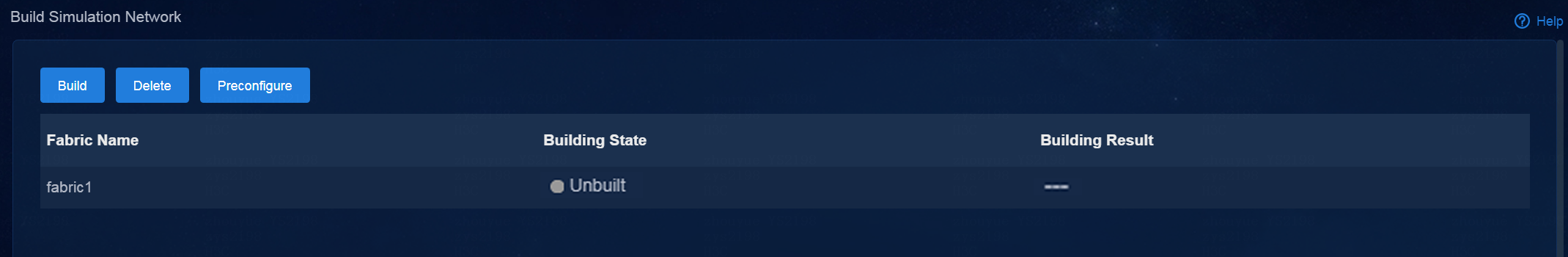

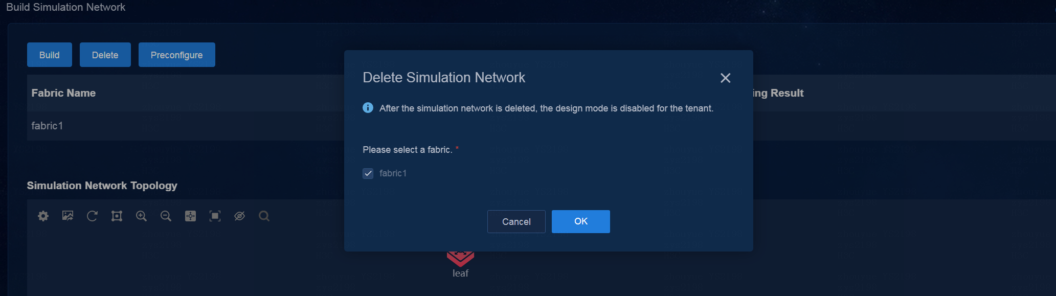

Delete a simulation network
2.     Click Delete. In the dialog box that opens, the fabric for which a simulation network has been built is selected by default.
Figure 17 Deleting a simulation network
3.     Click OK to start deleting the simulation network. When all operation results are displayed as Succeeded and the progress is 100%, the simulation network is deleted completely.
