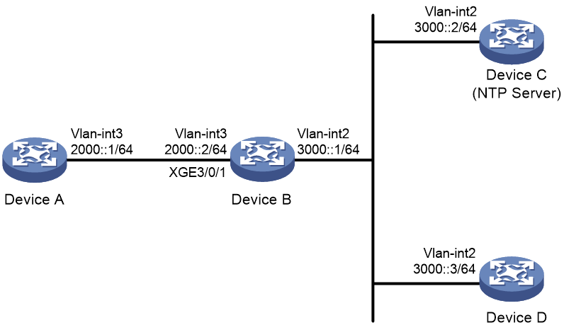

Example: Configuring the NTP client/server mode
As shown in Figure 1, configure the NTP client/server mode so all devices can be synchronized to Device A, the NTP server.

Procedures
Configuring Device A
# Assign an IP address to VLAN-interface 2.
<DeviceA> system-view
[DeviceA] interface Vlan-interface 2
[DeviceA-Vlan-interface2] ip address 1.0.1.11 24
[DeviceA-Vlan-interface2] quit
# Enable the NTP service.
[DeviceA] ntp-service enable
# Specify the local clock as the reference source, with the stratum level 2.
[DeviceA] ntp-service refclock-master 2
Configuring Device B
# Assign an IP address to VLAN-interface 2. (Details not shown.)
<DeviceB> system-view
[DeviceB] ntp-service enable
# Specify Device A as the NTP server of Device B so that Device B is synchronized to Device A.
[DeviceB] ntp-service unicast-server 1.0.1.11
Configuring Device C
<DeviceC> system-view
[DeviceC] ntp-service enable
# Specify Device A as the NTP server of Device C so that Device C is synchronized to Device A.
[DeviceC] ntp-service unicast-server 1.0.1.11
# Verify that Device B has synchronized to Device A, and the clock stratum level is 3 on Device B and 2 on Device A.
[DeviceB] display ntp-service status
 Clock status: synchronized
 Clock stratum: 3
 System peer: 1.0.1.11
 Local mode: client
 Reference clock ID: 1.0.1.11
 Leap indicator: 00
 NTP version: 4
 Clock jitter: 0.003479 s
 Stability: 0.000 pps
 Clock precision: 2^-17
 Root delay: 1.95313 ms
 Root dispersion: 28.38135 ms
 Reference time: d5ed8cd5.577006ea  Wed, Sep 25 2018 16:24:53.341
System poll interval: 8 s
The value of the Clock precision field varies by device model.
# Verify that an IPv4 NTP association has been established between Device B and Device A.
[DeviceB] display ntp-service sessions
        source          reference       stra reach poll  now offset  delay disper
[12345]1.0.1.11        127.127.1.0        2   255   64   38 -10.22 1.9531 3.3416
Notes: 1 source(master), 2 source(peer), 3 selected, 4 candidate, 5 configured.
 Total sessions: 1
Configuration files
·     Device A:
interface Vlan-interface2
 ip address 1.0.1.11 255.255.255.0
 ntp-service enable
·     Device B:
 ip address 1.0.1.12 255.255.255.0
 ntp-service enable
·     Device C:
 ip address 1.0.1.13 255.255.255.0
 ntp-service enable

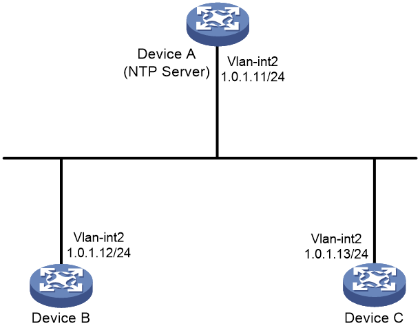

Example: Configuring the NTP broadcast mode
As shown in Figure 2, configure the NTP broadcast mode so all devices on the same network segment can be synchronized to Device C, the NTP server.

Procedures
[DeviceC] ntp-service refclock-master 2
[DeviceC] interface Vlan-interface 2
[DeviceC-Vlan-interface2] ip address 3.0.1.31 24
# Configure Device C to operate in broadcast server mode and send broadcast messages from VLAN-interface 2.
[DeviceC-Vlan-interface2] ntp-service broadcast-server
Configuring Device A, Device B, Device D, and Device E
# Configure Device A to operate in broadcast client mode and receive broadcast messages on VLAN-interface 2.
[DeviceA-Vlan-interface2] ntp-service broadcast-client
# Configure Device B, Device D, and Device E in the same way Device A is configured. (Details not shown.)
# Verify that Device A has synchronized to Device C, and the clock stratum level is 3 on Device A and 2 on Device C.
[DeviceA-Vlan-interface2] display ntp-service status
 Clock stratum: 3
 System peer: 3.0.1.31
 Local mode: bclient
 Reference clock ID: 3.0.1.31
 Leap indicator: 00
 NTP version: 4
 Clock jitter: 0.000061 s
 Root delay: 0.00000 ms
 Root dispersion: 7951.43127 ms
 Reference time: d5ee8d88.2faabed0  Thu, Sep 26 2018 10:40:08.186
# Verify that an IPv4 NTP association has been established between Device A and Device C.
[DeviceA-Vlan-interface2] display ntp-service sessions
 [1234]3.0.1.31        127.127.1.0        2   254   64   82 -2.190 0.0000 7937.5
 Total sessions: 1
Configuration files
·     Device C:
 ip address 3.0.1.31 255.255.255.0
 ntp-service enable
·     Device A:
 ip address 3.0.1.33 255.255.255.0
 ntp-service enable
·     Device B:
 ip address 3.0.1.30 255.255.255.0
 ntp-service enable
·     Device D:
 ip address 3.0.1.32 255.255.255.0
 ntp-service enable
·     Device E:
 ip address 3.0.1.34 255.255.255.0
 ntp-service enable

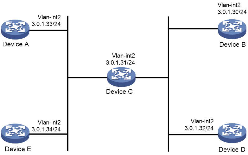

Example: Configuring the NTP multicast mode
As shown in Figure 3, configure the NTP multicast mode so all devices on different network segments can be synchronized to Device C, the NTP server.

Configure routing protocols on the devices and make sure the devices are reachable to each other. (Details not shown.)
Procedures
# Configure Device C to operate in multicast server mode and send multicast messages from VLAN-interface 2.
[DeviceC-Vlan-interface2] ntp-service multicast-server
Configuring Device D
<DeviceD> system-view
[DeviceD] ntp-service enable
[DeviceD] interface Vlan-interface 2
[DeviceD-Vlan-interface2] ip address 3.0.1.32 24
# Configure Device D to operate in multicast client mode and receive multicast messages on VLAN-interface 2.
[DeviceD-Vlan-interface2] ntp-service multicast-client
# Configure Device B to operate in multicast client mode and receive multicast messages on VLAN-interface 2.
[DeviceB-Vlan-interface2] ntp-service multicast-client
[DeviceB-Vlan-interface2] quit
Because Device A and Device C are on different subnets, you must enable the multicast functions on Device B before Device A can receive multicast messages from Device C.
# Enable IP multicast routing and IGMP.

Example: Configuring NTP client/server mode with authentication
As shown in Figure 4, configure the NTP client/server mode so all devices can be synchronized to Device A, the NTP server. Configure NTP authentication on Device A, Device B, and Device C.

Procedures
# Enable NTP authentication on Device A.
[DeviceA] ntp-service authentication enable
# Set an authentication key, and input the key in plain text.
[DeviceA] ntp-service authentication-keyid 42 authentication-mode md5 simple aNiceKey
# Specify the key as a trusted key.
[DeviceA] ntp-service reliable authentication-keyid 42

Example: Configuring SNTP
As shown in Figure 5, configure SNTP so all devices can be synchronized to Device A, the NTP server.

Procedures

Example: Configuring the IPv6 NTP client/server mode
As shown in Figure 1, configure the IPv6 NTP client/server mode so all devices can synchronize to Device A, the NTP server.

Procedures
# Assign an IPv6 address to VLAN-interface 2.
[DeviceA] interface vlan-interface 2
[DeviceA-Vlan-interface2] ipv6 address 3000::34 64

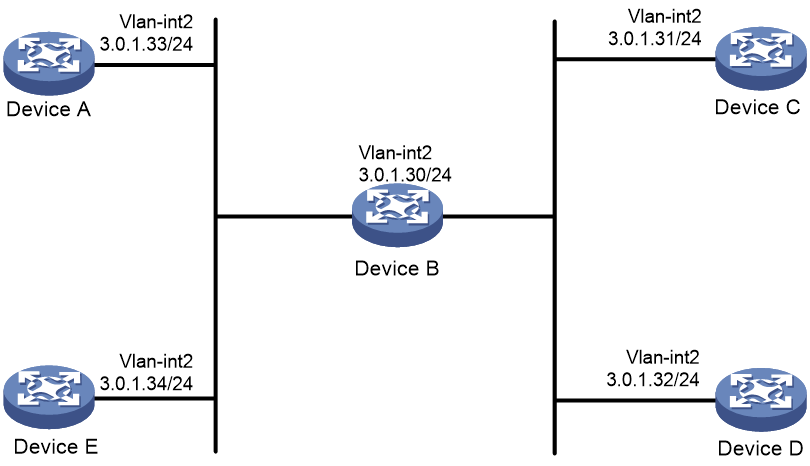

Example: Configuring the IPv6 NTP multicast mode
As shown in Figure 3, configure the IPv6 NTP multicast mode so all devices on different network segments can synchronize to Device C, the NTP server.
Procedures
[DeviceC-Vlan-interface2] ipv6 address 3000::2 64

Example: Configuring the NTP broadcast mode with authentication
As shown in Figure 4, configure NTP broadcast mode so all devices can synchronize to Device A, the NTP server. Configure NTP authentication on Device A, Device B, and Device C.
Figure 8 Network diagram
Hardware
Software version
S12500G-AF
Release 8053P05 and later
S12500CR
S10500X-G
Release 7753P05 and later
S7500X-G
Procedures
Configure Device C
# Specify the local clock as the reference source, with the stratum level 2 on Device C.
# Enable NTP authentication on Device C. Configure an NTP authentication key, with the key ID of 88 and key value of 123456. Input the key in plain text, and specify it as a trusted key.
[DeviceC] ntp-service authentication enable
[DeviceC] ntp-service authentication-keyid 88 authentication-mode md5 simple 123456
[DeviceC] ntp-service reliable authentication-keyid 88
# Specify Device C as an NTP broadcast server, and associate key 88 with Device C.
[DeviceC] interface vlan-interface 2
[DeviceC-Vlan-interface2] ntp-service broadcast-server authentication-keyid 88
[DeviceC-Vlan-interface2] quit
Configure Device A
# Enable NTP authentication on Device A. Configure an NTP authentication key, with the key ID of 88 and key value of 123456. Input the key in plain text, and specify it as a trusted key.
[DeviceA] ntp-service authentication-keyid 88 authentication-mode md5 simple 123456
[DeviceA] ntp-service reliable authentication-keyid 88
# Configure Device A to operate in NTP broadcast client mode and receive NTP broadcast messages on VLAN-interface 2.
[DeviceA-Vlan-interface2] ip address 3.0.1.33 24
[DeviceA] display ntp-service status
 Clock stratum: 3
 Local mode: bclient
 Leap indicator: 00
 NTP version: 4
 Clock jitter: 0.000092 s
 Root delay: 2.42615 ms
 Root dispersion: 1950.98877 ms
 Reference time: d5eed631.2f498d71  Thu, Sep 26 2018 15:50:09.184
