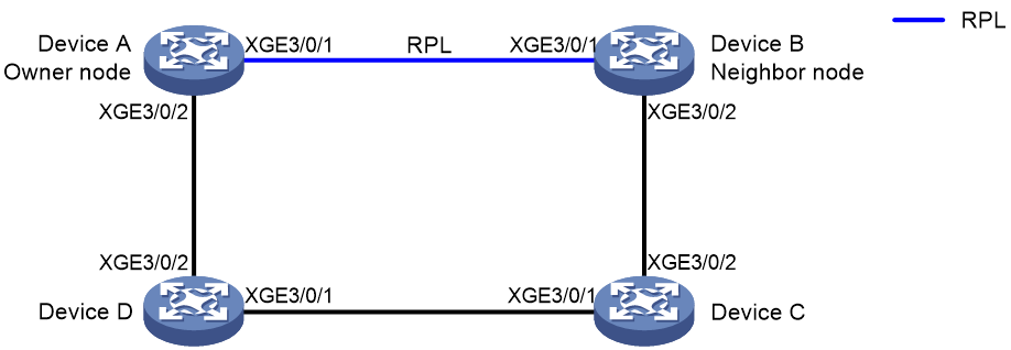

ERPS network diagrams
One major ring
The network has one major ring.
Figure 5 Network diagram
One major ring connecting one subring
The network has one major ring and one subring.
Figure 6 Network diagram

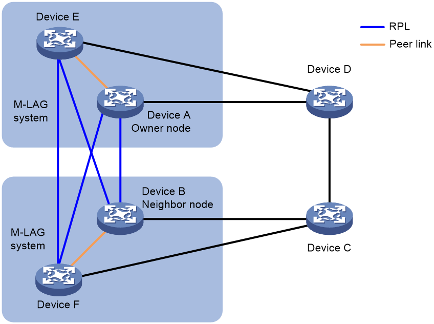

ERPS with M-LAG
M-LAG allows you to virtualize the devices in an ERPS ring into one system through multichassis link, thereby achieving device-level redundancy and load balancing.
You can use the display erps detail ring command to determine whether ERPS works correctly in a M-LAG network. For more information about M-LAG, see Layer 2—LAN Switching Configuration Guide.
Figure 11 ERPS with M-LAG
