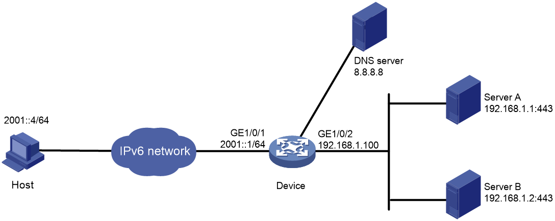

Working mechanism
Figure 1 shows the working mechanism.
Figure 1 HTTP proxy mechanism
1.     The IPv6 host obtains the IPv6 address corresponding to the requested domain name (the IPv6 address of the HTTP proxy service configured on the device) through the DNS server. The IPv6 host sends an HTTP or HTTPS GET request to the device.
2.     The device checks whether the URL of the request contains the domain name of the HTTP proxy service:
¡     If yes, the device strips the domain name from the URL and restores the URL of the request to the original URL.
¡     If not, the device re-encapsulates the HTTP or HTTPS GET request.
3.     The device sends the request to the IPv4 Web server. If the IPv4 Web server is an external Web server, a DNS server is required on the device to resolve URL of the IPv4 Web server to an IPv4 address.
4.     The IPv4 Web server sends an HTTP or HTTPS response to the device. The devices checks whether the response contains external media links or hyperlinks:
¡     If yes, the device adds the domain name of the HTTP proxy service to the URL of the response. In this way, the IPv6 host can send the HTTP or HTTPS request to the device when it accesses the IPv4 Web server again.
¡     If not, the device re-encapsulates the HTTP or HTTPS response.
5.     The device sends the HTTP or HTTPS response to the IPv6 host.

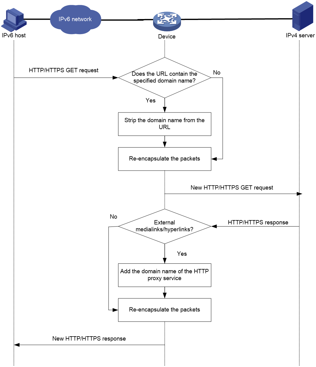

External link proxy
Figure 2 shows the mechanism of external link proxy when an IPv6 user accesses external media links or hyperlinks on webpages of the IPv4 Web server.
Figure 2 External link proxy mechanism
1.     When the device receives an HTTP or HTTPS response from the IPv4 Web server, it adds the domain name specified for the HTTP proxy service to the URL of the response.
2.     When the IPv6 user accesses the IPv4 Web server again, the DNS server resolves domain name contained in the URL of the Web request to the IPv6 address of the HTTP proxy service. The IPv6 user sends an HTTP or HTTPS GET request for accessing an external link to the device.
3.     Upon receiving the GET request, the device strips the domain name from the URL of the request.
4.     The device resolves the domain name to the IPv4 address of the GET request.
5.     The device re-encapsulates the GET request and sends it to the external IPv4 Web server.
6.     The external IPv4 Web server sends the HTTP or HTTPS response to the device.
7.     The device re-encapsulates the response and sends it the IPv6 host.

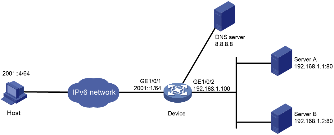

Example: Configuring HTTP-based HTTP proxy
As shown in Figure 3, configure HTTP-based HTTP proxy on the device to establish a connection between an IPv6 host and IPv4 Web servers.
·     Specify domain name test.gov.cn for the HTTP proxy service and specify 2001::1/64 as the IPv6 address of the HTTP proxy service.
·     Add external hyperlink www.hyperlink.org to be proxied by the HTTP proxy service and enable the external media link proxy feature.
·     Specify the DNS server with IP address 8.8.8.8 for the HTTP proxy service.
·     Enable the HTTP proxy operation recording.
Figure 3 Network diagram
Assign IP addresses and subnet mask to interfaces. (Details not shown.)
Make sure the domain name test.gov.cn of the HTTP proxy service can be resolved into IPv6 address 2001::1/64.

Example: Configuring HTTPS-based HTTP proxy
As shown in Figure 3, configure HTTPS-based HTTP proxy on the device to establish a connection between an IPv6 host and IPv4 Web servers.
Figure 4 Network diagram
Make sure the domain name test.gov.cn of the HTTP proxy service can be resolved into the IPv6 address 2001::1/64.

HTTP proxy configuration examples (in IRF mode)
Figure 5 Network diagram

2.     Configure a Web server group:
# Create Web server group httpsback and enter its view.
<Device> system-view
[Device] http-proxy server-group httpsback
# Add the Web server with IP address 192.168.1.1 and port number 443 to Web server group httpsback.
[Device-http-proxy-server-group-httpsback] ip-address 192.168.1.1 port 443
# Add the Web server with IP address 192.168.1.2 and port number 443 to Web server group httpsback.
[Device-http-proxy-server-group-httpsback] ip-address 192.168.1.2 port 443
# Specify HTTPS as the protocol type of Web server group httpsback.
[Device-http-proxy-server-group-httpsback] protocol-type https
[Device-http-proxy-server-group-httpsback] quit
3.     Configure an HTTP proxy service:
# Create HTTP proxy service proxyservice and enter its view.
[Device] http-proxy service proxyservice slot 1
# Specify HTTP as the protocol type of HTTP proxy service proxyservice and bind Web server group httpsback to the HTTP proxy service.
[Device-http-proxy-proxyservice-slot1] protocol-type https server-group httpsback
# Specify the SSL certificate file cert.pem for HTTP proxy service proxyservice.
[Device-http-proxy-proxyservice-slot1] ssl certificate file slot1#flash:/cert.pem
# Specify the SSL certificate key file cert.key for HTTP proxy service proxyservice.
[Device-http-proxy-proxyservice-slot1] ssl certificate key-file slot1#flash:/cert.key
# Specify DNS server at 8.8.8.8 for HTTP proxy service proxyservice.
[Device-http-proxy-proxyservice-slot1] dns-server 8.8.8.8
# Specify domain name test.gov.cn for HTTP proxy service proxyservice.
[Device-http-proxy-proxyservice-slot1] domain-name test.gov.cn
# Specify 2001::1 as the IPv6 address of HTTP proxy service proxyservice.
[Device-http-proxy-proxyservice-slot1] ipv6-address 2001::1
# Enable the external media link proxy feature for HTTP proxy service proxyservice.
[Device-http-proxy-proxyservice-slot1] medialink-proxy enable
# Specify external hyperlink www.hyperlink.org to be proxied by HTTP proxy service proxyservice.
[Device-http-proxy-proxyservice-slot1] hyperlink-proxy www.hyperlink.org
# Configure a source IP pool that contains IP addresses 192.168.1.10 to 192.168.1.20 for HTTP proxy service proxyservice.
[Device-http-proxy-proxyservice-slot1] ip-pool 192.168.1.10 192.168.1.20
# Enable the HTTP proxy operation recording and specify directory slot1#flash:/httpproxy/20191010.log for saving the HTTP proxy operation recording file.
[Device-http-proxy-proxyservice-slot1] access-record enable file-path slot1#flash:/httpproxy/20191010.log
4.     Enable the HTTP proxy service.
[Device-http-proxy-proxyservice-slot1] service enable
[Device-http-proxy-proxyservice-slot1] quit
[Device] quit
# Display the configuration information about Web server group httpsback.
<Device> display http-proxy server-group
Server group name: httpsback
  Protocol type:                  https
  Server IP addresses:  192.168.1.1:443
                        192.168.1.2:443
The output shows that the Web server group httpsback is configured with the correct protocol type and IPv4 Web servers have been added to the Web server group.
# Display the configuration information about HTTP proxy service proxyservice.
<Device> display http-proxy service proxyservice
Service name: proxyservice
  IPv6 address:                    2001::1
  Domain name:                     test.gov.cn
  Protocol types:                  HTTPS  [Server group: httpsback]
  SSL certificate file:            slot1#flash:/cert.pem
  SSL certificate key-file:        slot1#flash:/cert.key
  Hyperlink proxy strings:         www.hyperlink.org
  DNS server:                      8.8.8.8
  IP pools:                        192.168.1.10 to 192.168.1.20
  Medialink proxy:                 Enabled
  HTTP proxy operation recording:  Enabled
    Operation record file path:    slot1#flash:/httpproxy/20191010.log
  HTTP proxy status:               Enabled
The output shows that the HTTP proxy service proxyservice is configured with correct parameters and has been enabled.
# Display the content of the HTTP proxy operation recording file generated by HTTP proxy service proxyservice.
<Device> more slot1#flash:/httpproxy/20191010.log
[03/Dec/2019:16:11:35 +0800]  Client=2001::4  URL=https://test.gov.cn/sert.jpg  Server=192.168.1.1:443
[03/Dec/2019:16:11:35 +0800]  Client=2001::4  URL=https://test.gov.cn/config.js  Server=192.168.1.1:443
[03/Dec/2019:16:11:36 +0800]  Client=2001::4  URL=https://test.gov.cn/config.js  Server=192.168.1.2:443
[03/Dec/2019:16:11:36 +0800]  Client=2001::4  URL=https://test.gov.cn/sert.jpg  Server=192.168.1.2:443
The output shows the following:
·     The IPv6 host can access the IPv4 Web servers proxied by the HTTP proxy service and the proxy information is correctly recorded in the file, indicating that the HTTP proxy service has taken effect.
·     The requests to access the same URL are distributed to different Web servers, indicating that the two Web servers load balance the traffic.
