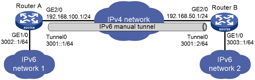

IPv6 over IPv4 manual tunneling
An IPv6 over IPv4 manual tunnel is a point-to-point link. To establish a manual tunnel, you must manually configure the source and destination addresses of the tunnel at both ends of the tunnel.
Manual tunneling provides the following solutions:
·     Connects isolated IPv6 networks over an IPv4 network.
·     Connects an IPv6 network and an IPv4/IPv6 dual-stack host over an IPv4 network.

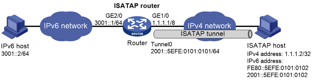

ISATAP tunneling
An ISATAP tunnel is a point-to-multipoint automatic tunnel. It provides a solution to connect an IPv6 host and an IPv6 network over an IPv4 network.
The destination address of an ISATAP tunnel is an ISATAP address. The address format is prefix:0:5EFE:abcd:efgh/64.
·     The 64-bit prefix is a valid IPv6 unicast address prefix.
·     The abcd:efgh/64 segments represent a 32-bit IPv4 address in hexadecimal notation, which identifies the tunnel destination but does not require global uniqueness.
ISATAP tunnels are mainly used for communication between IPv6 routers or between an IPv6 host and an IPv6 router over an IPv4 network.
Figure 3 Principle of ISATAP tunneling

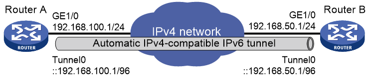

Example: Configuring an automatic IPv4-compatible IPv6 tunnel
As shown in Figure 5, dual-stack devices Router A and Router B communicate over an IPv4 network. Configure an automatic IPv4-compatible IPv6 tunnel between Router A and Router B to enable IPv6 communications over the IPv4 network.
Figure 5 Network diagram
Make sure Router A and Router B can reach each other through IPv4.

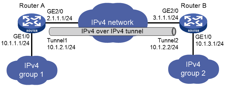

IPv4 over IPv4 tunneling
About IPv4 over IPv4 tunneling
IPv4 over IPv4 tunneling (RFC 1853) enables isolated IPv4 networks to communicate. For example, an IPv4 over IPv4 tunnel can connect isolated private IPv4 networks over a public IPv4 network.
Figure 9 IPv4 over IPv4 tunnel
Figure 9 shows the encapsulation and de-encapsulation processes.
·     Encapsulation:
a.     Device A receives an IP packet from an IPv4 host and submits it to the IP protocol stack.
b.     The IPv4 protocol stack determines how to forward the packet according to the destination address in the IP header. If the packet is destined for the IPv4 host connected to Device B, Device A delivers the packet to the tunnel interface.
c.     The tunnel interface adds a new IPv4 header to the IPv4 packet and submits it to the IP protocol stack.
In the new header, the source IP address specifies the tunnel source, and the destination IP address specifies the tunnel destination.
d.     The IP protocol stack uses the destination IP address of the new IP header to look up the routing table, and then sends the packet out.
·     De-encapsulation:
a.     After receiving the packet, Device B delivers it to the IP protocol stack.
b.     If the protocol number is 4 (indicating an IPv4 packet is encapsulated within the packet), the IP protocol stack delivers the packet to the tunnel module for de-encapsulation.
c.     The tunnel module de-encapsulates the IP packet and sends it back to the IP protocol stack.
d.     The protocol stack forwards the de-encapsulated packet.

IPv4 over IPv4 tunnel configuration examples
Example: Configuring an IPv4 over IPv4 tunnel
As shown in Figure 10, the two subnets IPv4 group 1 and IPv4 group 2 use private IPv4 addresses. Configure an IPv4 over IPv4 tunnel between Router A and Router B to make the two subnets reachable to each other.
Figure 10 Network diagram
1.     Configure Router A:
# Specify an IPv4 address for GigabitEthernet 1/0.
<RouterA> system-view
[RouterA] interface gigabitethernet 1/0
[RouterA-GigabitEthernet1/0] ip address 10.1.1.1 255.255.255.0
[RouterA-GigabitEthernet1/0] quit
# Specify an IPv4 address for GigabitEthernet 2/0, which is the physical interface of the tunnel.
[RouterA] interface gigabitethernet 2/0
[RouterA-GigabitEthernet2/0] ip address 2.1.1.1 255.255.255.0
[RouterA-GigabitEthernet2/0] quit
# Create IPv4 over IPv4 tunnel interface Tunnel 1.
[RouterA] interface tunnel 1 mode ipv4-ipv4
# Specify an IPv4 address for the tunnel interface.
[RouterA-Tunnel1] ip address 10.1.2.1 255.255.255.0
# Specify the IP address of GigabitEthernet 2/0 as the source address of the tunnel.
[RouterA-Tunnel1] source 2.1.1.1
# Specify the IP address of GigabitEthernet 2/0 on Router B as the destination address of the tunnel.
[RouterA-Tunnel1] destination 3.1.1.1
[RouterA-Tunnel1] quit
# Configure a static route destined for IPv4 group 2 through the tunnel.
[RouterA] ip route-static 10.1.3.0 255.255.255.0 tunnel 1
2.     Configure Router B:
<RouterB> system-view
[RouterB] interface gigabitethernet 1/0
[RouterB-GigabitEthernet1/0] ip address 10.1.3.1 255.255.255.0
[RouterB-GigabitEthernet1/0] quit
[RouterB] interface gigabitethernet 2/0
[RouterB-GigabitEthernet2/0] ip address 3.1.1.1 255.255.255.0
[RouterB-GigabitEthernet2/0] quit
# Create IPv4 over IPv4 tunnel interface Tunnel 2.
[RouterB] interface tunnel 2 mode ipv4-ipv4
[RouterB-Tunnel2] ip address 10.1.2.2 255.255.255.0
[RouterB-Tunnel2] source 3.1.1.1
# Specify the IP address of GigabitEthernet 2/0 on Router A as the destination address of the tunnel.
[RouterB-Tunnel2] destination 2.1.1.1
[RouterB-Tunnel2] quit
# Configure a static route destined for IPv4 group 1 through the tunnel.
[RouterB] ip route-static 10.1.1.0 255.255.255.0 tunnel 2
# Use the display interface tunnel command to display the status of the tunnel interfaces on Router A and Router B. Verify that the tunnel interfaces are up. (Details not shown.)
# Verify that Router A and Router B can ping the IPv4 address of the peer interface GigabitEthernet 1/0. This example uses Router A.
[RouterA] ping -a 10.1.1.1 10.1.3.1
Ping 10.1.3.1 (10.1.3.1) from 10.1.1.1: 56 data bytes, press CTRL_C to break
56 bytes from 10.1.3.1: icmp_seq=0 ttl=255 time=2.000 ms
56 bytes from 10.1.3.1: icmp_seq=1 ttl=255 time=1.000 ms
56 bytes from 10.1.3.1: icmp_seq=2 ttl=255 time=0.000 ms
56 bytes from 10.1.3.1: icmp_seq=3 ttl=255 time=1.000 ms
56 bytes from 10.1.3.1: icmp_seq=4 ttl=255 time=1.000 ms
--- Ping statistics for 10.1.3.1 ---
round-trip min/avg/max/std-dev = 0.000/1.000/2.000/0.632 ms

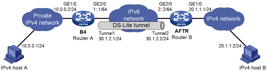

DS-Lite tunnel
Dual Stack Lite (DS-Lite) is a combination of the tunneling and NAT technologies. NAT translates the private IPv4 addresses of the IPv4 hosts before the hosts reach the IPv4 public network.
DS-Lite tunnel supports only an IPv4 host in a private network initiating communication with an IPv4 host on the Internet. It does not support an IPv4 host on the Internet initiating communication with an IPv4 host in a private network.
Figure 12 DS-Lite tunnel
As shown in Figure 12, the DS-Lite feature contains the following components:
·     Basic Bridging BroadBand (B4) element
The B4 element is typically a CPE router that connects end hosts. IPv4 packets entering the B4 router are encapsulated into IPv6 packets and sent to the AFTR. IPv6 packets from the AFTR are de-encapsulated into IPv4 packets and sent to the subscriber's network.
Hosts that can act as the B4 router are referred to as DS-Lite hosts.
·     Address Family Transition Router (AFTR)
An AFTR resides in the ISP network and terminates the tunnel from the B4 router. NAT is also implemented on the interface that is connected to the public IPv4 network.
An AFTR de-encapsulates the tunneled packet, translates the network address, and routes the packet to the destination IPv4 network. For IPv4 packets coming from the public IPv4 network, the AFTR performs reverse address translation and sends them to the B4 router by using the DS-Lite tunnel.
Figure 13 Packet forwarding process in DS-Lite
As shown in Figure 13, the packet forwarding process in DS-Lite is as follows:
1.     Upon receiving a packet from the private IPv4 network, the B4 router adds an IPv6 header to the packet and sends the IPv6 packet to the AFTR through the tunnel.
2.     The AFTR performs the following operations:
a.     Removes the IPv6 header from the tunneled packet.
b.     Assigns a tunnel ID for the B4 router.
c.     Records the mapping between the IPv6 address of the B4 router (the source IPv6 address of the packet), and the tunnel ID.
3.     After de-encapsulation, the AFTR translates the source private IPv4 address of the packet into a public IPv4 address and sends the packet to the destination IPv4 host. The AFTR also maps the NAT entries to the tunnel ID so that IPv4 networks connected to different B4 routers can use the same address space.
4.     Upon receiving the response packet from the public network, the AFTR translates the destination public IPv4 address into the private IPv4 address. The AFTR performs the following operations:
a.     Looks up the IPv6 address-tunnel ID mapping to obtain the IP address of the B4 router.
b.     Uses the address as the destination address of the encapsulated IPv6 packet.
c.     Forwards the packet to the B4 router.

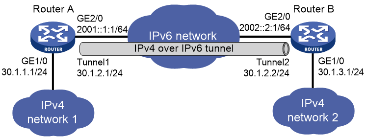

Example: Configuring an IPv4 over IPv6 tunnel
As shown in Figure 14, configure an IPv4 over IPv6 manual tunnel between Router A and Router B so the two networks can reach each other over the IPv6 network.
Figure 14 Network diagram
Make sure Router A and Router B can reach each other through IPv6.
[RouterA-GigabitEthernet1/0] ip address 30.1.1.1 255.255.255.0
# Specify an IPv6 address for GigabitEthernet 2/0, which is the physical interface of the tunnel.
[RouterA-GigabitEthernet2/0] ipv6 address 2001::1:1 64
# Create IPv6 tunnel interface Tunnel 1.
[RouterA] interface tunnel 1 mode ipv6
[RouterA-Tunnel1] ip address 30.1.2.1 255.255.255.0
[RouterA-Tunnel1] source 2001::1:1
[RouterA-Tunnel1] destination 2002::2:1
# Configure a static route destined for IPv4 network 2 through the tunnel.
[RouterA] ip route-static 30.1.3.0 255.255.255.0 tunnel 1
[RouterB-GigabitEthernet1/0] ip address 30.1.3.1 255.255.255.0
[RouterB-GigabitEthernet2/0] ipv6 address 2002::2:1 64
# Create IPv6 tunnel interface Tunnel 2.
[RouterB] interface tunnel 2 mode ipv6
[RouterB-Tunnel2] ip address 30.1.2.2 255.255.255.0
[RouterB-Tunnel2] source 2002::2:1
[RouterB-Tunnel2] destination 2001::1:1
# Configure a static route destined for IPv4 network 1 through the tunnel.
[RouterB] ip route-static 30.1.1.0 255.255.255.0 tunnel 2
[RouterA] ping -a 30.1.1.1 30.1.3.1
Ping 30.1.3.1 (30.1.3.1) from 30.1.1.1: 56 data bytes, press CTRL_C to break
56 bytes from 30.1.3.1: icmp_seq=0 ttl=255 time=3.000 ms
56 bytes from 30.1.3.1: icmp_seq=1 ttl=255 time=1.000 ms
56 bytes from 30.1.3.1: icmp_seq=2 ttl=255 time=0.000 ms
56 bytes from 30.1.3.1: icmp_seq=3 ttl=255 time=1.000 ms
56 bytes from 30.1.3.1: icmp_seq=4 ttl=255 time=1.000 ms
--- Ping statistics for 30.1.3.1 ---
round-trip min/avg/max/std-dev = 0.000/1.200/3.000/0.980 ms

Example: Configuring a DS-Lite tunnel
As shown in Figure 15, to enable hosts in the private IPv4 network to access the public IPv4 network over the IPv6 network, perform the following tasks:
·     Configure a DS-Lite tunnel between Router A and Router B.
·     Configure NAT on GigabitEthernet 1/0 on the AFTR.
Figure 15 Network diagram
[RouterA-GigabitEthernet1/0] ip address 10.0.0.2 255.255.255.0
[RouterA-GigabitEthernet2/0] ipv6 address 1::1 64
[RouterA-Tunnel1] source 1::1
[RouterA-Tunnel1] destination 2::2
# Configure a static route to the public IPv4 network through the tunnel.
[RouterA] ip route-static 20.1.1.0 255.255.255.0 tunnel 1
[RouterB-GigabitEthernet1/0] ip address 20.1.1.1 24
[RouterB-GigabitEthernet2/0] ipv6 address 2::2 64
# Create DS-Lite tunnel interface Tunnel 2.
[RouterB] interface tunnel 2 mode ds-lite-aftr
# Configure an IPv4 address for the tunnel interface.
# Specify GigabitEthernet 2/0 as the source interface of the tunnel.
[RouterB-Tunnel2] source gigabitethernet 2/0
# Enable DS-Lite tunneling on GigabitEthernet 1/0.
[RouterB-GigabitEthernet1/0] ds-lite enable
# Enable NAT on GigabitEthernet 1/0 and use the IP address of GigabitEthernet 1/0 as the translated address.
[RouterB-GigabitEthernet1/0] nat outbound
3.     On host A, specify the IP address for the host as 10.0.0.1 and configure a static route to 20.1.1.0/24 with next hop 10.0.0.2. (Details not shown.)
4.     On host B, specify the IP address for the host as 20.1.1.2. (Details not shown.)
# Verify that host A can ping host B.
C:\> ping 20.1.1.2
Pinging 20.1.1.2 with 32 bytes of data:
Reply from 20.1.1.2: bytes=32 time=51ms TTL=255
Reply from 20.1.1.2: bytes=32 time=44ms TTL=255
Reply from 20.1.1.2: bytes=32 time=1ms TTL=255
Ping statistics for 20.1.1.2:
    Minimum = 1ms, Maximum = 51ms, Average = 24ms

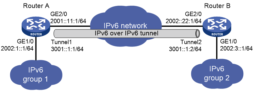

IPv6 over IPv6 tunneling
About IPv6 over IPv6 tunneling
IPv6 over IPv6 tunneling (RFC 2473) enables isolated IPv6 networks to communicate with each other over another IPv6 network. For example, two isolated IPv6 networks that do not want to show their addresses to the Internet can use an IPv6 over IPv6 tunnel to communicate with each other.
Figure 16 Principle of IPv6 over IPv6 tunneling
Figure 16 shows the encapsulation and de-encapsulation processes.
·     Encapsulation:
a.     After receiving an IPv6 packet, Device A submits it to the IPv6 protocol stack.
b.     The IPv6 protocol stack uses the destination IPv6 address of the packet to find the egress interface. If the egress interface is the tunnel interface, the stack delivers it to the tunnel interface.
c.     After receiving the packet, the tunnel interface adds an IPv6 header to it and submits it to the IPv6 protocol stack.
d.     The IPv6 protocol stack forwards the packet according to its destination IPv6 address.
·     De-encapsulation:
a.     Upon receiving the IPv6 packet, Device B delivers it to the IPv6 protocol stack.
b.     The IPv6 protocol stack checks the protocol type of the data portion encapsulated in the IPv6 packet. If the encapsulation protocol is IPv6, the stack delivers the packet to the tunnel module.
c.     The tunnel module de-encapsulates the packet and sends it back to the IPv6 protocol stack.
d.     The IPv6 protocol stack forwards the IPv6 packet.
