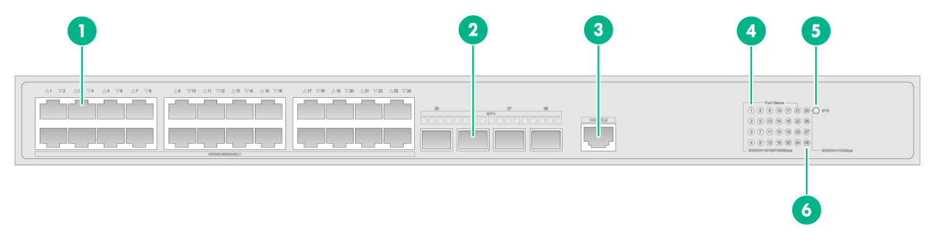

Figure 1 S5120V3-28S-EI front panel
(1) 10/100/1000BASE-T autosensing Ethernet port
(2) SFP+ port
(3) Serial console port
(4) 10/100/1000BASE-T autosensing Ethernet port LED
(5) System status LED
(6) SFP+ port LED

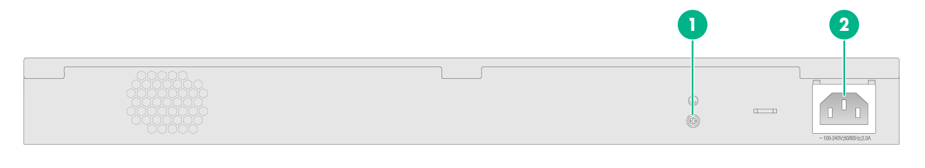

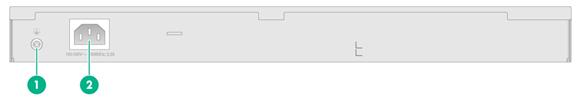

Figure 2 S5120V3-28S-EI rear panel
1-1-S5170-28S-EI后面板-01
(1) Grounding screw
(2) AC-input power receptacle

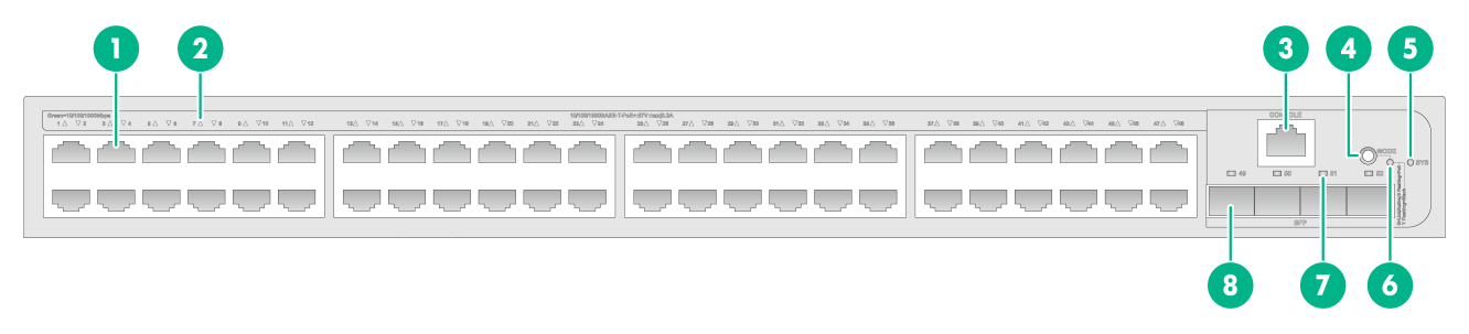

S5120V3-54S-EI
Figure 3 S5120V3-54S-EI front panel
(2) 10/100/1000BASE-T autosensing Ethernet port LED
(3) SFP+ port
(4) SFP+ port LED
(5) Serial console port
(6) System status LED

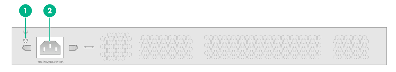

Figure 4 S5120V3-54S-EI rear panel
2-1-S5170-54S-EI后面板-01
(1) AC-input power receptacle
(2) Grounding screw

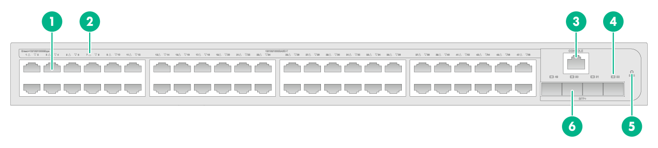

S5120V3-54P-EI
Figure 7 S5120V3-54P-EI front panel
(3) SFP port
(4) SFP port LED

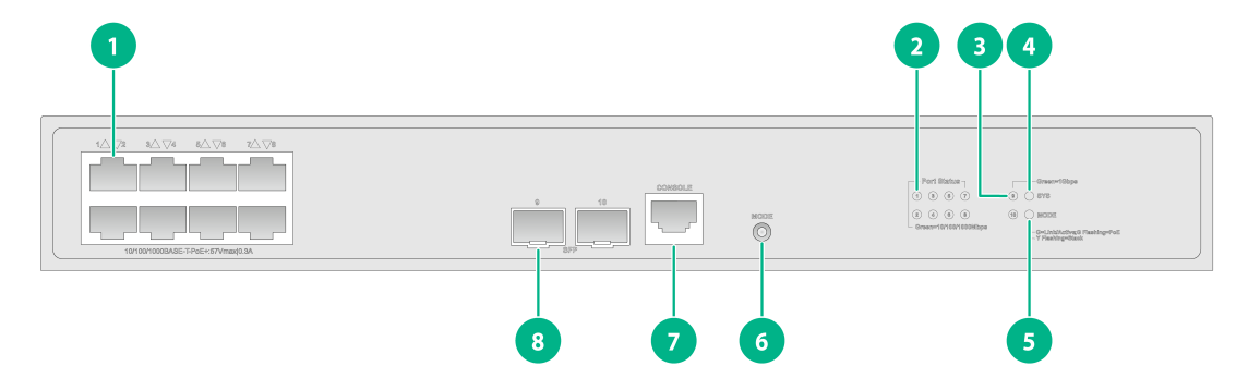

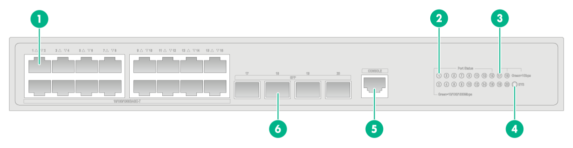

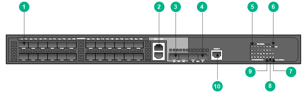

S5120V3-36F-EI
Figure 9 S5120V3-36F-EI front panel
(1) SFP port
(3) SFP+ port
(4) Serial console port
(5) SFP port LED
(6) 10/100/1000BASE-T autosensing Ethernet port LED
(7) System status LED
(8) SFP+ port LED

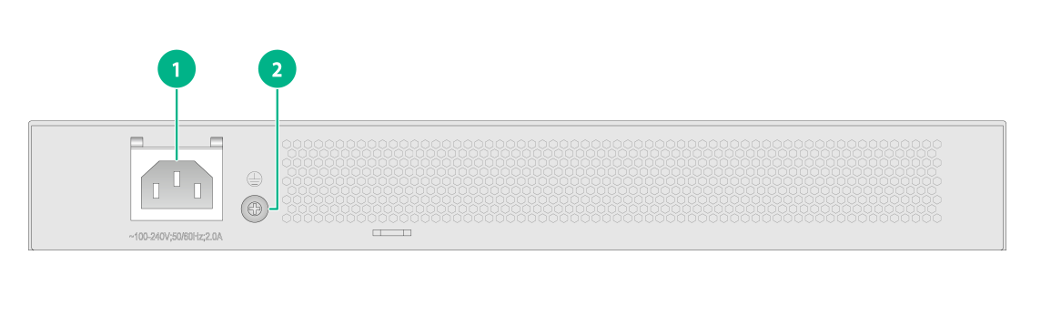

Figure 10 S5120V3-36F-EI rear panel
(2) Grounding screw

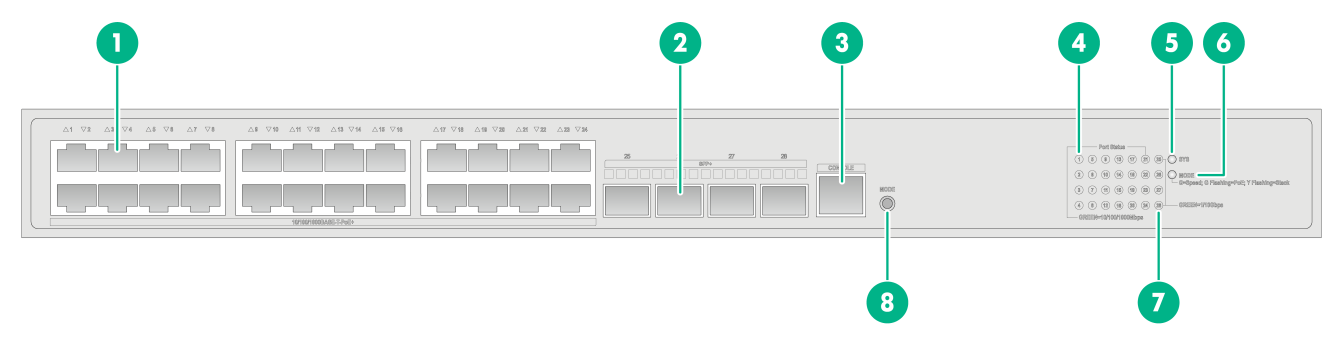

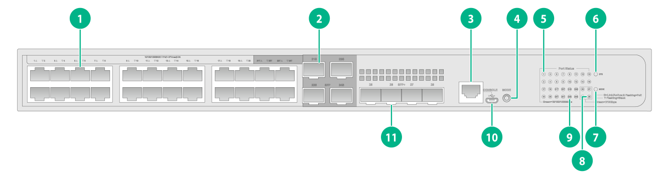

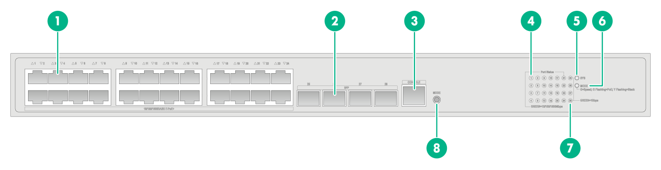

S5120V3-28S-HPWR-EI

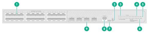

Figure 11 S5120V3-28S-HPWR-EI front panel
(2) SFP+ port
(6) Mode LED (MODE)
(7) SFP+ port LED
(8) Port LED mode switching button
Figure 12 S5120V3-28S-HPWR-EI rear panel

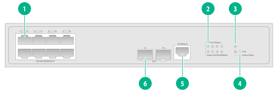

S5120V3-10P-LI
Figure 17 S5120V3-10P-LI front panel
(3) SFP port LED
(4) System status LED (SYS)
(5) Console port
(6) SFP port

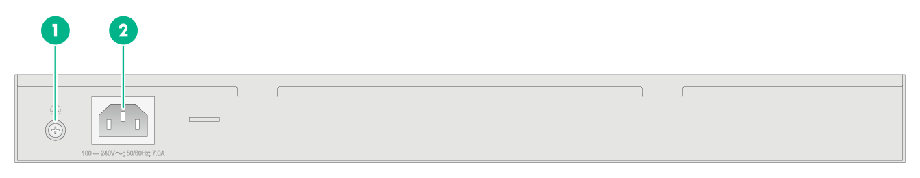

Figure 18 S5120V3-10P-LI rear panel
03-S5130S-10P-EI-后面板_复制-01
(1) Grounding screw

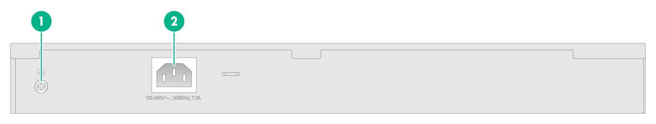

Figure 20 S5120V3-20P-LI rear panel
(2) Grounding screw

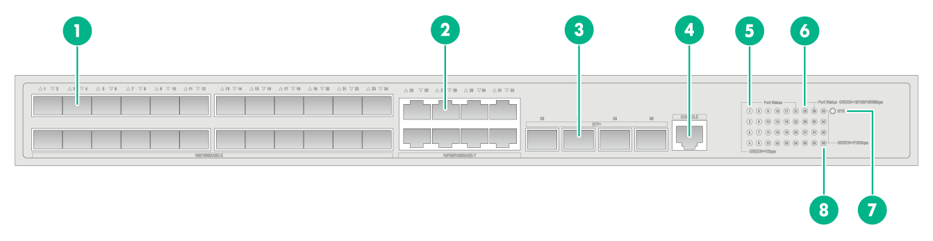

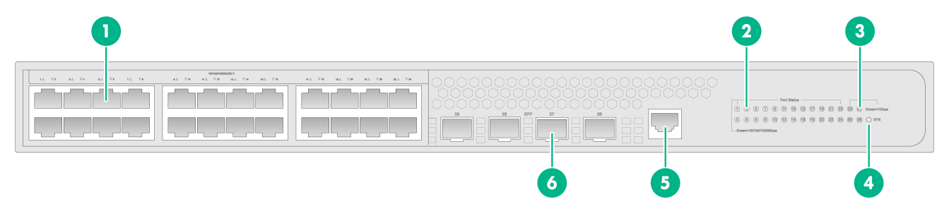

Figure 21 S5120V3-28P-LI front panel
(3) SFP port LED
(5) Console port
(6) SFP port

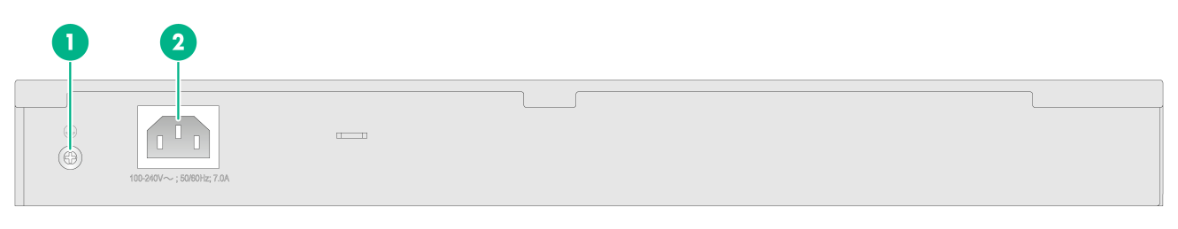

Figure 22 S5120V3-28P-LI rear panel
(1) Grounding screw

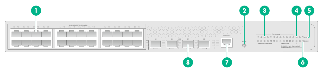

Figure 23 S5120V3-28S-LI front panel
(3) SFP+ port LED

Figure 24 S5120V3-28S-LI rear panel
(1) Grounding screw
S5120V3-28F-LI
Figure 25 S5120V3-28F-LI front panel
(1) SFP port
(3) SFP port
(4) SFP+ port
(5) SFP port LED
(6) System status LED (SYS)
(7) SFP+ port LED
(8) SFP port LED
(9) 10/100/1000BASE-T autosensing Ethernet port LED
(10) Console port
Figure 26 S5120V3-28F-LI rear panel
(2) Grounding screw
S5120V3-52P-LI
Figure 27 S5120V3-52P-LI front panel
(3) Console port
(4) SFP port LED
(5) System status LED (SYS)
(6) SFP port
Figure 28 S5120V3-52P-LI rear panel
(1) Grounding screw
S5120V3-52S-LI
Figure 29 S5120V3-52S-LI front panel
(3) Console port
(4) SFP+ port LED
(6) SFP+ port
Figure 30 S5120V3-52S-LI rear panel
(1) Grounding screw

S5120V3-10P-PWR-LI
Figure 39 S5120V3-10P-PWR-LI front panel
01-S5130S-10P-HPWR-EI-前面板-白牌化_复制-01
(3) SFP port LED
(5) Mode LED (MODE)
(6) Port LED mode switching button
(7) Console port
(8) SFP port

S5120V3-28P-HPWR-LI
Figure 43 S5120V3-28P-HPWR-LI front panel
05-s5130s-28p-hpwr-ei-前面板 - 副本-01
(2) Console port
(3) Port LED mode switching button
(6) Mode LED (MODE)
(7) SFP port LED
(8) SFP port

S5120V3-28S-HPWR-LI
Figure 45 S5120V3-28S-HPWR-LI front panel
04-s5130s-28s-hpwr-ei-前面板 - 副本-01
(2) SFP port
(3) Console port
(4) Port LED mode switching button
(5) 10/100/1000BASE-T autosensing Ethernet port LED
(7) Mode LED (MODE)
(8) SFP+ port LED
(9) SFP port LED
(10) Micro USB console port
(11) SFP+ port

S5120V3-28P-HPWR-LI-Q
Figure 47 S5120V3-28P-HPWR-LI-Q front panel
(2) Port LED mode switching button
(3) 10/100/1000BASE-T autosensing Ethernet port LED
(4) SFP port LED
(6) Mode LED (MODE)
(7) Micro USB console port
(8) Serial console port
(9) SFP port

S5120V3-SI switch series
S5120V3-10P-SI
Figure 49 S5120V3-10P-SI front panel
(3) SFP port LED
(5) Console port
(6) SFP port
Figure 50 S5120V3-10P-SI rear panel
(1) Grounding screw

S5120V3-28P-HPWR-SI
Figure 61 S5120V3-28P-HPWR-SI front panel
5-3-S5120V3-28P-HPWR-SI前面板
(1) 10/100/1000BASE-T-PoE+ autosensing Ethernet port
(2) SFP port
(4) 10/100/1000BASE-T PoE+ autosensing Ethernet port LED
(6) Mode LED (MODE)
(7) SFP port LED
Figure 62 S5120V3-28P-HPWR-SI rear panel
(1) Grounding screw
