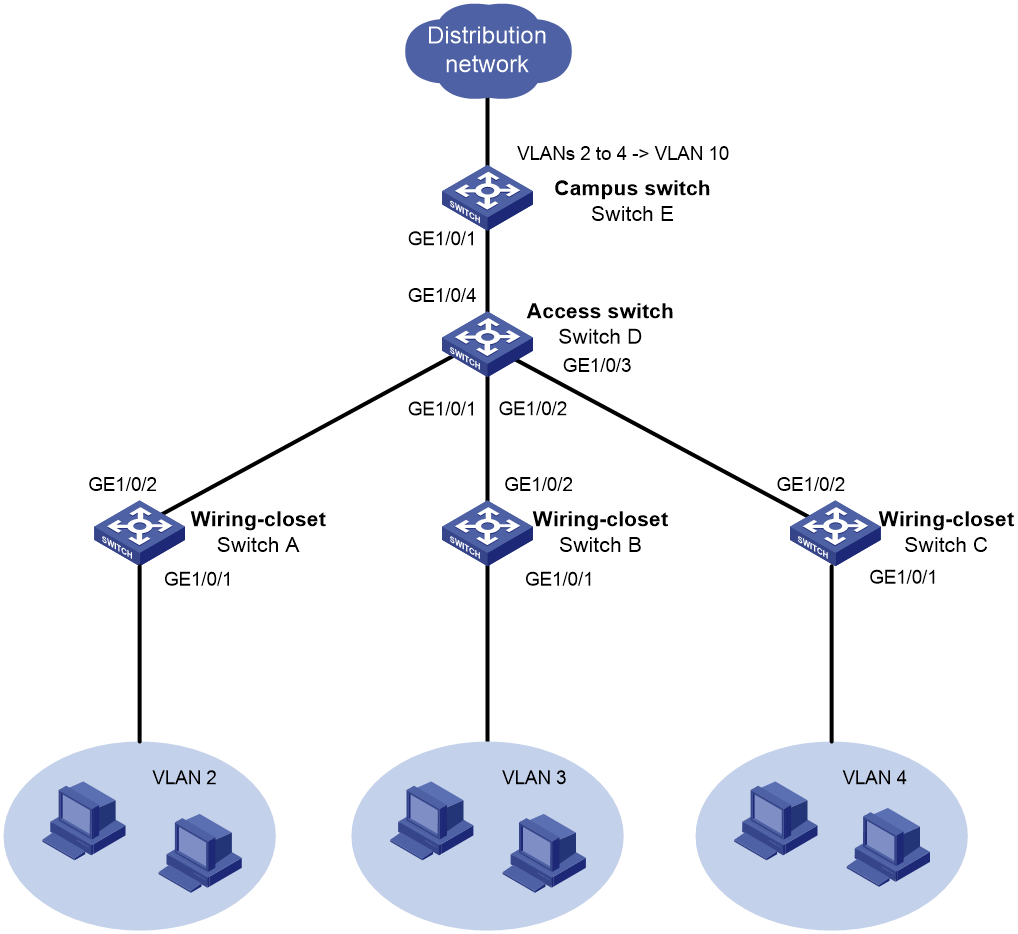

One-to-one and many-to-one VLAN mapping are typically used by a community for broadband Internet access, as shown in Figure 1.
Figure 1 Application scenario of one-to-one and many-to-one VLAN mapping
As shown in Figure 1, the network is implemented as follows:
·     Each home gateway uses different VLANs to transmit the PC, VoD, and VoIP services.
·     To further subclassify each type of traffic by customer, configure one-to-one VLAN mapping on the wiring-closet switches. This feature assigns a separate VLAN to each type of traffic from each customer. The required total number of VLANs in the network can be very large.
·     To prevent the maximum number of VLANs from being exceeded on the distribution layer device, configure many-to-one VLAN mapping on the campus switch. This feature assigns the same VLAN to the same type of traffic from different customers.

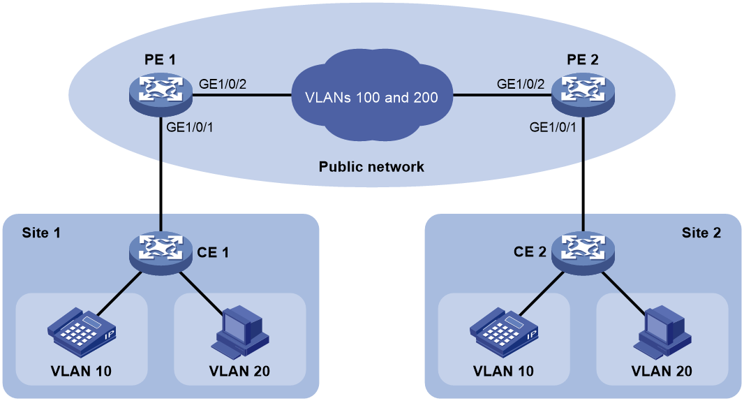

As shown in Figure 2, one-to-two VLAN mapping is used to transmit different types of CVLAN packets with different SVLAN tags over the service provider network.
Figure 2 Application scenario of one-to-two VLAN mapping
As shown in Figure 2, users of Site 1 and Site 2 are in VLAN 10 and VLAN 20. The service provider assigns VLAN 100 and VLAN 200 to the customer network. When packets from Site 1 arrive at PE 1, PE 1 adds an SVLAN tag to the packets based on the packet type.
One-to-two VLAN mapping enables the customer to plan CVLANs without conflicting with SVLANs. The service provider can distinguish traffic of the customer network with different SVLANs, and apply transmission policies to the customer traffic.

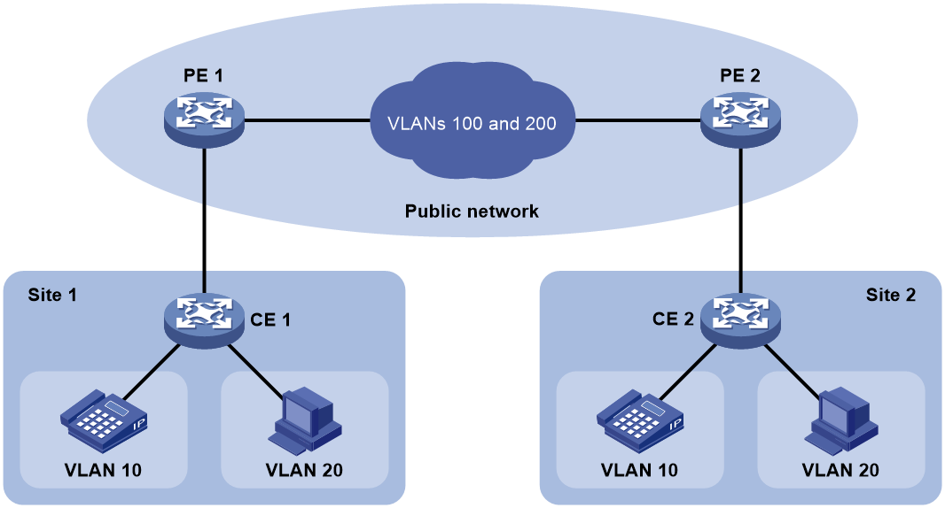

As shown in Figure 6, one-to-two VLAN mapping is implemented on the customer-side port to add the SVLAN tag for the uplink traffic.
For the downlink traffic to be correctly sent to the customer network, make sure the SVLAN tag is removed on the customer-side port before transmission. Use one of the following methods to remove the SVLAN tag from the downlink traffic:
·     Configure the customer-side port as a hybrid port and assign the port to the SVLAN as an untagged member.
·     Configure the customer-side port as a trunk port and set the port PVID to the SVLAN.
Figure 6 One-to-two VLAN mapping implementation

Configure one-to-one VLAN mapping on the wiring-closet switch, as shown in Figure 1.
·     Configuring many-to-one VLAN mapping
Configure many-to-one VLAN mapping on the campus switch, as shown in Figure 1.

Configure one-to-two VLAN mapping on PE 1 and PE 4, as shown in Figure 2, through which traffic from customer networks enters the service provider networks.

Example: Configuring many-to-one VLAN mapping
As shown in Figure 8:
·     Create VLAN 2, VLAN 3, and VLAN 4 on the wiring-closet switches to isolate traffic of the same service type from different households.
·     Configure many-to-one VLAN mappings on the campus switch to assigns one VLAN to transport all types of traffic from different households. In this example, map VLANs 2 through 4 to VLAN 10.
Figure 8 Network diagram
1.     Configure Switch A:
# Create VLAN 2.
<SwitchA> system-view
[SwitchA] vlan 2
[SwitchA-vlan2] quit
# Assign ports GigabitEthernet 1/0/1 and GigabitEthernet 1/0/2 to VLAN 2.
[SwitchA] interface range gigabitethernet 1/0/1 to gigabitethernet 1/0/2
[SwitchA-if-range] port access vlan 2
[SwitchA-if-range] quit
2.     Configure Switch B and Switch C in the same way Switch A is configured. (Details not shown.)
3.     Configure Switch D:
# Create VLANs 2, 3, and 4.
<SwitchD> system-view
[SwitchD] vlan 2 to 4
# Assign ports GigabitEthernet 1/0/1 to VLAN 2, GigabitEthernet 1/0/2 to VLAN 3, and GigabitEthernet 1/0/3 to VLAN 4.
[SwitchD] interface gigabitethernet 1/0/1
[SwitchD-GigabitEthernet1/0/1] port access vlan 2
[SwitchD-GigabitEthernet1/0/1] quit
[SwitchD] interface gigabitethernet 1/0/2
[SwitchD-GigabitEthernet1/0/2] port access vlan 3
[SwitchD-GigabitEthernet1/0/2] quit
[SwitchD] interface gigabitethernet 1/0/3
[SwitchD-GigabitEthernet1/0/3] port access vlan 4
[SwitchD-GigabitEthernet1/0/3] quit
# Configure port GigabitEthernet 1/0/4 as a trunk port.
[SwitchD] interface gigabitethernet 1/0/4
[SwitchD-GigabitEthernet1/0/4] port link-type trunk
# Assign GigabitEthernet 1/0/4 to VLANs 2 through VLAN 4.
[SwitchD-GigabitEthernet1/0/4] port trunk permit vlan 2 to 4
[SwitchD-GigabitEthernet1/0/4] quit
4.     Configure Switch E:
# Create VLANs 2, 3, and 4 (the original VLANs in the VLAN mapping to be created).
<SwitchE> system-view
[SwitchE] vlan 2 to 4
# Configure the customer-side port (GigabitEthernet 1/0/1) as a trunk port.
[SwitchE] interface gigabitethernet 1/0/1
[SwitchE-GigabitEthernet1/0/1] port link-type trunk
# Assign GigabitEthernet 1/0/1 to the original VLANs.
[SwitchE-GigabitEthernet1/0/1] port trunk permit vlan 2 to 4
# Configure many-to-one VLAN mapping on GigabitEthernet 1/0/1, which replaces VLAN tag 2 through VLAN tag 4 with VLAN tag 10.
[SwitchE-GigabitEthernet1/0/1] vlan mapping uni range 2 to 4 translated-vlan 10
[SwitchE-GigabitEthernet1/0/1] quit
# Verify VLAN mapping information on Switch E.
[SwitchE] display vlan mapping
Interface GigabitEthernet1/0/1:
  Outer VLAN    Inner VLAN    Translated Outer VLAN    Translated Inner VLAN
  2-4           N/A           10                       N/A
Example: Configuring one-to-two VLAN mapping
As shown in Figure 9, Site 1 and Site 2 of a company use VLAN 10 and VLAN 20 to transmit VoIP and PC traffic, respectively. The service provider assigns VLAN 100 and VLAN 200 to the customer network.
Configure one-to-two VLAN mappings to enable the service provider network to transmit VoIP and PC traffic with SVLAN 100 and SVLAN 200, respectively.
Figure 9 Network diagram
1.     Configure PE 1:
# Create VLANs 10, 20, 100, and 200.
<PE1> system-view
[PE1] vlan 10
[PE1-vlan10] quit
[PE1] vlan 20
[PE1-vlan20] quit
[PE1] vlan 100
[PE1-vlan100] quit
[PE1] vlan 200
[PE1-vlan200] quit
# Configure a one-to-two VLAN mapping on the customer-side port (GigabitEthernet 1/0/1) to add SVLAN tag 100 to packets from CVLAN 10.
[PE1] interface gigabitethernet 1/0/1
[PE1-GigabitEthernet1/0/1] vlan mapping nest single 10 nested-vlan 100
# Configure a one-to-two VLAN mapping on GigabitEthernet 1/0/1 to add SVLAN tag 200 to packets from CVLAN 20.
[PE1-GigabitEthernet1/0/1] vlan mapping nest single 20 nested-vlan 200
# Configure GigabitEthernet 1/0/1 as a hybrid port.
[PE1-GigabitEthernet1/0/1] port link-type hybrid
# Assign GigabitEthernet 1/0/1 to VLANs 100 and 200 as an untagged member.
[PE1-GigabitEthernet1/0/1] port hybrid vlan 100 200 untagged
[PE1-GigabitEthernet1/0/1] quit
# Configure the network-side port (GigabitEthernet 1/0/2) as a trunk port, and assign the port to VLANs 100 and 200.
[PE1] interface gigabitethernet 1/0/2
[PE1-GigabitEthernet1/0/2] port link-type trunk
[PE1-GigabitEthernet1/0/2] port trunk permit vlan 100 200
[PE1-GigabitEthernet1/0/2] quit
2.     Configure PE 2 in the same way PE 1 is configured. (Details not shown.)
# Verify VLAN mapping information on PE 1.
[PE1] display vlan mapping
  10             N/A           100                      10
  20             N/A           200                      20
# Verify VLAN mapping information on PE 2.
[PE2] display vlan mapping
Interface GigabitEthernet1/0/2:
  10             N/A           100                      10
  20             N/A           200                      20
