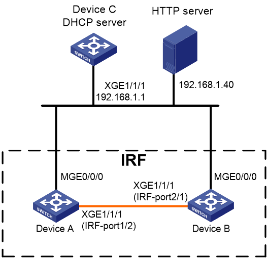

Example: Using Python script to set up an IRF fabric automatically
As shown in Figure 1, the administrator has only remote access to Device A and Device B, which have been physically connected for IRF setup. To have the two devices automatically configured into an IRF fabric:
·     Edit a Python script file to configure Device A and Device B as follows:
¡     Enable the devices to merge into an IRF fabric automatically.
¡     Enable Telnet access to the IRF fabric, and configure password authentication on VTY lines.
·     Store the Python file on an HTTP file server.
·     Issue the Python script file to the devices through a DHCP server.
Figure 1 Network diagram

When you set up an IRF fabric by using Python script, follow these restrictions and guidelines:
·     To do a successful automatic IRF setup, make sure the network environment has been set up as planned before you power on the candidate IRF member devices.
In this example, make sure the network has been set up as shown in Figure 1 before you power on Device A and Device B.

Configuring Device C (the DHCP server)
IMPORTANT
IMPORTANT:
IP address assignment and route configuration must ensure that the switches and the file server can reach each other.
1.     Configure the DHCP server:
# Enable DHCP.
<DeviceC> system-view
[DeviceC] dhcp enable
# Configure an address pool to assign IP addresses to the subnet that contains the member switches. This example uses the 192.168.1.0/24 subnet.
[DeviceC] dhcp server ip-pool 1
[DeviceC-dhcp-pool-1] network 192.168.1.0 24
# Specify the URL of the script file for the clients.
[DeviceC-dhcp-pool-1] bootfile-name http://192.168.1.40/device.py
[DeviceC-dhcp-pool-1] quit

 * indicates the device is the master.
 + indicates the device through which the user logs in.
 The Bridge MAC of the IRF is: 00e0-fc0f-8c14
 Auto upgrade                : yes
 Mac persistent              : 6 min
 Domain ID                   : 0
Configuration files
·     Device A and Device B:
telnet server enable
 irf mac-address persistent timer
 irf auto-update enable
 undo irf link-delay
 irf member 1 priority 1
 irf member 2 priority 1
irf-port 1/2
port group interface Ten-GigabitEthernet1/1/1 mode enhanced
irf-port 2/1
 port link-mode bridge
interface M-GigabitEthernet0/0/0
 ip address 192.168.0.63 255.255.255.0
line vty 0 63
 user-role network-admin
 set authentication password hash $h$6$40hhbS6PeVJORuQu$X/9nQ9PSpPbtGDukVYGOW2Ao
9yJaekVbzovWv23pEKCVwzqqRP8Elnm1qRm4TEIbAetmwQG5gWyREMC3zRCOaQ==
·     Device C (DHCP server):
 dhcp enable
 network 192.168.1.0 mask 255.255.255.0
