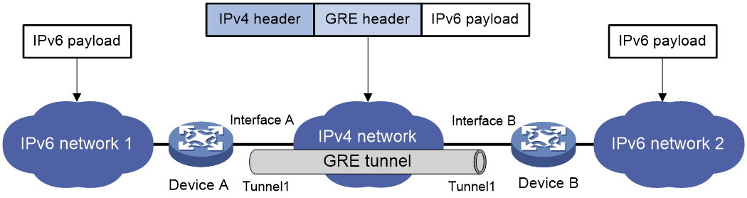

Figure 1 GRE encapsulation format

As shown in Figure 2, an IPv6 protocol packet traverses an IPv4 network through a GRE tunnel as follows:
1.     After receiving an IPv6 packet from the interface connected to IPv6 network 1, Device A processes the packet as follows:
a.     Looks up the routing table to identify the outgoing interface for the IPv6 packet.
b.     Submits the IPv6 packet to the outgoing interface—the GRE tunnel interface Tunnel 1.
2.     Upon receiving the packet, the tunnel interface encapsulates the packet with GRE and then with IPv4. In the IPv4 header:
¡     The source address is the tunnel's source address (the IP address of Interface A of Device A).
¡     The destination address is the tunnel's destination address (the IP address of Interface B of Device B).
3.     Device A looks up the routing table according to the destination address in the IPv4 header, and forwards the IPv4 packet out of the physical interface (Interface A) of the GRE tunnel.
4.     When the IPv4 arrives at the GRE tunnel destination Device B, Device B checks the destination address. Because the destination is Device B itself and the protocol number in the IP header is 47 (the protocol number for GRE), Device B submits the packet to GRE for de-encapsulation.
5.     GRE first removes the IPv4 header, and then checks the packet sequence number. After GRE finishes the checking, it removes the GRE header, and submits the payload to the IPv6 protocol for forwarding.
Figure 2 IPv6 networks interconnected through a GRE tunnel

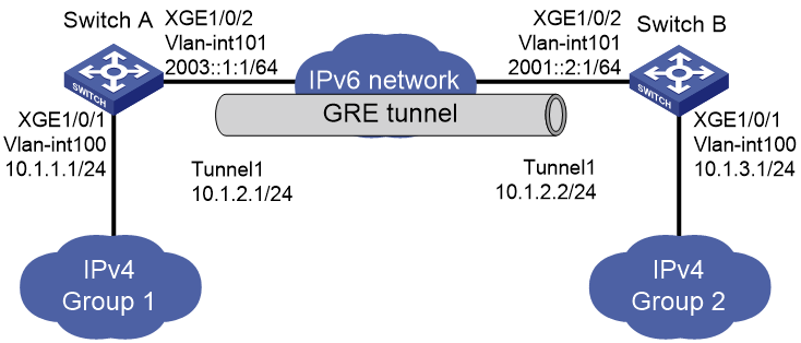

Example: Configuring an IPv4 over IPv4 GRE tunnel
As shown in Figure 6, Group 1 and Group 2 are two private IPv4 networks. The two networks both use private network addresses and belong to the same VPN. Establish a GRE tunnel between Switch A and Switch B to interconnect the two private IPv4 networks Group 1 and Group 2.
Figure 6 Network diagram
Before performing the following configuration, configure an IP address for each interface, and make sure Switch A and Switch B can reach each other.

Example: Configuring an IPv4 over IPv6 GRE tunnel
As shown in Figure 7, two IPv4 subnets Group 1 and Group 2 are connected to an IPv6 network. Create a GRE/IPv6 tunnel between Switch A and Switch B, so the two IPv4 subnets can communicate with each other through the GRE tunnel over the IPv6 network.
Figure 7 Network diagram
1.     Configure Switch A:
# Enter system view.
<SwitchA> system-view
# Create a tunnel interface Tunnel 1, and specify the tunnel mode as GRE/ IPv6.
[SwitchA] interface tunnel 1 mode gre ipv6
# Configure an IP address for the tunnel interface.
[SwitchA-Tunnel1] ip address 10.1.2.1 255.255.255.0
# Configure the source address of the tunnel interface as the IPv6 address of VLAN-interface 101 on Switch A.
[SwitchA-Tunnel1] source 2003::1:1
# Configure the destination address of the tunnel interface as the IPv6 address of VLAN-interface 101 on Switch B.
[SwitchA-Tunnel1] destination 2001::2:1
[SwitchA-Tunnel1] quit
# Configure a static route from Switch A through the tunnel interface to Group 2.
[SwitchA] ip route-static 10.1.3.0 255.255.255.0 tunnel 1
2.     Configure Switch B:
<SwitchB> system-view
# Create a tunnel interface Tunnel 1, and specify the tunnel mode as GRE/IPv6.
[SwitchB] interface tunnel 1 mode gre ipv6
[SwitchB-Tunnel1] ip address 10.1.2.2 255.255.255.0
# Configure the source address of tunnel interface as the IPv6 address of VLAN-interface 101 on Switch B.
[SwitchB-Tunnel1] source 2001::2:1
# Configure the destination address of the tunnel interface as the IPv6 address of VLAN-interface 101 on Switch A.
[SwitchB-Tunnel1] destination 2003::1:1
[SwitchB-Tunnel1] quit
# Configure a static route from Switch B through the tunnel interface to Group 1.
[SwitchB] ip route-static 10.1.1.0 255.255.255.0 tunnel 1
