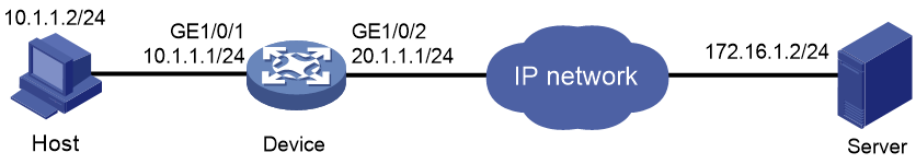

As shown in Figure 2, configure HTTP-based Web caching on the device to cache Web content from the HTTP server.
Figure 2 Network diagram

Example: Configuring HTTPS-based Web caching
As shown in Figure 3, configure HTTPS-based Web caching on the device to cache Web content from the HTTPS server.
Figure 3 Network diagram

Web caching configuration examples (in IRF mode)
Example: Configuring HTTP-based Web caching
As shown in Figure 4, configure Web caching on the device to cache Web content from the HTTP server.
Figure 4 Network diagram
As shown in Figure 5, configure HTTPS-based Web caching on the device to cache Web content from the HTTPS server.
Figure 5 Network diagram
# Configure IP addresses for interfaces. (Details not shown.)
