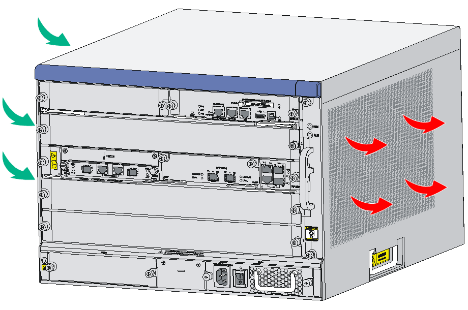

Cooling system
The router uses left to right airflow for heat dissipation.
To ensure good ventilation, the following requirements must be met:
·     Leave a minimum clearance of 100 mm (3.94 in) at the inlet and outlet air vents.
·     The installation site has a good cooling system.
Figure1-1 Airflow

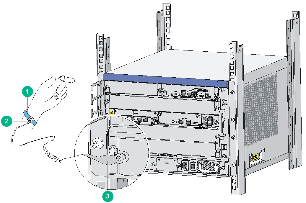

To attach the ESD wrist strap:
1.     Wear the wrist strap on your wrist.
2.     Lock the wrist strap tight around your wrist to keep good contact with the skin.
3.     Insert the ESD wrist strap into the specially designed hole on the router chassis or attach it to the grounding screw of the chassis with the alligator clips.

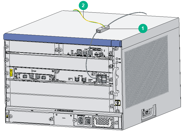

4.     Make sure the rack is reliably grounded.
Figure1-2 Attaching an ESD wrist strap
(1) ESD wrist strap
(2) Lock
(3) Alligator clip

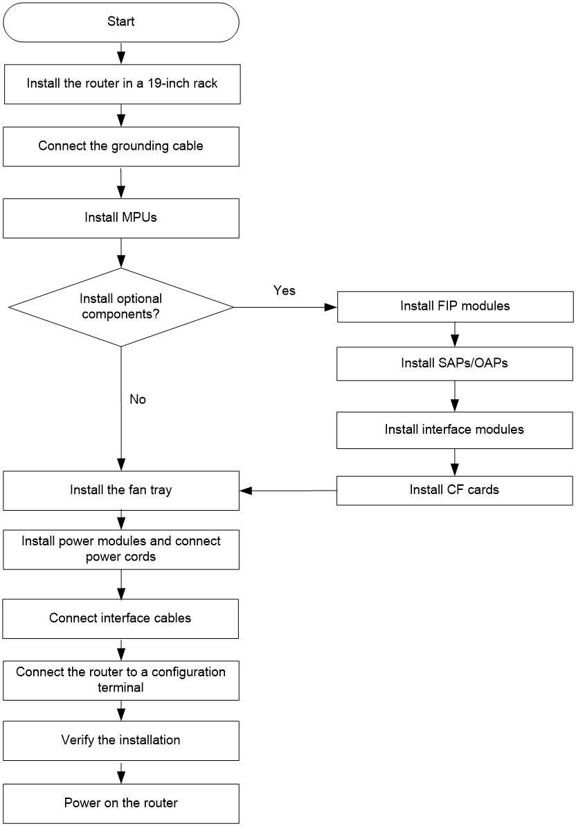

Figure2-1 Router installation flow

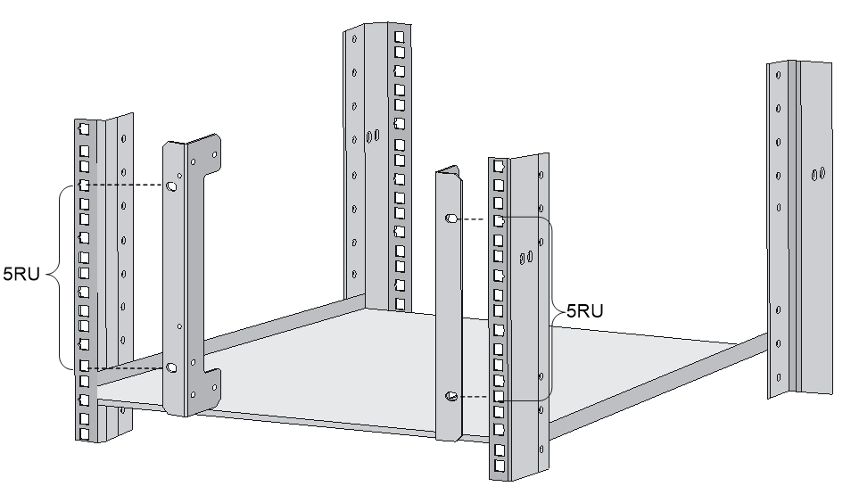

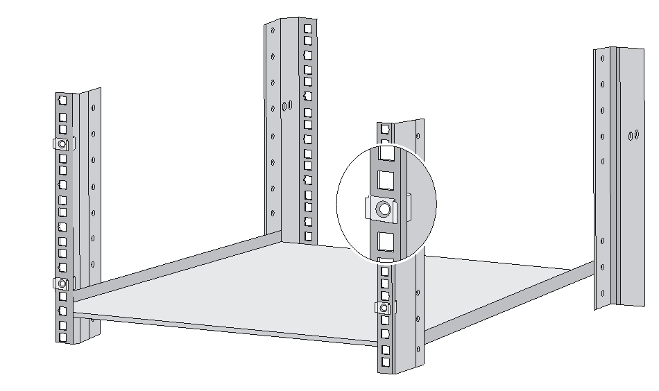

Attaching cage nuts to the rack

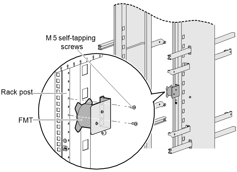

1.     Determine where to install the router in the rack, and then install a rack shelf on the rack.
2.     As shown in Figure2-2, mark the positions of cage nuts on the front rack posts by using a front mounting bracket.
Figure2-2 Marking the positions of the cage nuts
3.     As shown in Figure2-3, attach the cage nuts to the marked positions on the rack posts.
Figure2-3 Installing cage nuts

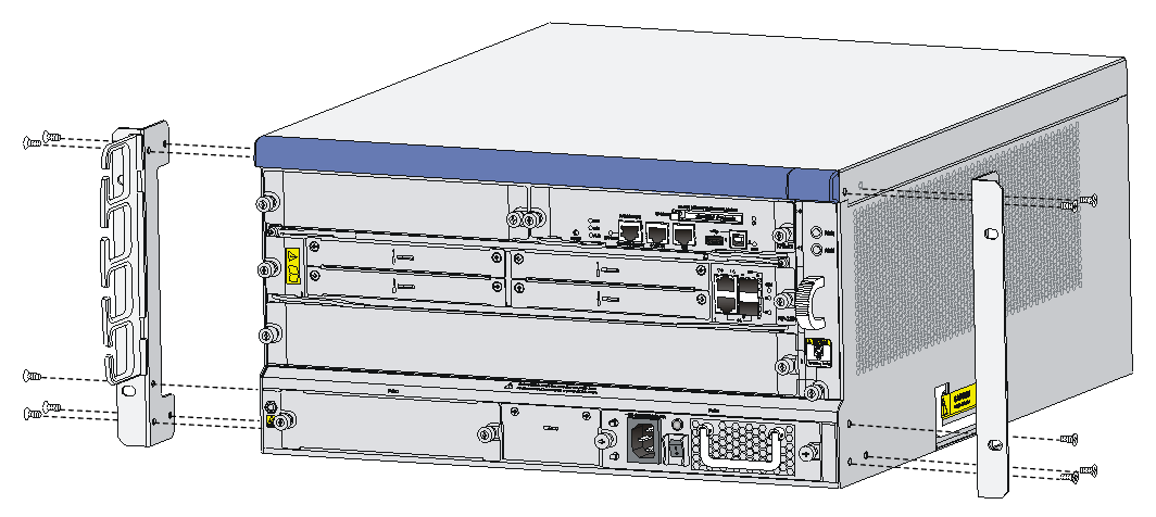

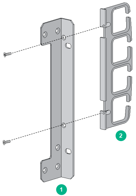

Installing the cable management brackets
As shown in Figure2-4, attach the cable management bracket to the left mounting bracket with screws before attaching it to the router.
The SR6608-DS router is shipped with the cable management bracket attached to the left mounting bracket. You do not need to install the cable management bracket separately for the SR6608-DS router.
Figure2-4 Installing the cable management bracket
(1) Left mounting bracket
(2) Cable management bracket
Attaching the mounting brackets to the router
Before installing the router in a rack, attach the front mounting brackets to the two sides of the router.
To attach the front mounting brackets to the router, align the screw holes on the mounting brackets with the screw holes on the router chassis, and then fasten the screws.
Figure2-5 Attaching the front mounting brackets to the two sides of the router

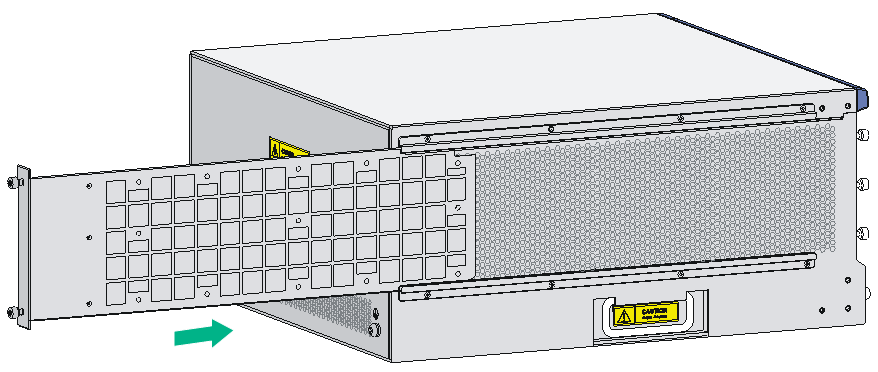

If you have ordered an air filter for the router, attach it to the router before rack-mounting the router. For the air filter installation procedure, see "Installing an air filter."

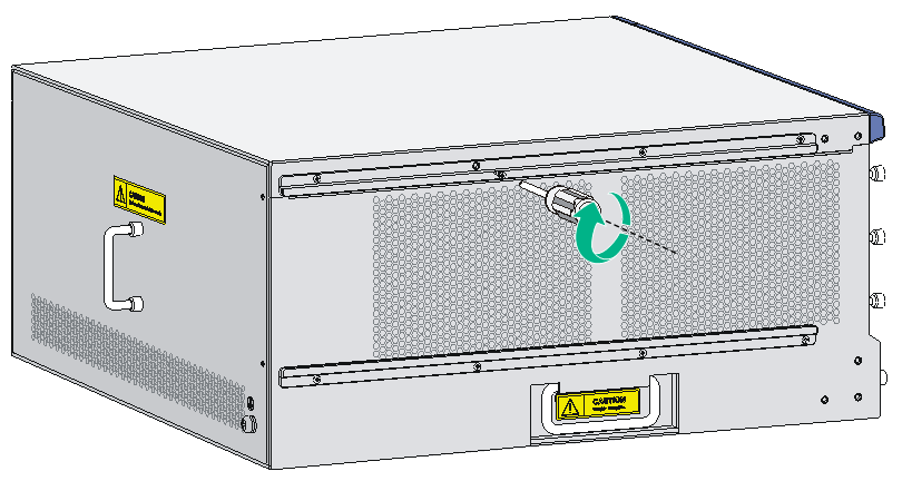

Installing the router by using mounting brackets and slide rails
The procedure is similar for installing the router by using mounting brackets and slide rails and by using mounting brackets and a rack shelf. For more information, see "Installing the router by using mounting brackets and a rack shelf."
Before installing the router in the rack, attach slides rails to the rack. As a best practice, purchase slide rails from H3C. Table2-1 describes the slide rails available for the router. For information about installing the slide rails, see the installation guide shipped with the slide rails.
If the rack has slide rails installed, skip this step.

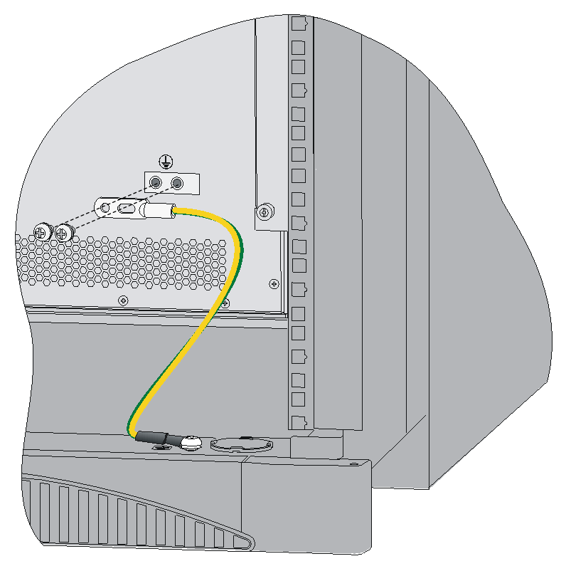

Grounding the router
WARNING
WARNING!
Correctly connecting the router grounding cable is crucial to lightning protection and EMI protection.
To connect the grounding cable:
1.     Remove the grounding screws from the grounding terminal on the rear panel of the router chassis.
2.     Use the grounding screws to attach the lug of the grounding cable to the grounding terminal and fasten the screws.
3.     Connect the other end of the grounding cable to the grounding strip of the rack.
Figure2-7 Connecting the grounding cable to the grounding hole of router
·     Make sure the resistance reading between router chassis and the ground is smaller than 5 ohms.
·     To guarantee the grounding effect, use the grounding cable provided with the router to connect to the grounding strip in the equipment room as long as possible.

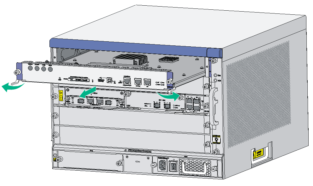

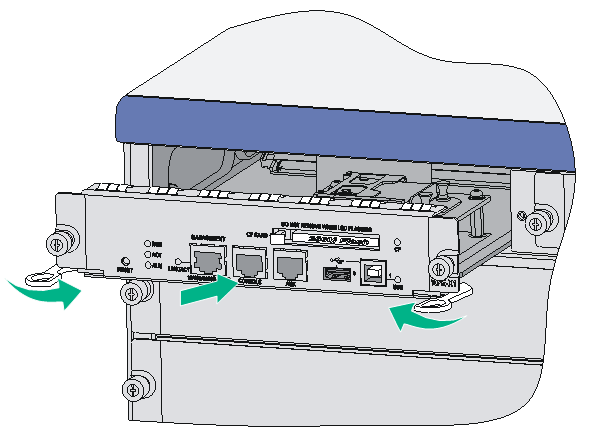

Installing an RPE-X1/RPE-X3/RPE-X5/RPE-X5E MPU

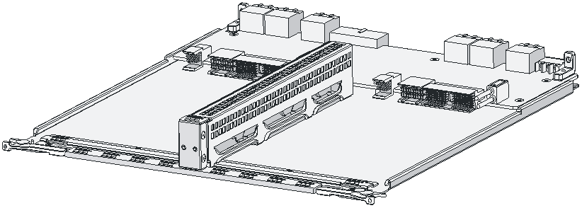

Before installing an RPE-X1, RPE-X3, RPE-X5, or RPE-X5E MPU, install a compatible carrier in the MPU slot. The RPE-X1 MPU supports the BKEB carrier, the RPE-X3 MPU supports the BKEC carrier, and the RPE-X5/RPE-X5E MPU supports the BKED carrier. For the carrier model, see the barcode on the carrier.
The installation procedures for the RPE-X1, RPE-X3, RPE-X5, and RPE-X5E are the same. This example uses an RPE-X1.

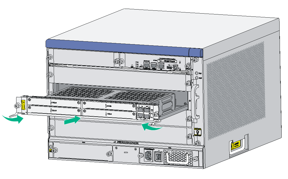

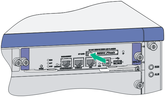

To install an RPE-X1:
1.     Locate the slot to install the RPE-X1.
The RPE-X1 can be installed in slot 0 or slot 1. This procedure uses slot 1 as an example.
2.     Gently push the RPE-X1 carrier (with the components facing up) into slot 1 along the slide rails until the positioning pins on the backplane are seated in the positioning holes at the bottom of the RPE-X1 carrier. Then push the ejector levers inward to lock the RPE-X1 carrier in position and fasten the captive screws on the ejector levers.
Figure2-8 Internal structure of the RPE-X1 carrier
Figure2-9 Installing the RPE-X1 carrier
3.     Use even pressure to gently push the RPE-X1 into slot 1 along the slide rails, and then push the ejector levers inward to lock the board in position.
Figure2-10 Inserting the RPE-X1 into the slot
4.     Fasten the captive screws on the RPE-X1.
5.     Observe the RUN LED on the RPE-X1 to verify that the RPE-X1 is installed correctly.
After the router is powered on, the RUN LED on the RPE-X1 flashes green at 8 Hz until the application software is loaded. When the RUN LED flashes green at 1 Hz, the RPE-X1 is operating correctly.
When two RPE-X1 or RPE-X3 MPUs are installed on the router, the ACT LED on the active MPU is steady green. For the MPU LED descriptions, see H3C SR6604[6608] Routers Hardware Information and Specifications.

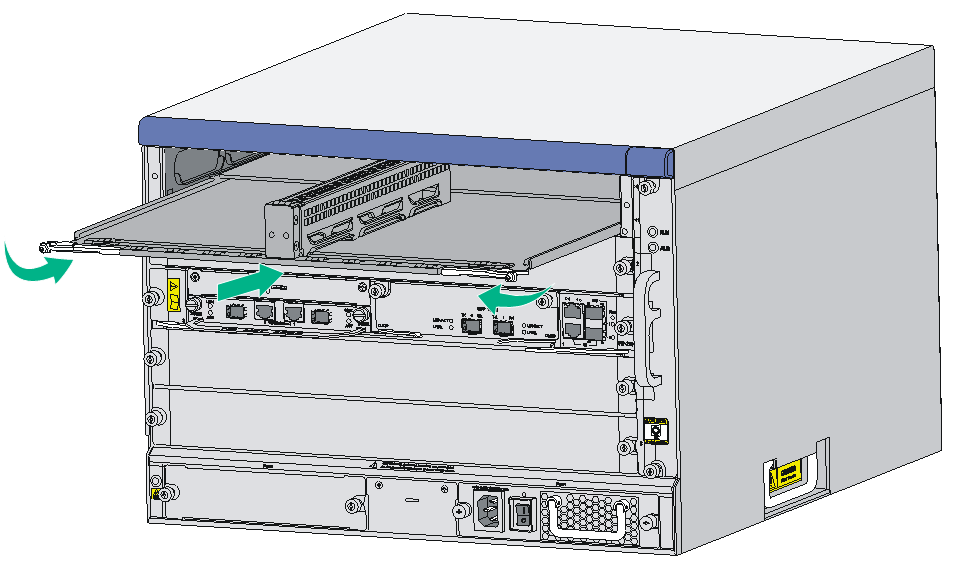

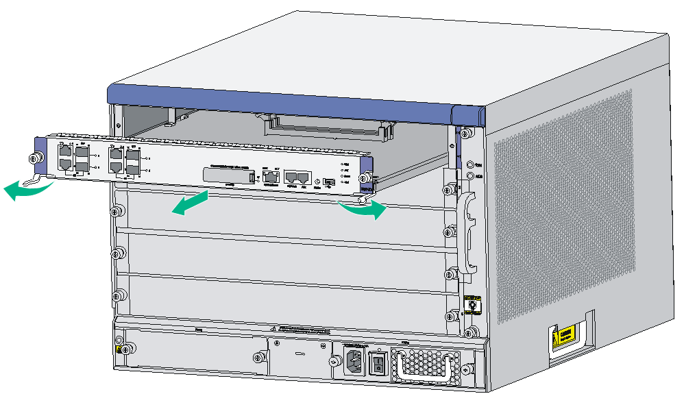

Installing an RSE-X1 MPU
1.     Locate the slot to install the RSE-X1.
You can install an RSE-X1 in slot 1 or slot 2. This procedure uses slot 1 as an example.
2.     Loosen the captive screws on the filler panel in slot 1, and then remove the filler panel.

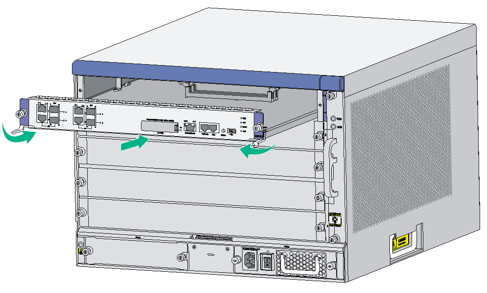

3.     Use even pressure to gently push the RSE-X1 into slot 1 along the slide rails, and then push the ejector levers inward to lock the RSE-X1 in position.
Figure2-11 Inserting the RSE-X1 into the slot
4.     Fasten the captive screws on the RSE-X1.
5.     Observe the RUN LED on the RSE-X1 to verify that the RSE-X1 is installed correctly.
After the router is powered on, the RUN LED on the RSE-X1 flashes green at 8 Hz until the application software is loaded. When the RUN LED flashes green at 1 Hz, the RSE-X1 is operating correctly.
When two RSE-X1 MPUs are installed on the router, the ACT LED on the active MPU is steady green. For the MPU LED descriptions, see H3C SR6604[6608] Routers Hardware Information and Specifications.

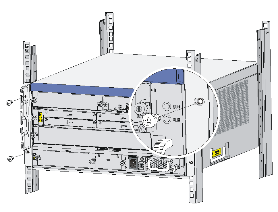

To install an MCP:
1.     Loosen the captive screws on the filler panel in the slot, and then remove the filler panel.
2.     Use even pressure to gently push the MCP into slot 1 along the slide rails until positioning pins on the backplane are seated in the positioning holes, and then push the ejector levers inward to lock the MCP in position.
Figure2-12 Inserting the MCP into the slot
3.     Fasten the captive screws on the MCP.
4.     Observe the RUN LEDs on the MCP to verify that the MCP is installed correctly.
After the router is powered on, the RUN LED on the MCP flashes green at 8 Hz until the application software is loaded. When the RUN LED flashes green at 1 Hz, the MCP is operating correctly.
When two MCP MPUs are installed on the router, the ACT LED on the active MPU is steady green. For the MPU LED descriptions, see H3C SR6604[6608] Routers Hardware Information and Specifications.

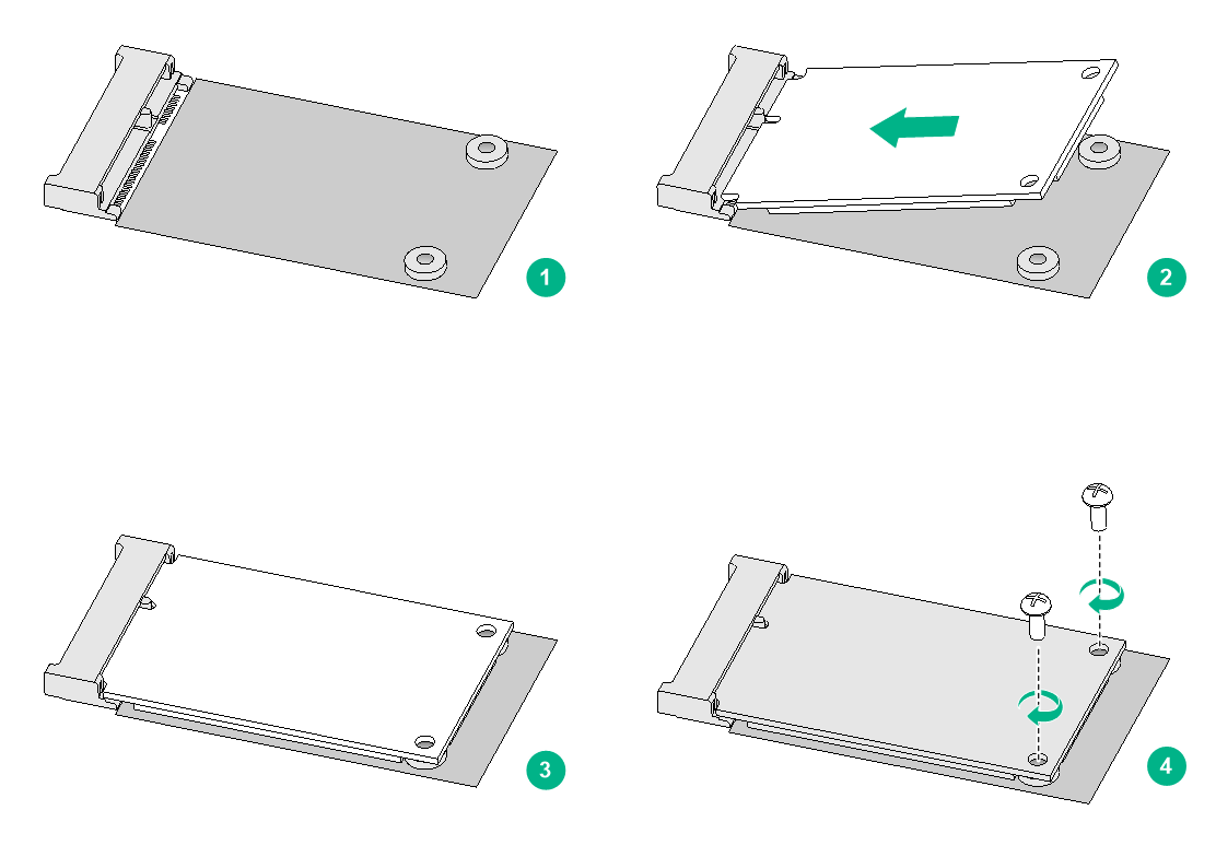

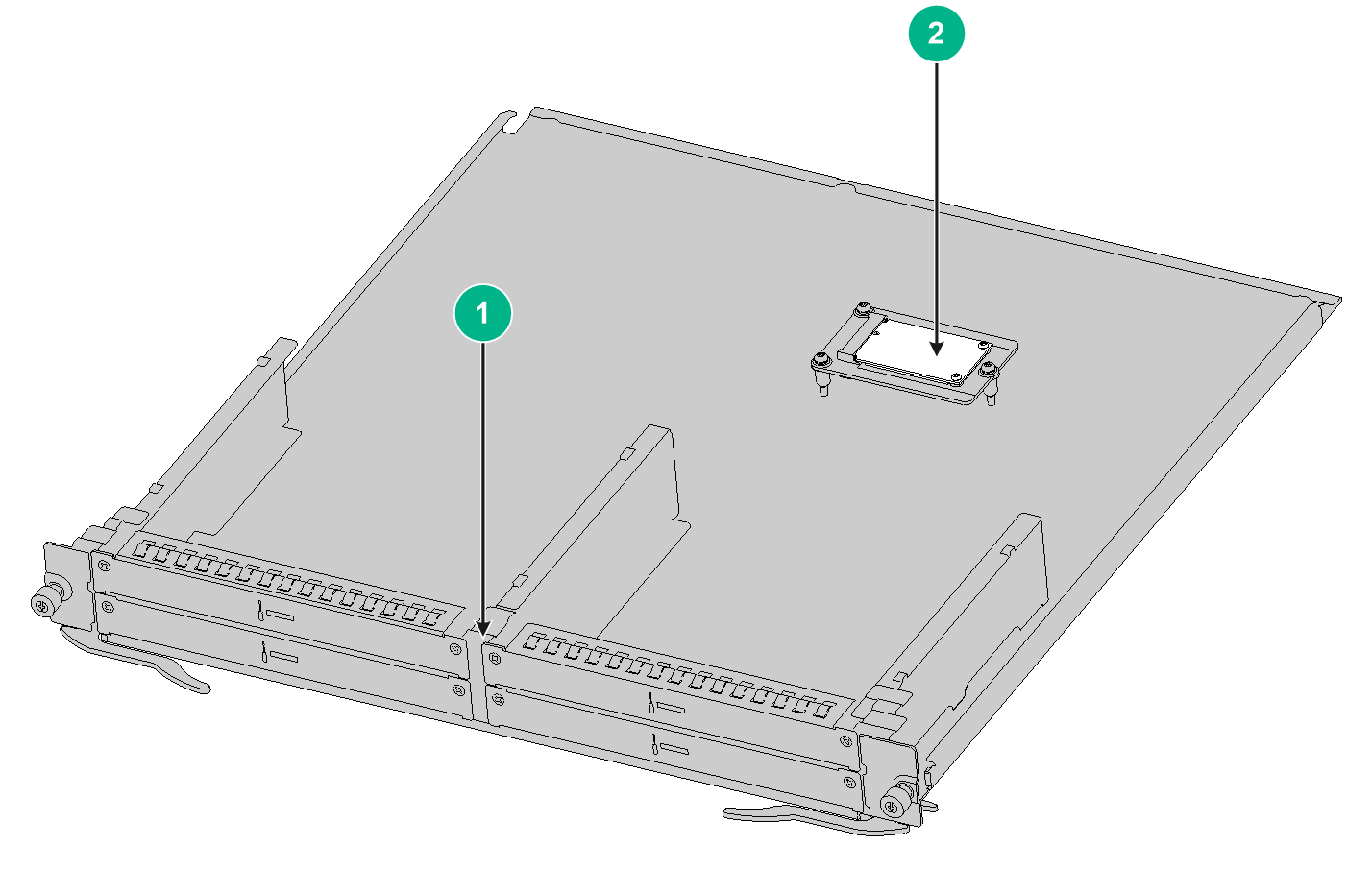

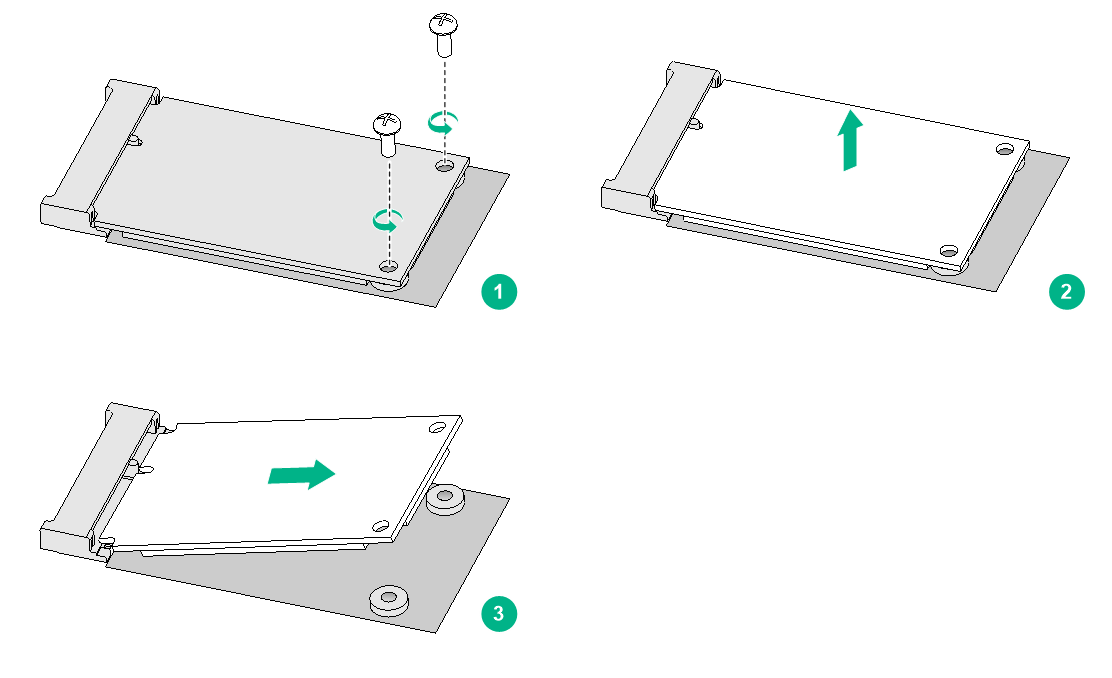

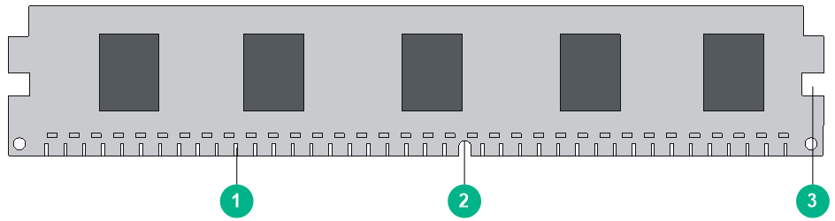

Installing an SSD drive
Only the RPE-X5E, FIP-260, FIP-380, and SAP-XP4GE32 modules support mSATA SSD drives. The FIP-260, FIP-380, and SAP-XP4GE32 modules do not support SSD drives with SSC enabled. No SSD drive or screws are provided with the router. As a best practice, purchase an SSD drive and screws from H3C as needed.
To install an SSD drive:
1.     Locate the SSD drive slot on the service module.
Figure2-13 FIP-260
(1) Front panel
(2) SSD drive slot
2.     Align the golden plating on the SSD drive with the mSATA connector in the slot.
3.     Slightly press the SSD drive until it is level with the surface of the connector.
4.     Use a Phillips screwdriver to screw the SSD drive into place.
Figure2-14 Installing an SSD drive

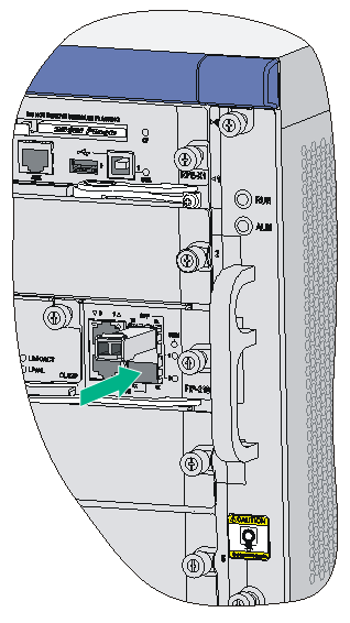

The installation procedure is similar for FIPs. The following procedure installs a FIP-210.
To install a FIP module:
1.     Locate the slot to install the FIP module.
2.     Loosen the captive screws on the filler panel, and then remove the filler panel.
3.     Use even pressure to gently push the FIP module into the slot along the slide rails until positioning pins on the backplane are seated in the positioning holes, and then push the ejector levers inward to lock the FIP module in position.
If you encounter a resistance when pushing a FIP module into slot, remove the filler panels from the left and right slots and then install the FIP module. After the FIP module is installed, reinstall the removed filler panels to prevent dust from entering the chassis.
Figure2-15 Inserting a FIP module
4.     Fasten the captive screws on the FIP module.
5.     Observe the RUN LED on the FIP to verify that the FIP module is installed correctly.
After the router is powered on, the RUN LED on the FIP flashes green once and then fast flashes (at 8 Hz) until the application software is loaded. When the RUN LED flashes green at 1 Hz, the FIP is operating correctly.
For the FIP LED descriptions, see H3C SR6604[6608] Routers Hardware Information and Specifications.

To install a SAP module:
1.     Locate the slot to install the SAP module.
3.     Use even pressure to gently push the SAP module into the slot along the slide rails until positioning pins on the backplane are seated in the positioning holes, and then push the ejector levers inward to lock the SAP module in position.
Figure2-17 Inserting a SAP module
4.     Fasten the captive screws on the SAP module.
5.     Observe the RUN LED on the SAP to verify that the SAP module is installed correctly.
After the router is powered on, the RUN LED on the SAP flashes green once and then fast flashes (at 8 Hz) until the application software is loaded. When the RUN LED flashes green at 1 Hz, the SAP is operating correctly.
For the SAP LED descriptions, see H3C SR6604[6608] Routers Hardware Information and Specifications.

Assembling a MIC-X adapter module and MIC interface module into a MIC-X interface module
IMPORTANT
IMPORTANT:
A MIC-X-ET16-compatible FIP module supports only one MIC-X-ET16 assembled by a MIC-X adapter module and a MIC-ET16L interface module.

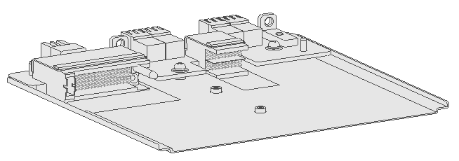

MIC-X adapter module components
Figure2-18 Screw
Figure2-19 Carrier
Figure2-20 Front panel

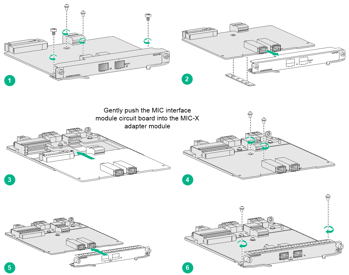

1.     Use a screwdriver to remove the four screws from the MIC interface module circuit board so that the front panel and the gasket are disengaged from the circuit board.
2.     Align the MIC interface module circuit board with the guide rails on the MIC-X adapter module carrier. Gently push the circuit board into the carrier along the guide rails until the circuit board makes close contact with the connectors on the MIC-X adapter module carrier.
3.     Install M3 screws provided with the MIC-X adapter module carrier into the two screw holes at the center of MIC interface module circuit board and fasten the screws.
4.     Select the front panel matching the MIC interface module, align the front panel with the ports on the circuit board, and use M3 screws to attach the front panel to the circuit board.
The MIC-CLP2L, MIC-CLP4L, MIC-SP4L, MIC-SP8L, MIC-ET16L interface modules can be assembled into corresponding MIC-X modules by using MIC-X adapter modules.
Figure2-21 Assembling a MIC-X adapter module and a MIC interface module into a MIC-X interface module

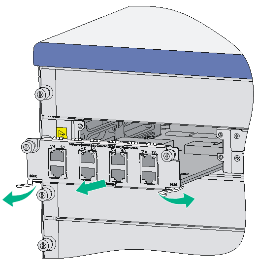

Installing an interface module
The installation procedure is the same for HIM, MIM, MIC, and MIC-X interface modules.

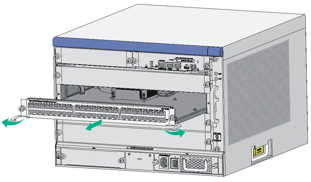

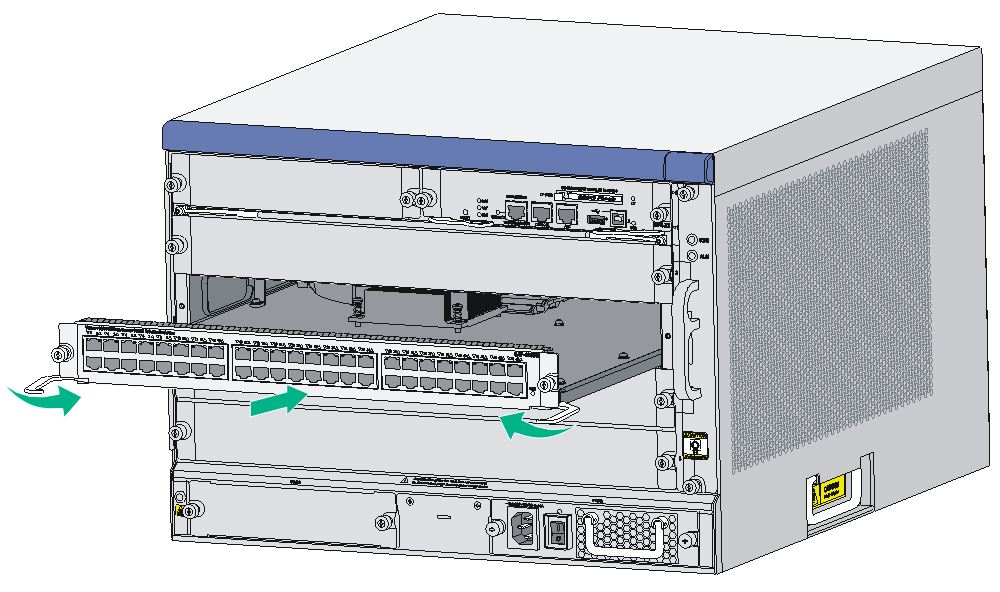

To install a HIM/MIM/MIC/MIC-X interface module:
1.     Locate the slot to install the target module on the FIP module.
Keep the filler panel safe for future use.

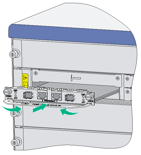

3.     Use even pressure to push the module slowly along the slide rails into the slot, and then close the levers.
Install a HIM/MIM/MIC-X with the components upward and install an MIC with the components downward.
Figure2-22 Pushing the module into the slot
4.     Fasten the captive screws on the module.
5.     Observe the LED for the slot on the router front panel to verify that the module is installed correctly.
If the LED is on after the module initialization completes, the module has been installed correctly and is operating correctly. If the LED is off, the module has failed the POST.

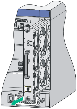

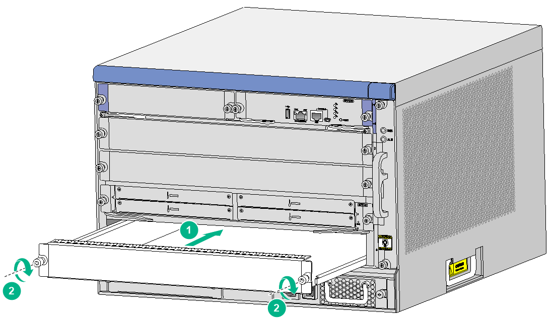

Installing a fan tray
The fan tray is hot swappable and the fans can automatically adjust the speed.
To install a fan tray:
1.     Examine the warning sign on the fan tray to ensure the correct direction of the fan tray. Otherwise, the fan tray cannot be inserted into the slot.
2.     Gently push the fan tray slowly along the slide rails into the slot.
Figure2-23 Pushing the fan tray into the slot
3.     Fasten the captive screws on the fan tray.
4.     Power on the router and check the status LED on the front panel.
On means the fan tray is operating correctly. Off means the fan tray has failed the POST. For the LED description of the fan tray, see H3C SR6604[6608] Routers Hardware Information and Specifications.

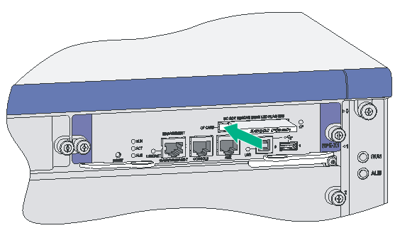

Installing a CF card
To install a CF card on an MCP, remove the CF card cover first.
To install a CF card:
1.     Push the CF card eject button all the way into the slot, and make sure the button does not project from the panel.
2.     Insert the CF card into the slot following the direction shown in Figure2-24, and make sure it does not project from the slot.
Figure2-24 Inserting the CF card into the slot

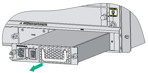

Installing a power supply
The procedures for installing an AC power supply and DC power supply are the same. The following uses a PSR650-A AC power supply as an example.
1.     Locate the slot to install the power supply. Use even pressure to gently push the power supply slowly along the slide rails into the slot.
Figure2-25 Inserting the power supply into the slot
2.     Fasten the captive screws on the power supply.
3.     After connecting the power cord, power on the power supply.
If the power supply LED is green, the power supply operates correctly. If the LED is red, the power supply has failed.
For more information about the power supply LEDs, see H3C SR6604[6608] Routers Hardware Information and Specifications.

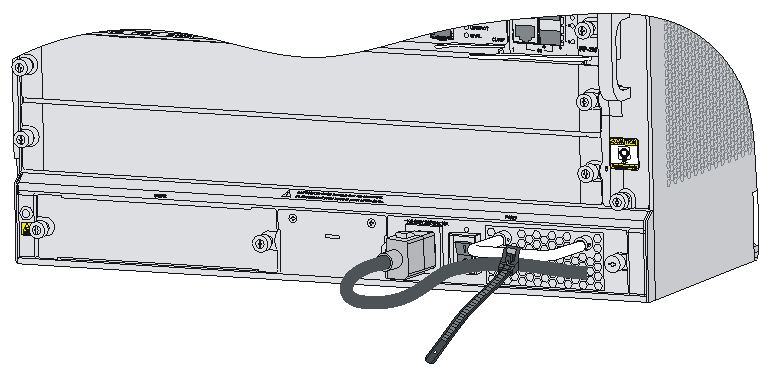

Connecting a power cord
Connecting an AC power cord
1.     Make sure the power is OFF.
2.     Make sure the router is reliably grounded.
3.     Connect one end of the AC power cord to the AC receptacle on the router, and the other end to the AC power source.
4.     Fix the power cord to the power supply handle by using a cable tie.
Figure2-26 Connecting an AC power cord to the router

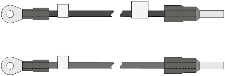

Connecting a DC power cord
Connecting the power cord for the PSR650-D
WARNING
WARNING!
Identify the label on the DC power cord when connecting a DC power cord to avoid connection mistakes.
Figure2-27 DC power cord

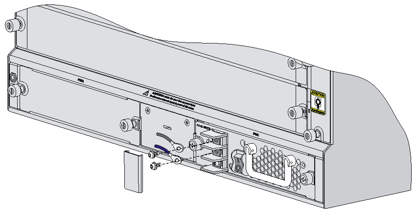

To connect the DC power cord:
2.     Remove the protection cover of the DC power supply.
3.     Remove the screws from the terminals on the power supply.
4.     Connect the end marked with "–" to the negative terminal (–) on the power supply and fasten the screw.
5.     Connect the end marked with "+" to the positive terminal (+) on the power supply and fasten the screw.
6.     Connect the other end of the DC power cord to the DC power source.
7.     Install the protection cover of the DC power supply.
Figure2-28 Connecting the DC power cord

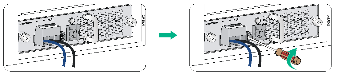

Connecting the power cord for the PSR1200-D
Figure2-29 DC power cord
1.     Loosen the captive screws on the power supply to remove the power supply connector.
2.     Connect the end marked with "–" to the negative terminal (–) on the power supply and fasten the screw.
3.     Connect the end marked with "+" to the positive terminal (+) on the power supply and fasten the screw.
Figure2-30 Attaching the power cords to the power supply connector
4.     Insert the power supply connector in right direction into the power supply, and fasten the captive screws.
Figure2-31 Installing the power supply connector to the power supply
5.     Connect the other ends of the power cords to the DC power source.

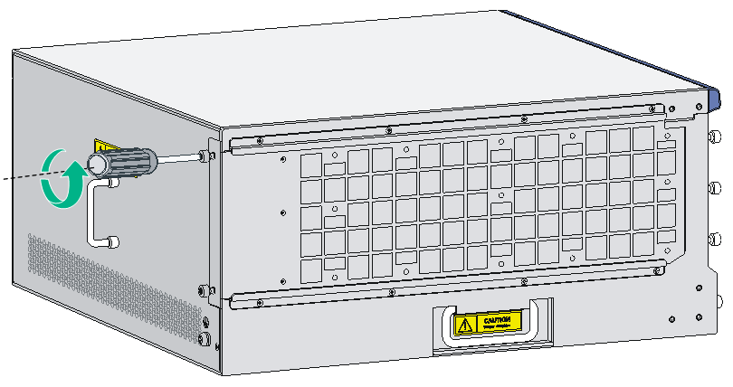

1.     Position the upper slide rail horizontally near the top of the left side of the chassis, as shown in Figure3-1. Align the screw holes on the slide rail with those on the chassis.
2.     Fasten the fastening screws one by one.
3.     Position the lower slide rail horizontally near the bottom of the left side of the chassis, as shown in Figure3-2. Align the screw holes on the slide rail with those on the chassis.
4.     Fasten the fastening screws one by one.
Figure3-1 Installing the air filter slide rails
5.     Gently push the air filter along the slide rails until it is seated in position.
Figure3-2 Inserting the air filter
6.     Fasten the captive screws.
Figure3-3 Fastening the captive screws

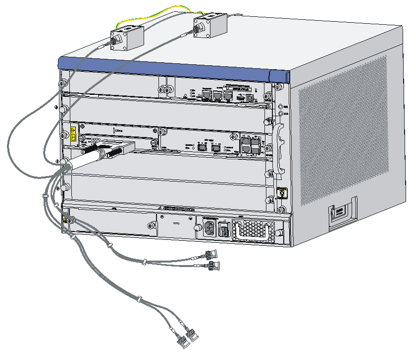

Installing a lightning protector for a network port
Lightning protectors are applicable to only 10/100 Mbps copper Ethernet ports.
Read the instructions for the lightning protector carefully before you install it.
The router does not come with any lightning protectors.
If part of the network cable of a copper Ethernet port must be routed outdoors, connect a lightning protector to the cable before you plug the cable into the port. The router provides this type of lightning protector: single port, residual pulse energy (8/20μs test pulse) 5 KA, output voltage (8/20μs waveform): core-core ≤ 40 V, core-ground ≤ 600 V.
Installation procedure
1.     Use a double-faced adhesive tape to stick the lightning protector onto the router chassis, and make sure it is as close to the grounding screw of the router as possible.
2.     Measure the distance between the protector and the grounding screw of the router, cut the ground wire of the protector as appropriate, and securely tighten the ground wire to the grounding screw of the router.
3.     Use the multimeter to measure whether the ground wire of the protector contacts well with the grounding screw of chassis.
4.     Insert the outdoor network cable into the protector's IN end, and the cable connected to the router into the OUT end, and look at the indicators on the lightning protector to verify that the connection is correct.
5.     Use nylon ties to bundle the cables neatly.
Figure3-5 Installing a lightning protector for a network port
(1) Lightning protector
(2) Grounding cable
Installation precautions
The performance of the port lightning protector might be affected in the following cases:
·     The port lightning protector is installed in reverse direction. Connect the IN end to the outdoor network cable and the OUT end to the network port on the router.
·     The port lightning protector is not reliably grounded. After the connection, use the multimeter to confirm that the ground wire for the protector is as short as possible to ensure its good contact with the grounding screw of the router.
·     The installed port lighting protectors are not sufficient. If the router has more than one network port connected with other devices through cables outdoor, install a lightning protector for each network port.

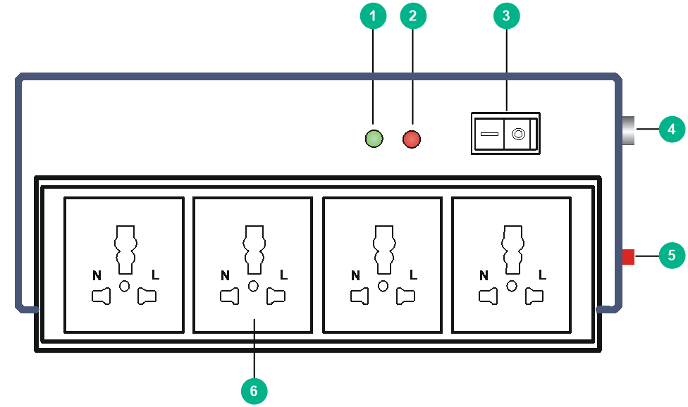

Connecting the AC power supply to a power strip with lightning protection
CAUTION
CAUTION:
Make sure the PE terminal of the power socket has been securely grounded.
If part of the AC power line is routed outdoors, use a power strip with lightning protection to connect the AC power cord of the router to the AC power line to protect the router from being damaged by lightning strikes.
You can attach the power strip to the rack, workbench, or wall of equipment room.
After you connect the AC power cord from the router to a socket on the power strip, verify that the green RUN LED on the strip is on and the red LED is off.
If the red LED is on, use a multimeter to check the polarity of the wires in the power socket for wrong connections. If the zero wire (left) and the live wire (right) are correctly connected, check for missing grounding connection.
Figure3-6 Power strip with lightning protection
(1) Working LED (green)
On means the circuit is operating correctly; off means the circuit is damaged.
(2) Grounding/pole detection LED (red)
On indicates a wrong wire connection (the wire is not grounded or the live line and null line are reversely connected), and you need to check the power supply line.
(3) Power switch
(4) IEC standard socket
It is used to connect to the power supply in the equipment room through a power cord.
(5) Overload automatic protector
The protector automatically opens the electric circuit when the current exceeds the threshold and closes the electric circuit when the current drops below the threshold.
(6) Multifunctional socket
It is used to connect the power supply of the router.
4.     Insert the outdoor network cable into the protector's IN end, and the cable connected to the router into the OUT end, and look at the indicators on the surge protector to verify that the connection is correct.
Figure3-7 Installing a surge protector
Precautions
The performance of the surge protector might be affected in the following cases:
·     The surge protector is installed in reverse direction. Connect the IN end to the outdoor network cable and the OUT end to the network port on the router.
·     The surge protector is not reliably grounded. After the connection, use the multimeter to confirm that the ground wire for the protector is as short as possible to ensure its good contact with the grounding screw of the router.
·     The installed surge protectors are not sufficient. If the router has more than one cable connected with other devices through cables outdoor, install a surge protector for each cable.

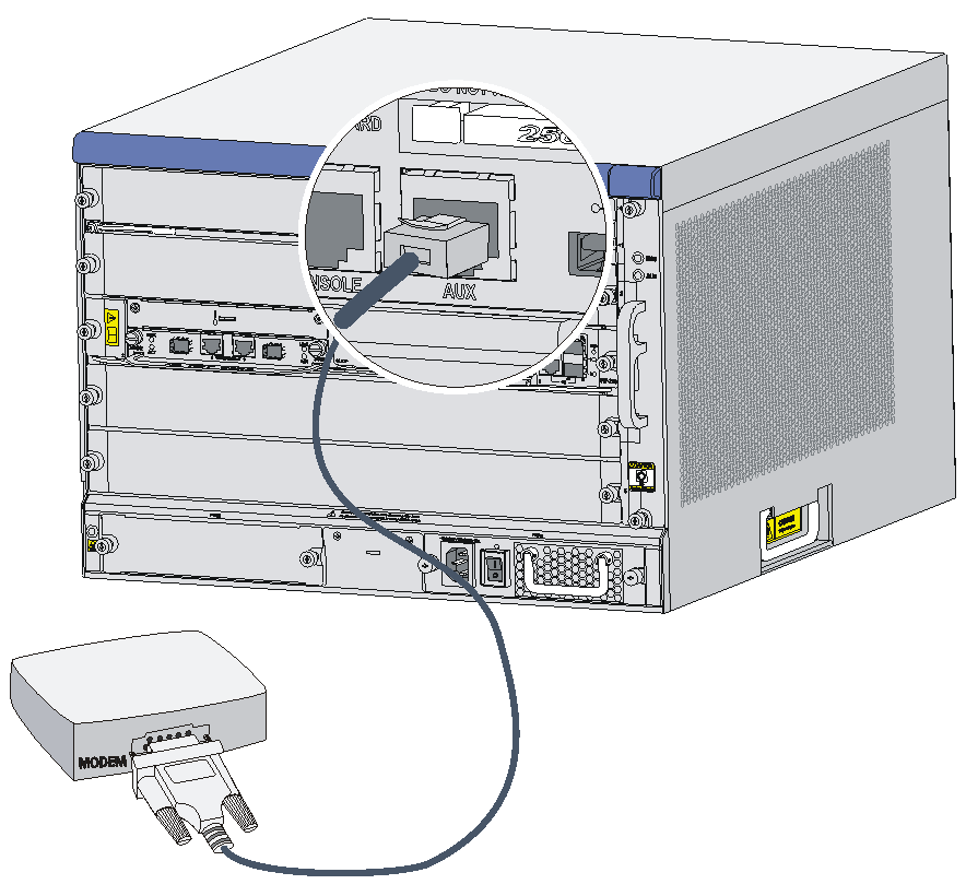

Connecting the AUX cable
Overview
An AUX console cable is an 8-core shielded cable, with a crimped RJ-45 connector at one end for connecting to the AUX port of the router, and DB-25 and DB-9 male connectors at the other end for connecting to the serial port of the modem.
Figure4-1 AUX cable
1.     Plug the DB-9 or DB-25 male connector at one end of the AUX cable into the serial port of the modem.
2.     Plug the RJ-45 connector of the AUX cable into the AUX port of the router.
Figure4-2 Connecting the AUX port to a modem

Connecting a fiber cable

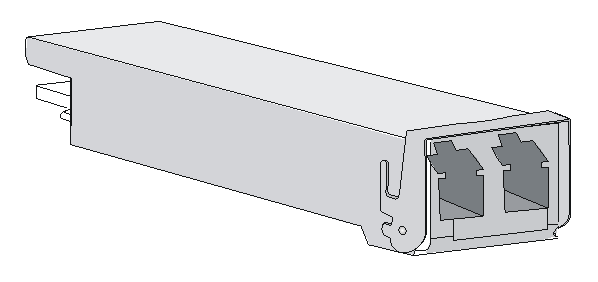

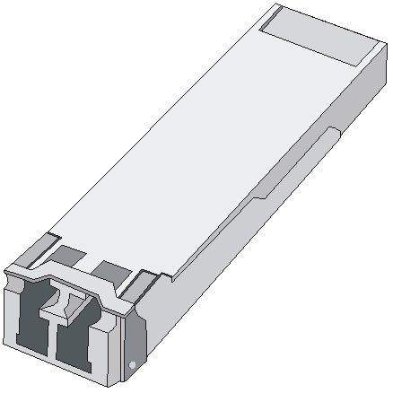

Transceiver modules
A transceiver module and a fiber cable with an LC or MPO connector are required for connecting a fiber port.
·     SFP transceiver modules—Connecting 100/1000 Mbps Ethernet fiber ports and SFP ports on some HIMs.
·     XFP transceiver modules—Connecting XFP ports on the HIM-1EXP.
·     SFP+ transceiver modules—Connecting GE SFP+ ports on the MCP-X2.
·     QSFP+ transceiver modules—Connecting 40GE QSFP+ ports on the MIC-QP1L.

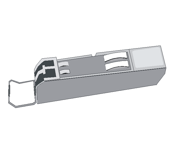

Figure4-4 SFP transceiver module
Figure4-5 XFP transceiver module
Figure4-6 SFP+ transceiver module

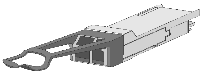

Figure4-7 QSFP+ transceiver module (LC port)
Figure4-8 QSFP+ transceiver module (MPO port)
Fiber cables
About fiber cables

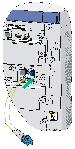

Connecting a fiber cable with an LC connector
1.     Remove the dust plug from a fiber port of the router.
Figure4-11 Removing the dust plug
2.     Install the transceiver module.
Figure4-12 Installing the transceiver module
3.     Identify the Rx and Tx ports. Plug the LC connector at one end of one fiber cable into the Rx port of the router and the LC connector at the other end into the Tx port of the peer device. Plug the LC connector at one end of another fiber cable into the Tx port of the router and the LC connector at the other end to the Rx port of the peer device.
Figure4-13 Installing the fiber connector
4.     View the LINK LED after connection.
¡     If the LED is on, the optical fiber link is present.
¡     If the LED is off, no link is present. This might be because the TX and Rx port of the optical fiber are not connected correctly. In this case, connect the optical fiber again.

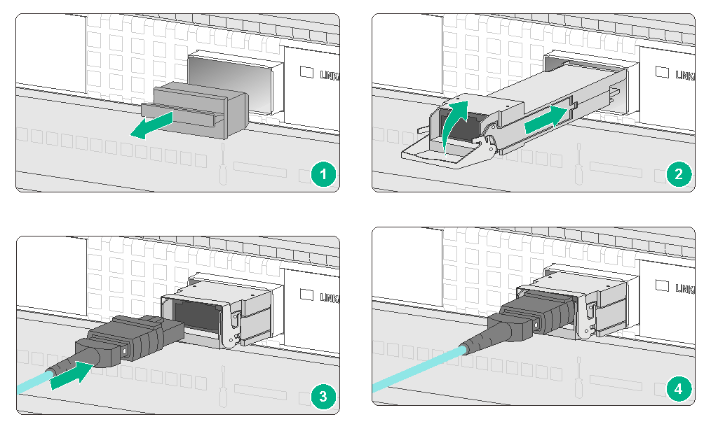

Connecting a fiber cable with an MPO connector
1.     Wear an ESD wrist strap. Make sure the wrist strap makes good skin contact and is reliably grounded.
2.     Remove the dust plug from the target fiber port.
For interface modules with dust plugs provided as accessories, install dust plugs for empty fiber ports in time.
3.     Pull the bail latch on the transceiver module upwards.
4.     Take the transceiver module by its two sides and push the end without the bail latch gently into the port until it is firmly seated in the fiber port.
5.     Remove the dust plug and dust cap from the transceiver module and fiber connector, respectively.
6.     Orient the MPO fiber connector with the white dot on it facing right. Insert the connector horizontally into the transceiver module, and then push it into the transceiver module slightly until it clicks into the place, as shown in Figure4-14.
7.     Use cable ties to bind the fiber cable every 150 mm (5.91 in).
8.     Attach labels to the fiber cable as required.
Figure4-14 Installing a transceiver module and optical fiber (MPO connector)

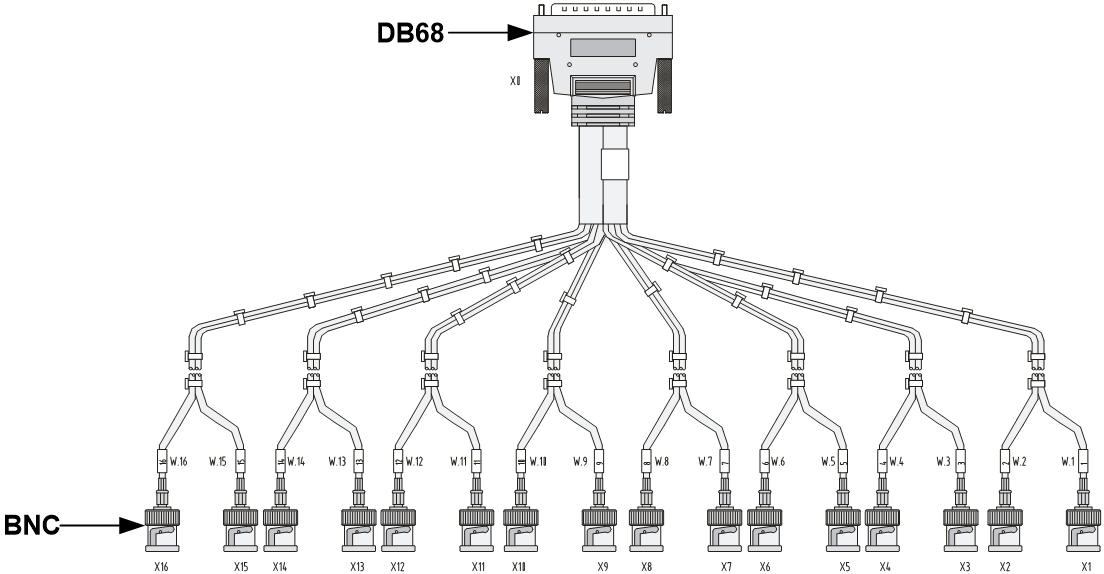

You can use an 8E1 interface cable to connect to MIM-8E1(75)/MIM-8E1(75)-F modules.

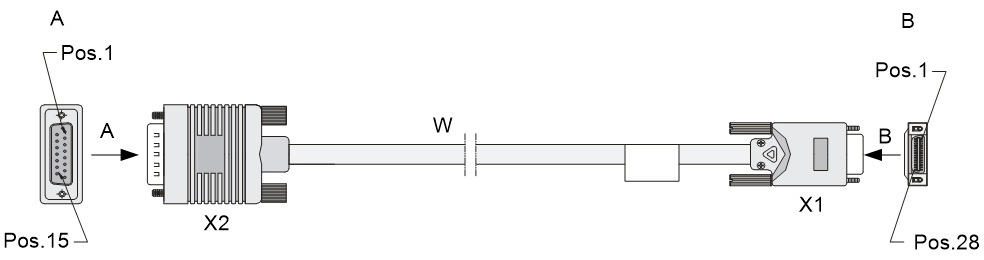

Figure4-15 8E1 splitter cable
The coaxial connector and 75-ohm E1 adapter cable are optional accessories, and must be purchased separately if needed.

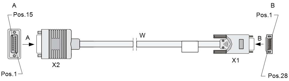

Figure4-16 8T1 splitter cable

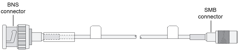

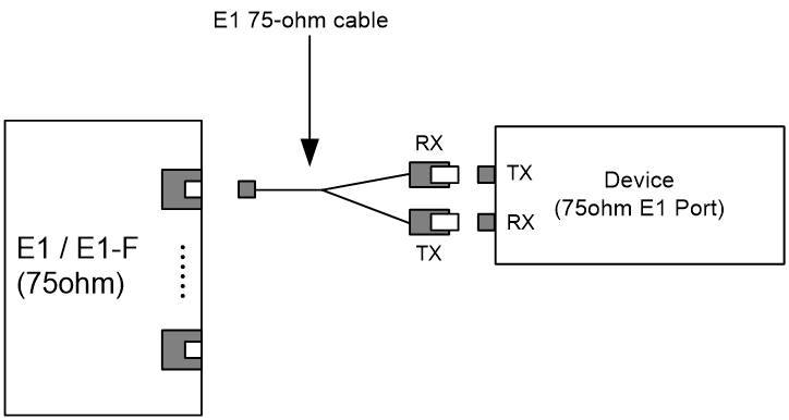

Connecting an E1 cable (D15/D68 <----> BNC)
CAUTION
CAUTION:
When connecting the interface cable, pay attention to the mark on the interface to avoid wrong insertion, which might damage the interface module or even the router.
·     If you do not need to extend the cable, you can directly connect the BNC connectors of the E1 75-ohm cable to the remote network device as follows.
a.     Connect the D15/D68 connector of the E1 75-ohm cable to the D15/D68 interface of the interface module and fasten the bolts to fix the cable.
b.     The other end of the cable provides one pair or multiple pairs of 75-ohm BNC connectors. Connect the TX connectors and the RX connectors on this end to the RX connectors and the TX connectors on the remote device respectively.
Figure4-17 Connect an E1 75-ohm cable

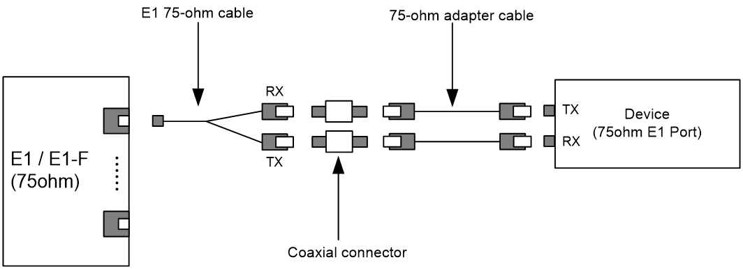

·     If you want to extend the cable, connect each BNC connector of the E1 75-ohm cable to one end of a coaxial connector, and connect the remote device to the other end of the coaxial connector through an E1 75-ohm adapter cable.
Figure4-18 Connecting an E1 75-ohm cable

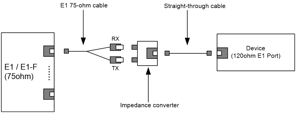

·     If the impedance of the E1 interface on the remote device is 120 ohms, you must use an impedance converter to adapt the impedance.
Figure4-19 Connecting an impedance converter

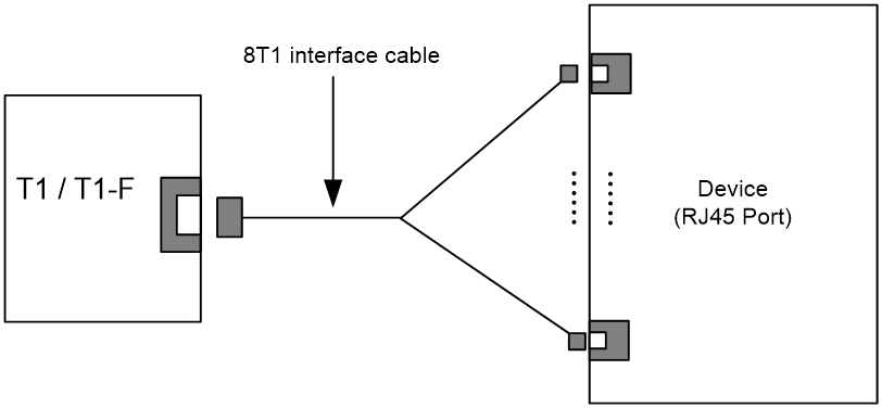

Connecting a T1 cable

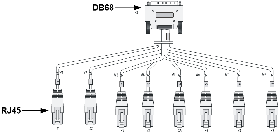

1.     Connect the D68 connector of the 8-port T1 cable to the D68 interface on the interface module and fasten the bolts to fix the cable.
2.     The other end of the cable provides eight RJ-45 connectors. Connect them to the RJ-45 interface on the remote device as needed.
Figure4-20 Connecting an 8T1 cable

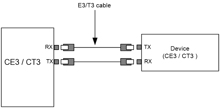

Connecting a CE3/CT3/T3 cable
1.     Connect the SMB connector of an E3/T3 cable to the Tx port on the interface module and the other end to the Rx port on the device to be connected.
2.     Connect the SMB connector of another E3/T3 cable to the Rx port of interface module and the other end to the Tx port on the device to be connected.
Figure4-22 Connecting a CE3/CT3/T3 cable

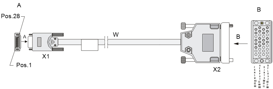

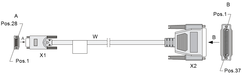

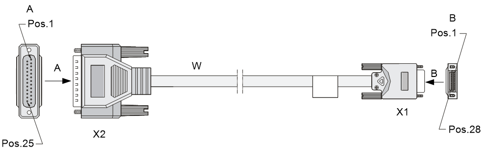

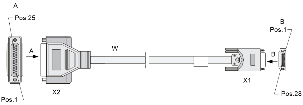

Connecting a serial port cable
Overview

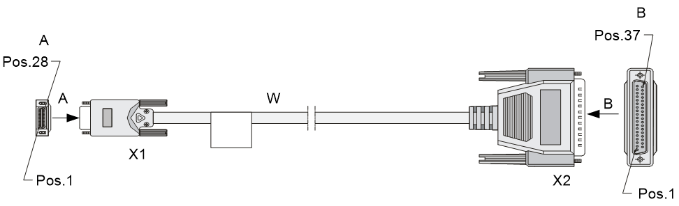

You can use a serial port cable to connect to the MIM-2SAE/MIM-4SAE/MIM-8SAE module. Select a serial port cable according to the link type.

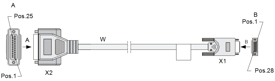

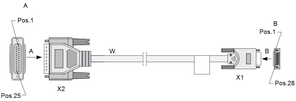

Figure4-23 V.24 DTE cable
Figure4-24 V.24 DCE cable
Figure4-25 V.35 DTE cable
Figure4-26 V.35 DCE cable
Figure4-27 X.21 DTE cable
Figure4-28 X.21 DCE cable
Figure4-29 RS449 DTE cable
Figure4-30 RS449 DCE cable

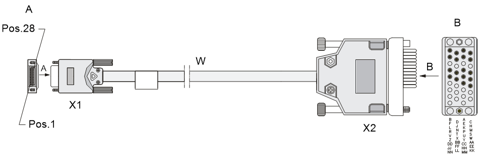

Figure4-31 RS530 DTE cable
Figure4-32 RS530 DCE cable
1.     Check port type of the peer device and choose the synchronous serial interface cable of correct type.
2.     Plug the D28 end of the synchronous serial interface cable into the D28 interface of the SAE interface module.
3.     If the WAN uses DDN line, connect the cable to the port of the CSU/DSU.

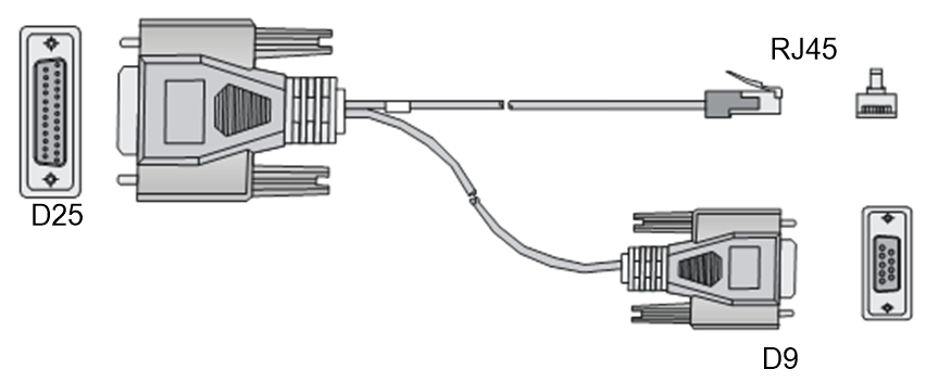

Connecting a DB9-to-RJ45 console cable
IMPORTANT
IMPORTANT:
The serial ports on PCs do not support hot swapping. To connect a PC to an operating router, first connect the PC end. To disconnect a PC from an operating router, first disconnect the router end.
You can connect a configuration terminal to the router by using the console cable or by using the USB cable.

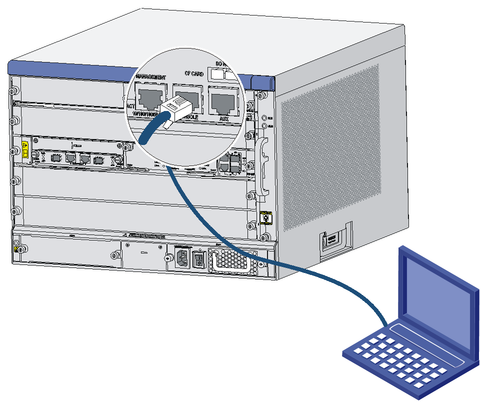

To connect a configuration terminal to the router by using a console cable:
1.     Select a configuration terminal, which can be a character terminal with an RS-232 serial port, or a PC.
If the PC does not have an RS-232 serial port but a USB port, use a USB to RS-232 adapter for the USB port and install the driver.
2.     Plug the DB-9 female connector of the console cable into the serial port on the configuration terminal and the RJ-45 connector into the console port on the router
The console cable connection procedures are the same for the routers. The following uses an SR6608 as an example.
Figure5-1 Connecting the console cable

6.     Connect the standard USB connector of the cable to the USB port of the configuration terminal.
7.     Connect the RJ-45 connector of the cable to the console port of the router.
Connecting the USB console port by using a USB cable
IMPORTANT
IMPORTANT:
After using a USB console cable to connect the router to a configuration terminal, you must download and install the USB console driver program from http://www.h3c.com/ before configuring the device.
To use a USB console cable to connect the router to a configuration terminal:
1.     Click the following link, or copy it to the address bar of the browser to log in to the download page of the USB console driver, and download the driver.
https://www.h3c.com/cn/Home/QR/USBControl.htm
2.     Run Installer to pre-install the driver. A message that indicates successful driver pre-installation will pop up when the preinstallation is complete.
3.     Connect the standard USB port of the USB cable to the configuration terminal.
4.     Connect the mini USB port at the other end of the USB cable to the USB console port on the router. Then, the system will install the driver automatically.
Setting terminal parameters
To configure and manage the router through the console port, you must run a terminal emulator program, TeraTermPro or PuTTY, on your configuration terminal. You can use the emulator program to connect a network device, a Telnet site, or an SSH site. For more information about the terminal emulator programs, see the user guides for these programs.
The following are the required terminal settings:
·     Bits per second—9600.
·     Data bits—8.
·     Stop bits—1.
·     Parity—None.
·     Flow control—None.

1.     Always wear an ESD wrist strap or ESD gloves when replacing the modules.
2.     When working with a removable module, such as an MPU, RPE-X1/RPE-X3/RPE-X5/RPE-X5E carrier (used when you use an RPE-X1/RPE-X3/RPE-X5/RPE-X5E MPU), FIP module, SAP module, switching fabric module, memory module, CF card, or HIM/MIM, follow these guidelines:
¡     Ensure good alignment with the slot to avoid damage to the module during installation or removal.
¡     Before removing a module, make sure the captive screws are completely loosened. Otherwise, the panel of the module might be deformed.
¡     Avoid touching any components on the PCB during observing or moving the module.
¡     Put the removed module on an antistatic workbench with the PCB side facing upward or place them in antistatic bags.
Replacing a power supply
The replacement procedure of an AC power supply is the same as a DC power supply. This section takes an AC power supply as an example.
To replace a power supply:
1.     Loosen the captive screws of the power supply until all spring pressure is released.
2.     Gently pull the power supply out of the slot along the slide rails.
Figure6-1 Pulling out the power supply
3.     Put the removed power supply on an antistatic workbench or into an antistatic bag.
4.     If you do not install a new power supply in the slot, install a filler panel. To install a power supply, see "Installing a power supply."

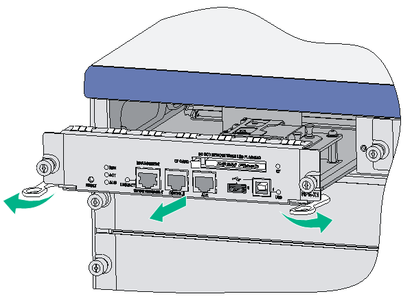

Replacing an RPE-X1/RPE-X3/RPE-X5/RPE-X5E MPU
The replacement procedures for the RPE-X1, RPE-X3, RPE-X5, and RPE-X5E MPUs are the same. This example uses an RPE-X1.
To replace an RPE-X1 MPU:
1.     Determine the MPU to be removed. This section takes the MPU in slot 1 as an example.
2.     Loosen the captive screws of the MPU until all spring pressure is released.
3.     Holding the ejector levers of the MPU with both hands, pull the ejector levers outward, and gently pull the MPU out of the slot along the slide rails.
Figure6-2 Pulling the RPE-X1 MPU out of the slot
4.     Install a new RPE-X1 MPU. For more information, see "Installing an RPE-X1/RPE-X3/RPE-X5/RPE-X5E MPU."

1.     Determine the FIP module to be removed. This section takes the FIP module in slot 3 as an example.
2.     Loosen the captive screws of the FIP module until all spring pressure is released.
3.     Holding the ejector levers of the FIP module with both hands, pull the ejector levers outward, and gently pull the FIP module out of the slot along the slide rails.
Figure6-5 Pulling the FIP module out of the slot
4.     If you do not install a new FIP module in the slot, install a filler panel. To install a new FIP module, see "Installing a FIP module and an air deflector."

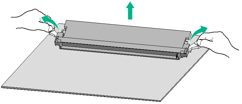

Replacing an SSD drive
Before you remove an SSD drive, remove the service module from the router. For the removal procedure of service modules, see "Replacing a FIP module" or "Replacing a SAP/OAP/switching fabric module."
To remove an SSD drive:
1.     Use a Phillips screwdriver to remove the fastening screws on the SSD drive.
2.     Gently lift the SSD drive free from the connector and slightly pull the SSD drive out of the slot.
Keep the SSD drive secure.
3.     Install a new SSD drive. For the installation procedure, see "Installing an SSD drive."
Figure6-6 Removing an SSD drive

Replacing a HIM/MIM/MIC/MIC-X
CAUTION
CAUTION:
To avoid hardware damage, do not install or remove a HIM/MIM/MIC/MIC-X module when the RUN LED on a FIP module is fast flashing green.
IMPORTANT
IMPORTANT:
After you remove a HIM/MIM/MIC/MIC-X from a FIP, the HIM/MIM/MIC/MIC-X settings will not automatically restore if you reinstall the HIM/MIM/MIC/MIC-X on the FIP after the FIP reboots. To save the settings, make sure the HIM/MIM/MIC/MIC-X is in position before rebooting the FIP module or inserting the FIP module into the router.
IMPORTANT
IMPORTANT:
The replacement procedures for HIMs, MIMs, MICs, and MIC-Xs are similar.
To replace a HIM/MIM/MIC/MIC-X:
1.     Determine the HIM/MIM/MIC/MIC-X to be removed, and completely loosen the captive screws of the HIM/MIM/MIC/MIC-X.
2.     Fully open the ejector levers on the HIM/MIM/MIC/MIC-X. Hold the ejector levers and then gently pull the HIM/MIM/MIC/MIC-X out of the slot along the slide rails.
The ejector levers of the FIP module are long. When removing the HIM/MIM/MIC/MIC-X in slot 1 on the FIP module, avoid touching the right ejector lever of the FIP module.
Figure6-8 Replacing a HIM/MIM/MIC/MIC-X
3.     If you do not install a new HIM/MIM/MIC/MIC-X in the slot, install a filler panel. To install a new HIM/MIM/MIC/MIC-X, see "Installing a HIM/MIM/MIC/MIC-X interface module."
Replacing a CF card
CAUTION
CAUTION:
To avoid hardware damage, do not remove the CF card when the router is booting or the CF LED is flashing.
To replace a CF card:
1.     Make sure the CF card LED is not flashing. A flashing CF card LED means that the system is accessing the CF card.
To replace the CF card on the MCP, remove the CF card cover first.
2.     As shown in Figure6-9, press the CF card eject button of the CF card reader so that the eject button protects from the panel.
Figure6-9 Pressing the eject button
3.     Press the eject button again to eject the CF card part-way out of the CF card reader, and then pull the CF card out of the CF card reader.
Figure6-10 Pressing the eject button to eject the CF card
4.     Install a new CF card. For more information, see "Installing a CF card."
To protect the CF card, place it into an antistatic bag.
Replacing a transceiver module
WARNING
WARNING!
·     Do not stare into the optical fibers.
·     When removing a transceiver module, do not touch the golden finger of the transceiver module.
The replacement procedure is the same for LC and MPO transceiver modules. The LC transceiver module is used as an example in this procedure:
1.     Remove the optical fibers from the transceiver module.
2.     Pivot the clasp down to the horizontal position.
3.     As shown in Figure6-11, holding the handle of the transceiver module, gently pull the transceiver module out.
4.     Insert the plastic plug to the removed transceiver module, and put the transceiver module into its original shipping materials.
5.     If you do not install a new transceiver module in the interface, install a dust-proof plug in the interface. To install a transceiver module, see "Connecting a fiber cable."
Figure6-11 Removing a transceiver module
When replacing a transceiver module, make sure the two transceiver modules connected by the same optical fiber have the same wavelength.
Replacing a fan tray
CAUTION
CAUTION:
·     The router supports automatic fan speed adjustment and hot-swapping of the fan tray.
·     Keep your hands away from the spinning fan blades when removing the fan tray.
To replace a fan tray:
1.     Loosen the captive screws of the fan tray until all spring pressure is released.
2.     Gently pull the fan tray out of the slot along the slide rails.
Figure6-12 Pulling out the fan tray
3.     Install a new fan tray. For more information, see "Installing a fan tray."
·     Do not keep the router working without a fan tray for more than two minutes because poor ventilation might cause damage to the router.
·     To protect the removed fan tray, place it in an antistatic bag.
·     For more information about the LED status on the fan tray, see H3C SR6604[6608] Routers Hardware Information and Specifications.

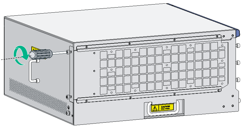

To replace an air filter:
1.     Loosen the captive screws of the air filter until all spring pressure is released.
Figure6-13 Loosening the captive screws of the air filter
2.     Gently pull the air filter out along the slide rails.
Figure6-14 Pulling the air filter out along the slide rails
3.     Install a new air filter. For more information, see "Installing an air filter."

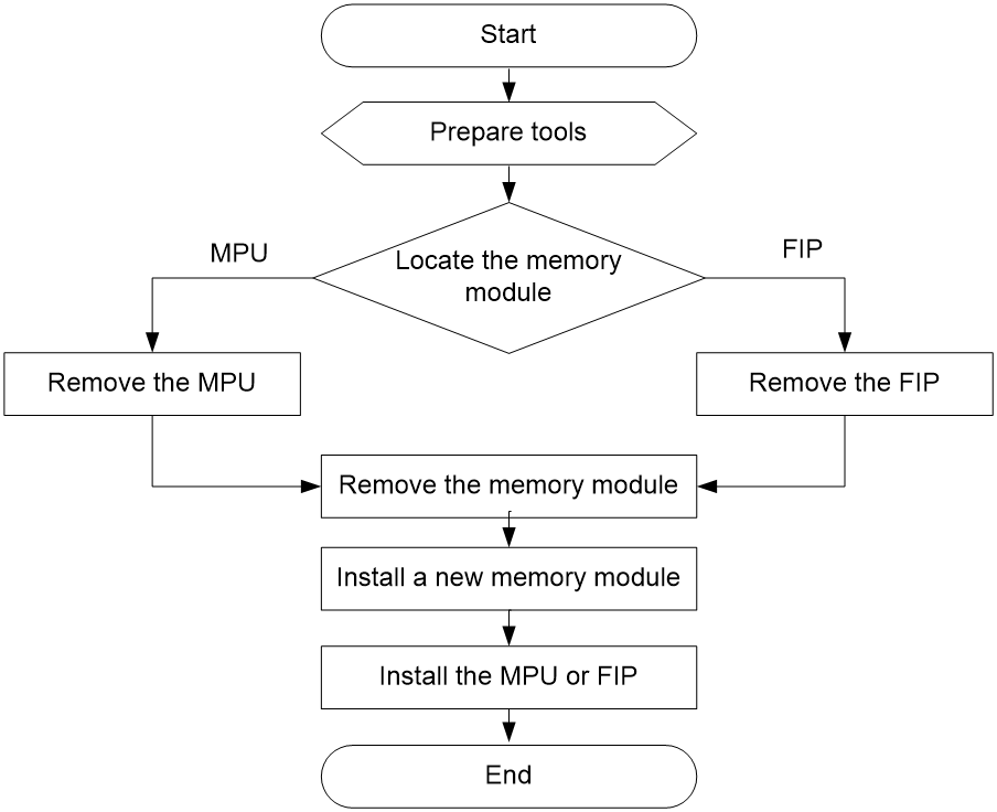

Replacing a memory module
The RPE-X1s and FIPs are equipped with memory modules. Before installing or removing a memory module, remove the RPE-X1 or FIP from the chassis first. For more information, see "Replacing an MPU," "Replacing an RSE-X1 MPU," and "Replacing a FIP module."
When to replace a memory module
CAUTION
CAUTION:
·     Use the memory modules provided by H3C only. Otherwise, the router might be unable to operate correctly.
·     For the memory module specifications, see H3C SR6604[6608] Routers Hardware Information and Specifications.
Memory modules are removable components of the router.
You need to replace a memory module in the following situations:
·     More memory is needed to upgrade the application program.
·     The router needs to maintain a large routing table or support other highly memory consuming operations.
·     An existing memory module is damaged.
Figure6-15 Memory module replacement flowchart
Memory module structure
Figure6-16 Memory module structure (DDR2)
(1) Connector edge
(2) Polarization notch
(3) Latch notch
Figure6-17 Memory module structure (DDR3)
(1) Connector edge
(3) Latch notch

To replace a memory module:
1.     Determine the module (MPU or FIP) for which you will replace a memory module, and put the module on a flat workbench.
2.     Pull the release latches away from the memory module at both ends so that the memory module is lifted from the memory module slot.
3.     Holding the non-conductive edge, remove the memory module.
Figure6-19 Removing the memory module
4.     Align the polarization notch of the memory module with the key in the connector.
5.     Insert the memory module into the slot.
6.     Carefully and firmly press the memory module at both ends until you hear a click. This indicates the memory module is seated in the memory module slot.
7.     Verify that the release latches have firmly locked the memory module in position.
Figure6-20 Installing the memory module

Displaying transceiver module information and alarming information
Table7-8 Commonly used transceiver modules
Transceiver module type
Application scenarios
Whether can be an optical transceiver
Whether can be an electrical transceiver
SFP (Small Form-factor Pluggable)
Typically used for 100M/1000M Ethernet ports or POS 155M/622M/2.5G ports
Yes
Yes
XFP(10-Gigabit small Form-factor Pluggable)
Typically used for 10G ports
Yes
No
SFP+
Yes
No
QSFP+
Typically used for 40G ports
Yes
No
To identify transceiver modules, you can use the following command to view the key parameters of the transceiver modules, including transceiver module type, connector type, central wavelength of the laser sent, transmission distance, and vendor name or name of the vendor who customizes the transceiver modules.
To display transceiver module information:
Purpose
Remarks
Display key parameters of the transceiver module in a specified interface
display transceiver interface [ interface-type interface-number ]
Available for all transceiver modules.
Displaying the alarming information or fault detection parameters for a transceiver module
The system outputs alarm information for you to locate and troubleshoot faults of transceiver modules. For the H3C-customized transceiver modules, the system can also monitor the key parameters, such as temperature, voltage, laser bias current, TX power, and RX power. When these parameters are abnormal, you can take corresponding measures to prevent transceiver module faults.
To display the alarming information or fault detection parameters of a transceiver module:
Purpose
Remarks
Display the current alarm information of the transceiver module in a specified interface
display transceiver alarm interface [ interface-type interface-number ]
For more information about the transceiver module displaying commands, see H3C SR6600/SR6600-X Routers Fundamentals Command Reference.
