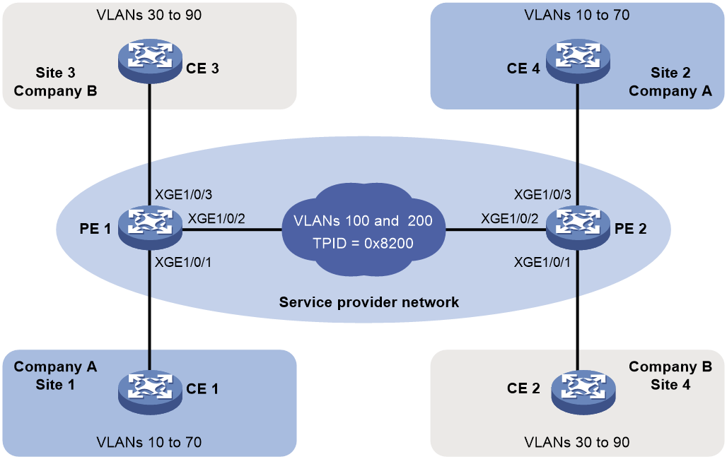

Network requirements
As shown in Figure 3:
·     The service provider assigns VLAN 100 to Company A's VLANs 10 through 70.
·     The service provider assigns VLAN 200 to Company B's VLANs 30 through 90.
·     The devices between PE 1 and PE 2 in the service provider network use a TPID value of 0x8200.
Configure QinQ on PE 1 and PE 2 to transmit traffic in VLANs 100 and 200 for Company A and Company B, respectively.
For the QinQ frames to be identified correctly, set the SVLAN TPID to 0x8200 on the service provider-side ports of PE 1 and PE 2.
Figure 3 Network diagram
Configuration procedure
1.     Configure PE 1:
# Configure Ten-GigabitEthernet 1/0/1 as a trunk port, and assign it to VLAN 100.
<PE1> system-view
[PE1] interface ten-gigabitethernet 1/0/1
[PE1-Ten-GigabitEthernet1/0/1] port link-type trunk
[PE1-Ten-GigabitEthernet1/0/1] port trunk permit vlan 100
# Set the PVID of Ten-GigabitEthernet 1/0/1 to VLAN 100.
[PE1-Ten-GigabitEthernet1/0/1] port trunk pvid vlan 100
# Enable QinQ on Ten-GigabitEthernet 1/0/1.
[PE1-Ten-GigabitEthernet1/0/1] qinq enable
[PE1-Ten-GigabitEthernet1/0/1] quit
# Configure Ten-GigabitEthernet 1/0/2 as a trunk port, and assign it to VLANs 100 and 200.
[PE1] interface ten-gigabitethernet 1/0/2
[PE1-Ten-GigabitEthernet1/0/2] port link-type trunk
[PE1-Ten-GigabitEthernet1/0/2] port trunk permit vlan 100 200
# Set the TPID value in the SVLAN tags to 0x8200 on Ten-GigabitEthernet 1/0/2.
[PE1-Ten-GigabitEthernet1/0/2] qinq ethernet-type service-tag 8200
[PE1-Ten-GigabitEthernet1/0/2] quit
# Configure Ten-GigabitEthernet 1/0/3 as a trunk port, and assign it to VLAN 200.
[PE1] interface ten-gigabitethernet 1/0/3
[PE1-Ten-GigabitEthernet1/0/3] port link-type trunk
[PE1-Ten-GigabitEthernet1/0/3] port trunk permit vlan 200
# Set the PVID of Ten-GigabitEthernet 1/0/3 to VLAN 200.
[PE1-Ten-GigabitEthernet1/0/3] port trunk pvid vlan 200
# Enable QinQ on Ten-GigabitEthernet 1/0/3.

2.     Configure PE 2:
# Configure Ten-GigabitEthernet 1/0/1 as a trunk port, and assign it to VLAN 200.
<PE2> system-view
[PE2] interface ten-gigabitethernet 1/0/1
[PE2-Ten-GigabitEthernet1/0/1] port link-type trunk
[PE2-Ten-GigabitEthernet1/0/1] port trunk permit vlan 200
# Set the PVID of Ten-GigabitEthernet 1/0/1 to VLAN 200.
[PE2-Ten-GigabitEthernet1/0/1] port trunk pvid vlan 200
[PE2-Ten-GigabitEthernet1/0/1] qinq enable
[PE2-Ten-GigabitEthernet1/0/1] quit
[PE2] interface ten-gigabitethernet 1/0/2
[PE2-Ten-GigabitEthernet1/0/2] port link-type trunk
[PE2-Ten-GigabitEthernet1/0/2] port trunk permit vlan 100 200
[PE2-Ten-GigabitEthernet1/0/2] qinq ethernet-type service-tag 8200
[PE2-Ten-GigabitEthernet1/0/2] quit
# Configure Ten-GigabitEthernet 1/0/3 as a trunk port, and assign it to VLAN 100.
[PE2] interface ten-gigabitethernet 1/0/3
[PE2-Ten-GigabitEthernet1/0/3] port link-type trunk
[PE2-Ten-GigabitEthernet1/0/3] port trunk permit vlan 100
# Set the PVID of Ten-GigabitEthernet 1/0/3 to VLAN 100.
[PE2-Ten-GigabitEthernet1/0/3] port trunk pvid vlan 100
[PE2-Ten-GigabitEthernet1/0/3] qinq enable
[PE2-Ten-GigabitEthernet1/0/3] quit
3.     Configure the devices between PE 1 and PE 2:
# Set the MTU to a minimum of 1504 bytes for each port on the path of QinQ frames. (Details not shown.)
# Configure all ports on the forwarding path to allow frames from VLANs 100 and 200 to pass through without removing the VLAN tag. (Details not shown.)

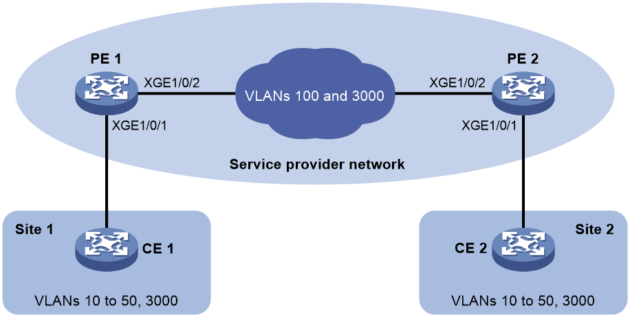

VLAN transparent transmission configuration example
As shown in Figure 4:
·     The service provider assigns VLAN 100 to a company's VLANs 10 through 50.
·     VLAN 3000 is the dedicated VLAN of the company on the service provider network.
Configure QinQ on PE 1 and PE 2 to provide Layer 2 connectivity for CVLANs 10 through 50 over the service provider network.
Configure VLAN transparent transmission for VLAN 3000 on PE 1 and PE 2 to enable the hosts in VLAN 3000 to communicate without using an SVLAN.
Figure 4 Network diagram
1.     Configure PE 1:
# Configure Ten-GigabitEthernet 1/0/1 as a trunk port, and assign it to VLAN 100 and VLAN 3000.
<PE1> system-view
[PE1-Ten-GigabitEthernet1/0/1] port trunk permit vlan 100 3000
# Enable transparent transmission for VLAN 3000 on Ten-GigabitEthernet 1/0/1.
[PE1-Ten-GigabitEthernet1/0/1] qinq transparent-vlan 3000
# Configure Ten-GigabitEthernet 1/0/2 as a trunk port, and assign it to VLANs 100 and 3000.
[PE1-Ten-GigabitEthernet1/0/2] port trunk permit vlan 100 3000
2.     Configure PE 2:
<PE2> system-view
[PE2-Ten-GigabitEthernet1/0/1] port trunk permit vlan 100 3000
[PE2-Ten-GigabitEthernet1/0/1] qinq transparent-vlan 3000
[PE2-Ten-GigabitEthernet1/0/2] port trunk permit vlan 100 3000
# Configure all ports on the forwarding path to allow frames from VLANs 100 and 3000 to pass through without removing the VLAN tag. (Details not shown.)
