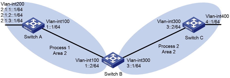

To enable an OSPFv3 process on a router:
1.     Enable the OSPFv3 process globally.
2.     Assign the OSPFv3 process a router ID.
3.     Enable the OSPFv3 process on related interfaces.
An OSPFv3 process ID has only local significance. Process 1 on a router can exchange packets with process 2 on another router.
OSPFv3 requires you to manually specify a router ID for each router in an AS. Make sure all assigned router IDs in the AS are unique.
Restrictions and guideline
If a router runs multiple OSPFv3 processes, you must specify a unique router ID for each process.

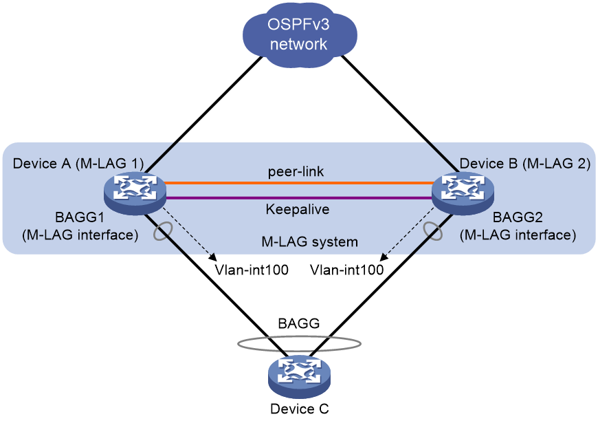

Establishing OSPFv3 neighbor relationships on an M-LAG network
When a customer-side device accesses the OSPFv3 network through both M-LAG member devices in an M-LAG system, the M-LAG member devices provide Layer 3 gateway services. The gateway interfaces (such as VLAN interfaces) on different M-LAG member devices might generate the same link-local address because they have the same IP address and MAC address. In this case, the M-LAG member devices cannot establish OSPFv3 neighbor relationships with the customer-side device.
To resolve this issue, configure the gateway interfaces to use M-LAG virtual IPv6 addresses for OSPFv3 neighbor relationship establishment. The M-LAG virtual IPv6 address configured for a gateway interface must be a link-local address because OSPFv3 uses link-local addresses for OSPFv3 neighbor relationship establishment. For more information about M-LAG, see M-LAG configuration in Layer 2—LAN Switching Configuration Guide.
As shown in Figure 1, Device C accesses the OSPFv3 network through the M-LAG system that consists of Device A and Device B. Device A and Device B provide Layer 3 gateway services. The gateway interface VLAN-interface 100 on Device A and the gateway interface VLAN-interface 100 on Device B have the same IP address and the same MAC address. To ensure that both Device A and Device B can establish an OSPFv3 neighbor relationship with Device C, configure different M-LAG virtual IPv6 addresses for the VLAN interfaces on Device A and Device B.
Figure 1 OSPFv3 neighbor relationship establishment on an M-LAG network
2.     Enter interface view.
3.     Specify a link-local address as the M-LAG virtual IPv6 address to be assigned to the interface.
port m-lag ipv6 virtual-ip ipv6-address link-local
By default, no M-LAG virtual IPv6 address is assigned to an interface.
For more information about this command, see M-LAG commands in Layer 2—LAN Switching Ethernet Command Reference.

Example: Configuring OSPFv3 route summarization
As shown in Figure 9:
·     Switch A, Switch B, and Switch C are in Area 2.
·     OSPFv3 process 1 and OSPFv3 process 2 run on Switch B. Switch B communicates with Switch A and Switch C through OSPFv3 process 1 and OSPFv3 process 2, respectively.
·     On Switch A, configure IPv6 addresses 2:1:1::1/64, 2:1:2::1/64, and 2:1:3::1/64 for VLAN-interface 200.
·     On Switch B, configure OSPFv3 process 2 to redistribute direct routes and the routes from OSPFv3 process 1. Switch C can then learn the routes destined for 2::/64, 2:1:1::/64, 2:1:2::/64, and 2:1:3::/64.
·     On Switch B, configure route summarization to advertise only summary route 2::/16 to Switch C.
Figure 9 Network diagram
1.     Configure IPv6 addresses for interfaces. (Details not shown.)
